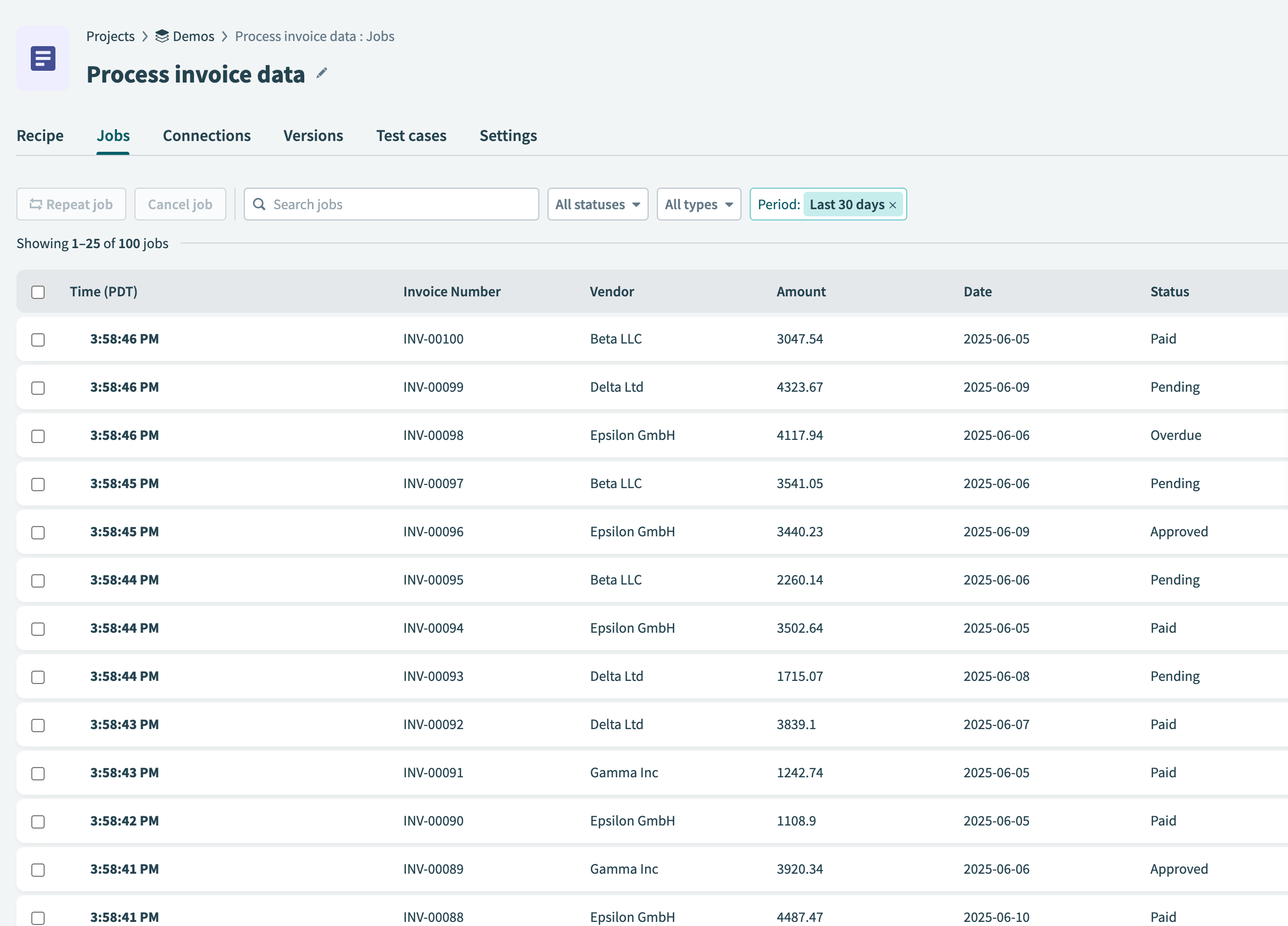

The Job report page records all processed jobs for a recipe. Open the recipe and click its Jobs tab to view the report.
A recipe's Job report page, showing the list of jobs with their time, status, and other columns, plus job actions and filters above the table.Job report page

You can customize job reports to display up to ten additional columns. The columns you add can contain any data available in the recipe. For example, if the recipe processes invoices, you can customize the report to include columns for Invoice ID, Invoice amount, or other relevant invoice data.

Click the ••• (ellipsis) in the table header row, then select Customize job report.
The job report table header with the ellipsis menu open, showing the Customize job report option.Customize job report button
Use datapills from the recipe's steps to add columns to the report on the Customize job report page.
The Customize job report page with datapills mapped to report columns.Customize the job report
