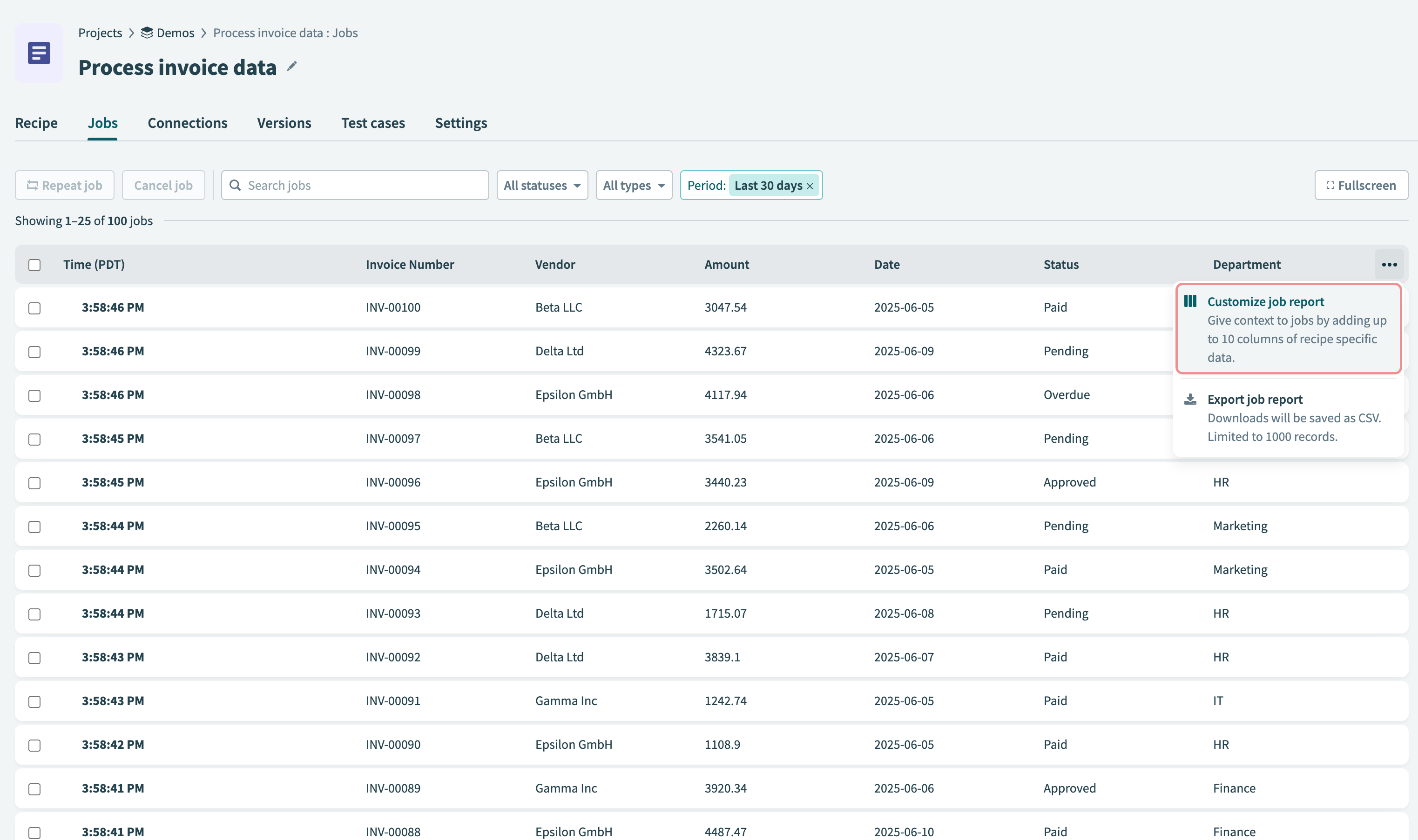

Click the ••• (ellipsis) in the table header row, then select Customize job report.
The job report table header with the ellipsis menu open, showing the Customize job report option.Customize job report button

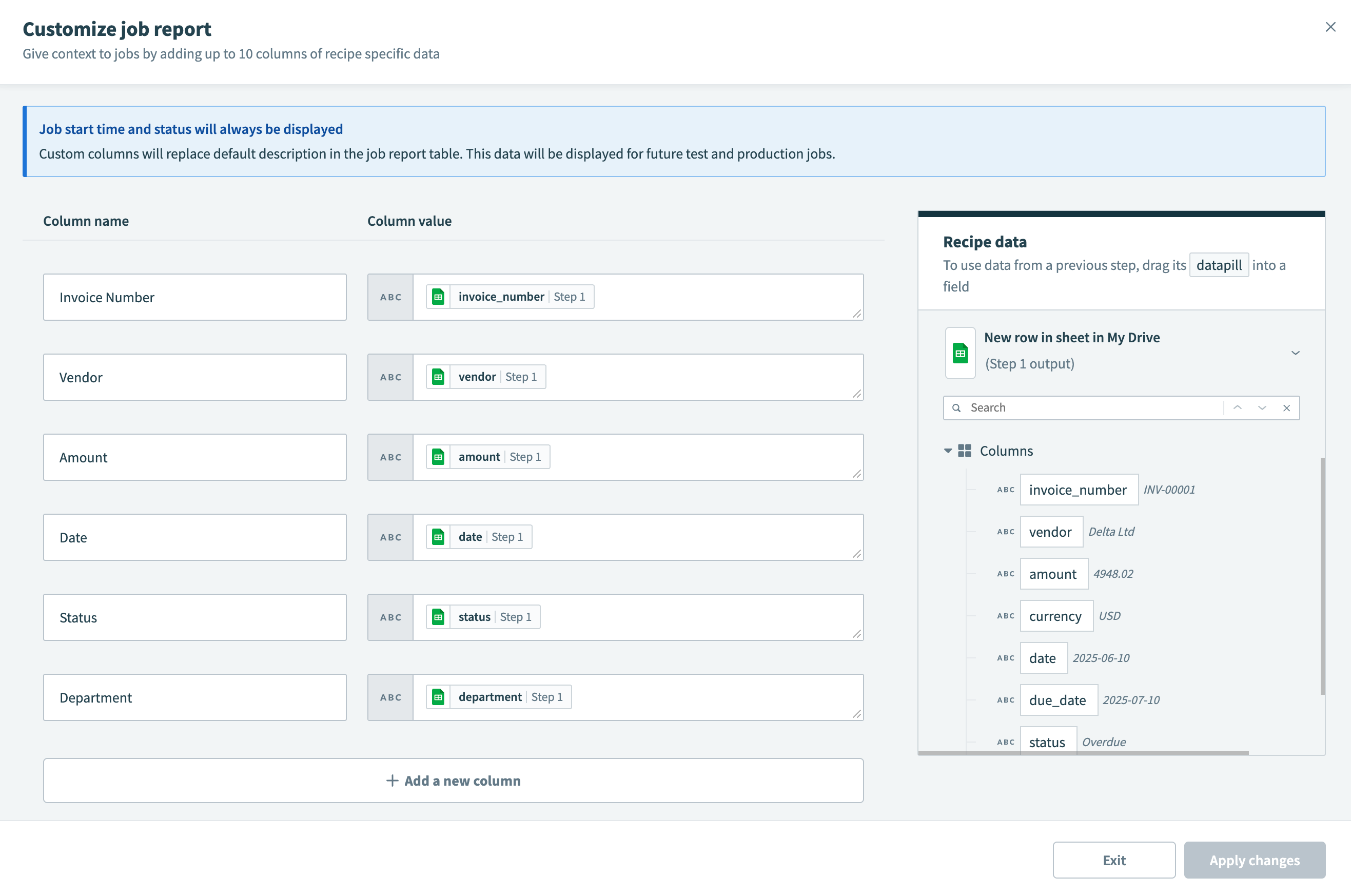

Use datapills from the recipe's steps to add columns to the report on the Customize job report page.
The Customize job report page with datapills mapped to report columns.Customize the job report

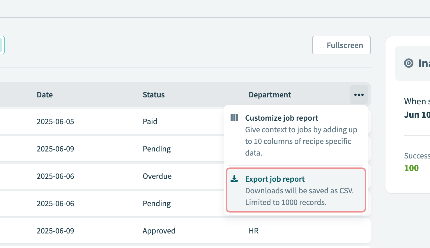

Export job reports to CSV files
You can export job reports to CSV files, which include the latest 1,000 rows based on the current filter settings.
Complete the following steps to export job reports:
Select a recipe and go to the Jobs tab.
Optional. Set filters on the job report table.
Click the ... (ellipsis) and select Export job report.
The job report table with the export menu open and the Export job report option selected.Export job reports to CSV file
