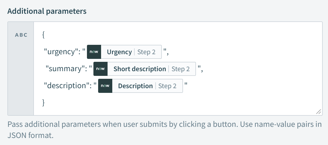

| Additional parameters |
Parameter values to be passed onto the next recipe when button is clicked, for example: Datapills must be enclosed within double quotes, and parameter names should be entirely lowercase. These parameters can be supplied by users. For example, you can supply parameters such as the urgency of an issue in ServiceNow, or specific recipe details like the Message ID from a previous Microsoft Teams message.
