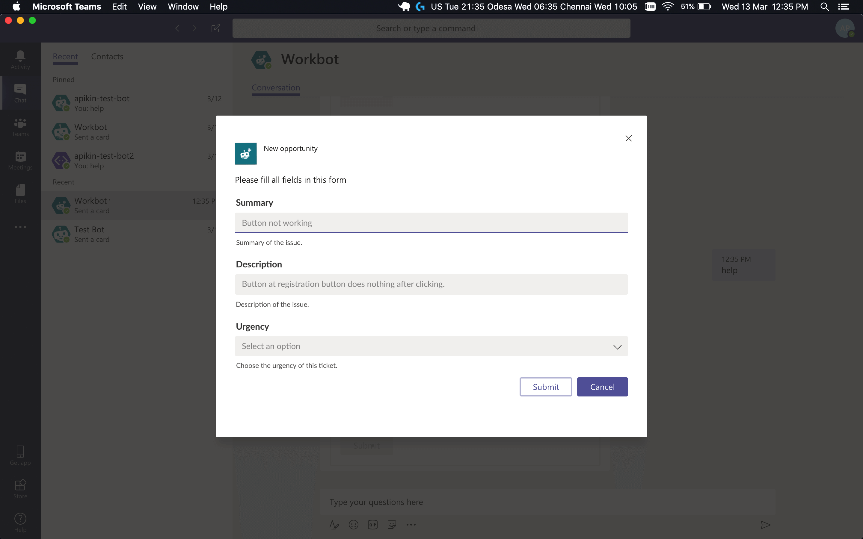

When you define parameters, Workbot opens a task module to collect each parameter's value from the user.

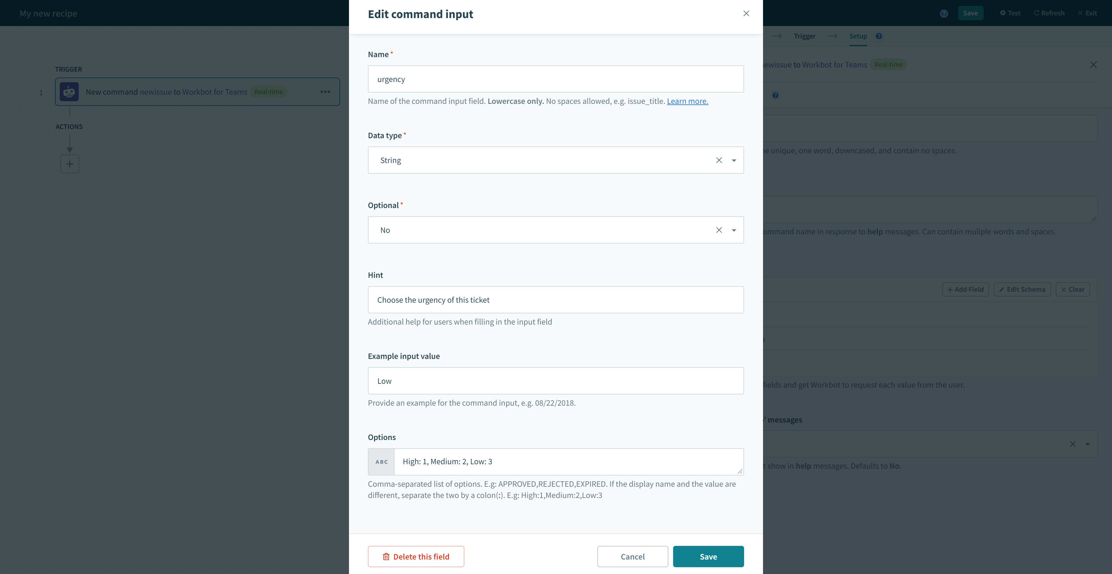

To add a parameter, select the +Add parameter button under the Parameters section of a Workbot command trigger.
Adding a new parameter
By configuring the parameter, you can control how the users interact with the parameter in the task module.
Configuring a parameter
The table below describes in further detail what each parameter configuration field does.
| Input field | Description |
| Name | Name of the parameter. This is the name you use to reference the parameter in:
| Data type | Data type of the parameter. Currently supports the following data types:
The data type will influence the input type presented to the user in a task modules. For example, if Date is chosen, a date picker will be presented to the user.The file parameter is only available for Enterprise Workbot. Learn more. |
| Optional? | If set to Yes, users can skip this input. If set to No, users are required to provide this input. |
| Hint | Hints are displayed just below the input field for users when filling in the input field. |
| Example input value | Displays a placeholder for the field in the task module. Useful in giving the user a sense of what the requested input should look like, as well as the desired format. |
| Visible? | If Yes, command will not show up in task modules. Useful if the parameter is a record ID that is not human-readable. Defaults to No. |
| Options | Comma-separated list of options, for example, APPROVED, REJECTED, EXPIRED. If the display name and the value are different, separate the two by a colon, for example, High:1,Medium:2,Low:3. |

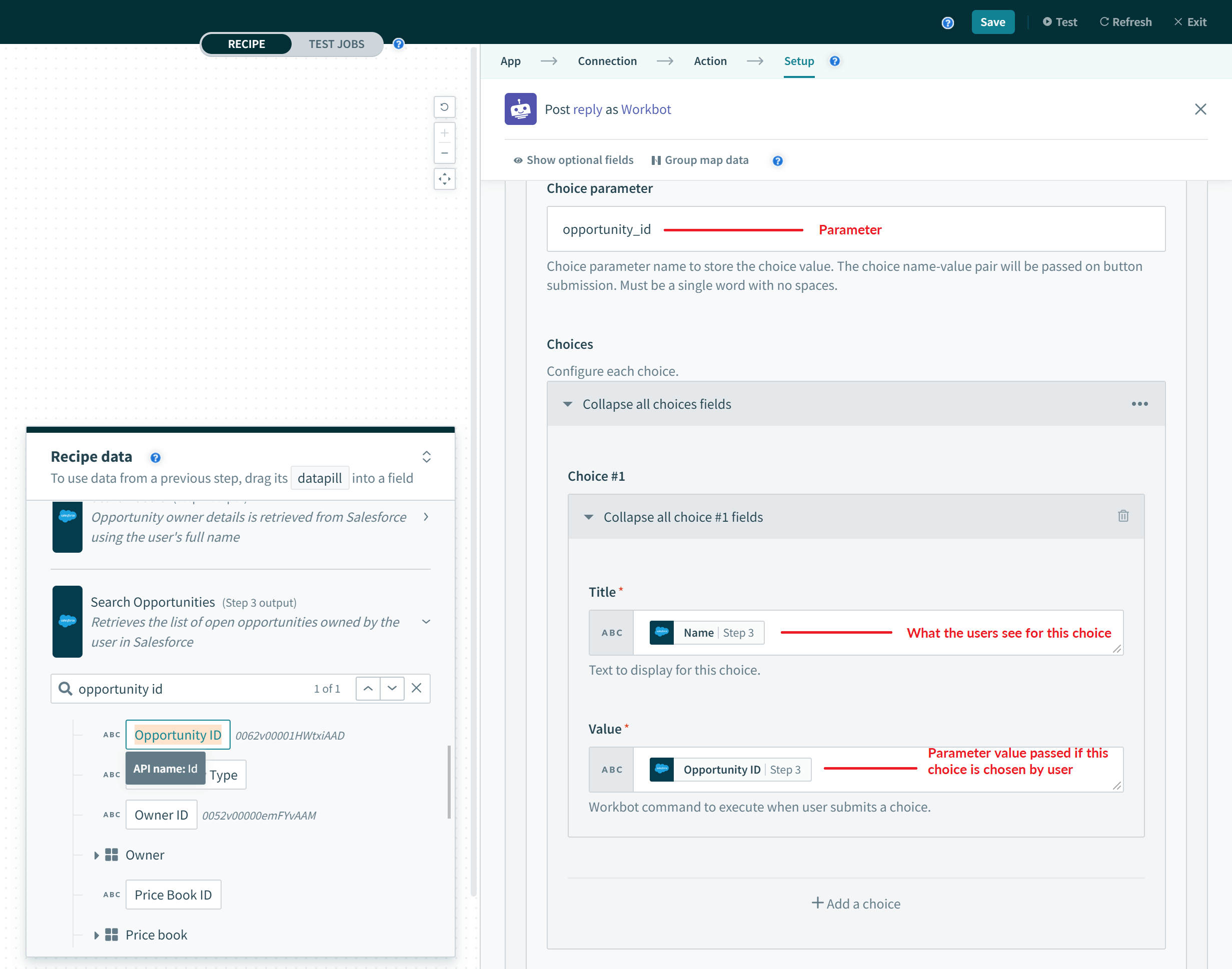

Another way to pass a parameter is by using a pick list Choice parameter.
The choice parameter will take its value from a choice (if it's chosen)
The choice parameter is passed when a button from the same message is submitted (along with any other parameters the button may have).
The 'Next' button also passes the 'opportunity_id' of 'Google' onto the command recipe that it invokes

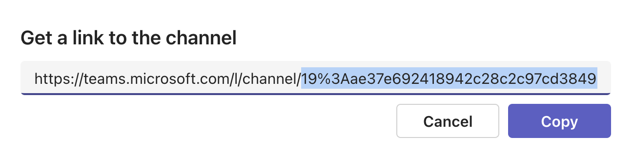

A channel ID corresponds to a specific channel in Microsoft Teams. You can use the channel ID to configure trigger conditions that filter events by channel and control which channels prompt a response from Workbot. This ensures Workbot's actions are relevant to the context of those channels.
Complete the following steps to obtain a channel ID from Microsoft Teams.
Go to the channel where you plan for Workbot to monitor messages.
Click the ... (ellipsis) on the right of the channel name.
Click Get link to channel.
Copy the channel ID from the modal. The modal displays the entire link to the channel. The channel ID is included in this link as a path parameter following the channel path segment.
Copy the channel ID
In the following example, everything between channel/ and /%5BDocs is the channel ID.
https://teams.microsoft.com/l/channel/19%3Aae37e692418942c28c2c97cd38493cf5%40thread.tacv2/%5BDocs%5D%20Test?groupId=55563081-256e-4922-8f4e-e2a760294320&tenantId=76a89289-583c-40a2-9709-e076eed5d680Decode the channel ID. You can use a tool such as Dupli Checker or a similar tool for this purpose.
For example, the following string should change from this:
19%3Aae37e692418942c28c2c97cd38493cf5%40thread.tacv2To this:
Split the resulting string to remove the metadata from the channel ID. The metadata include the @ symbol and everything after it.
For example, the string:
Should be split to:
19:ae37e692418942c28c2c97cd38493cf5The result is the channel ID you can use to configure the trigger condition.

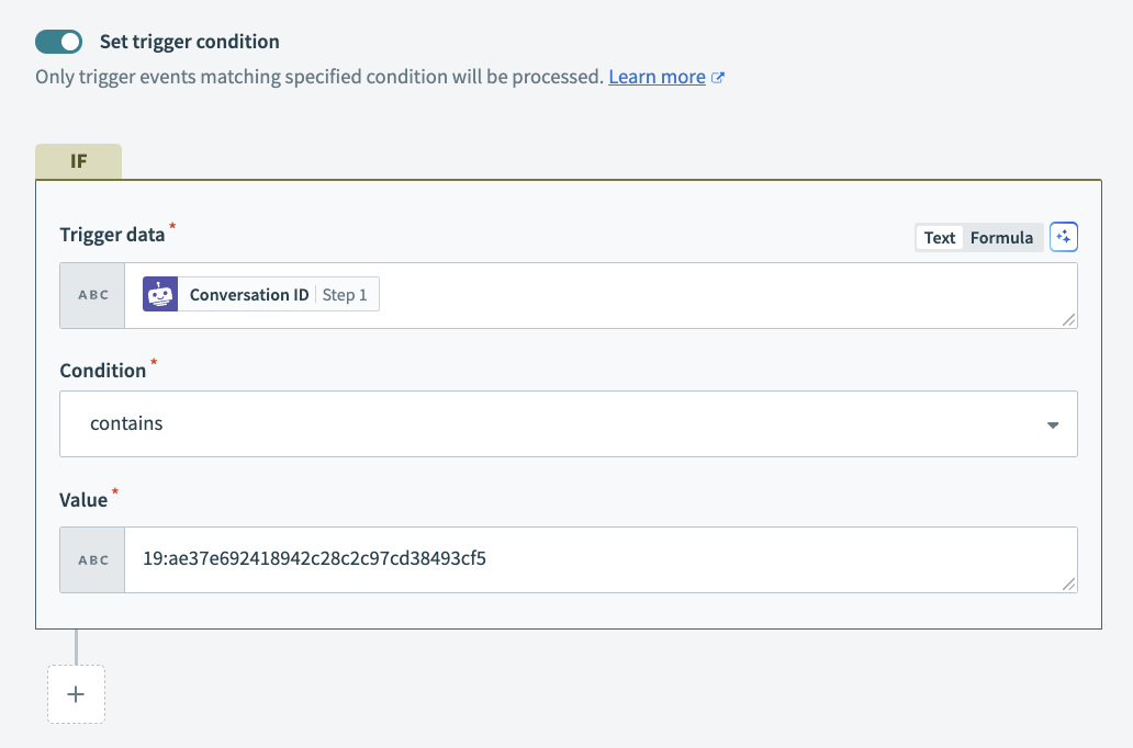

Configure an IF condition to control where Workbot can post messages
