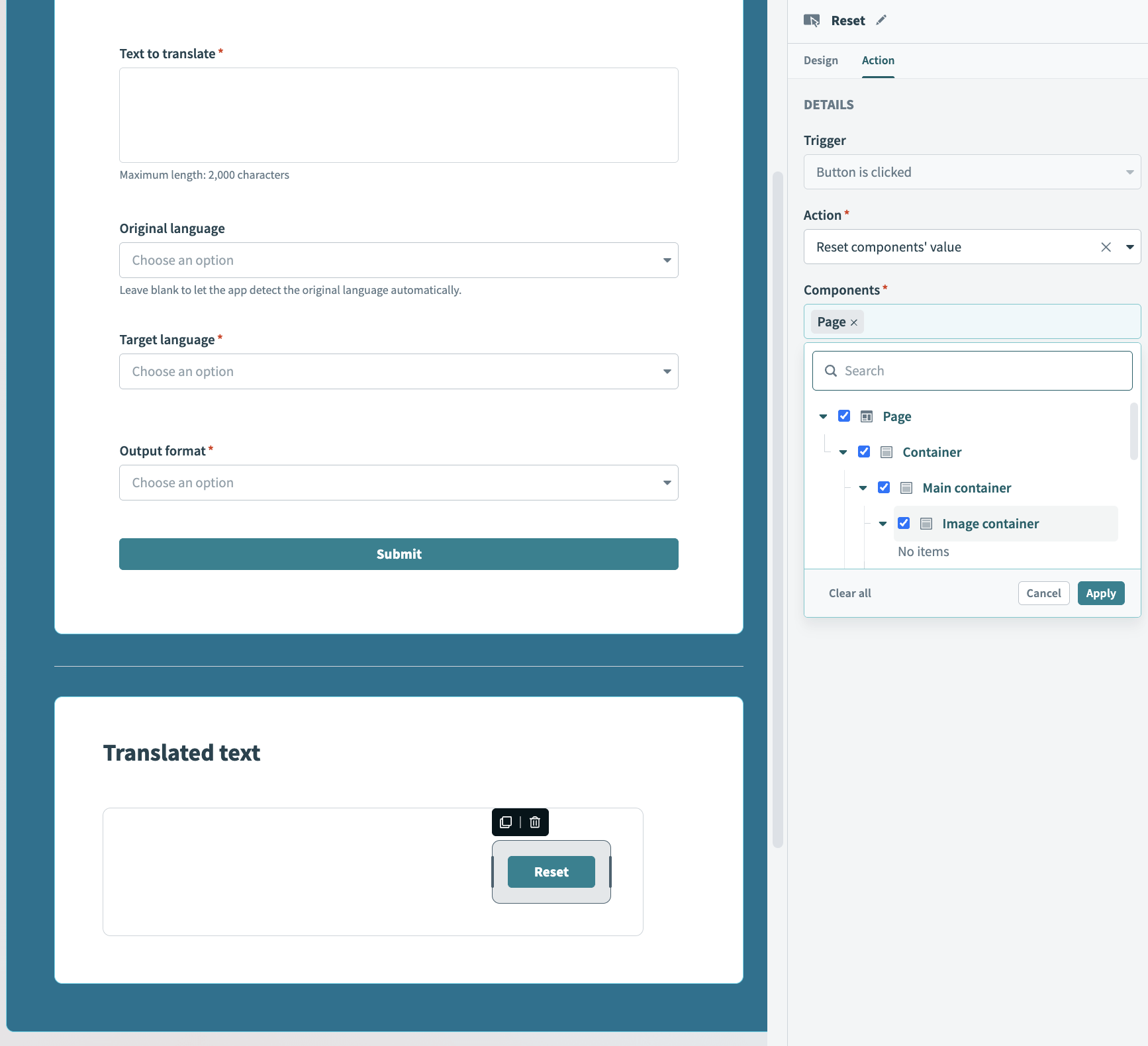

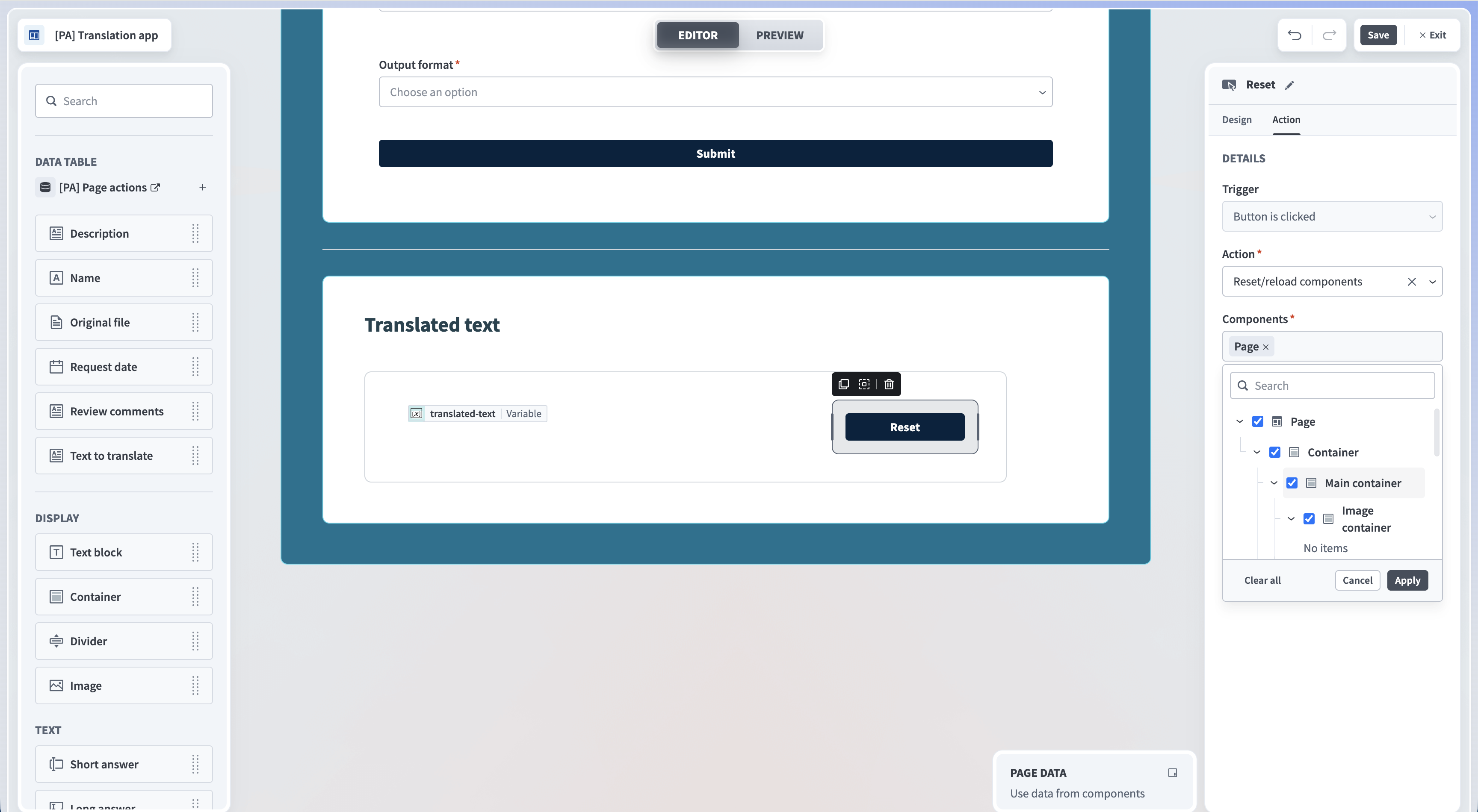

Go to the Page components panel and select a button component. Drag and drop it onto your page.
Go to the Component properties panel > Design and type Reset in the Label field.
Click the Action tab.
Go to the Action menu and select Reset components’ value.
Go to the Components field and select the component values you plan to clear, for example, Page.
Your configuration should look as follows:
Reset button configurationReset button configuration

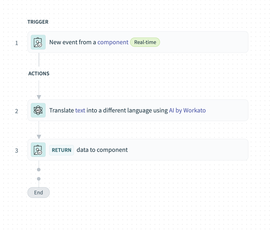

Workato generates a recipe pre-configured with the New component event (real-time) trigger and the Return data to component action:
Recipe outlineRecipe outline

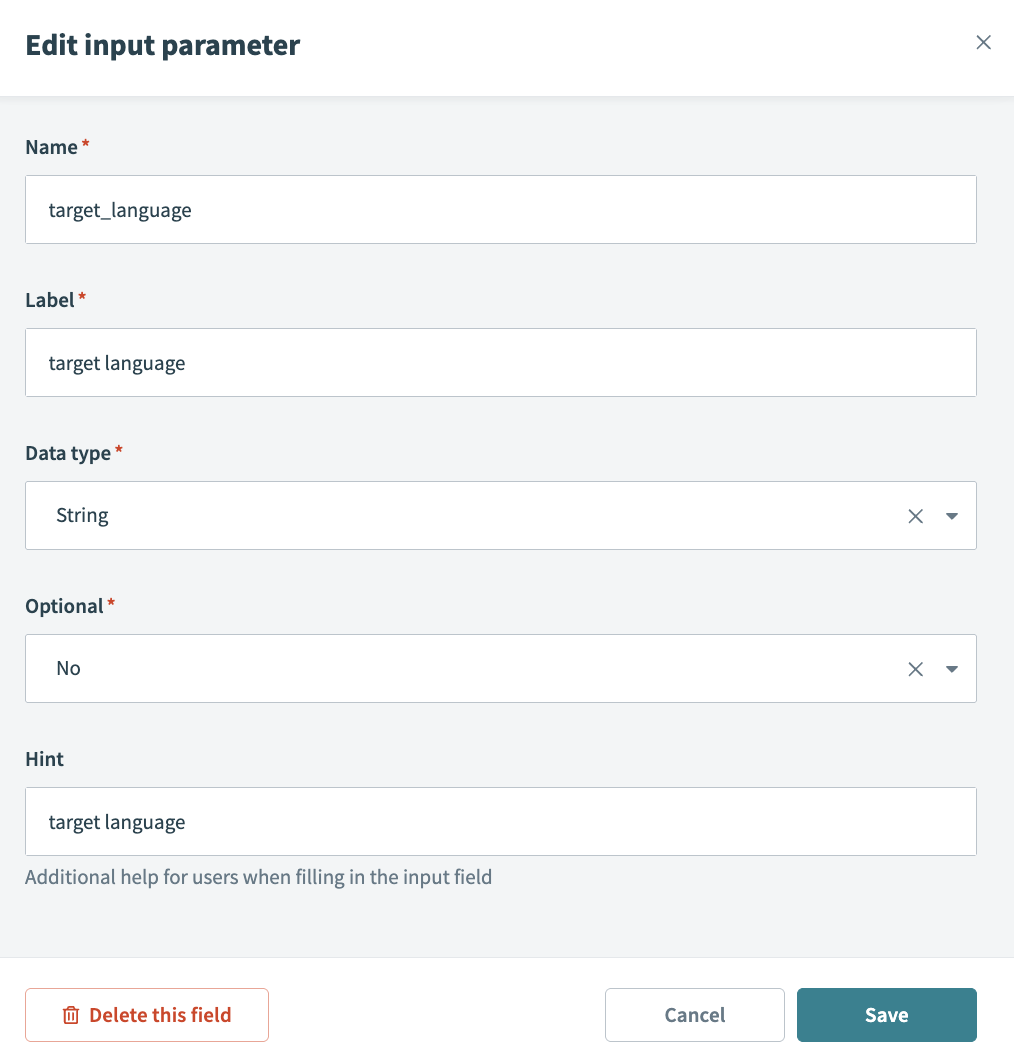

Go to Input parameters and click + Add field.
Go to the Name field and provide a unique name for this parameter.
Go to the Label field and provide a unique name for this parameter, such as target language.
Go to the Data type field and select String.
Go to the Optional field and select Yes or No. When No, users must provide input for this parameter in the corresponding Workflow apps field.
Optional. Go to the Hint field and provide a hint to help users fill out this field.
Input parameter configurationInput parameter configuration

Add additional recipe steps

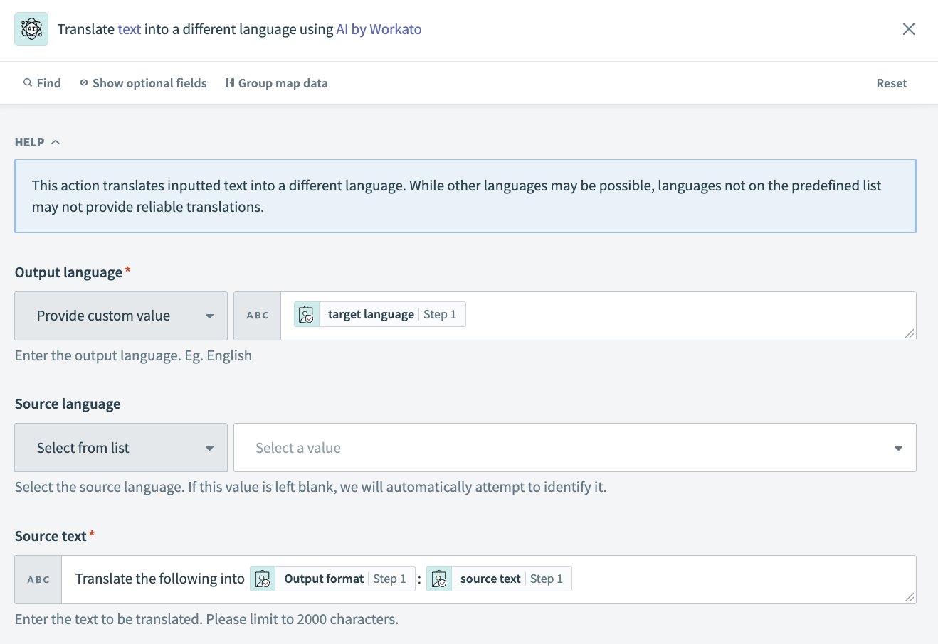

Add an additional recipe step to get data from other applications and return it to your app. This step uses AI by Workato to translate text.
Click Step 2.
Search for and select AI by Workato as your app.
Select the Translate text action.
Go to the Output language field and map in the Target languageStep 1 datapill.
Go to the Source text field, type Translate the following into, and map in the Output formatStep 1 and Source TextStep 1 datapills.
Datapill mappingDatapill mapping

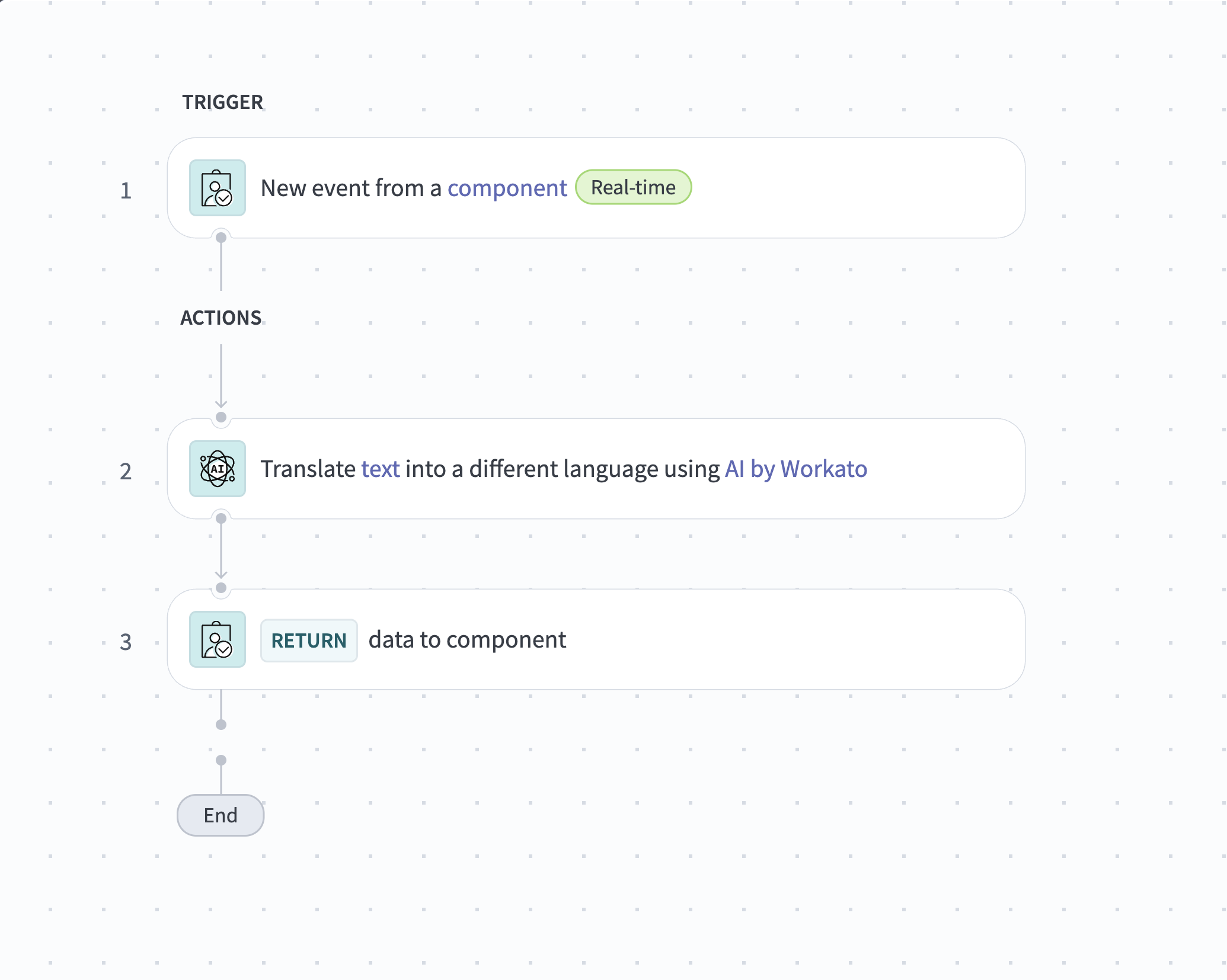

Click Save and Exit.
Click Start recipe.
Your completed recipe should look as follows:
Completed recipeCompleted recipe

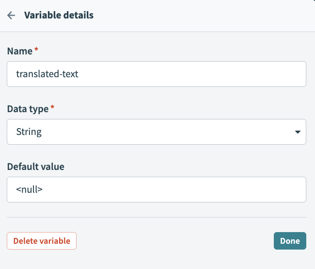

Create a page variable
Click the page canvas.
Go to Properties panel > Design.
Click + Add variable.
Go to the Name field and type a unique name for your variable, such as translated text.
Optional. Provide a default value for your variable, such as <null>.
Click Done.
Create a variableCreate a variable

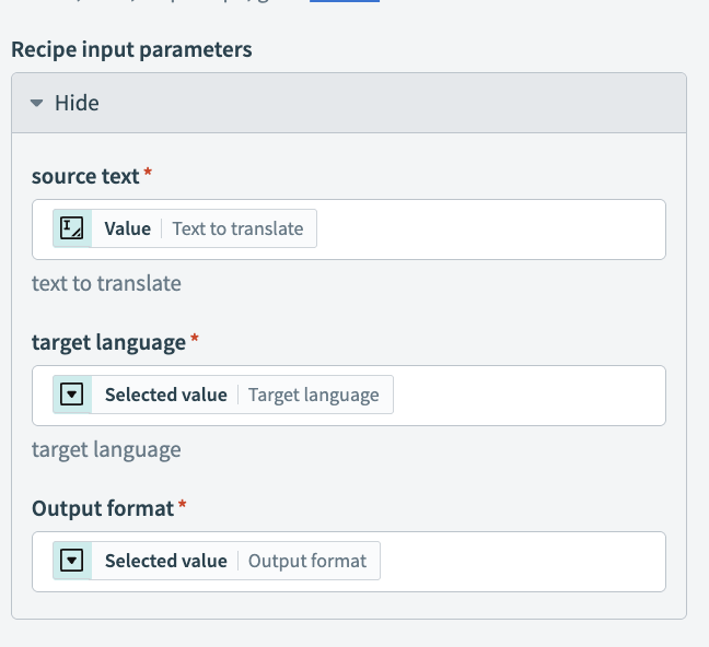

Click the Submit button to select it and go to the Component properties panel.
Go to the source text field and map in the ValueText to translate datapill.
Go to the Target language field and map in the Selected valueTarget language datapill.
Go to the Output format field and map in the Selected valueOutput format datapill.
Map in input parametersMap in input parameters

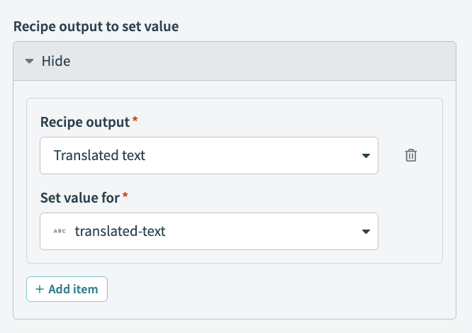

This variable is used to return the translated text to your app.
Go to the Recipe output to set value > Recipe output field and select translated-text. This is the output field you defined in your recipe.
Go to the Set value for field and select the translated-text variable.
Use recipe output to set variable valuesUse recipe output to set variable values

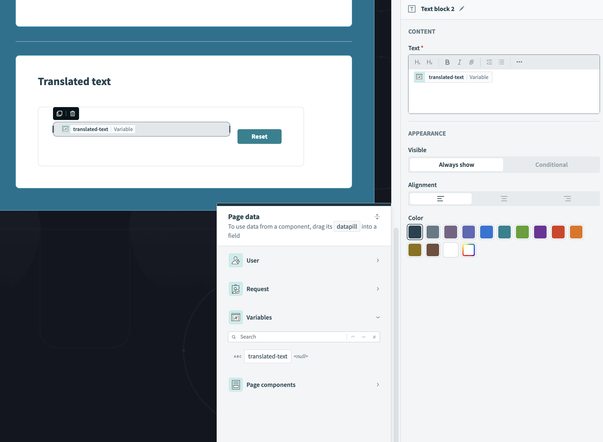

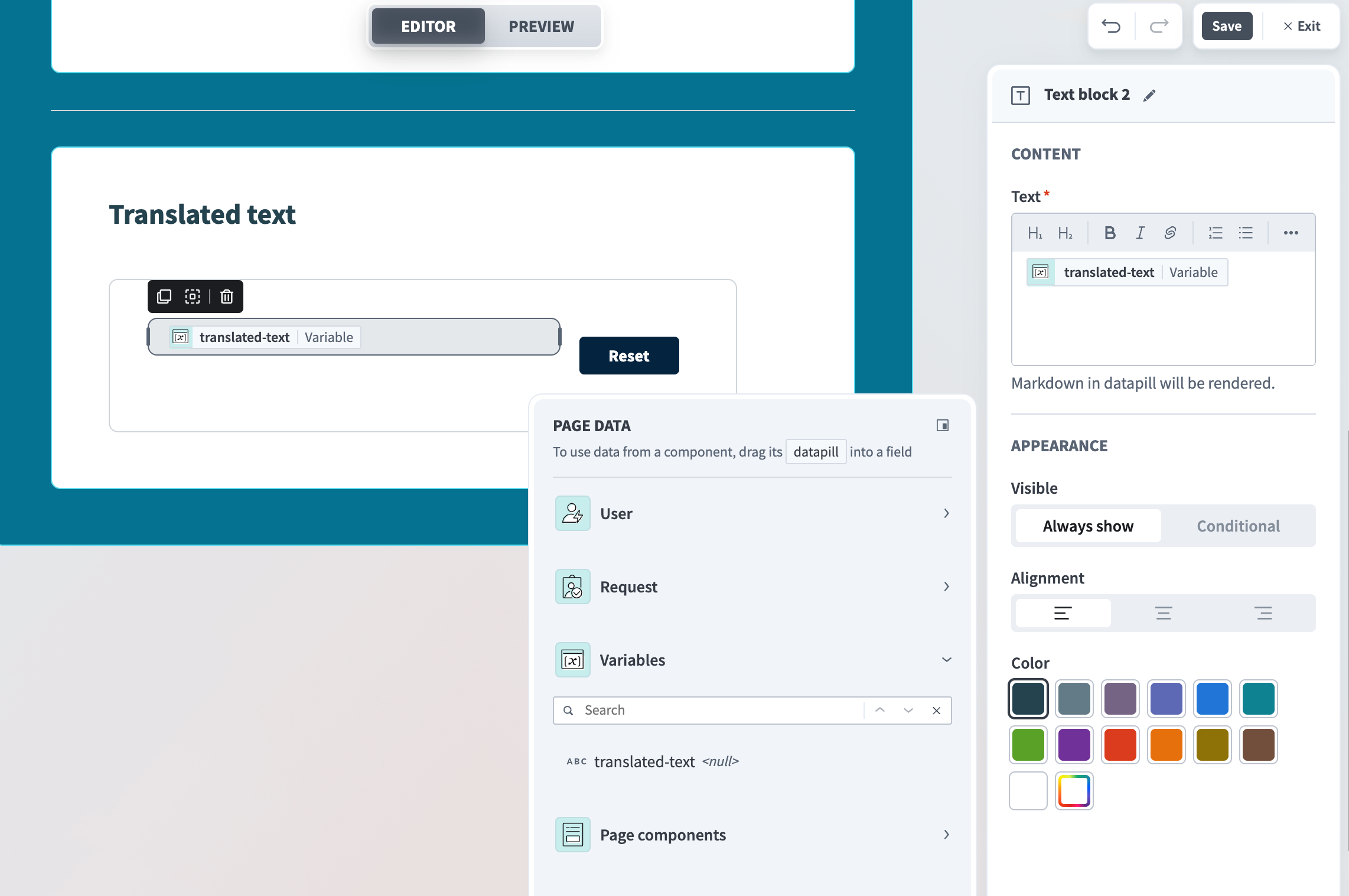

Map your variable into a component
This variable will contain the translated text.
Go to the Translated text container.
Select the Text component.
Go to the Properties panel > Text.
Map in the Translated-text datapill from the Page data module.
Variable configurationVariable configuration
