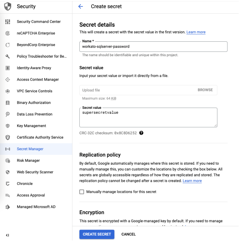

Click + CREATE SECRET
Create secret
Assign a name to the secret; this name is used in your OPA config file to look up the correct password. In this example, the name is workato-sqlserver-password.
Secret created

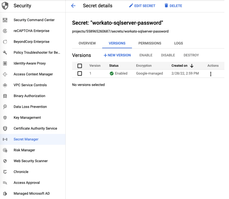

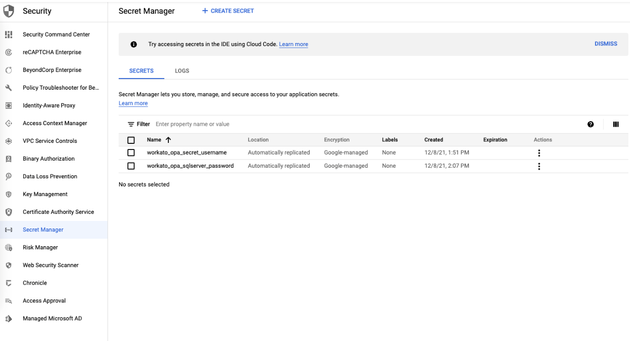

After creating the secret, note the project, secret name, and version. Use these to format the Secret Version and place it inside the OPA.
In this example:
  • the project is 558965260687,
  • secret name is workato-sqlserver-password,
  • version is 1.
That means that the composite value used in the OPA config file is projects/558965260687/secrets/workato-sqlserver-password/versions/1

Using latest version for secret
projects/558965260687/secrets/workato-sqlserver-password/versions/latest can also be used to reference the latest version of the secret.
