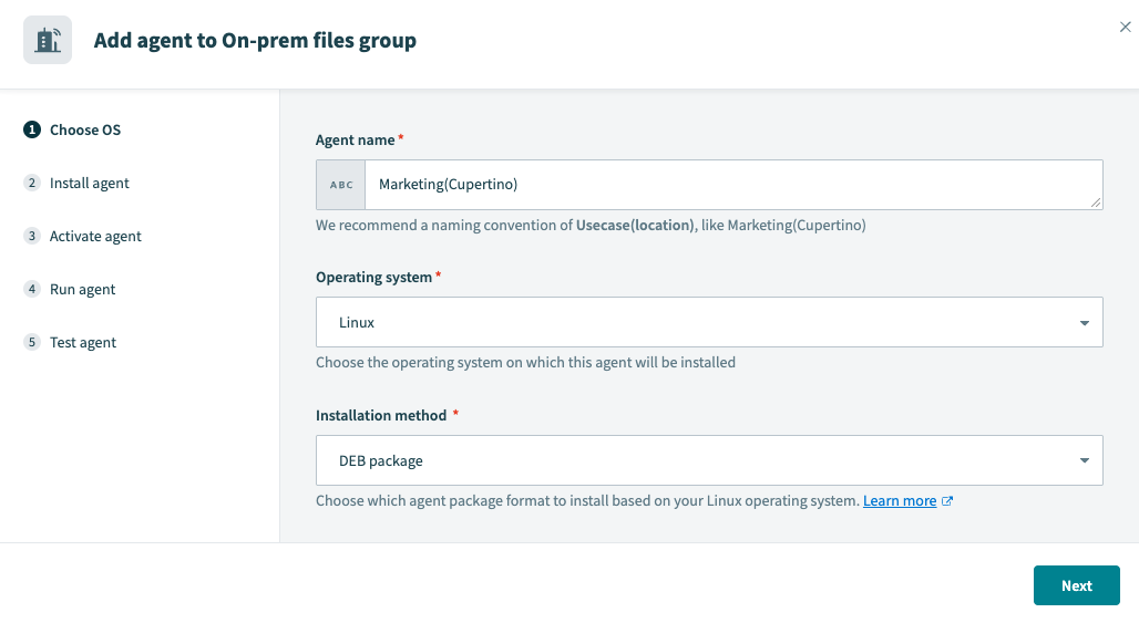

Provide an Agent name, use the Operating system drop-down menu to select Linux, and use the Installation method drop-down menu to select DEB package.
Choose OS

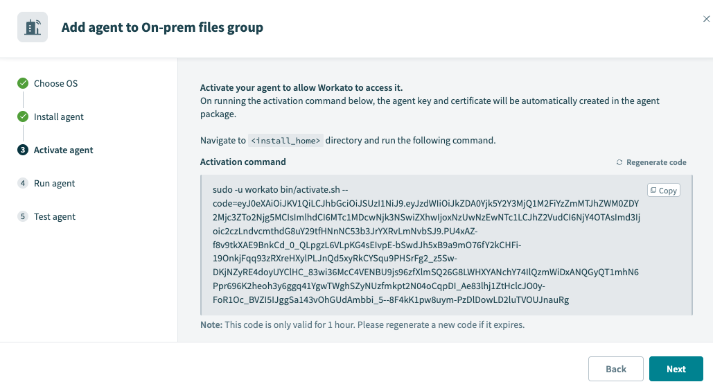

Copy the command provided by the wizard and run it in the directory where the agent is installed. This automatically creates the agent key and certificate in the agent package. We strongly recommend you run this command as the workato system user to avoid permission errors. Refer to the On-prem setup & installation issues guide for more information.
The activation code is valid for one hour. Click Regenerate code to generate a new code if it expires.
Activate

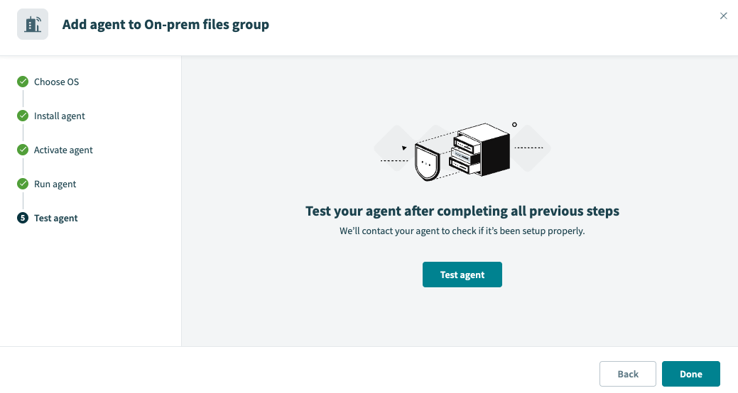

Click Test agent to confirm that your on-prem agent is working as expected.
Click Test agent
Click Done to complete the setup.
