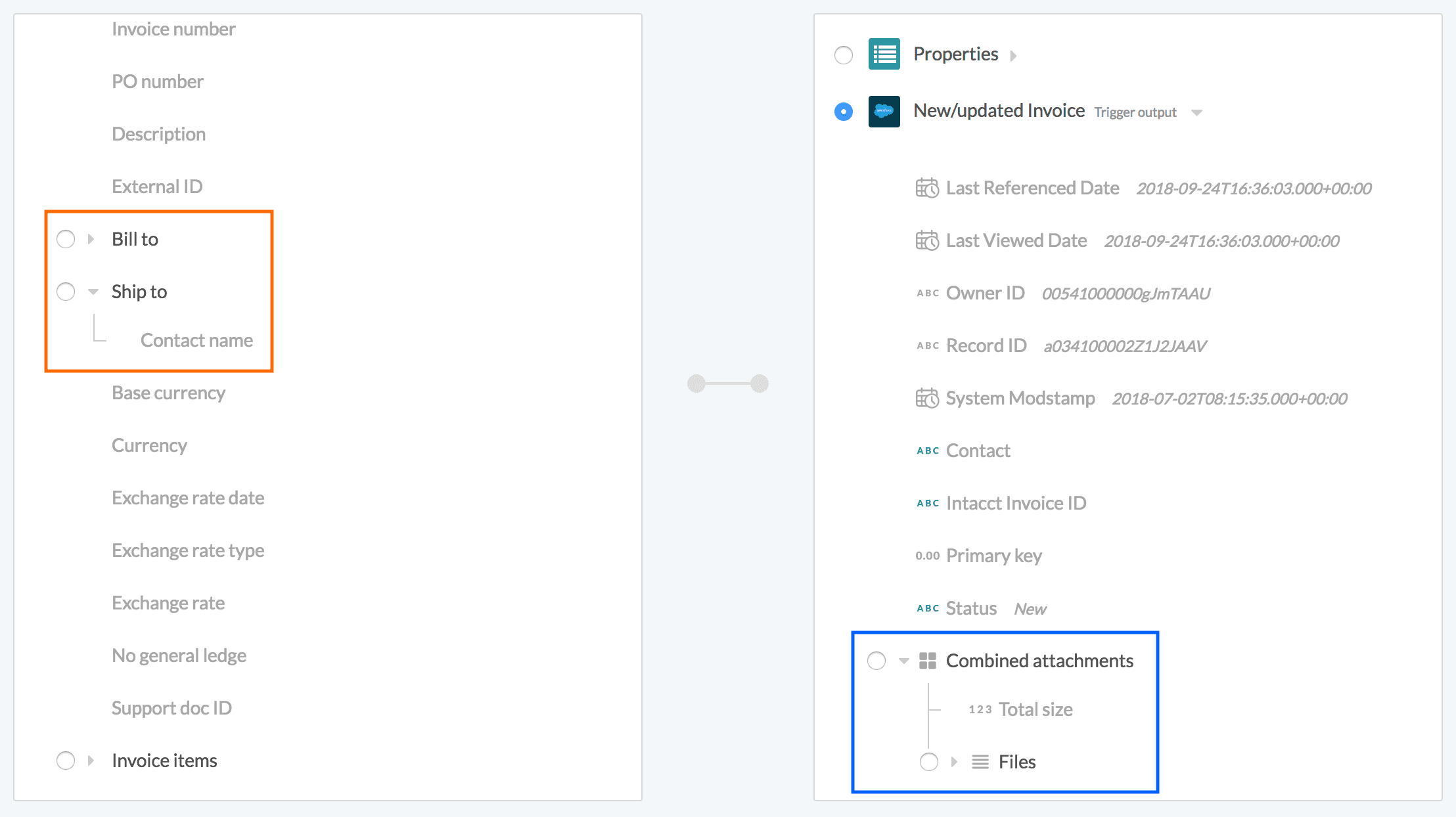

# Select the field group and data source
The group mapping wizard displays the fields and field groups available for mapping and the available data sources. These data sources are similar to the app data you use in recipe building.
Field groups are fields that appear as nested fields in the recipe UI, and follow the object structure you have in your application. You may select either all fields in a step (including nested fields) or a specific field group. The following image uses the nested fields Bill to and Ship to:
An example of fields and field groups within an action
Select the fields you plan to map.
Select the data source for the datapills from your Environment properties, including the trigger and all preceding recipe steps. You can map from either the output of an entire step or a nested array within it.
Review the wizard to confirm that display options match your selections and then click Next.

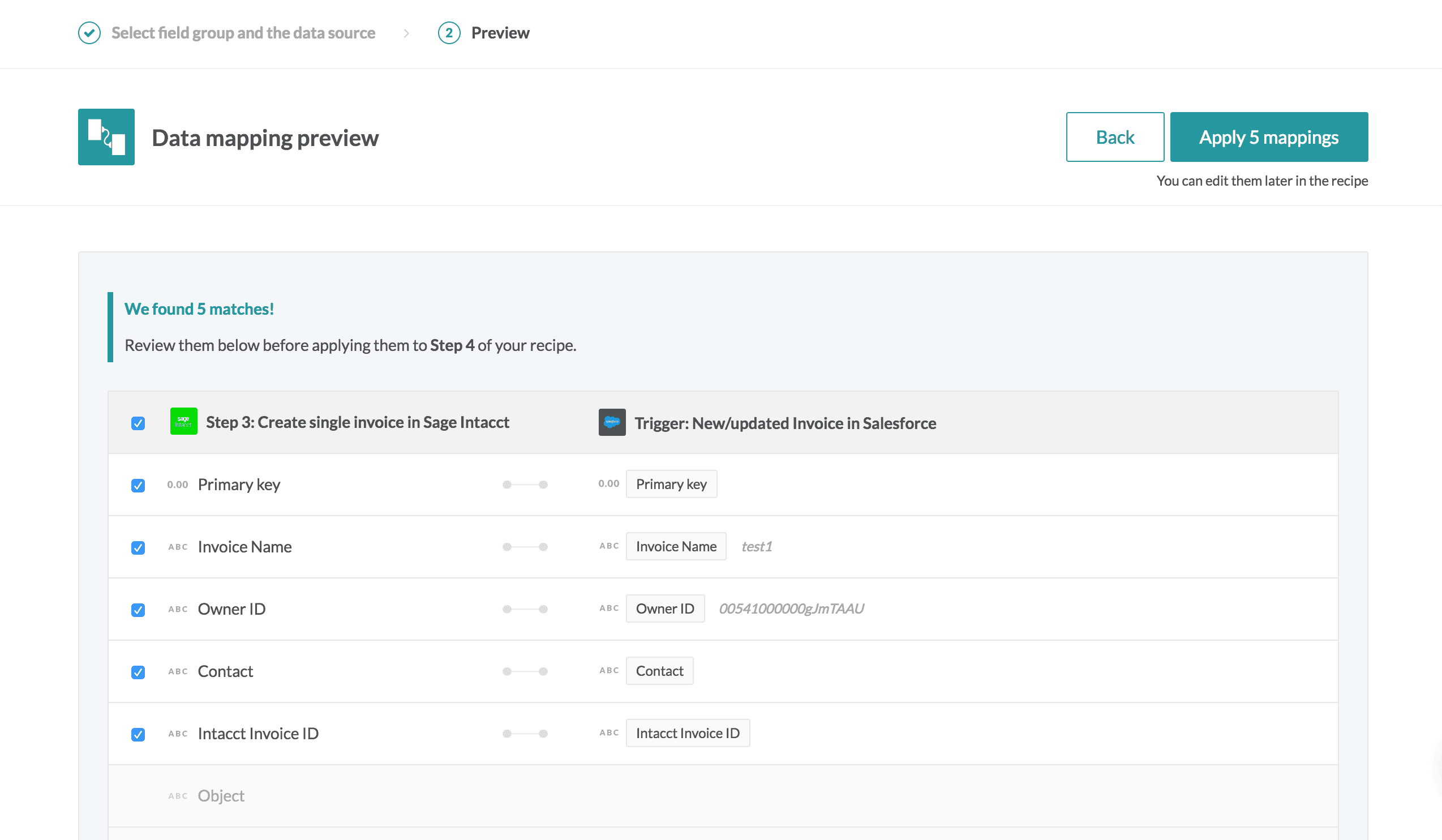

# Data mapping preview
The second screen in the wizard displays fields successfully matched with datapills sharing the same name and data type. Complete the following steps to apply these mappings:
Review the field and datapill mappings to ensure the selections are correct.
Select the checkboxes for the fields you plan to map. You can deselect fields that you don't plan to map.
Click the Apply mappings button to map the datapills to the fields you selected. You can edit these mappings in the recipe.
