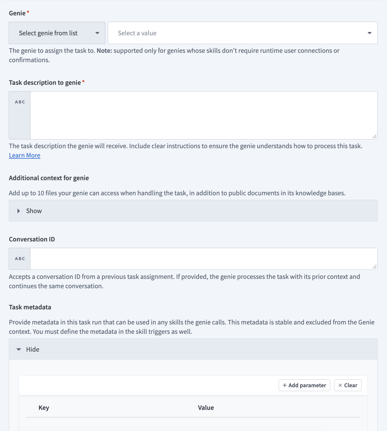

You can use the Assign task to genie action to assign a task to a genie. This enables your genie to trigger a recipe autonomously, perform the assigned task, and return a response.
Complete the following steps to configure the Assign task to genie action:

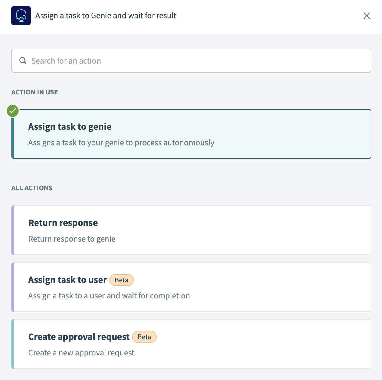

Go to the skill where you plan to assign a task to a genie.
Click the Select an app and action step in the recipe.

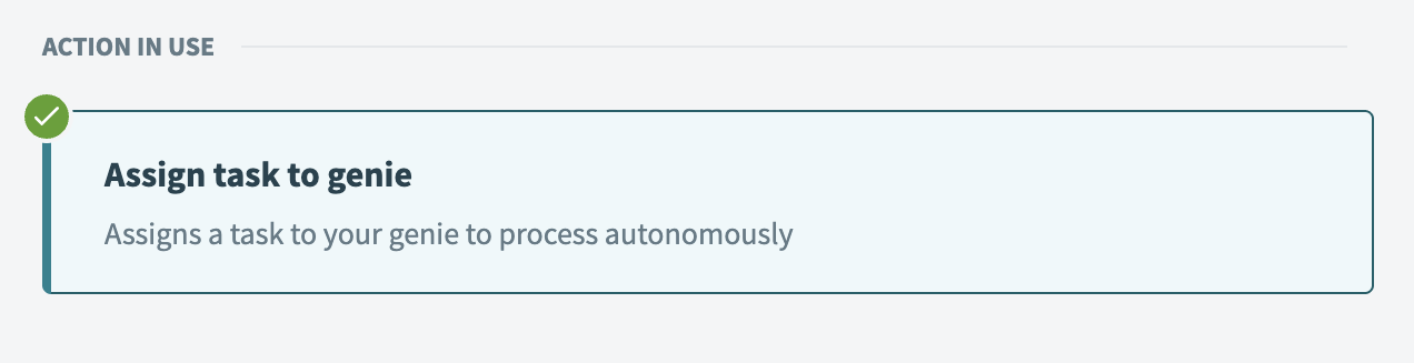

Search for and select Workato Genie.
Select the Assign task to genie action.
Use the Genie drop-down menu to select the genie you plan to use.
Set up the Assign task to genie action
Enter detailed instructions in the Task description to genie field. Write clear, self-contained tasks to ensure your genie handles them correctly. Include all required data.

</data>Optional. Expand the Additional context for genie section and provide up to ten files as context for the task.
Optional. Provide the conversation ID in the Conversation ID field to pass context from a previous task. This allows a task to build on the earlier conversation.

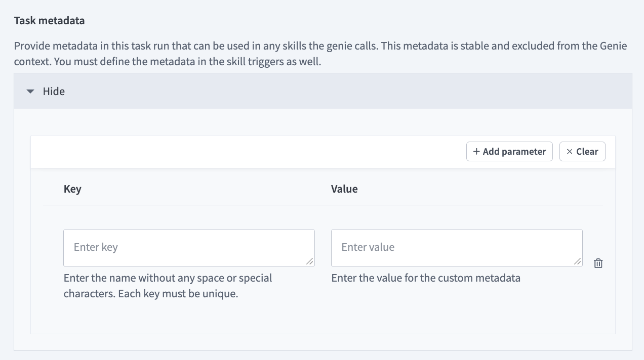

Optional. Expand the Task metadata section and click Add parameter to provide custom key and value pairs for your metadata, such as invoice_id for an invoice processing genie or user_email for an IT reset password genie. Any skill your genie uses can access the metadata you add here.
METADATA MUST BE CONFIGURED IN SKILL TRIGGER
You must define matching metadata in your skill trigger for the skill to access the metadata.
Define custom metadata
Optional. Go to the Configure genie output for usage in this recipe section and provide custom output fields to enable your genie to respond with a structured output rather than a plain text response. This allows you to use the output datapills in downstream steps in your recipe.
Click Save.
