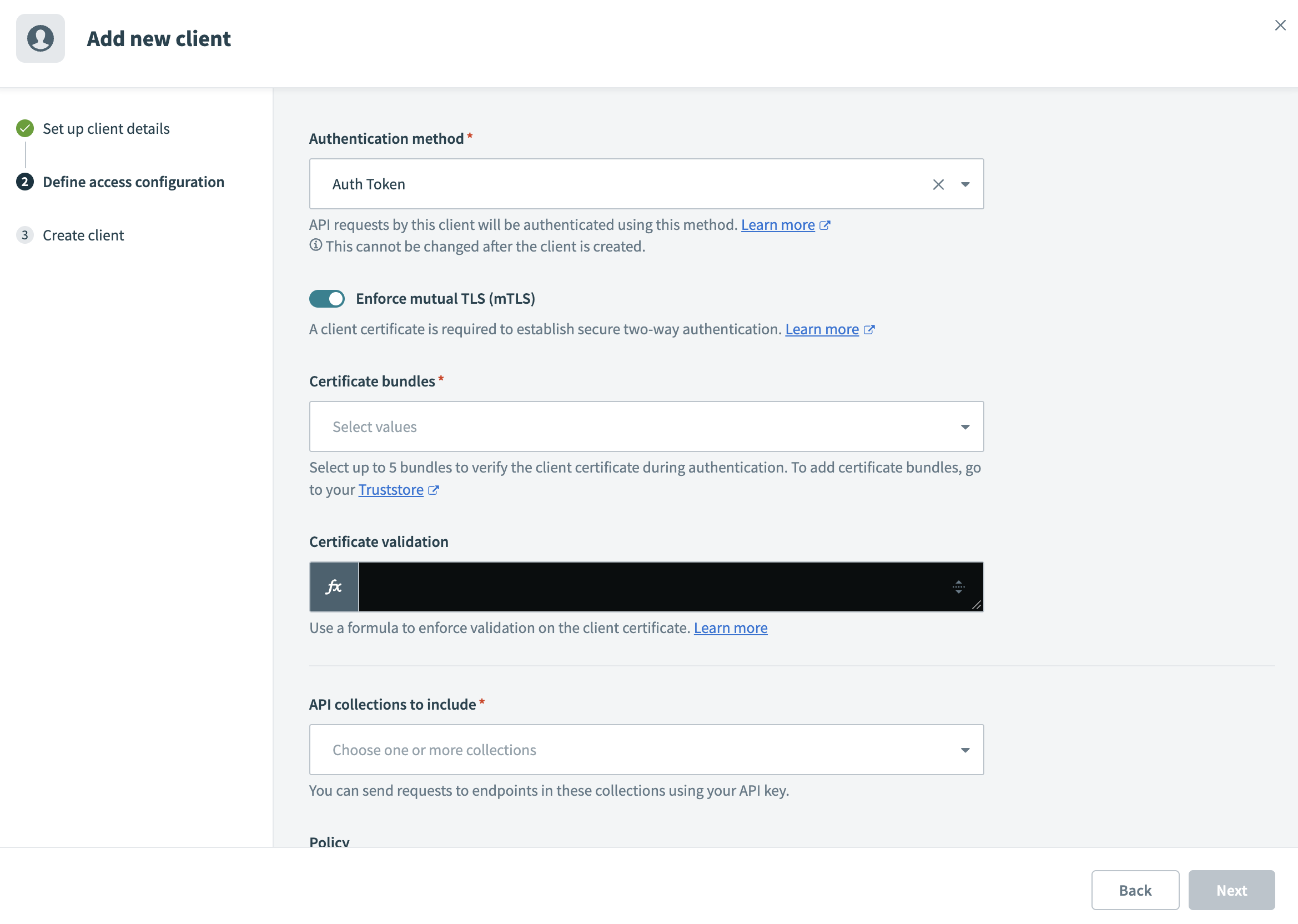

Complete the following steps to enable mTLS enforcement for an API client. This requires each request to present a valid client certificate:
Go to API platform > Clients, then click + Add new client.
Enter client details such as the Name and Description. You can optionally upload a Client logo and enable Grant client access to portal.
Click Next.
Choose an Authentication method for the client.
Toggle Enforce mutual TLS (mTLS).
Edit Mutual TLSEdit Mutual TLS
Select up to 5 Certificate bundles from your Truststore. Workato uses these bundles to validate client certificates against trusted certificate authorities.
Add Certificate validation rules. Refer to the Add certificate validation rules section for more information.
Configure the remaining access settings, such as API collections to include and optional policies.
Click Next to complete the client creation.
Workato checks both the access token and the client certificate for each request. It uses the selected bundles to build trust chains during certificate validation.
