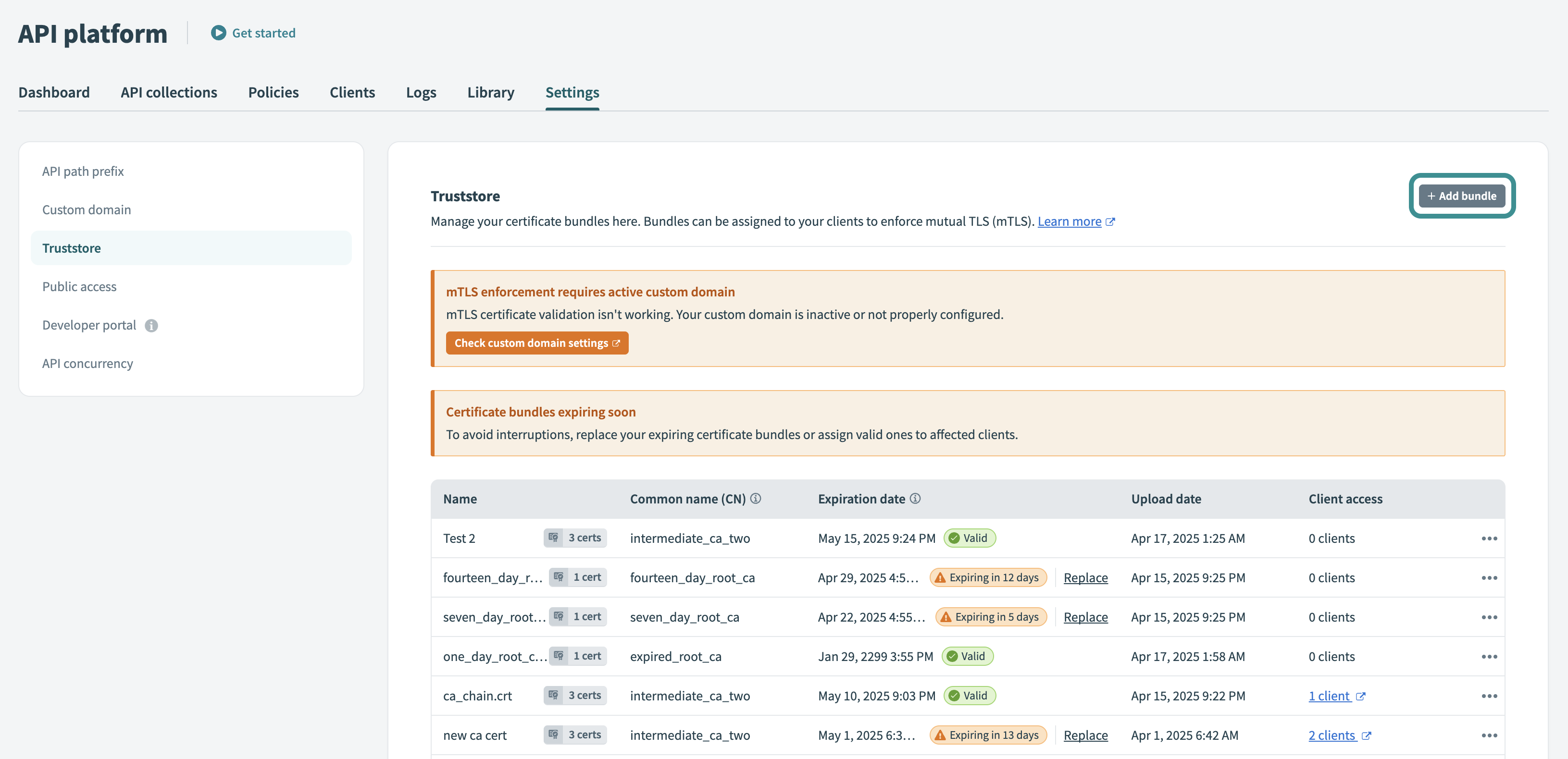

Click Add bundle.

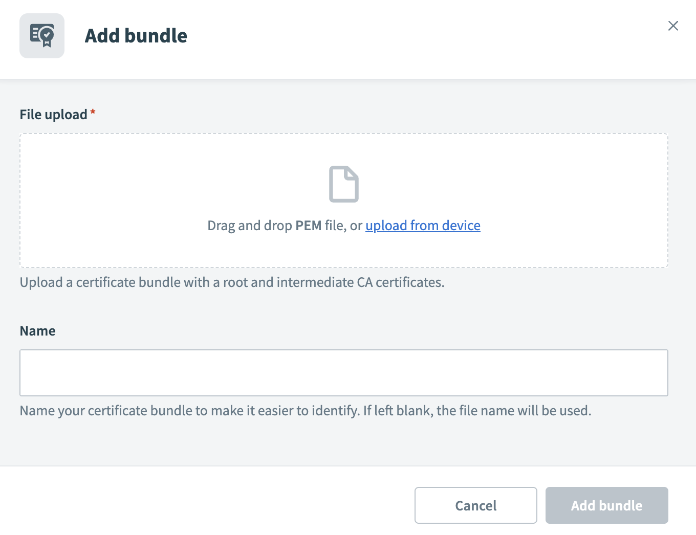

Add certificate bundle
Upload a valid .pem file that includes a root and intermediate CA certificates.
Enter a Name to identify your bundle. Workato uses the file name as the bundle name if left blank.
Click Add bundle.

Confirm that the bundle appears in the Truststore with one of the following statuses:
- Valid: All certificates are valid.
- Expiring soon: One or more certificates expire within 14 days.
- Expired: One or more certificates have expired.

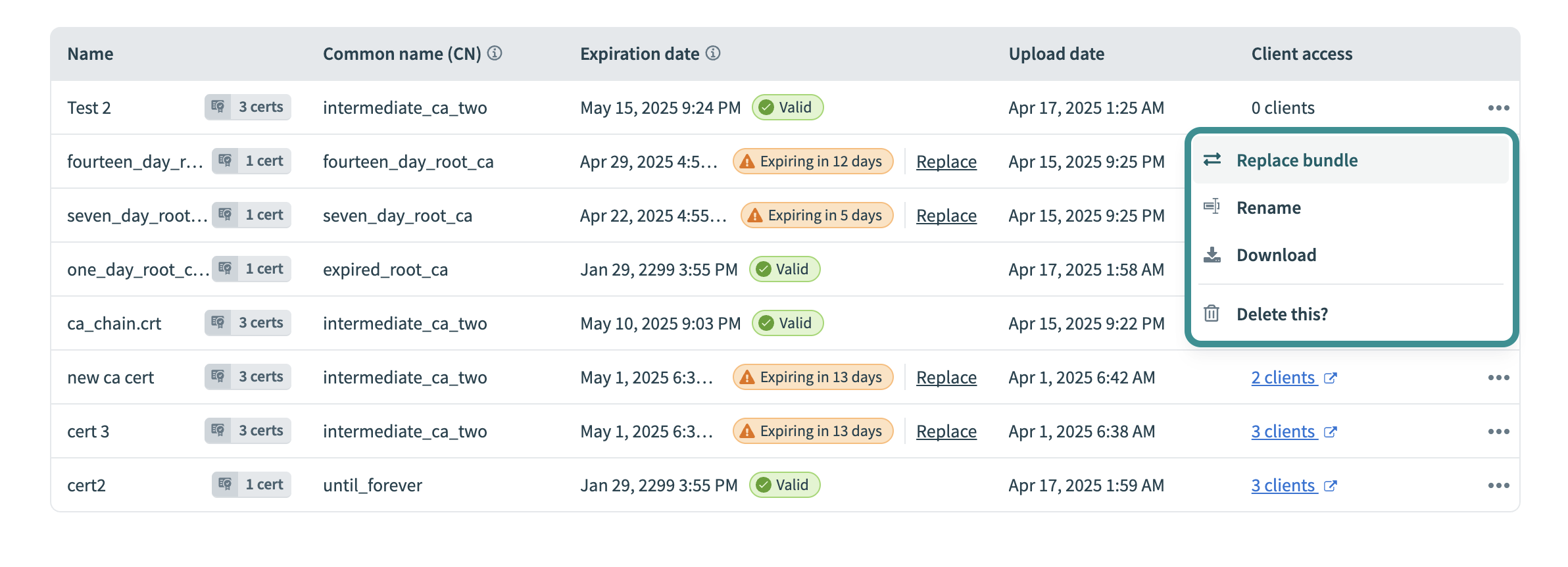

Use the ••• (ellipsis) menu in the Truststore to manage certificate bundles. You can Rename a bundle, Download it, replace it with a new PEM file, or delete it if it's no longer in use.
Manage certificate bundles
When you replace a bundle, Workato updates all clients that use it. The new certificates take effect immediately without downtime.

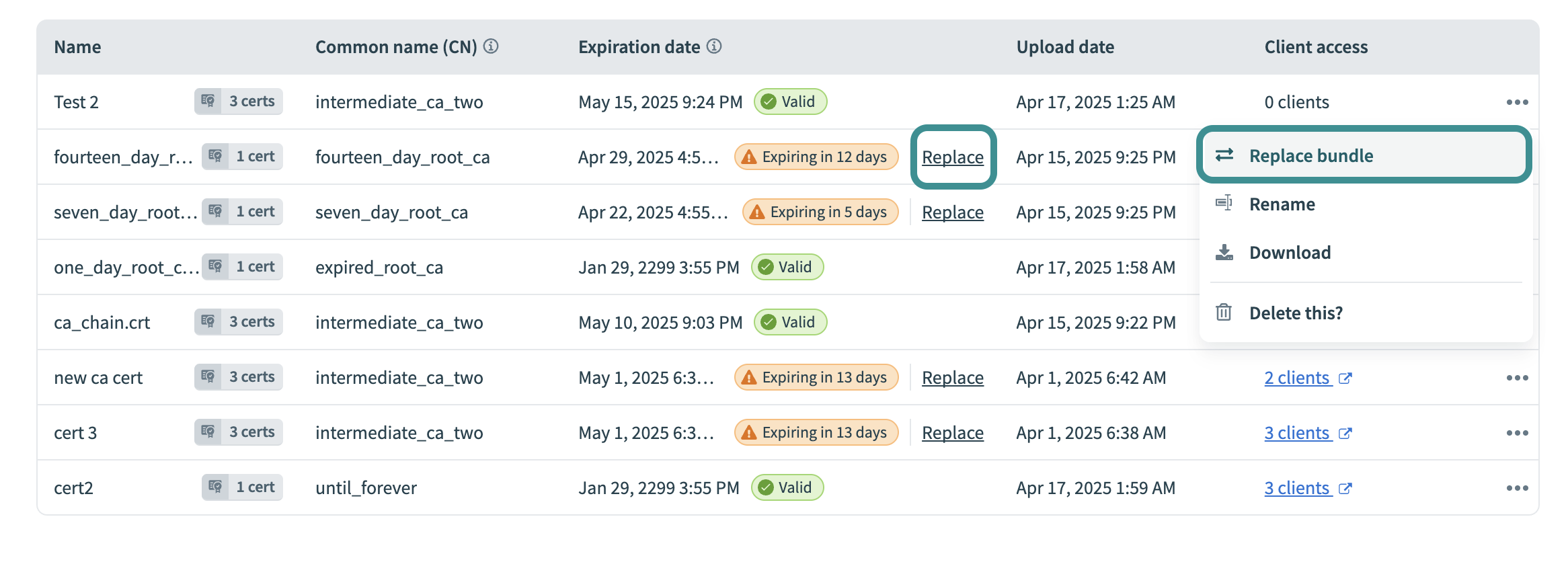

Workato displays a warning if a bundle expires within 14 days or within 24 hours. Replace the bundle before it expires to avoid mTLS handshake failures.
Locate the expiring bundle in the Truststore.
Click Replace next to the expiration badge, or click ••• (ellipses) and select Replace bundle.

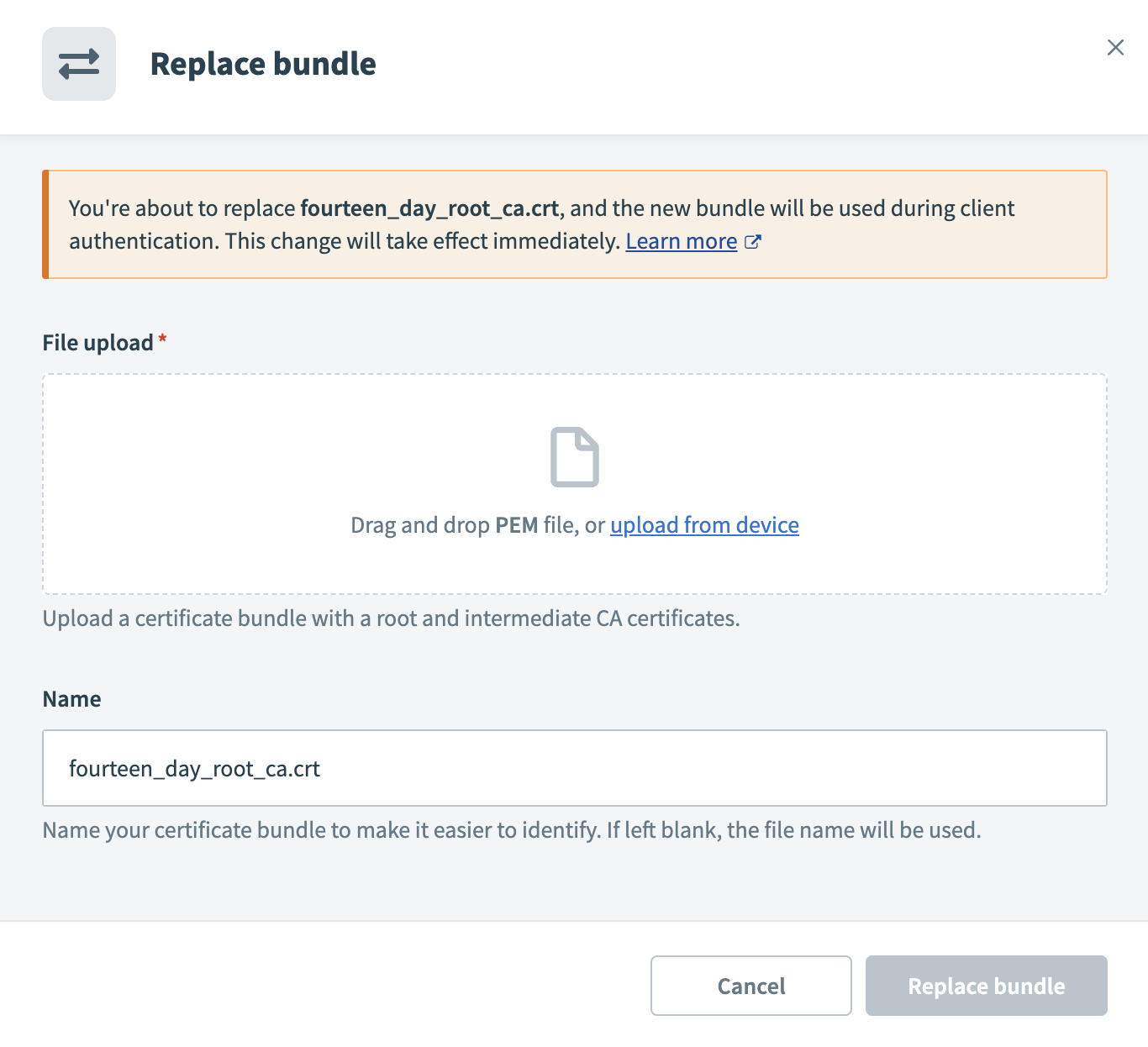

Replace certificate bundle
Upload a new .pem file in the File upload field with a valid root and intermediate CA certificates.
Optional. Enter a new Name.
Click Replace bundle.
Workato replaces the bundle immediately and uses the new certificates for client validation. After replacement, the expiration date and status reflect the updated bundle. This update affects all clients that use the replaced bundle.

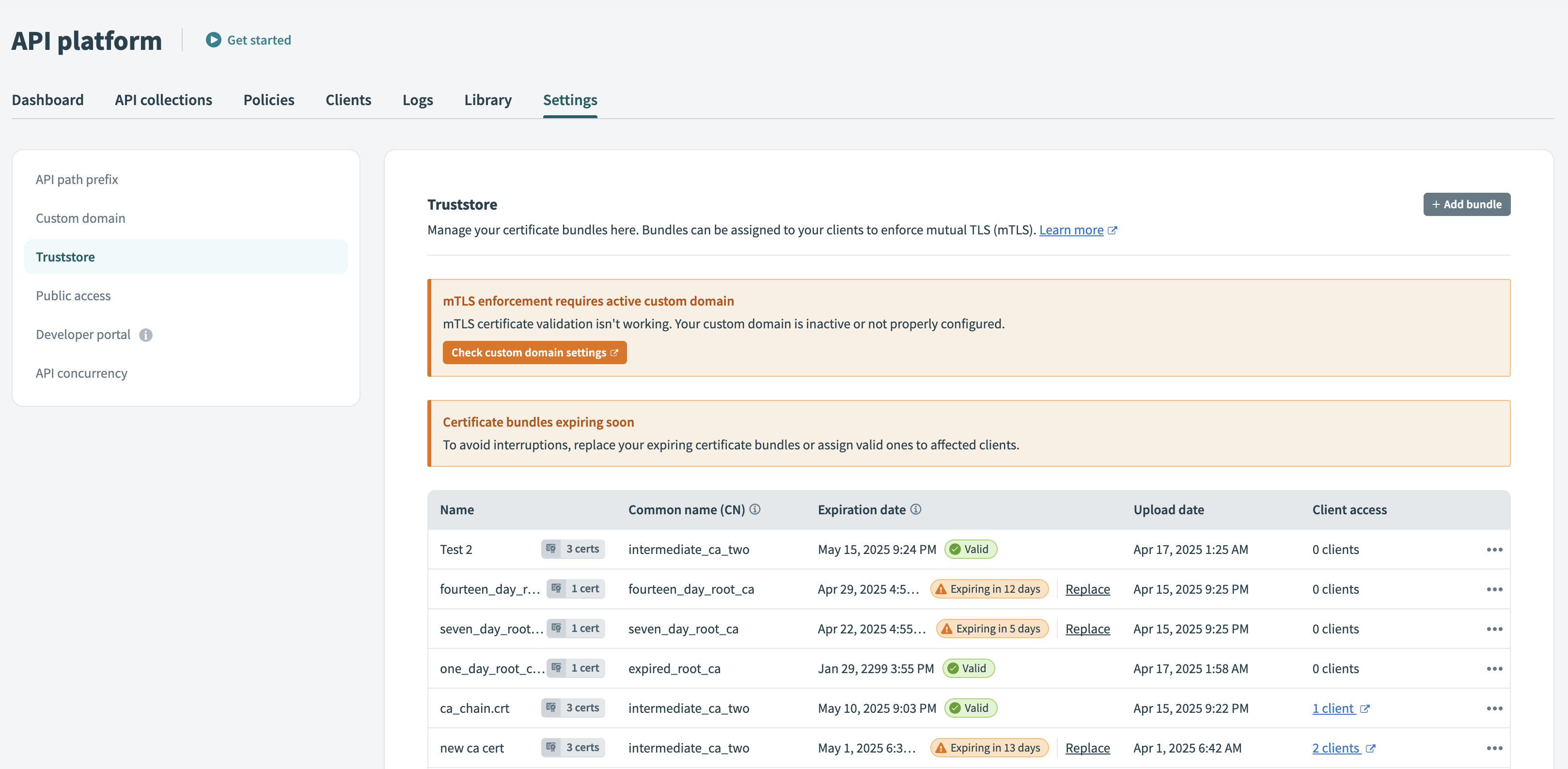

Workato enforces mTLS only when your workspace has a valid custom domain. The Truststore disables mTLS certificate validation if the domain is inactive or misconfigured.
The Truststore displays a warning when mTLS enforcement becomes unavailable due to domain issues.
mTLS enforcement warning
Click Check custom domain settings to update your configuration. Contact your workspace administrator if you don't have access to API settings. Workato doesn't enforce mTLS until the custom domain becomes active, even if certificate bundles are present.
