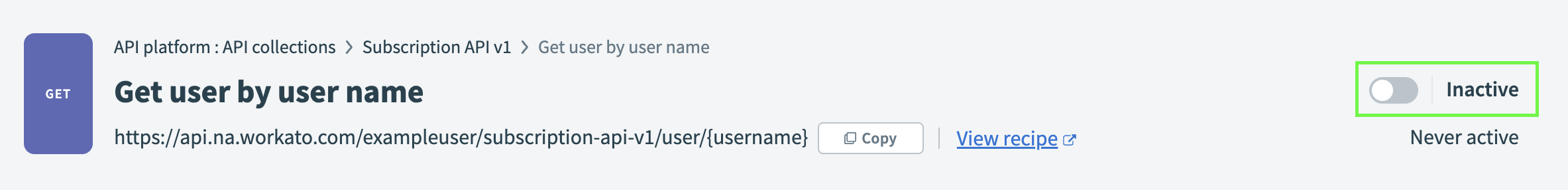

Recipe-based endpoints must be active before you can test them. If you haven't activated the endpoint yet, select the Inactive toggle in the upper right of the page to change it to Active.
Activate API recipe endpointActivate API recipe endpoint

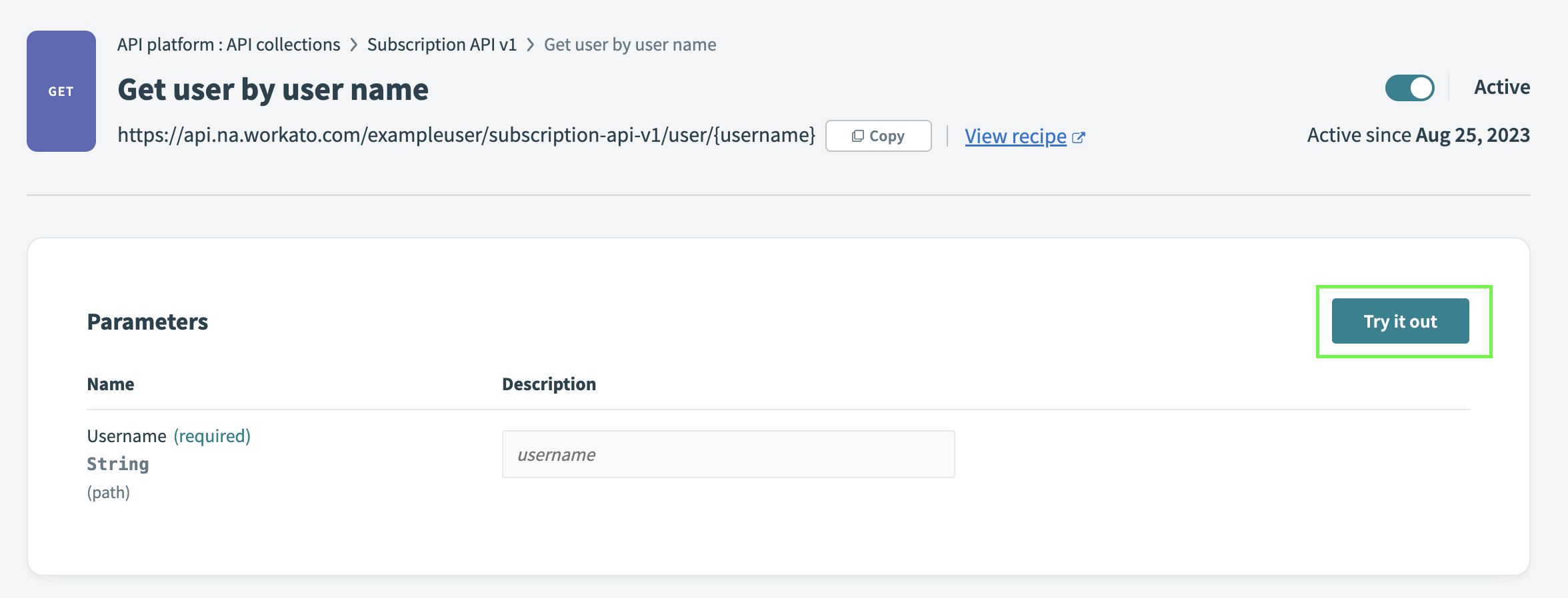

Select the Try it out button to the right of the Parameters section.
API recipe endpoint Try it out buttonTry it out button on an API recipe endpoint

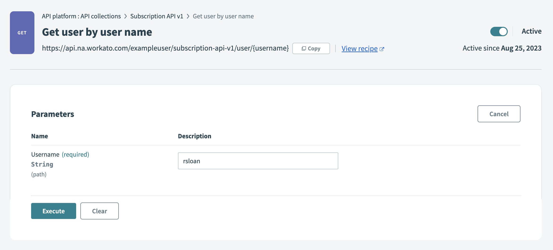

Enter any required path, query, or body parameters in the Parameters section.
The following screenshot shows a recipe endpoint with its required username path parameter filled out:
Entering a path parameter for a recipe endpointEntering a path parameter for a recipe endpoint

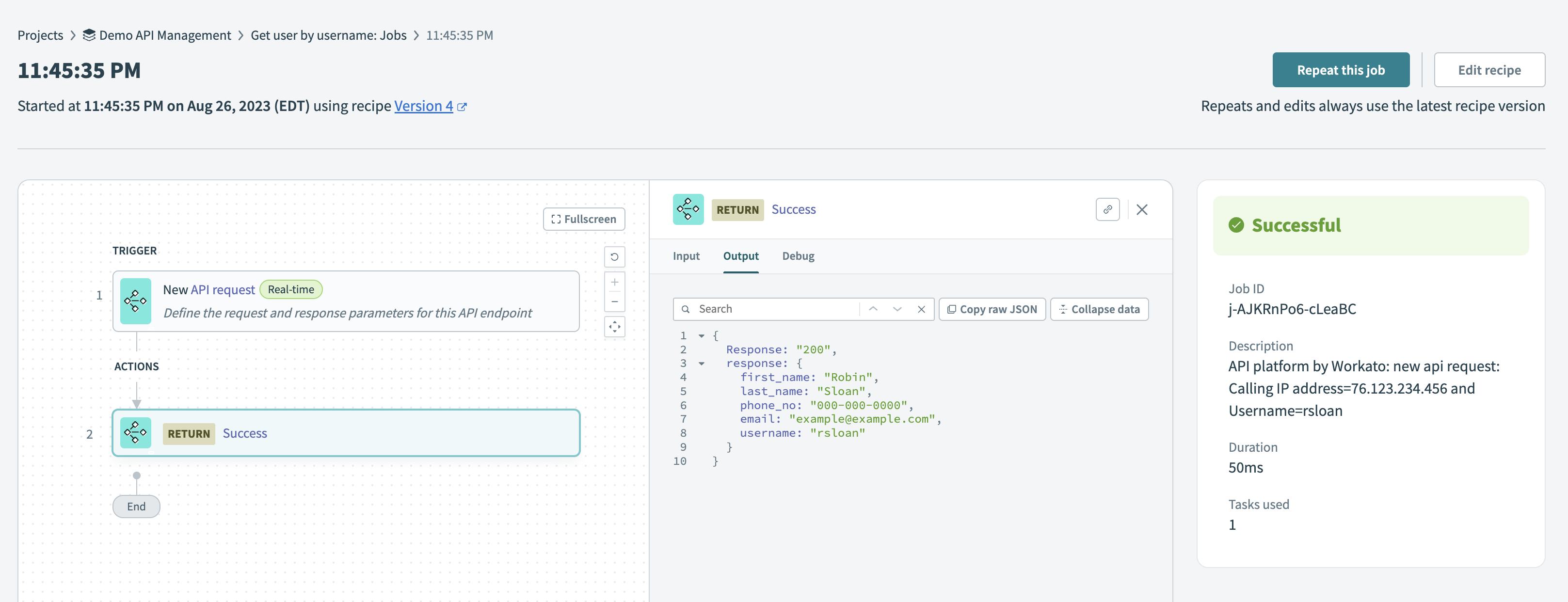

View the Jobs tab for the corresponding recipe to see the test job you just executed. Select the job to see more details.

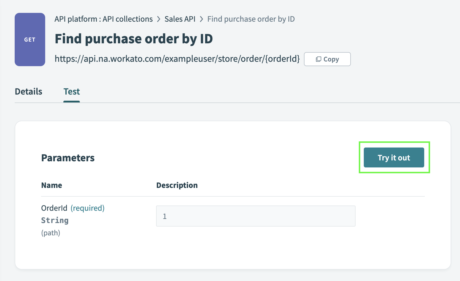

Select the Try it out button in the Parameters section:
API proxy endpoint Try it out buttonAPI proxy endpoint Try it out button

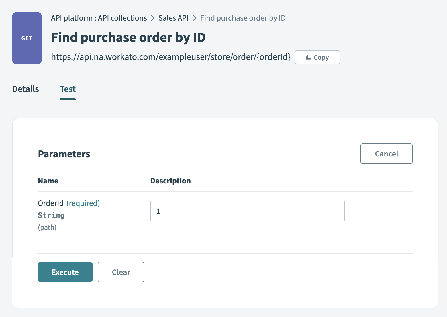

The following screenshot shows a proxy endpoint with its required orderId path parameter set to the value 1:
Entering a path parameter for a proxy endpointEntering a path parameter for a proxy endpoint

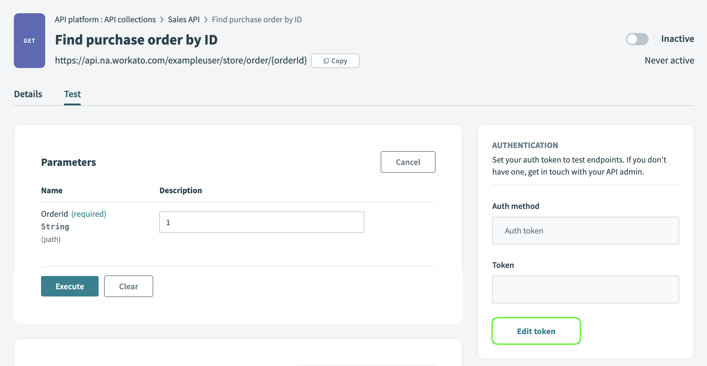

In the Authentication box, select the Edit token button:
Slect the Edit token buttonSelect the Edit token button
Select an authentication method from the Auth method picklist and enter the access or auth token for your client in the Token field.
Select Set token to confirm the auth token.

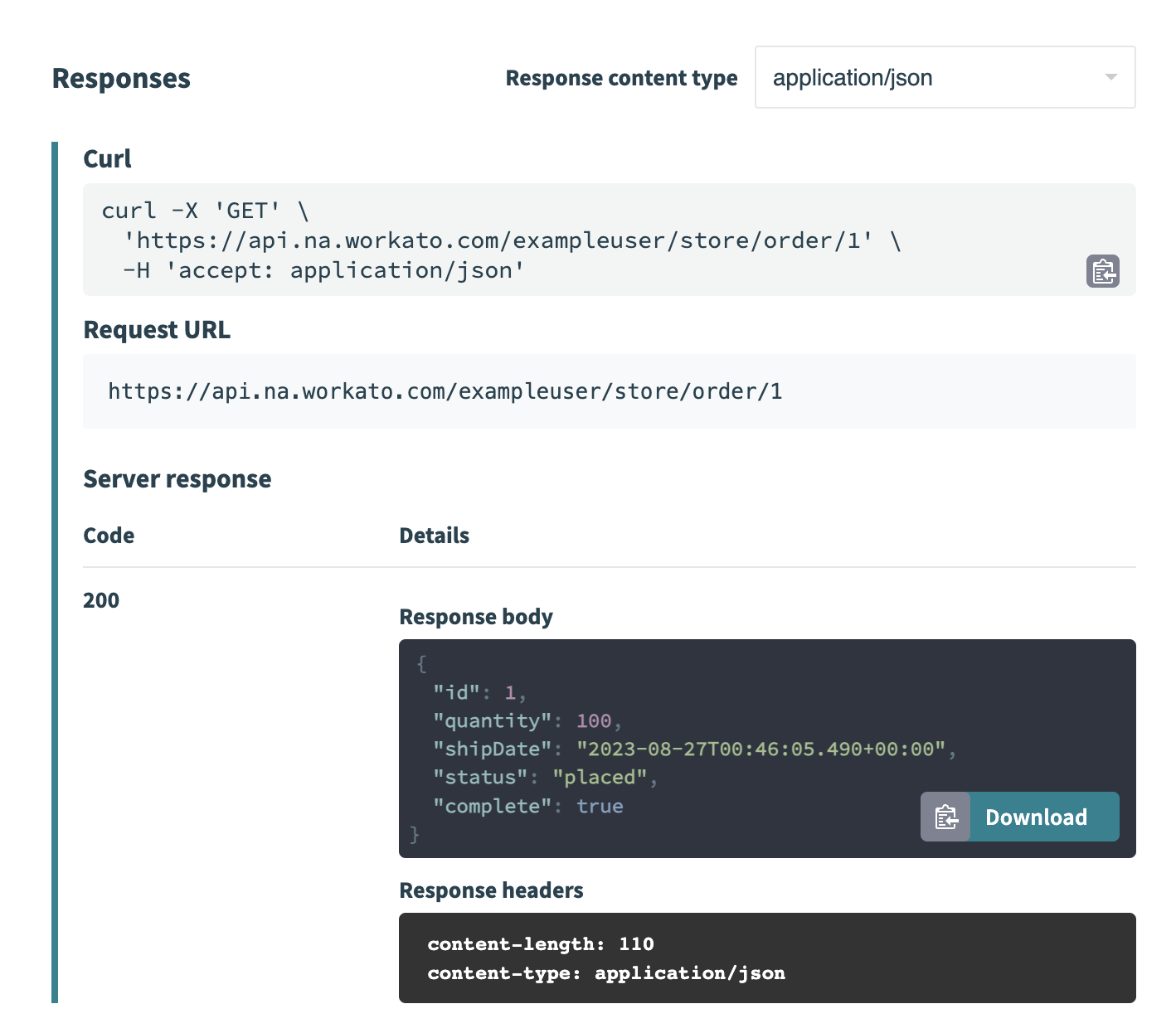

Select Execute to send the test request.
The following screenshot of a proxy endpoint shows a test response with a 200 success code and a downloadable response body:
Successful test responseSuccessful test response
