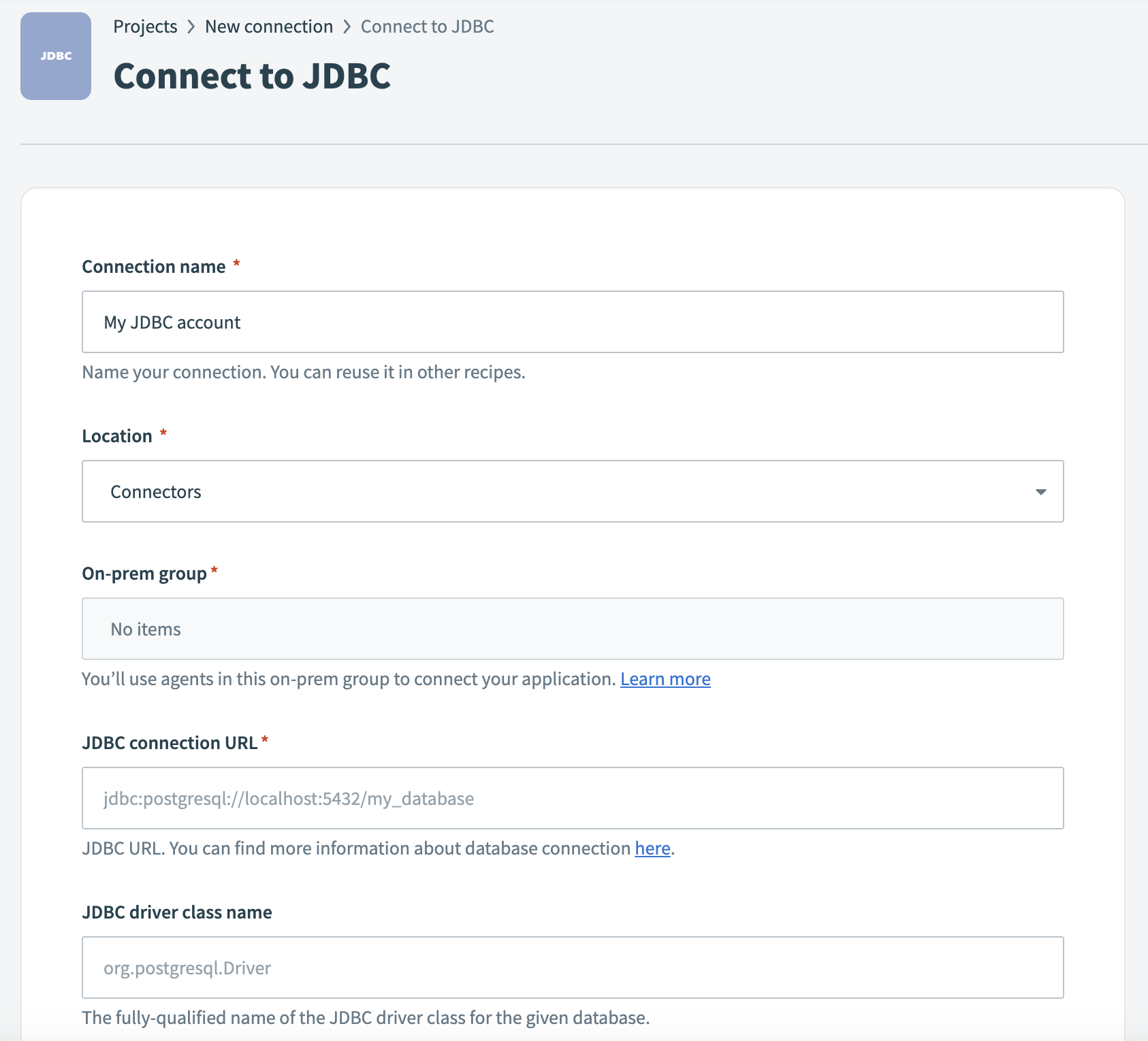

Complete the following steps to create a JDBC connection:
Provide a unique Connection name to identify your JDBC connection.
Connect to JDBC
Use the On-prem group drop-down menu to select the connection profile you plan to use.
Enter your JDBC connection URL.
Enter the JDBC driver class name.
Enter your database username in the User name field.
Provide a Password if your database requires username/password authentication.
Configure Pooling settings to control the number of open connections to your database.
Enter the Schema if your JDBC driver or database requires a specific schema to access tables and views.
Expand the Additional properties for JDBC connection section to display the advanced configuration fields. Use this section to add authentication keys or other custom JDBC parameters.

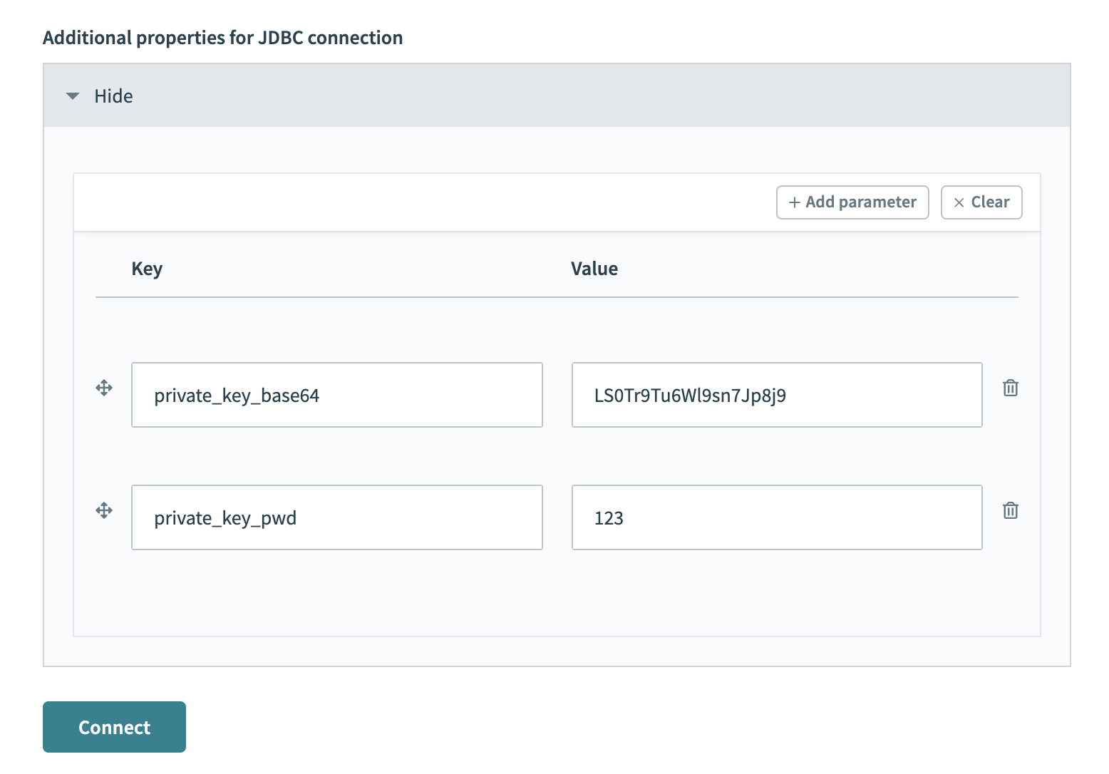

Expand the Additional properties for JDBC connection section.
Add the private_key_base64 connection property. This value is the base64-encoded content of your PKCS#8 private key file.
Add additional properties
You can generate it with the following command:
cat rsa_key.p8 | base64
Add the private_key_pwd property if your private key is encrypted. Otherwise, omit this property.

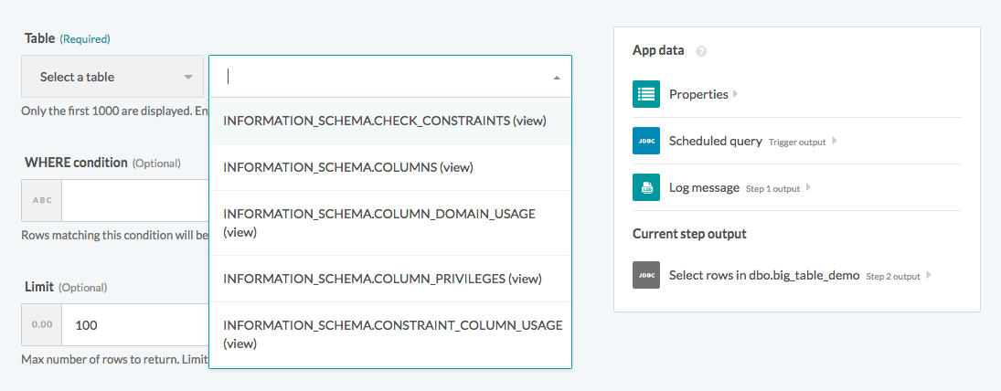

The JDBC connector works with all tables and views available to the credentials used to establish the connection. These are available in pick lists in each trigger/action, or you can provide the exact name.
Select a table/view from the pick list
Provide the exact table/view name in a text field
The case sensitivity of the name of a table/view depends on your database implementation.

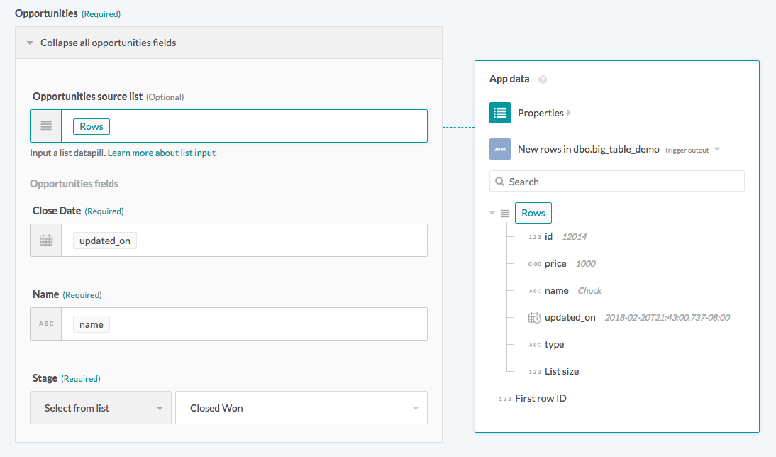

However, a trigger that processes rows in batches outputs them as an array of rows. The Rows datapill indicates that the output is a list containing data for each row in that batch.
Batch trigger output
As a result, the output of batch triggers/actions must be handled differently. The output of the trigger can be used in actions with batch operations (like the Salesforce Create objects in bulk action) that requires mapping the Rows datapill into the source list. Learn how to work with lists in Workato.
Using batch trigger output

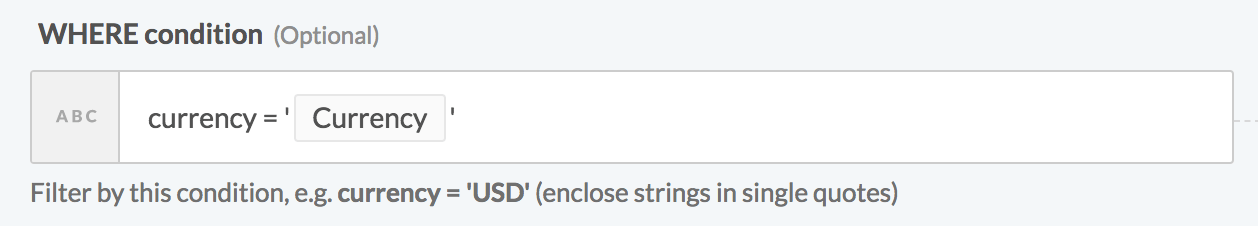

If used in a Select rows action, this WHERE condition returns all rows that have the value 'USD' in the currency column. Remember to wrap datapills with single quotes in your inputs.
Using datapills in WHERE condition

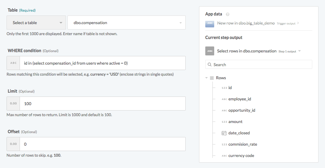

Your WHERE condition can also contain subqueries. The following example selects inactive employees from the compensation table.
id in (select compensation_id from users where active = 0)
When used in a Select rows action, this selects all rows in the compensation table related to users who are no longer active (active = 0).
Using subquery in WHERE condition
