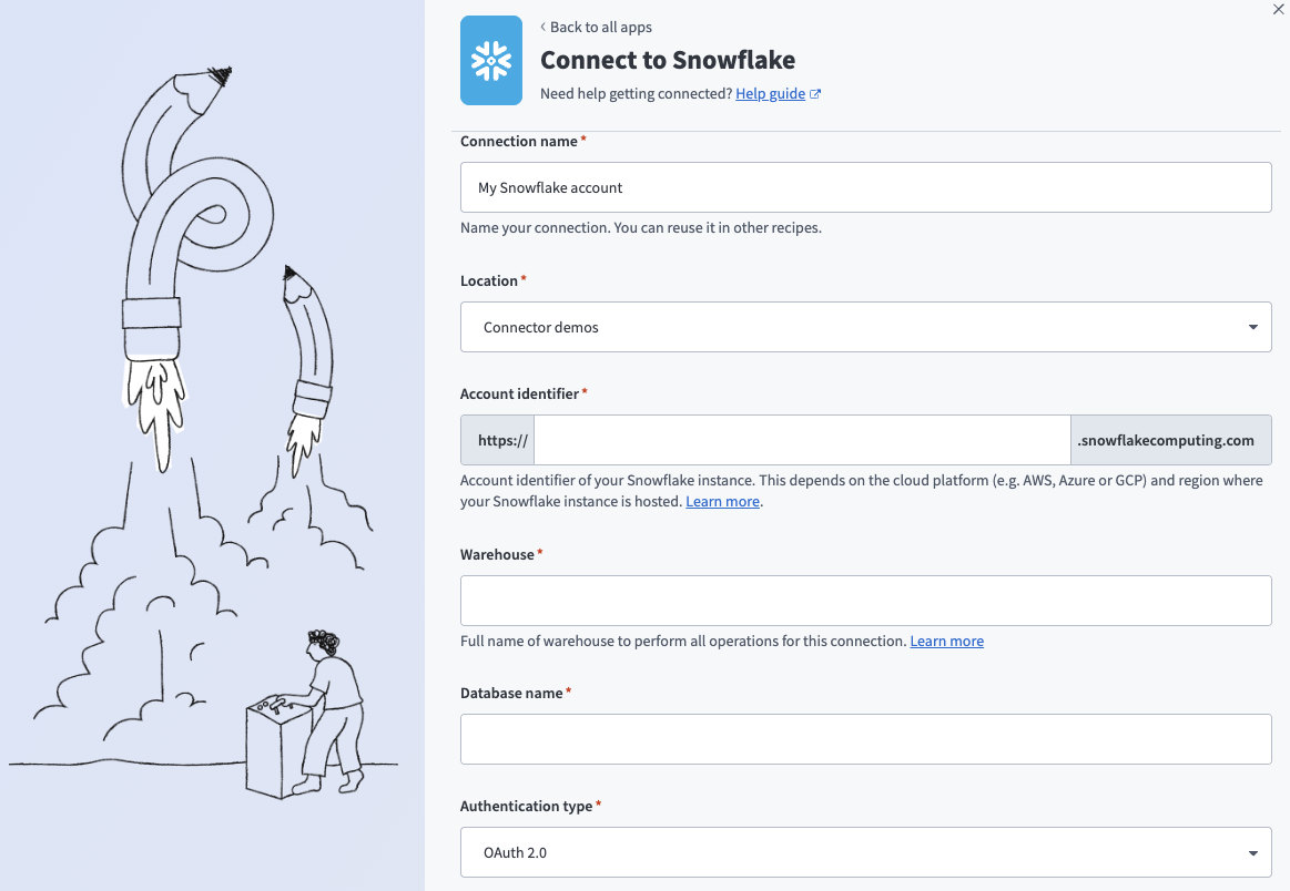

Connect to Snowflake with OAuth 2.0 authentication
Complete the following steps to set up an OAuth 2.0 authentication connection to Snowflake in Workato:
Search for Snowflake and select it as your app.
Snowflake OAuth 2.0 connectionSnowflake OAuth 2.0 connection
Enter the Snowflake instance Account identifier in one of the supported formats:
  • Account name: https://{org_name}-{account_name}
  • Connection name: https://{org_name}-{connection_name}
  • Account locator: https://{account_locator}.{region}.{cloud}
Refer to the Snowflake Connecting to your accounts guide for more information.
ACCOUNT LOCATOR FORMAT
Certain locations require you to include the {region} and {cloud} in your account locator URL. For example:
  • AWS US West (Oregon): your-account-locator
  • AWS US East (Ohio): your-account-locator.us-east-2
  • Azure West Europe: your-account-locator.west-europe.azure
Refer to the Snowflake Using an account locator as an identifier guide for more information.
Enter the Warehouse name to define the compute resources for this connection. Refer to Warehouse considerations for more information.
Enter the Database name for the target Snowflake database.
Enter the Client ID and Client secret. Refer to Snowflake setup for OAuth 2.0 authentication for information on how to retrieve these credentials.
Optional. Specify a Role for authentication. This role must be an existing role assigned to the user. If left blank, Snowflake uses the default role assigned to the user.
Optional. Enter the Schema. If left blank, the default schema is public.
12
Optional. Set the Use improved datetime handling (Recommended) to Yes to ensure correct timezone handling for timestamps.
13
Optional. Define the Database timezone to apply to timestamps without an assigned timezone. Defaults to your workspace's timezone if left blank.
14
15
Click Allow to provision access to Workato.

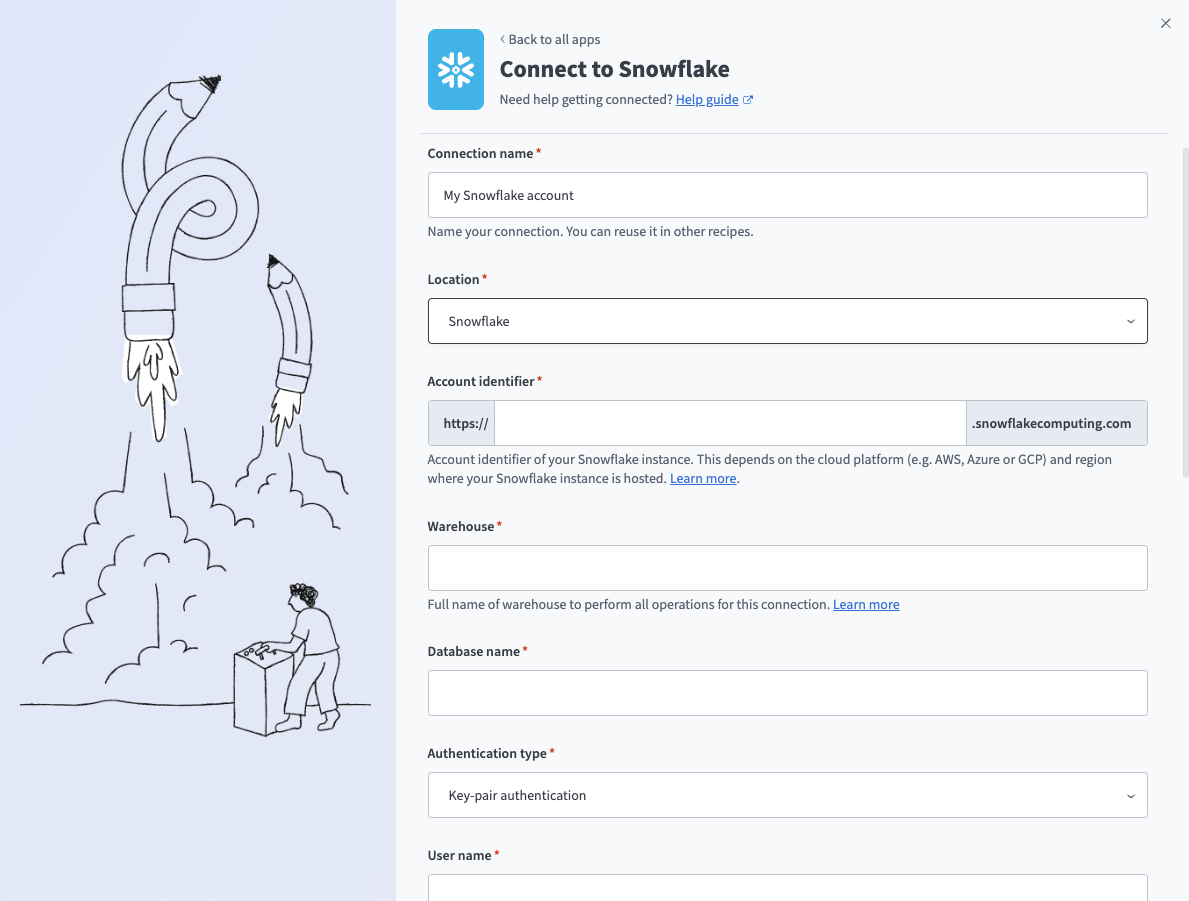

Connect to Snowflake with key-pair authentication
Complete the following steps to set up a key-pair authentication connection to Snowflake in Workato:
Snowflake Key-pair connectionSnowflake key-pair connection
Use the Authentication type drop-down menu to select Key-pair authentication.
Enter the User name and Private key. Refer to Snowflake setup for key-pair authentication for information on how to retrieve these credentials.
Optional. Enter the Private key passphrase if you generated an encrypted private key.
12
13
14
15

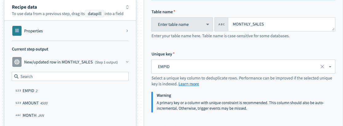

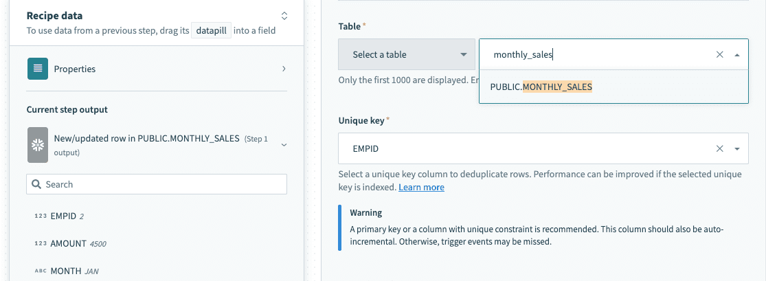

Table and view
The Snowflake connector works with all tables and views available to the username used to establish the connection. These are available in drop-down menus in each trigger/action, or you can provide the exact name.
Table selection from pick listSelect a table/view from the drop-down menu
Exact table name providedProvide exact table/view name in a text field

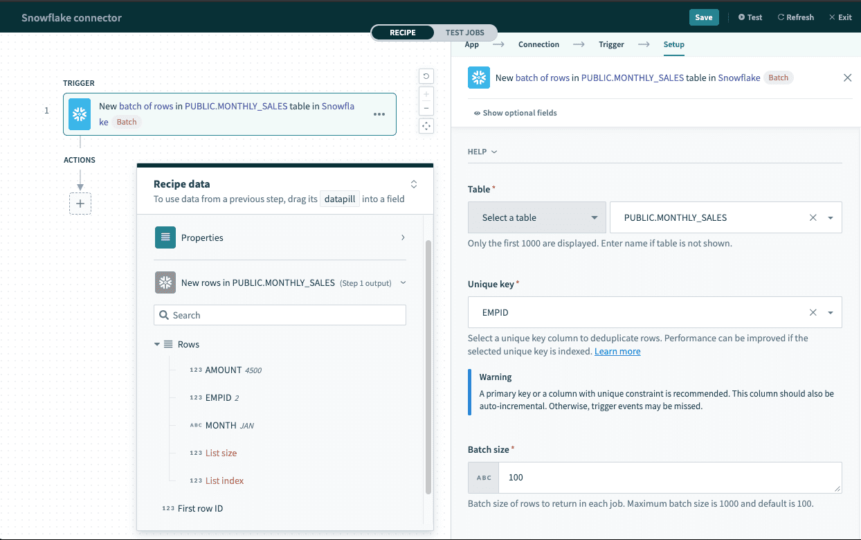

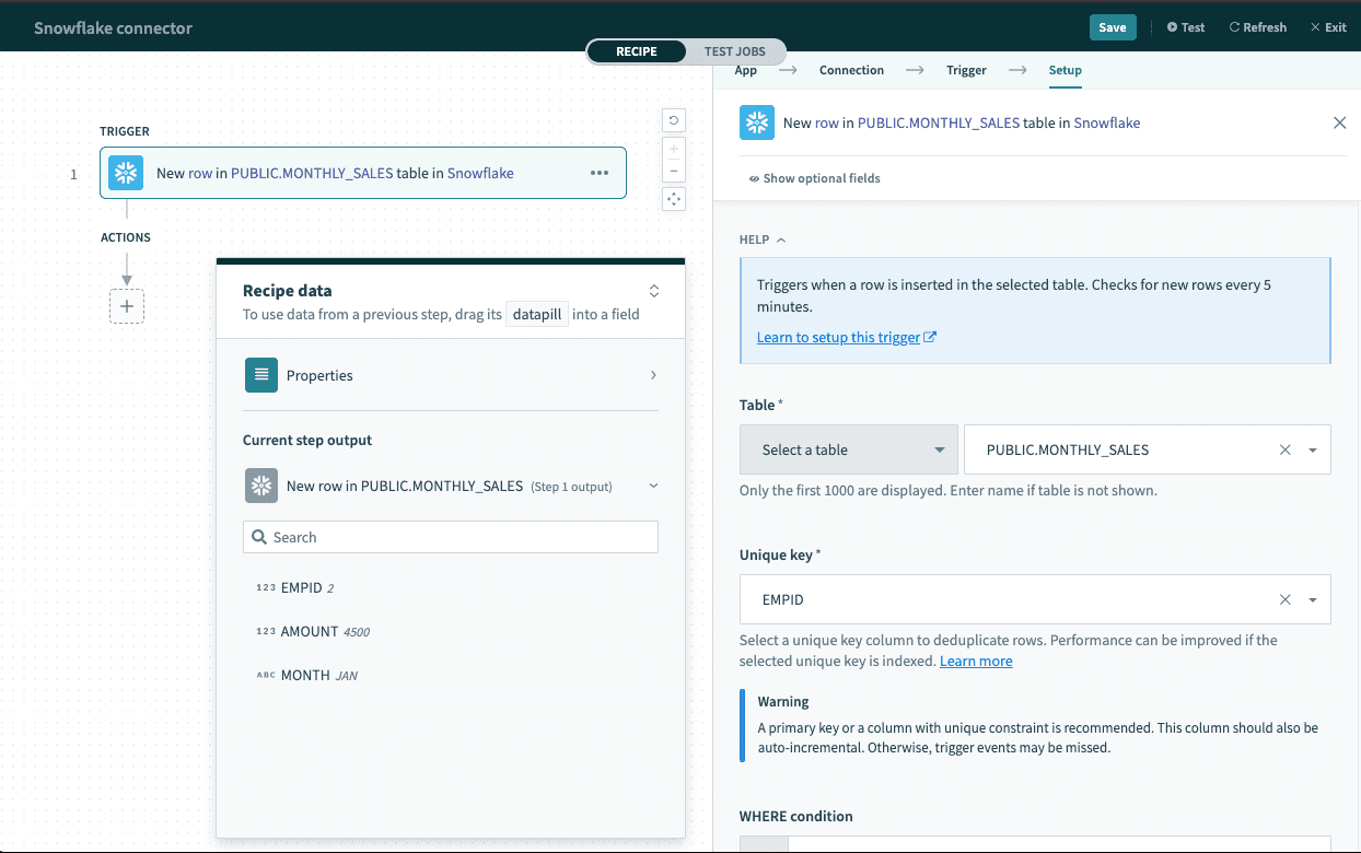

Single row and batch of rows
The Snowflake connector supports reading and writing data as a single row or in batches. Batch triggers and actions require a batch size between 1 and 100, and return a list datapill (an array of rows) rather than a single row output.
Batch trigger outputBatch trigger output
List datapill
The Rows datapill indicates that the output is a list containing data for each row in that batch.
Single-row triggers return an output datatree for mapping individual row data, while batch triggers return a list datapill that must be handled differently.
Single row outputSingle row output

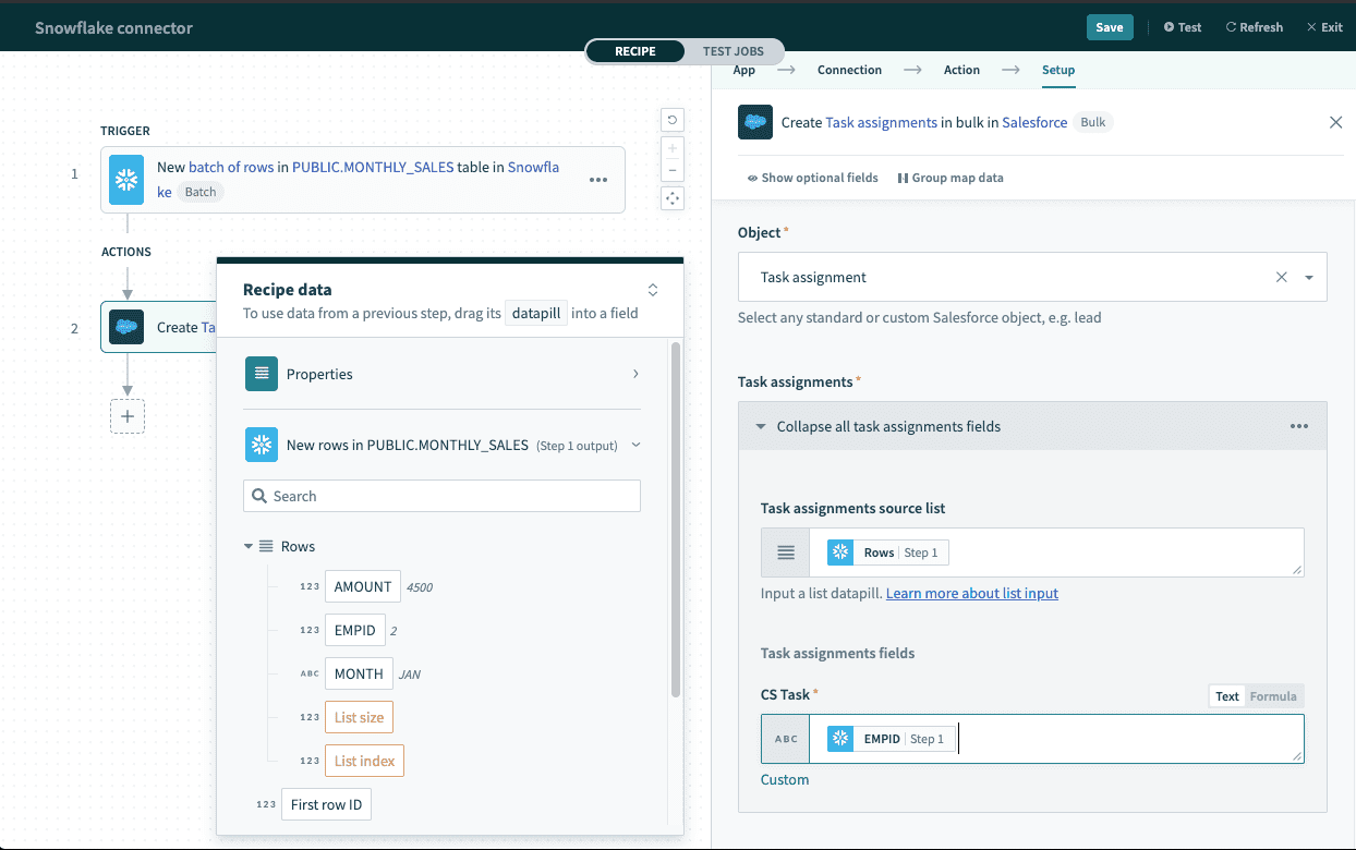

Map the Rows datapill into the source list with batch-compatible operations, such as the Salesforce Create objects in bulk action. Refer to Work with lists in Workato for more information.
Using batch trigger outputUsing batch trigger output

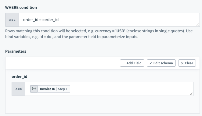

Use Parameters
Use parameters in conjunction with WHERE conditions to add an additional layer of security against SQL injection. To use parameters in your WHERE conditions, you first need to declare bind variables in your input. Bind parameters must be declared in the form :bind_variable where the variable name is preceded with a :. When this is done, declare the parameter in the following section using the exact name you've given.
TIP
Bind variables should only be used in place of column values and not column names.
WHERE condition with bind variableWHERE condition with bind variable
You can provide any number of bind variables, and each one should have a unique name. Workato distinguishes bind variables from column names and static values by ignoring any : inside single quotes ('), double quotes (") and square brackets ([]).
