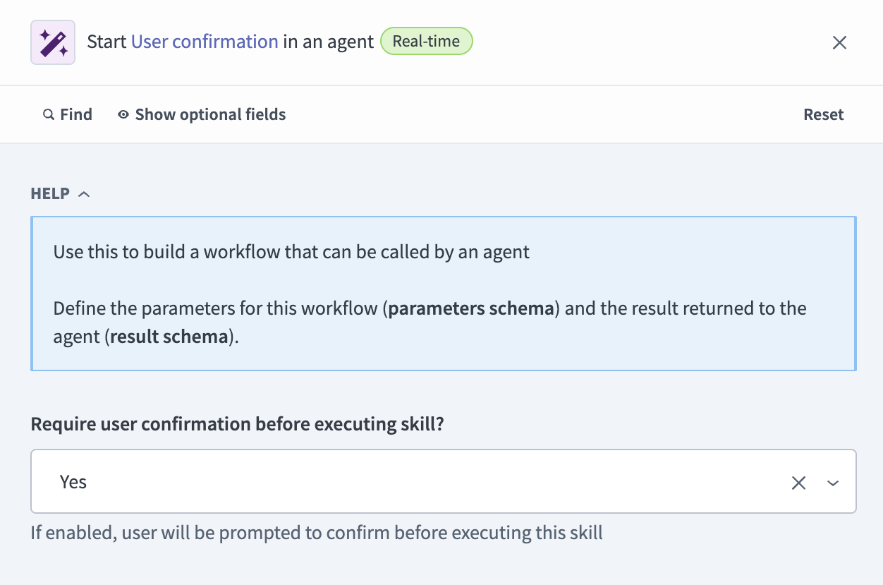

Use the Require user confirmation before executing skill? drop-down menu to select Yes.
Use the Require user confirmation before executing skill? drop-down menuUse the Require user confirmation before executing skill? drop-down menu
