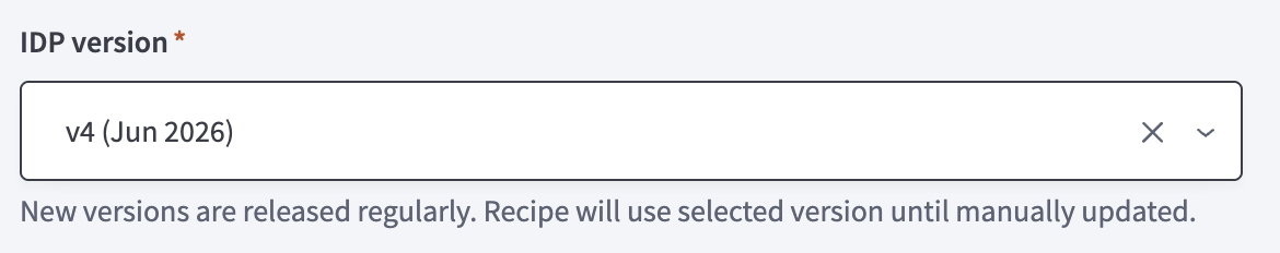

Use the IDP version drop-down menu in the action to set or change the version. The drop-down menu shows only the action's currently selected version and the latest available version. In recipes built before a newer version was released, refresh the recipe's schema first so the drop-down menu reflects these two versions correctly.
IDP versionIDP version

Complete the following steps to update an action to a newer IDP model version:
Open the recipe and select the Process document or Classify document action.
Refresh the recipe's schema so the IDP version drop-down shows the latest available version.
Use the IDP version drop-down to select the new version.
Save and re-run your recipe.
