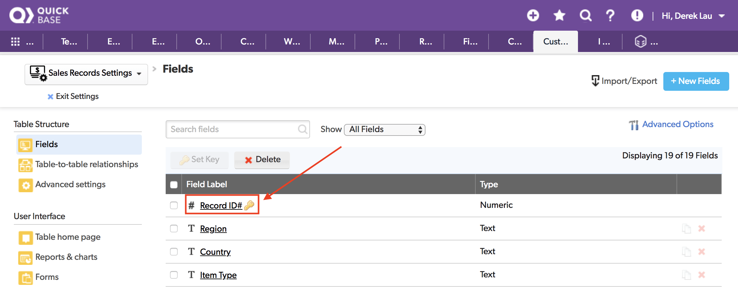

If your Quickbase table uses default key field - Record ID ​
Quickbase Default Record IDQuickbase default record
The default key field Record ID is automatically generated by Quickbase. In this situation, you can choose to do one of the following:
  • Create new records only
  • Create and update records using the default key field
  • Create and update records using the custom merge field

Navigate to Workato's Quickbase table settings and select Key field as the default Record ID.
Leave the first field labeled Record ID# in the Column mappings section blank. Because the default Record ID is auto-generated, you are not required to provide this ID when creating new records.

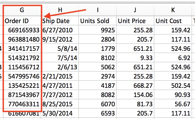

Create and update records using custom merge field ​
You can use an unique custom merge field like Order ID to create and update records, instead of the default key field Record ID. In this situation, the Order ID is used to determine if a CSV record already exists in Quickbase.
Ensure you have the Order ID column in your CSV file.
Custom ID column in CSV fileCustom ID column in CSV file
Navigate to Workato's Quickbase table settings, select Use custom merge field, then select the Order ID column in your Quickbase table.
Locate the Column mappings section and map your table's Order ID column to your CSV file's Order ID column.

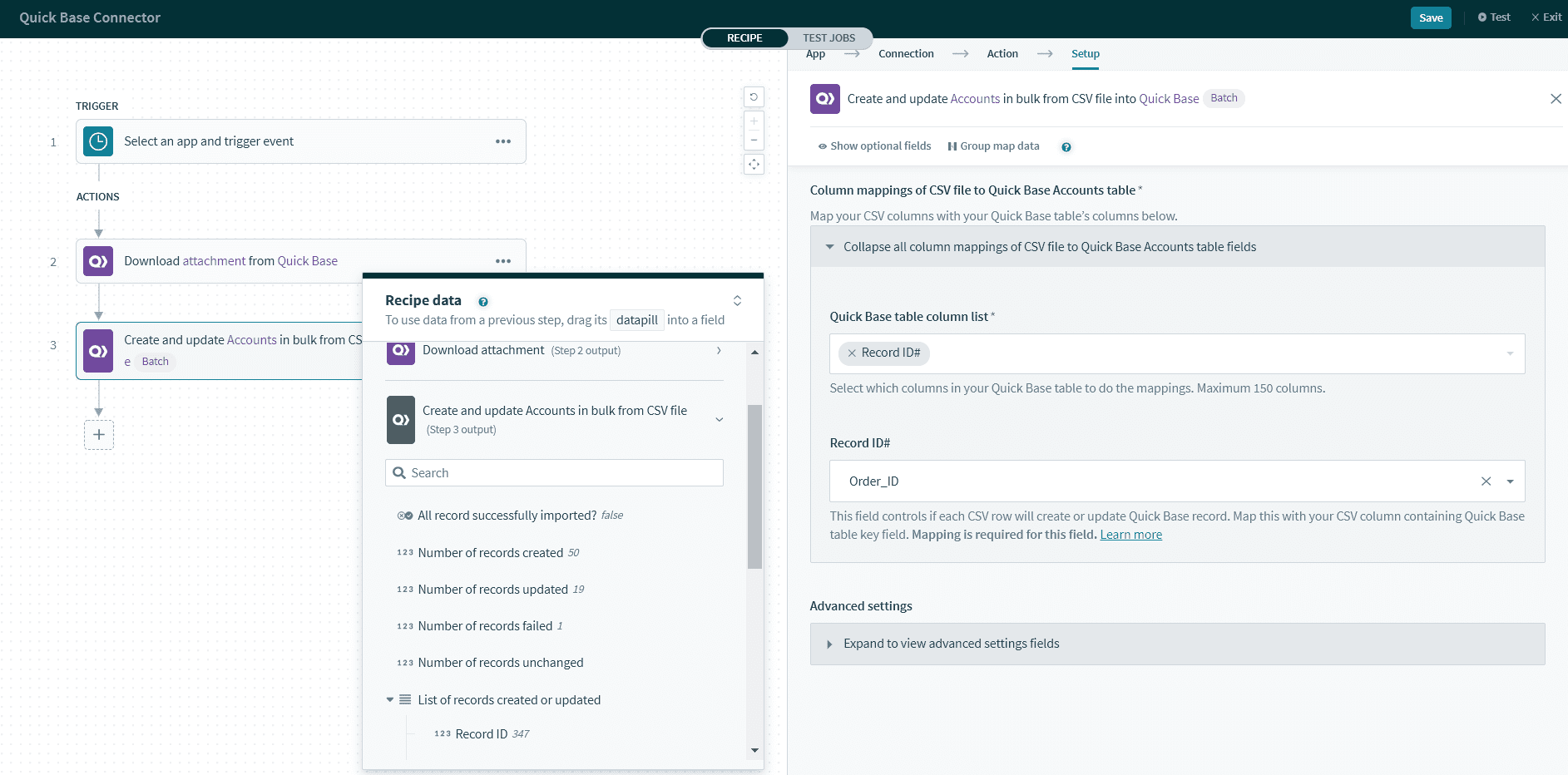

Column mappings ​
This section lists all columns in your Quickbase table. You must map these columns with the respective columns in your CSV file.
Pay attention to the first input field, Record ID. Make sure to map it with the correct record ID column in your CSV file, so Workato can use that to search for and update records in Quickbase. The following sample CSV file uses column Quickbase Record ID:
