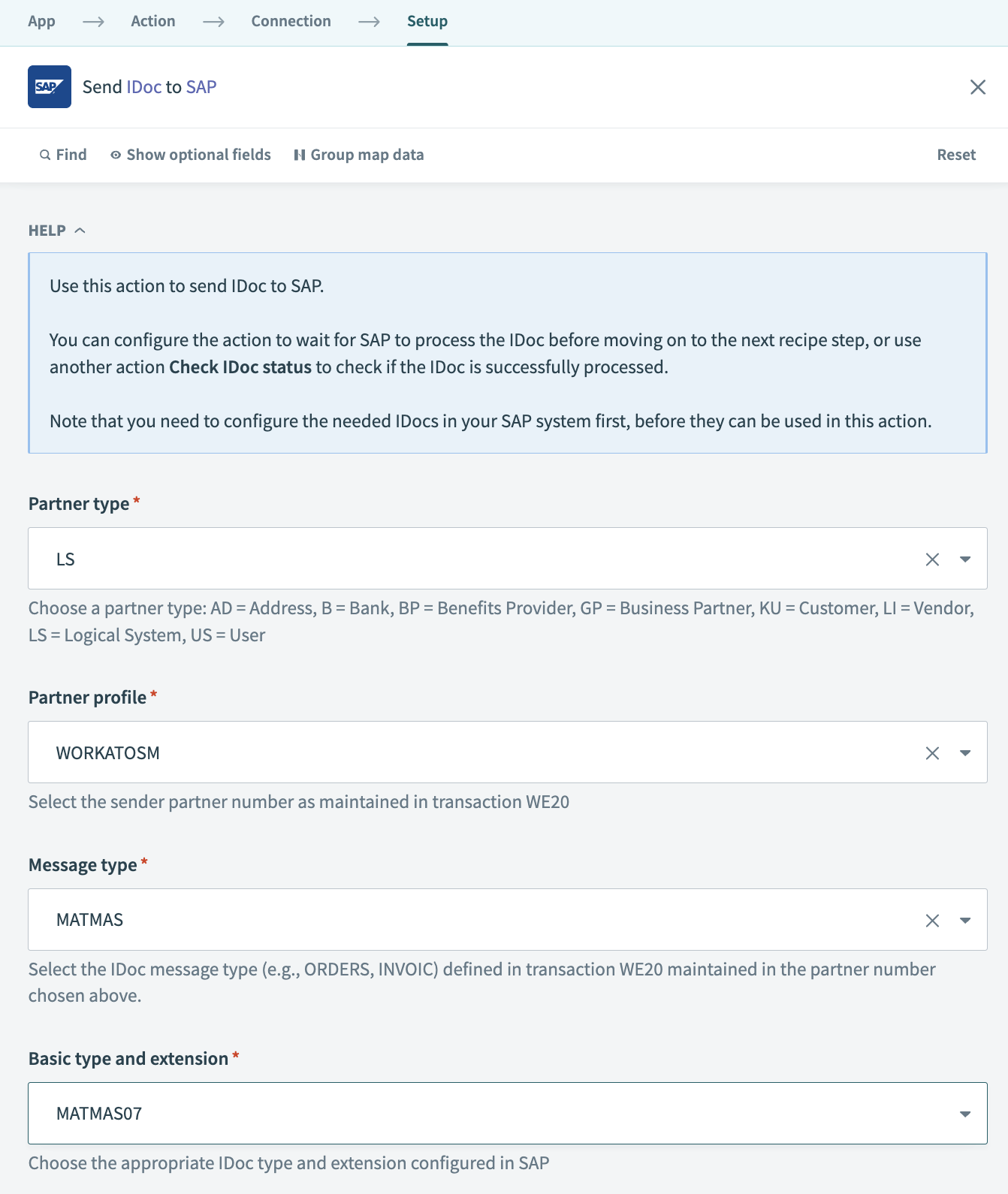

| Field name | Description |
| Partner type | Choose a partner type: AD = Address, B = Bank, BP = Benefits Provider, GP = Business Partner, KU = Customer, LI = Vendor, LS = Logical System, US = User. |
| Partner profile | Select the sender partner number as maintained in transaction WE20. |
| Message type | Select the IDoc message type defined in transaction WE20 maintained in the partner number selected in the preceding steps. For example, ORDERS, INVOIC. |
| Basic type and extension | Choose the appropriate IDoc type and extension configured in SAP for a particular message type selected in the preceding steps. |
| Wait for SAP to process the IDoc? | IDoc is processed asynchronously in SAP. This means you can configure the recipe to wait for the processing to finish before moving on to the next recipe step. |
| Check IDoc status every | This field appears if Wait for SAP to process the IDoc is set to Yes. Select how often Workato should call SAP. This is useful when you want to control the workload of your SAP system. |
