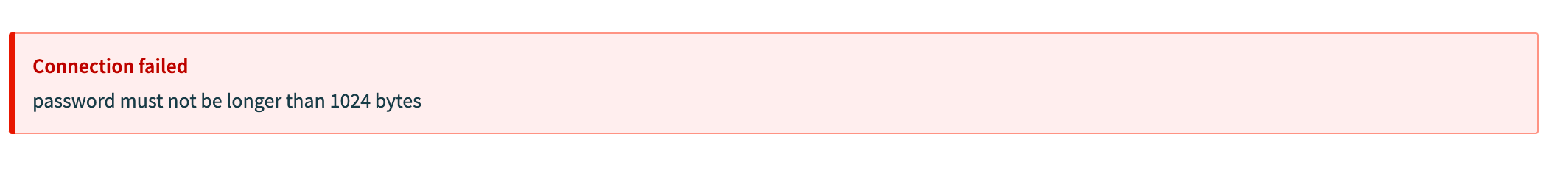

Connection fails with “password must not be longer than 1024 bytes”
You may see the following error when you create an SFTP connection:
SFTP connection failed errorSFTP connection failed error
Why it happens
This error occurs when the Private key passphrase field contains a value longer than 1024 characters. In some cases, the field auto-fills incorrectly with the private key itself. The encryption library Workato uses enforces a 1024-byte quota on passphrase length, which causes the connection to fail.
How to troubleshoot
Complete the following steps to resolve the issue:
Create a new SFTP connection in Workato.
Leave the Private key passphrase field blank if your SSH key doesn't use a passphrase. If your key uses a passphrase, enter it manually and ensure it's under 1024 characters.
Save and test the new connection.
