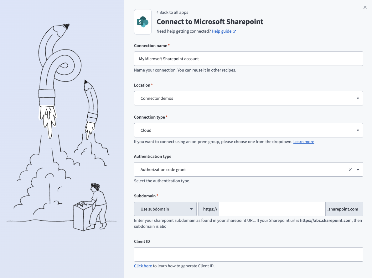

Complete setup in Workato ​
Sign in to Workato.
Select the project where you plan to store the connection.
Search for and select SharePoint as your connection on the New connection page.
Connect to SharePointConnect to SharePoint
Select the Authorization code grant option from the Authentication type drop-down menu.
Enter your SharePoint Subdomain. You can find it in your SharePoint URL. For example, if your SharePoint URL is https://abc.sharepoint.com, the subdomain is abc.
Provide the Client ID generated in SharePoint.
Provide the Client secret generated in SharePoint.
Provide the name of your SharePoint site in the Site name field. Enter the name as it appears in the site URL. For example, if the URL is https://company-name.sharepoint.com/sites/product, the site name is product. If left blank, Workato connects to your default home site.
12
13
Click Sign in with Microsoft.

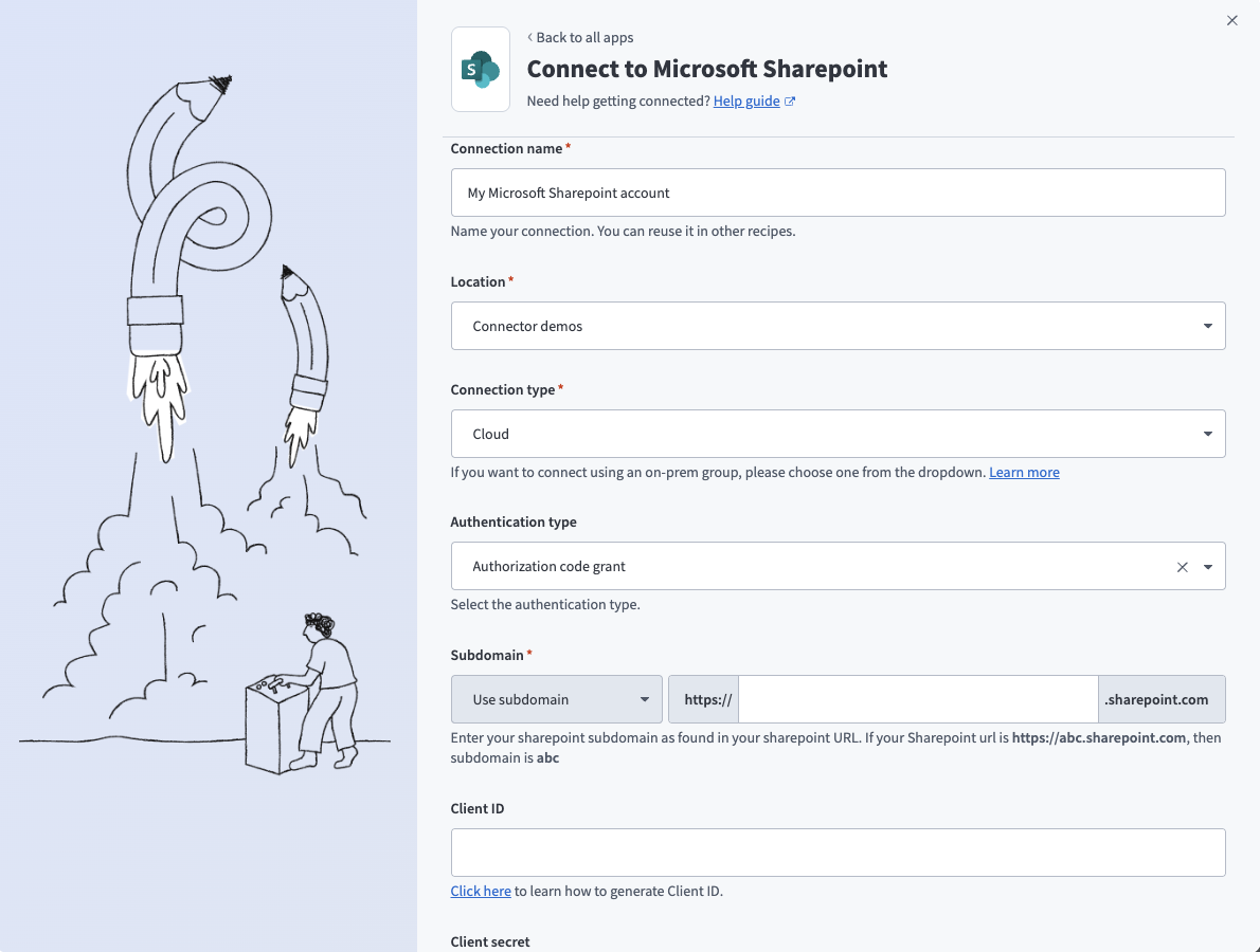

Complete the following steps to create a SharePoint connection in Workato after you configure your app in the Azure Portal:
Sign in to Workato.
Select the Client credentials option from the Authentication type drop-down menu.
Use the API Scope drop-down menu to select SharePoint API or SharePoint & Graph API. Don't select Graph API (Data-Pipelines only), because it doesn't work with recipe triggers and actions.
Provide the Directory (tenant) ID from the Azure portal in the Tenant ID field.
Provide the Application (client) ID from the Azure portal in the Client ID field.
12
Provide the certificate string you generated in the Certificate field.
13
Provide the private key string you generated in the Private key field.
14
15
16
