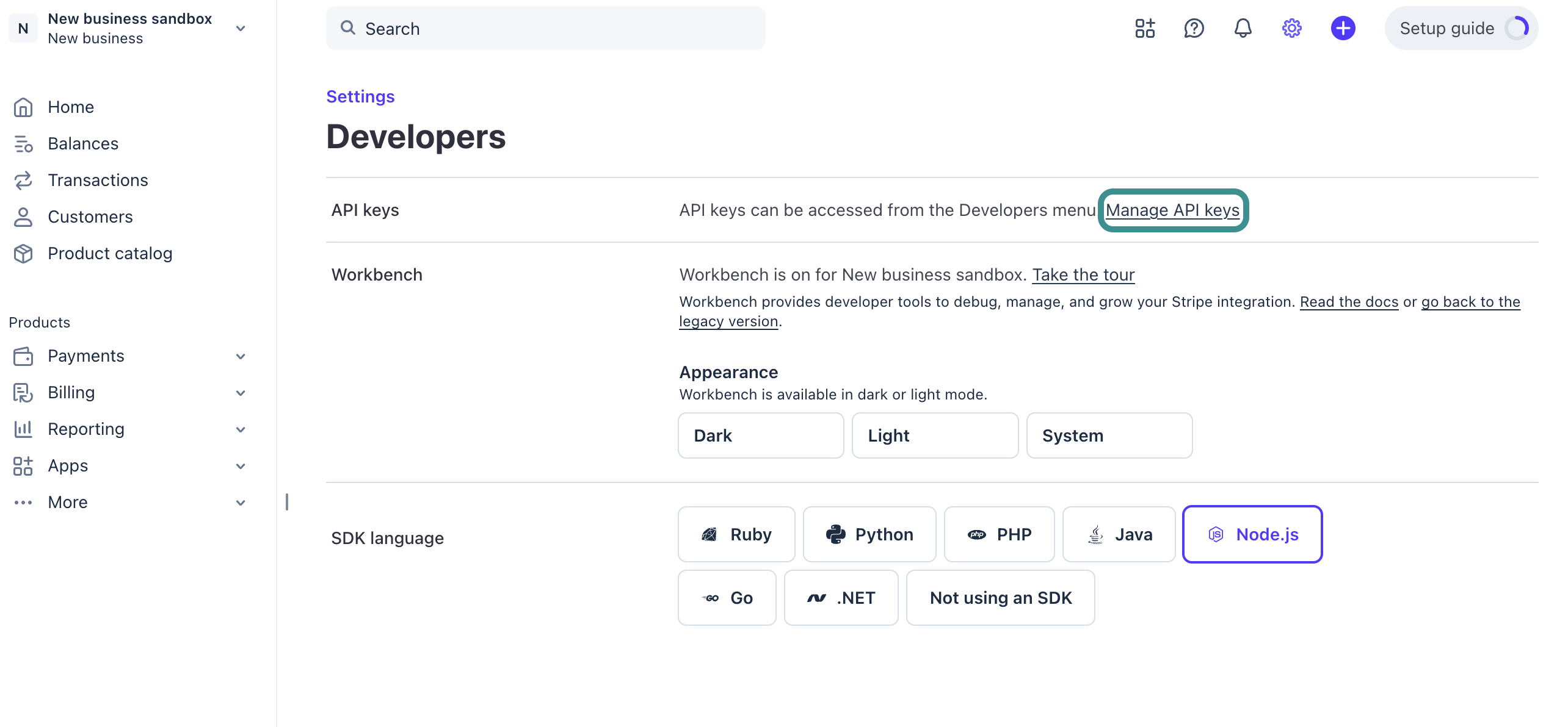

Sign in to your Stripe Dashboard and select the mode (live or test) that matches the data you plan to sync.
Go to Settings > Developers > Manage API keys.
Manage API keys

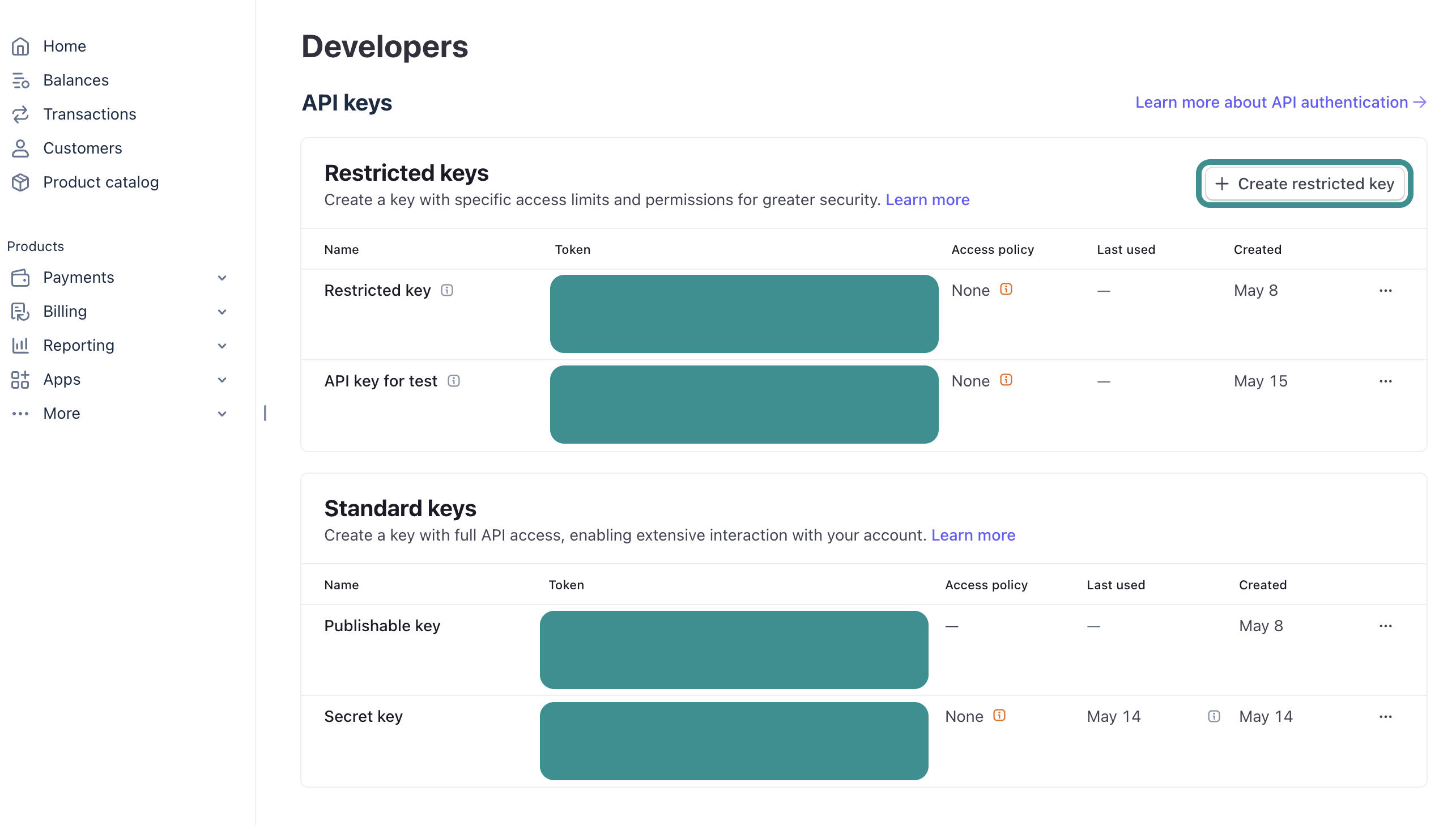

Locate the Restricted keys section and click Create restricted key.

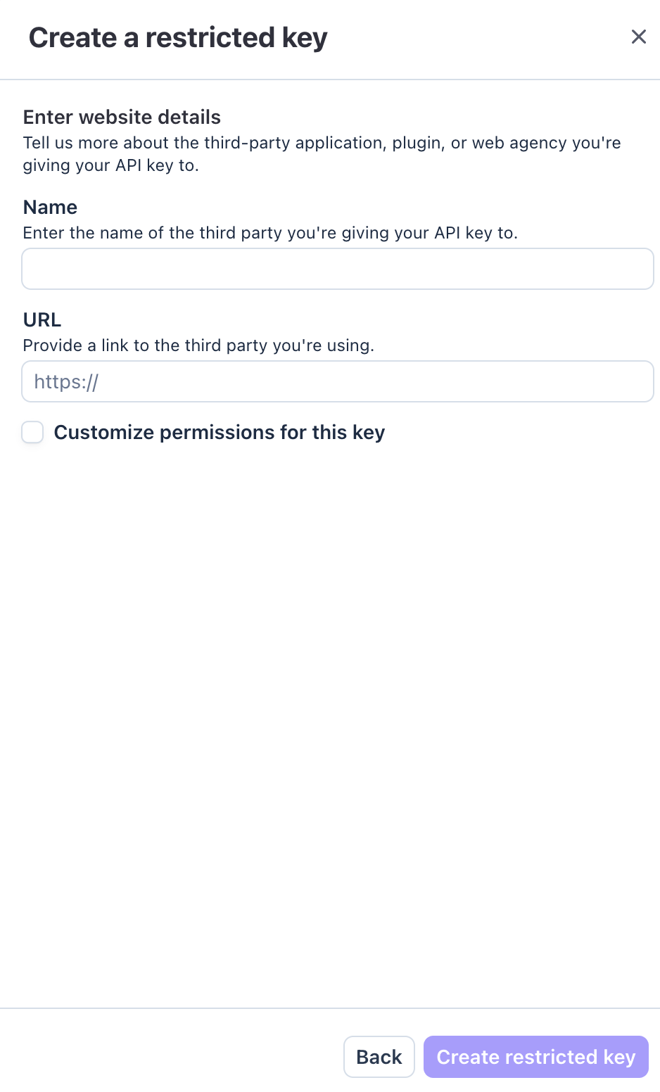

Select Providing this key to a third-party application when Stripe asks how you plan to use the key, then click Continue.
Enter a name for the key in the Name field. For example, Workato Data Pipeline.
Enter key details
Enter https://www.workato.com in the URL field.

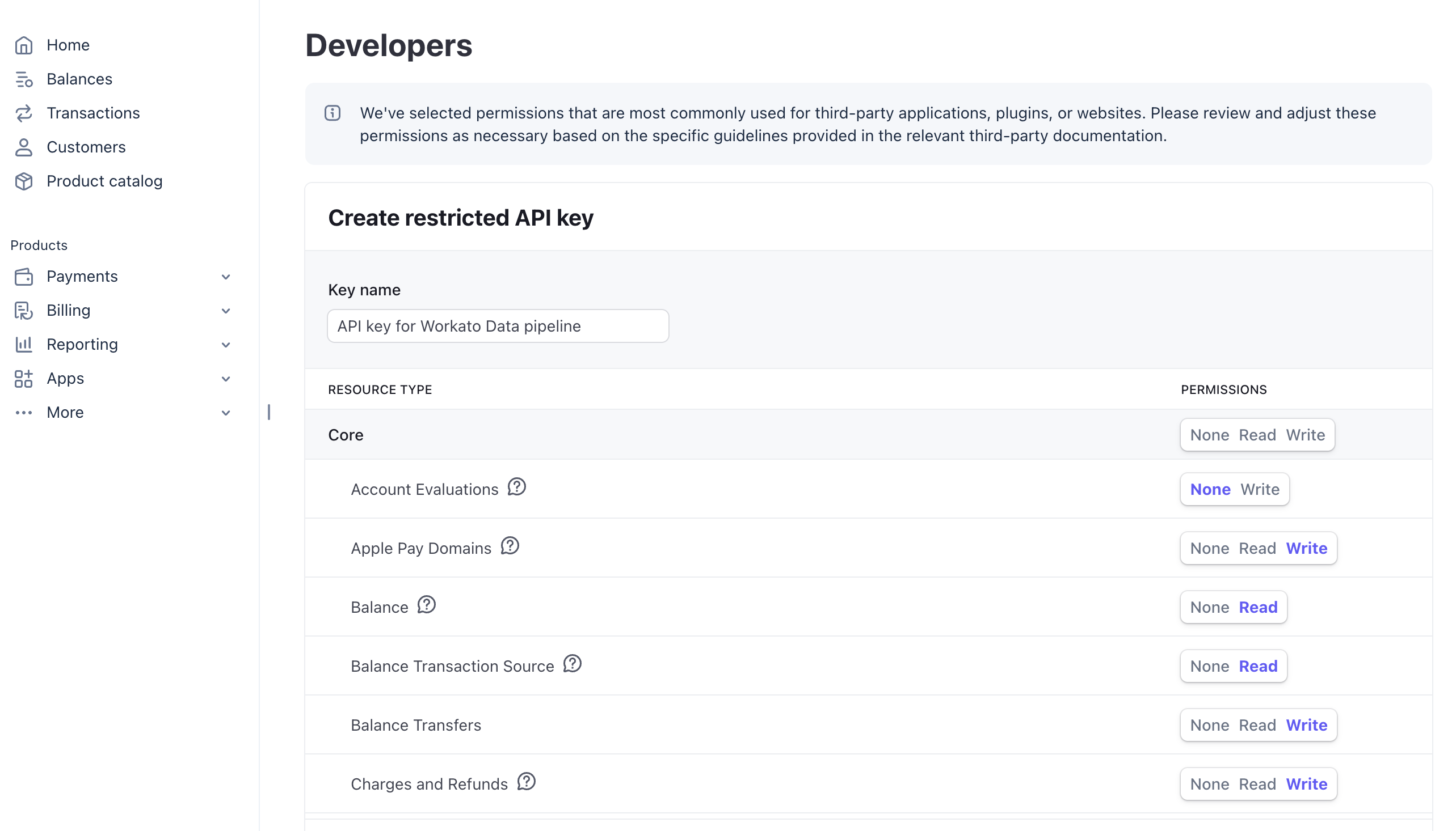

Select Customize permissions for this key and click Continue. Stripe opens a permissions grid with default selections for third-party applications.
Review each resource type and set the permission to Read for every resource that corresponds to an object you plan to sync. Set unused resources to None. Don't grant Write for any resource, because Workato data pipelines extract data only.
Customize resource permissions
Refer to Recommended permissions for the complete list of permission categories that map to Workato objects.

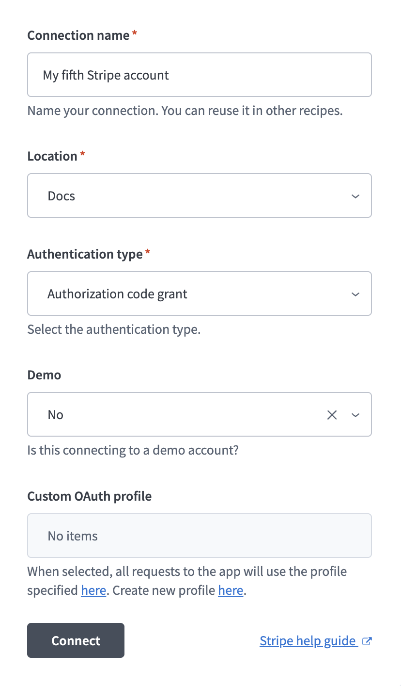

Connect to Stripe
Complete the following steps to connect Stripe as a data pipeline source.
Connect to Stripe

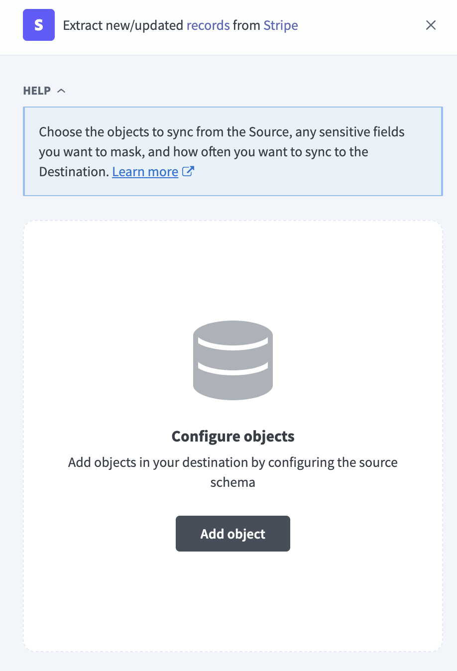

Click Add object to open the Add new objects panel.
Add objects
