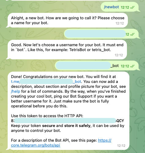

Sign in to your Telegram app and search for the @BotFather account.
Start a conversation with @BotFather and enter the /newbot command.
Create a new Telegram botCreate a new Telegram bot
Enter a human-readable name for your bot when prompted. For example: Workato PA genie.
Enter a unique bot username that ends with bot when prompted. For example: workato_bot.
Copy the secret API token that @BotFather provides in the confirmation message. You must use this token to connect your bot to Workato.

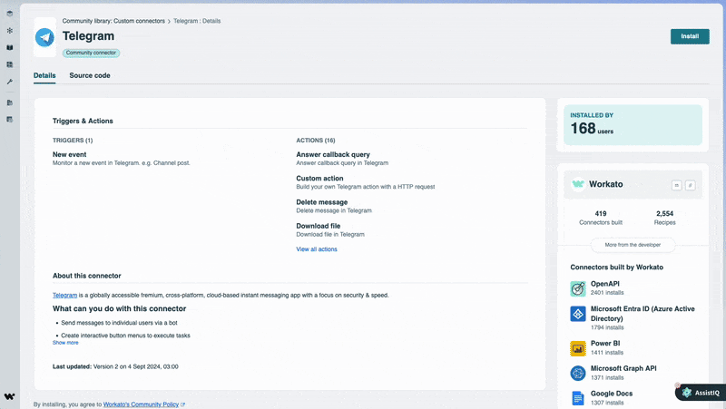

This step installs the Telegram community connector and creates a connection between Workato and your Telegram bot.
Go to Community Library > Custom Connectors.
Search for Telegram and select it as your app.
Click Install.
Install the Telegram community connectorInstall the Telegram community connector

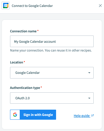

Complete the following steps to set up your Google Calendar connection using OAuth 2.0:
View OAuth 2.0 authentication steps
Search for and select Google Calendar as your connection on the New connection page.
Select the project where you plan to store the connection from the Location drop-down menu.
Select OAuth 2.0 as the Authentication type.
Click Sign in with Google, then sign in to your Google account. Ensure your Google account has sufficient permissions to manage the events and calendars you plan to use in Workato. Click Sign in with GoogleClick Sign in with Google.

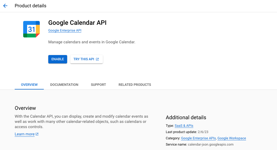

You must enable the Google Calendar API before you return to Workato to finish setting up your connection.
Sign in to Google's API library.
Search for and select the Google Calendar API.
Click Enable to enable the API. Enable the Google Calendar APIEnable the Google Calendar API

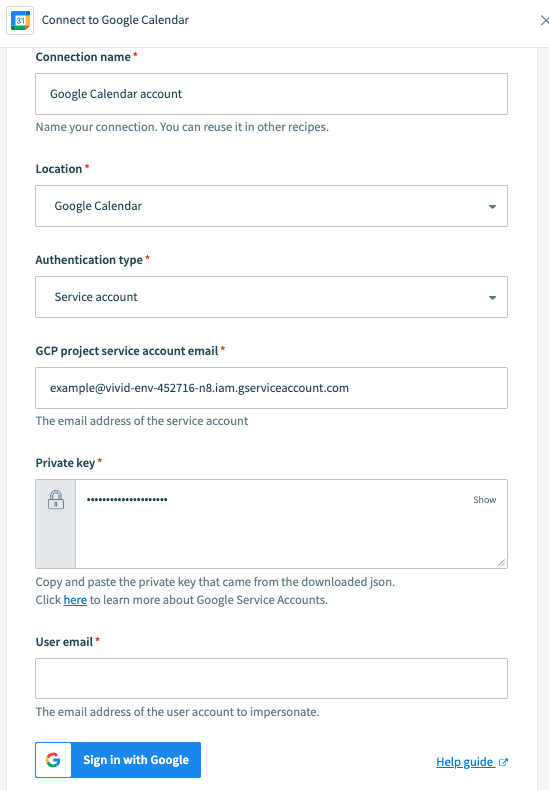

Complete the following steps in Workato to set up your Google Calendar connection using a service account:
Select Service account as the Authentication type.
Enter your service account's Private key.
Provide the User email of the account you plan to impersonate.
User impersonation lets the service account act on behalf of a designated user, accessing and managing events in their Google Calendar. Impersonating a user ensures data accuracy and enforces the permissions and access controls set for that user in Google Calendar. Refer to Google's Service account impersonation guide for more information.
Click Sign in with Google to complete the setup. Configure Google Calendar service account connectionConfigure Google Calendar service account connection

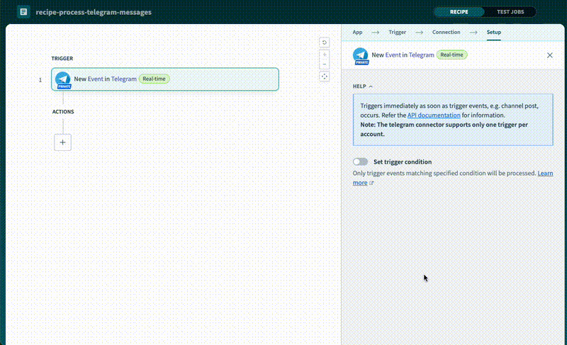

Set up a recipe to process incoming Telegram messages.
This step ensures that messages sent to your Telegram bot reach Workato and are processed correctly.

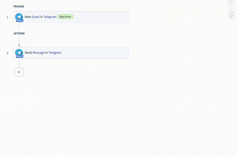

Go to the project where you plan to store your recipe and click Create > Recipe or press C+R.
Enter a name for your recipe in the Name field and use the Save recipe in drop-down menu to select a project location.
Click Pick a starting point > Select an app.
Select the New Event trigger and connect using the Telegram connection you created in the preceding steps.
Click + Add step and search for and select Telegram.
Set up your Telegram Send message actionSet up your Telegram Send message action
Select the Send message action.
Map the Telegram Message > Chat IDStep 1 datapill to the Chat ID field.
Enter Message received in the Message to send field.
Optional. Click Test recipe and send a message to your Telegram bot. Your recipe is configured correctly if you receive a reply.

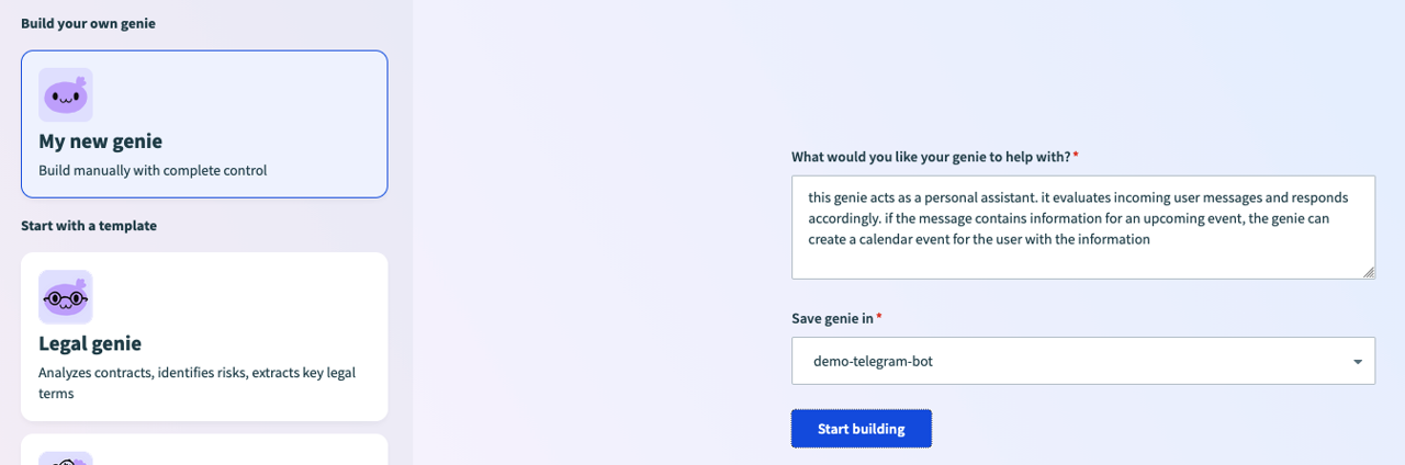

Go to the project where you plan to store your genie and click Create > Genie, or press C+G.
Enter a request or goal for your genie in the What would you like your genie to help with? field. For example:
plaintext
You are a personal assistant who responds to users' messages. If the message contains
information about an upcoming event, you can create a calendar event for the user
with the given information.
Use the Save genie in drop-down menu to select a location for your genie.
Create a new genieCreate a new genie
Click Start building. The genie Build page displays with the Job description automatically generated based on the input you provided. You can edit this to suit your requirements.

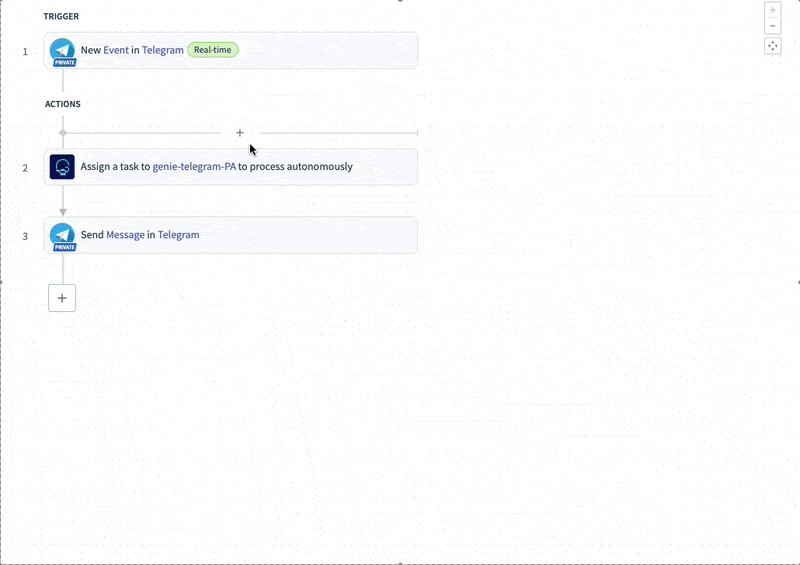

Return to the recipe editor and click + Add step before the Telegram Send Message action step.
Click + Add step before the Telegram Send Message action stepClick + Add step before the Telegram Send Message action step
Select Action in app, search for Workato Genie, and select it as your app.
Select the Assign task to genie action.
Use the Genie drop-down menu to select the genie you created in the preceding steps.

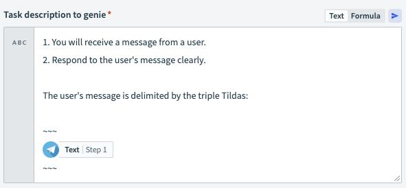

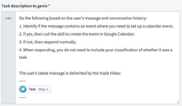

Enter a description that instructs the genie to process the incoming message and use the Google Calendar skill when appropriate in the Task Description field.
Map the Telegram trigger TextStep 1 datapill after your description in the Task Description field.
Configure the Task Description fieldConfigure the Task Description field
Click Save.

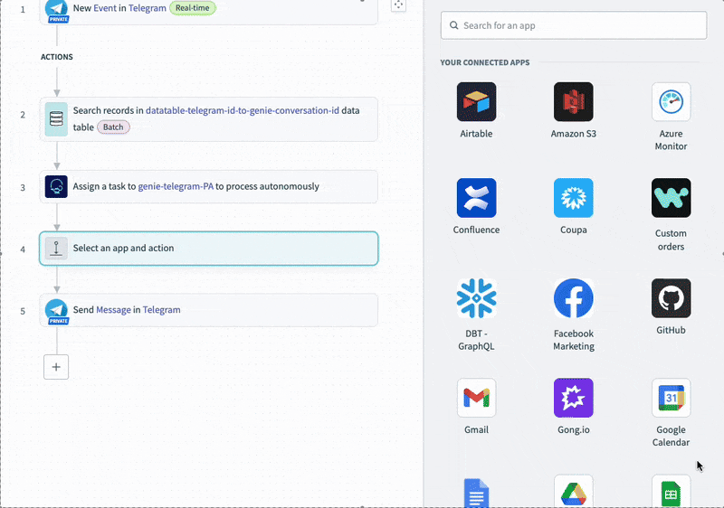

Add the Conversation ID to the recipe.
This steps adds a Workato Data tables Search records action that allows the recipe to refer to the Data table to see if the sender's Telegram ID has a corresponding Conversation ID in the data table. An existing Conversation ID indicates that there's a previous conversation which the genie can refer to.
Return the recipe editor and click + Add step before the Assign task to genie action step.
Select Action in app, search for Workato Data Tables, and select it as your app.
Select the Search records action.
Use the Data table drop-down menu to select the data table you created in the preceding steps.
Go to the Filter section and click Add filter.
Use the Column name drop-down menu to select telegram-id.
Use the Operand drop-down menu to select equals.
Map the Telegram IDStep 1 datapill to the Value field. This datapill is located under Telegram > Message > From.
Configure the data table to search TelegramConfigure the data table to search Telegram

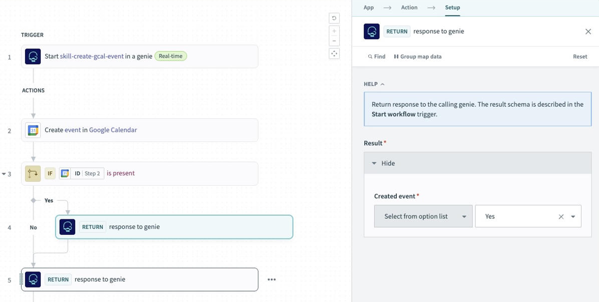

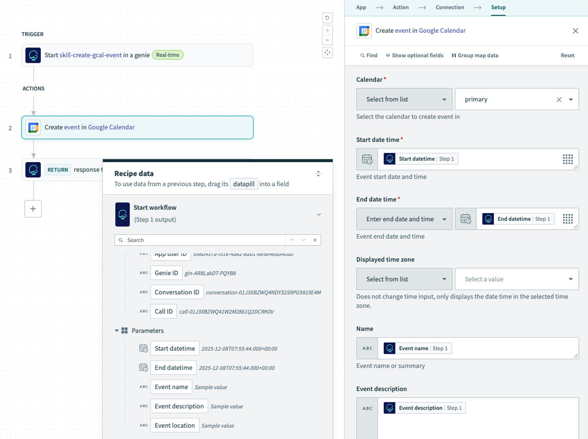

Create a skill recipe to convert messages into Google Calendar events.
This step creates a custom skill recipe that enables your genie to detect messages that should be converted into Google Calendar events.
Go to the Build page of the genie you created in the preceding steps.
Go to the Skills section and click + Add > Skill.
Select New skill and click Create new skill.
Alternatively, you can create a skill from the Projects page by clicking Create > Skill or pressing C+S.
Provide a name for your skill in the Name field. For example: Create Google Calendar event.
Use the Location drop-down menu to select a location for your skill recipe.

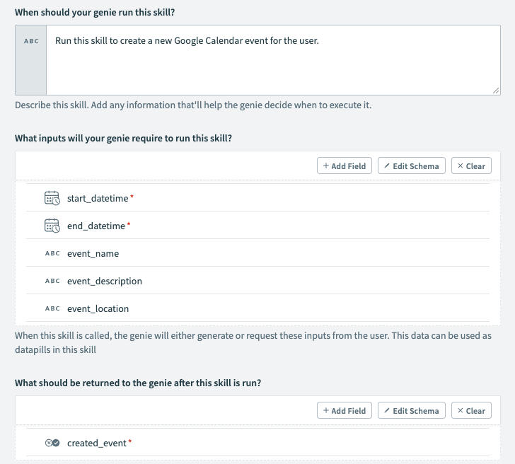

Click Start building. The recipe editor opens with the Start workflow trigger and Return response action automatically selected.
Select the Start workflow trigger.
Go to the What inputs will your genie require to run this skill? section and click Add fields manually. Add the following fields:
LabelData type
event_titleString
event_dateDate

Click the Assign task to genie step in the recipe editor.
Go to the Task Description field and update the description to use the following instructions:
DON'T REMOVE THE TELEGRAM DATAPILL
Don't remove the Telegram datapill you mapped to the Task Description field in previous steps.
plaintext
Do the following based on the user's message and conversation history:
1. Identify if the message contains an event where you need to set up a calendar event.
2. If yes, then call the skill to create the event in Google Calendar.
3. If not, then respond normally.
4. When responding, you do not need to include your classification of whether it was a task.
Click Save.
Update the Task DescriptionUpdate the Task Description
