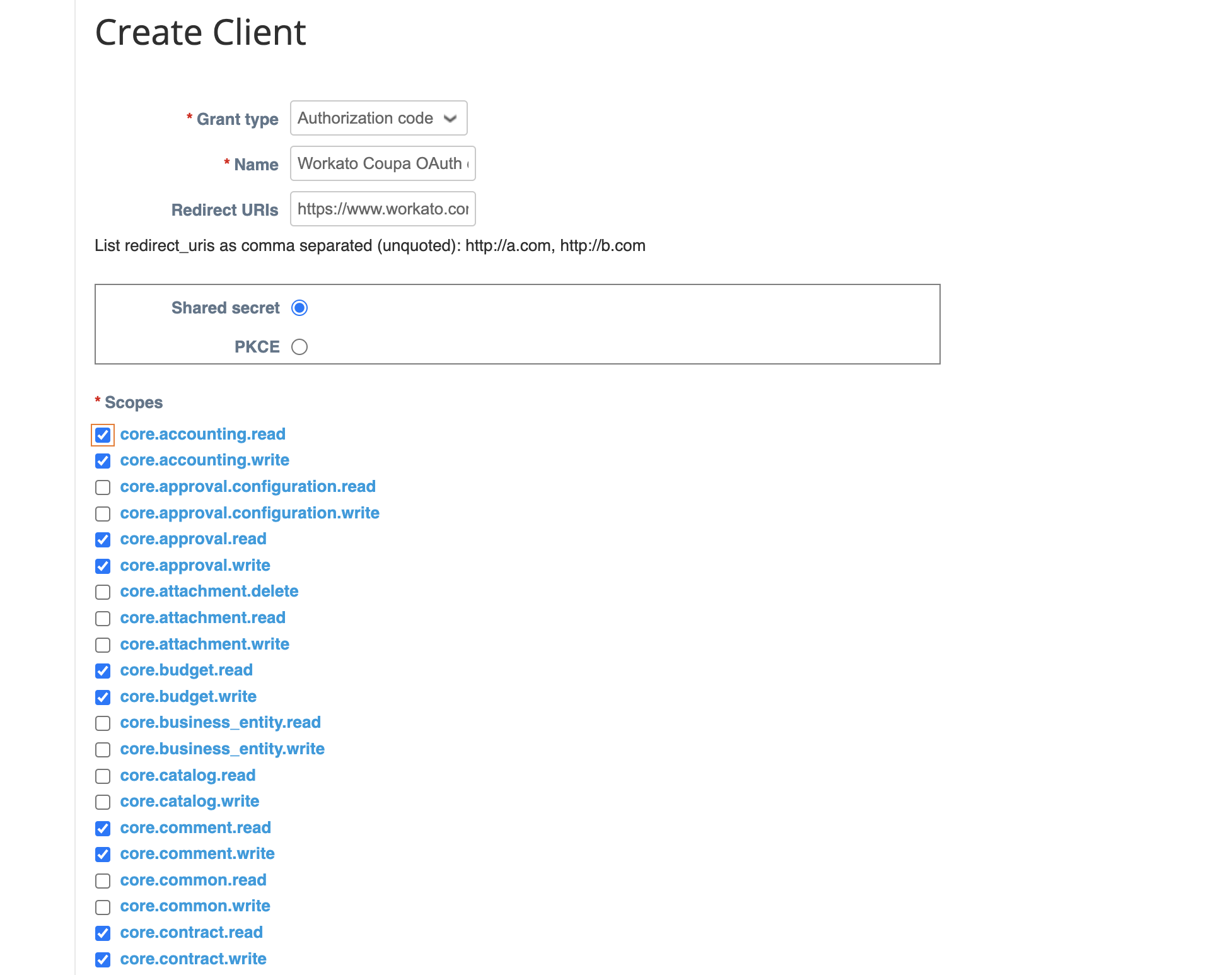

Sign in to your Coupa instance, for example https://[your-instance-name].coupacloud.com/oauth2/clients.
Click Create to create a new OAuth client.
Use the Grant type drop-down menu to select Authorization Code or Client Credentials. You must select the same option in Workato for the Authentication type.
Provide a name in the Name field. For example: Workato Coupa OAuth connection.
Enter the redirect URIs you plan to use in the Redirect URIs field. Add the link https://www.workato.com/oauth/callback if you plan to use Authorization code.
Select the scopes you plan to provide to Workato. Include all objects and features you plan to automate with the Coupa connector. The scopes you select must match the scopes you configure in Workato. You must include the core.common.read and offline_access scopes at a minimum to establish a connection.
Coupa creating a clientCreate a new client
Click Save.
Copy and store the Identifier and the Secret for use in Workato.

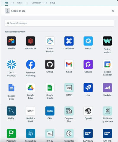

Search for and select Coupa as the app to monitor.
Select the Create object action.

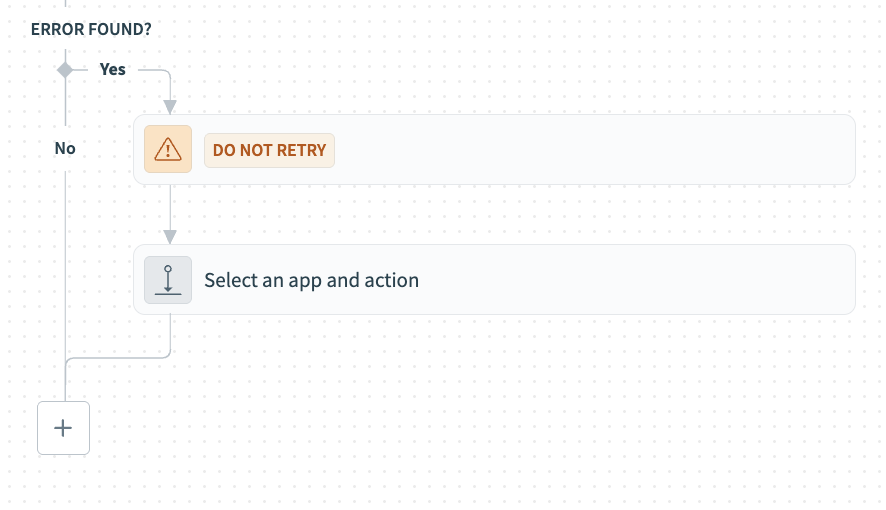

Go to the ERROR FOUND? block and confirm that the Yes branch shows DO NOT RETRY. This option is typically set by default.
Error found blockERROR FOUND? block

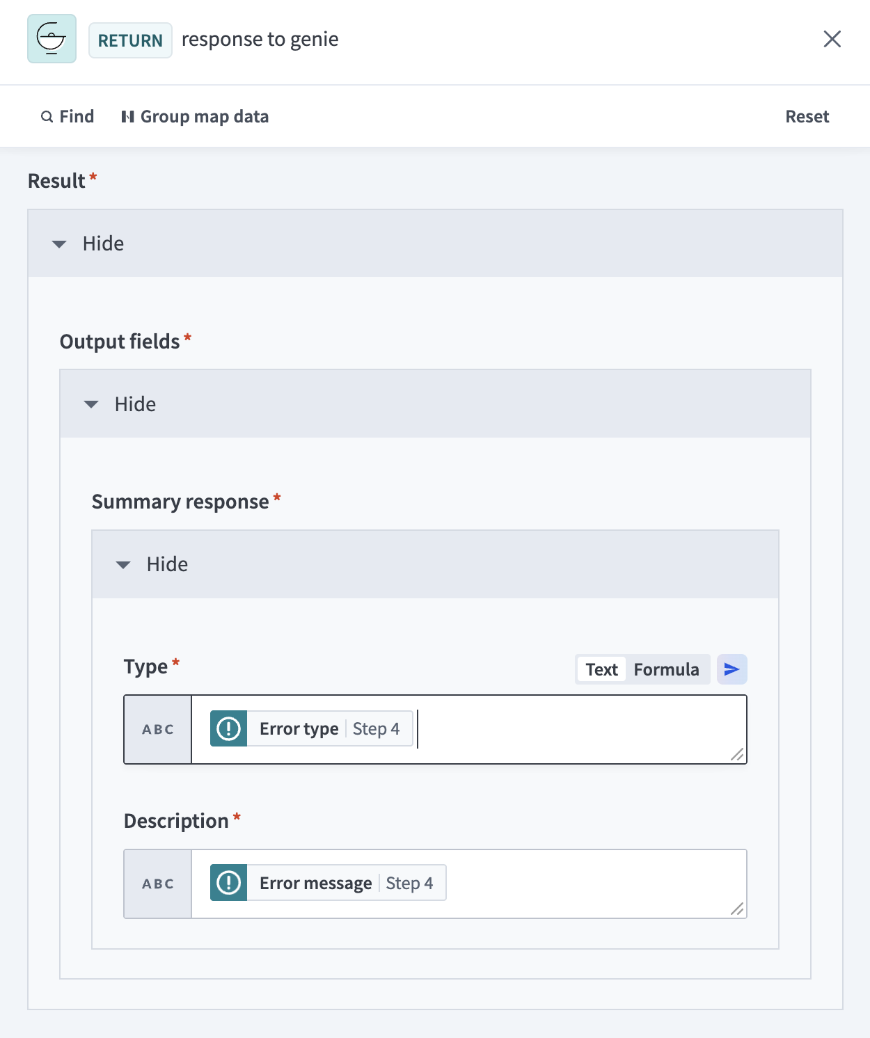

Go to the Yes branch and click Select and app and action.
Search for and select Workato Skill as your app.
Select the Return response action.
Map the Error typeStep 4 datapill to the Type field.
Map the Error messageStep 4 datapill to the Description field.
Map the error informationMap the error information
Click Save.

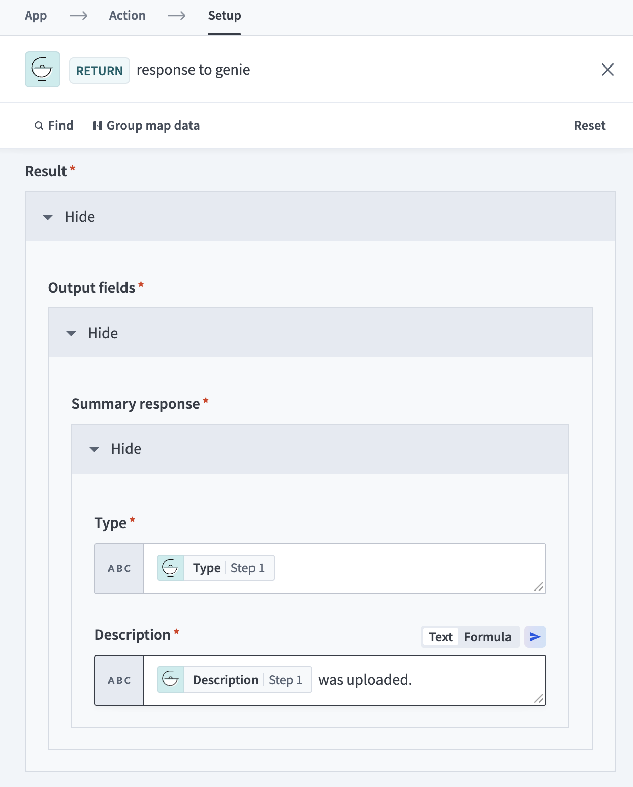

Go to the No branch. The Return response action should already be present.
Click the Return response action to open it.
Map the TypeStep 1 datapill to the Type field.
Map the DescriptionStep 1 datapill to the Description field.
Map the error informationMap the response information
12
Click Save.

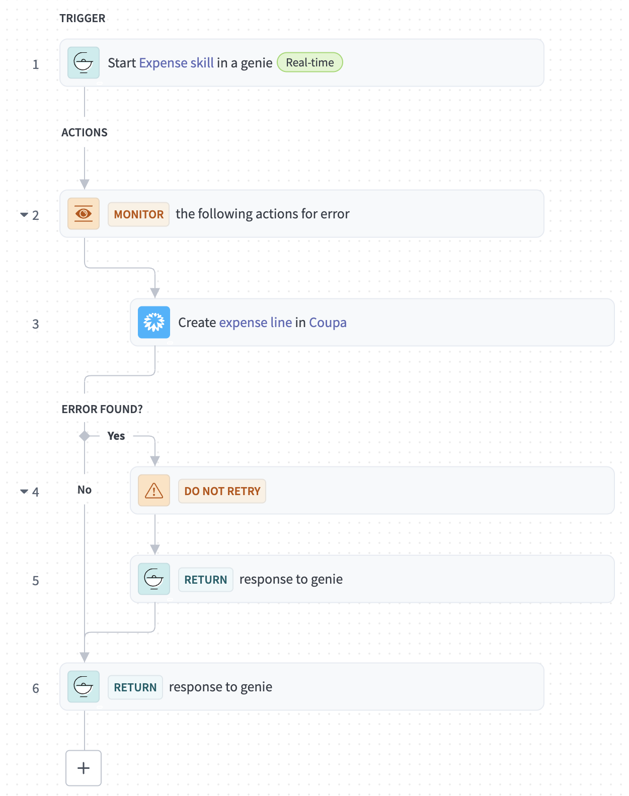

Example genie recipe configuration
Configured genie recipe exampleConfigured genie recipe example
