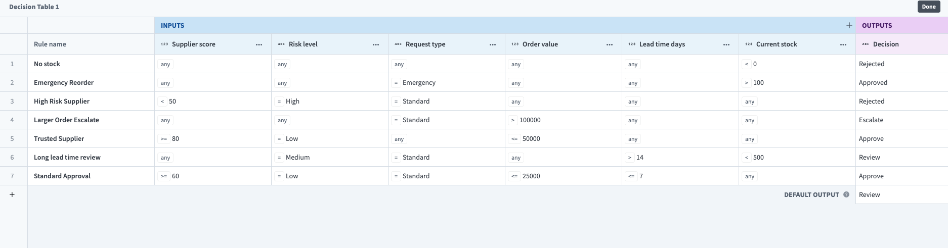

Open the Decision table node and add your fulfillment rules as rows. Rules are evaluated top to bottom: the first row that matches all conditions determines the output. You can also set a Default output that applies when no rule matches. For example:
Rule nameSupplier scoreRisk levelRequest typeOrder valueLead time daysCurrent stockDecision
No stockAnyAnyAnyAnyAny< 0Rejected
Emergency reorderAnyAnyEmergencyAnyAny> 100Approved
High risk supplier< 50HighStandardAnyAnyAnyRejected
Large order escalateAnyAnyStandard> 100000AnyAnyEscalate
Trusted supplier≥ 80LowAny≤ 50000AnyAnyApprove
Long lead time reviewAnyMediumStandardAny> 14< 500Review
Standard approval≥ 60LowStandard≤ 25000≤ 7AnyApprove
Default outputReview
Configure fulfillment rules in the decision tableAdd fulfillment rules as rows in the decision table
Click Save.

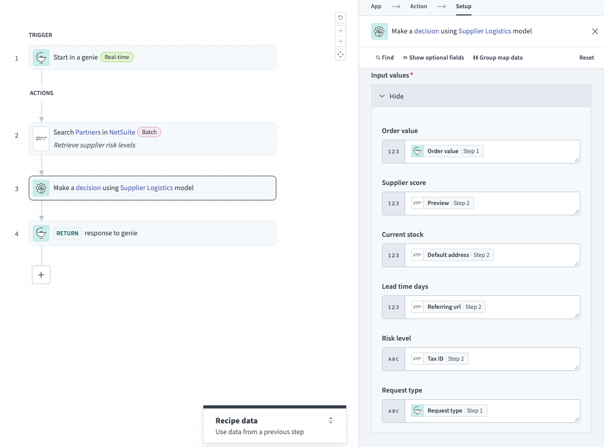

Add any steps needed to fetch data the decision model requires before making a decision. For example, use the Search action in a connector such as NetSuite to look up supplier risk scores and current inventory levels for the submitted product_id.
Click + Add step in the recipe editor.
Search for and select Decision Models by Workato.
Select the Make a decision action.
Use the Model name drop-down to select your Purchase order fulfillment model.
Map the input datapills to the model's input fields. For example:
  • order_valueOrder valueStep 1 from the skill trigger
  • request_typeRequest typeStep 1 from the skill trigger
  • supplier_scoreSupplier score from your supplier lookup step
  • risk_levelRisk level from your supplier lookup step
  • lead_time_daysLead time days from your supplier lookup step
  • current_stockCurrent stock from your supplier lookup step
Map datapills to decision model inputsMap datapills from earlier recipe steps to the decision model's input fields
Click Save.
