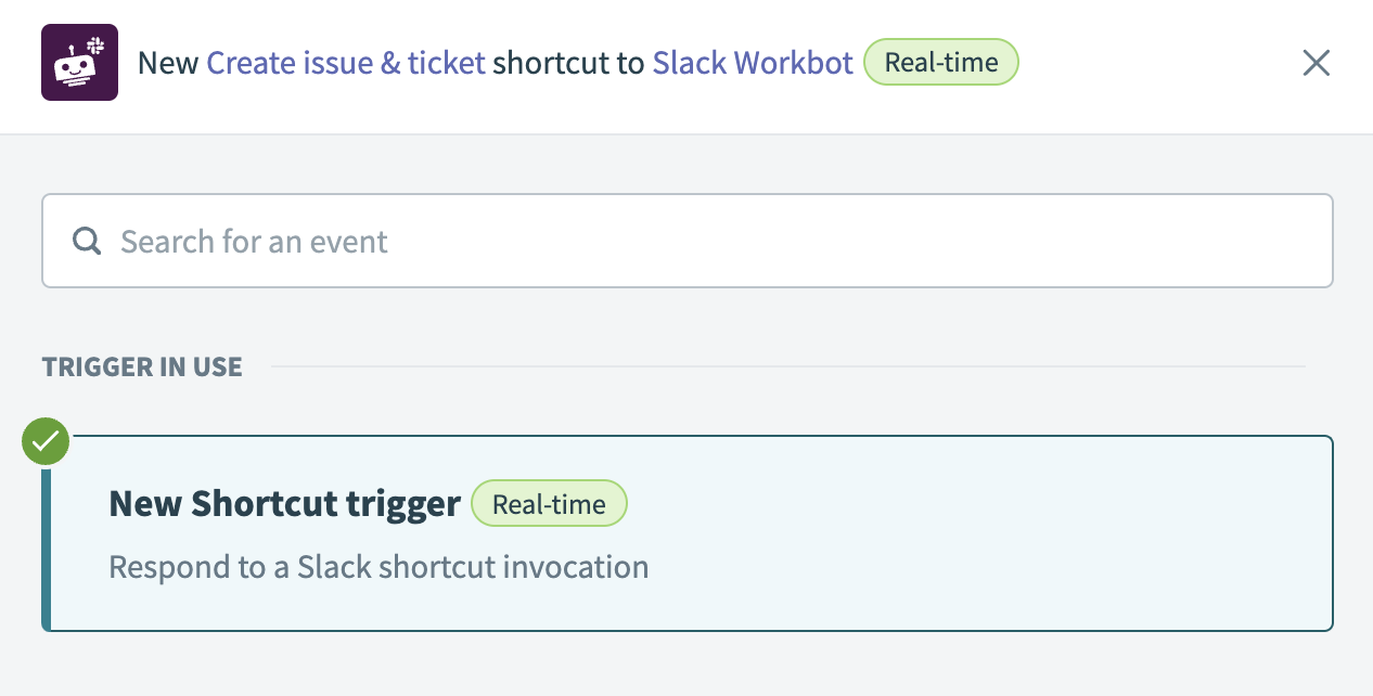

Set up your Workbot for Slack New shortcut trigger.
Set up Workbot for Slack New shortcut trigger
This trigger monitors Workbot for Slack for new shortcuts.
Search for Workbot for Slack and select it as your app.
Choose Workbot for Slack as your appChoose Workbot for Slack as your app
Select the New Shortcut trigger.
New shortcut triggerNew Shortcut trigger

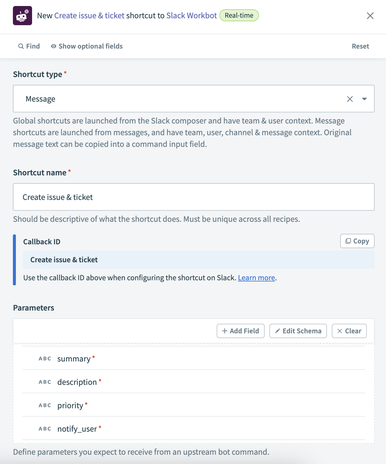

Use the Shortcut type drop-down menu to select Message.
Setup shortcut triggerSet up your Shortcut trigger
Enter a name in the Shortcut name field. For example, Create issue & ticket.
Click Add field in the Parameters section.
Enter Summary in the Name field.
Enter a label in the Label field.
Select String from the Data type drop-down menu.
Select No from the Optional? drop-down menu.
Enter additional help text in the Hint field.
Select Text from the Dialog control type drop-down menu.
Summary input fieldSummary input field

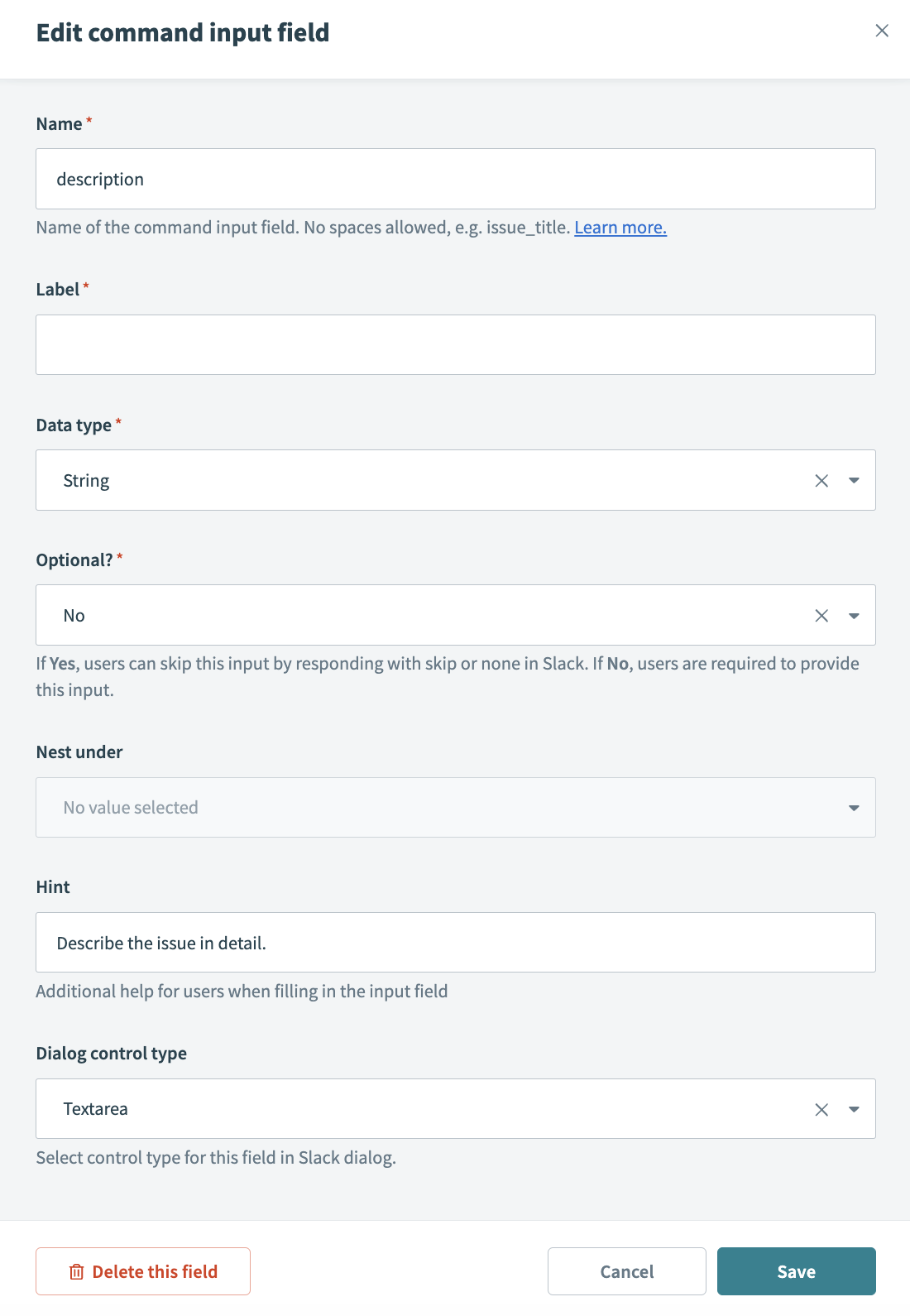

Select Textarea from the Dialog control type drop-down menu.
Description input fieldDescription input field

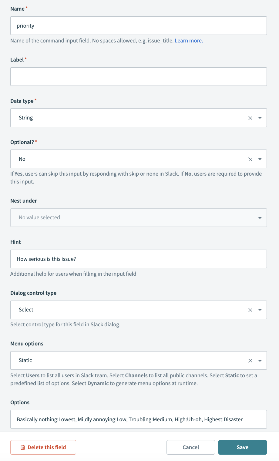

Enter Priority in the Name field.
21
22
23
24
Enter additional help text in the Hint drop-down menu.
25
Select Static from the Menu options drop-down menu.
26
Enter a list of comma-separated priority levels in the Options field.
Priority input fieldPriority input field

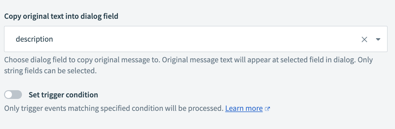

Use the Copy original text into dialog field drop-down menu to select Description.
notify_user input fieldSelect Description

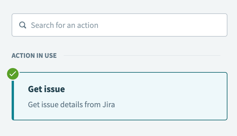

Select the Get issue action.
Get issueSelect the Get issue action

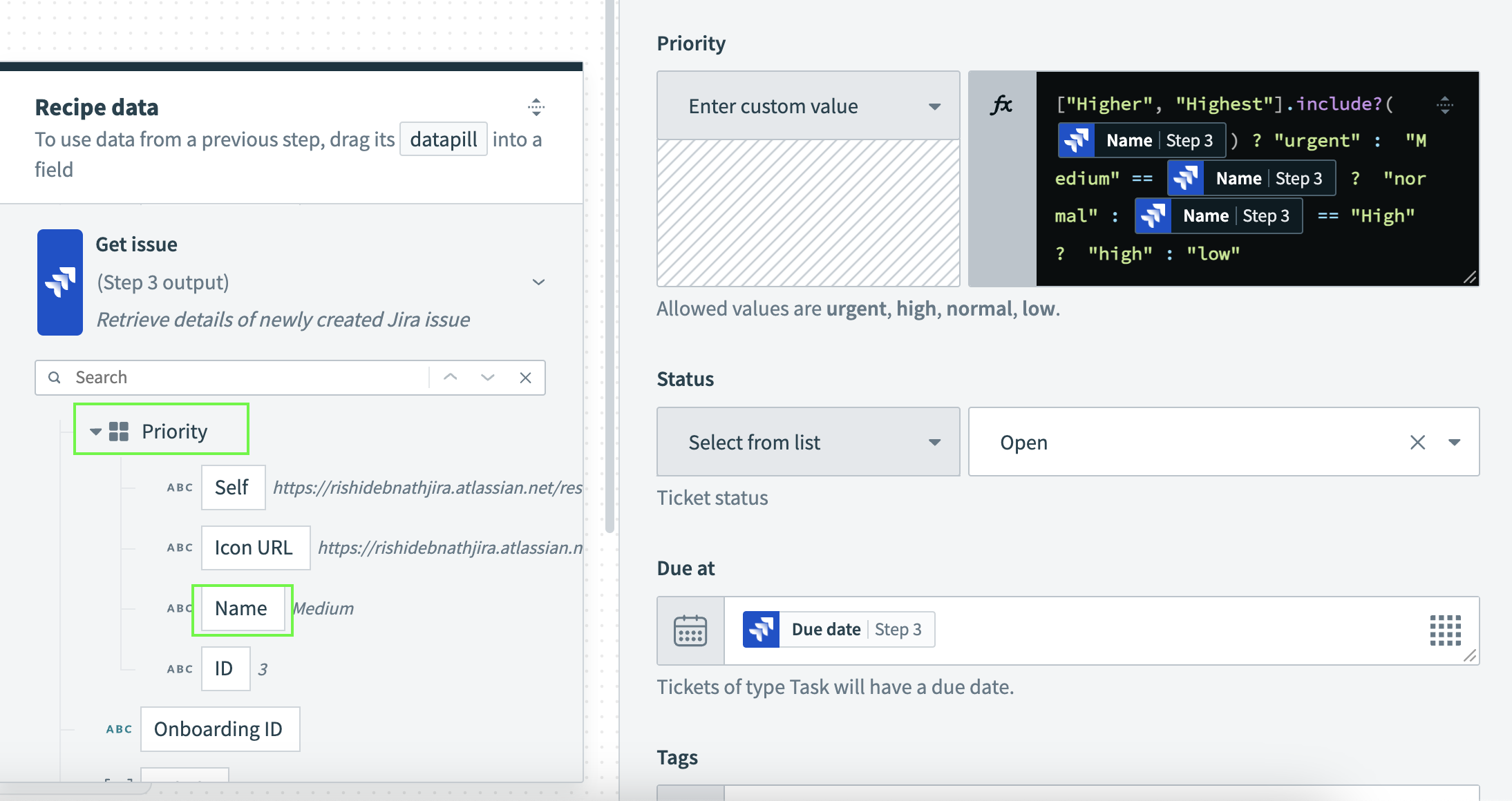

Use the Priority drop-down menu to select Enter custom value and then click Formula.
Set priority to formulaSet the Priority field to Formula
Copy and paste the following formula into the Priority field:
=["Higher", "Highest"].include?(_dp('{"pill_type":"output","provider":"jira","line":"9e7af602","path":["fields","priority","name"]}')) ? "urgent" :  "Medium" == _dp('{"pill_type":"output","provider":"jira","line":"9e7af602","path":["fields","priority","name"]}') ?  "normal" : _dp('{"pill_type":"output","provider":"jira","line":"9e7af602","path":["fields","priority","name"]}') == "High" ?  "high" : "low"
Priority formulaPriority formula

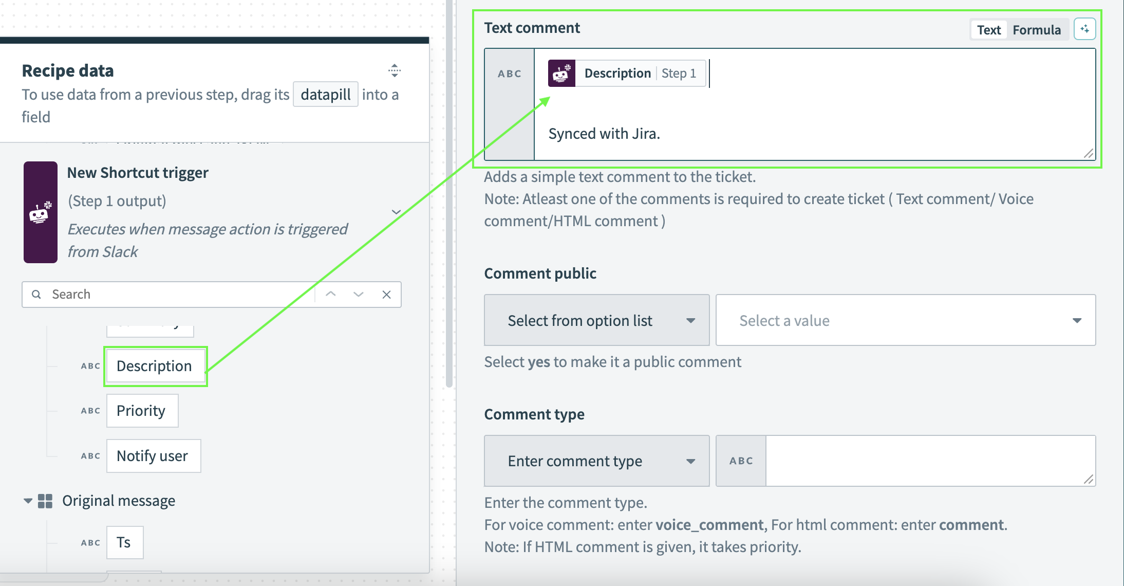

Map the Workbot for Slack DescriptionStep 1 datapill to the Text comment field.
Map descriptionConfigure the Text comment field

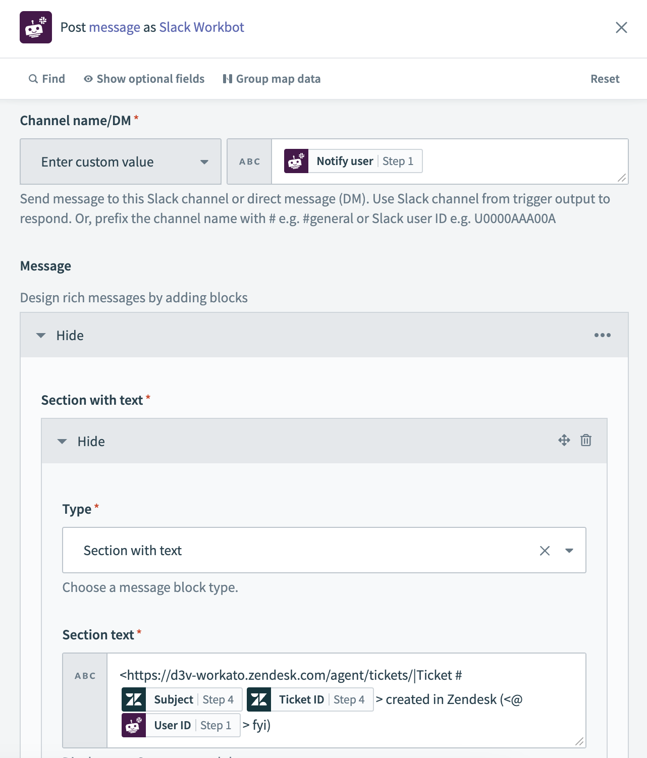

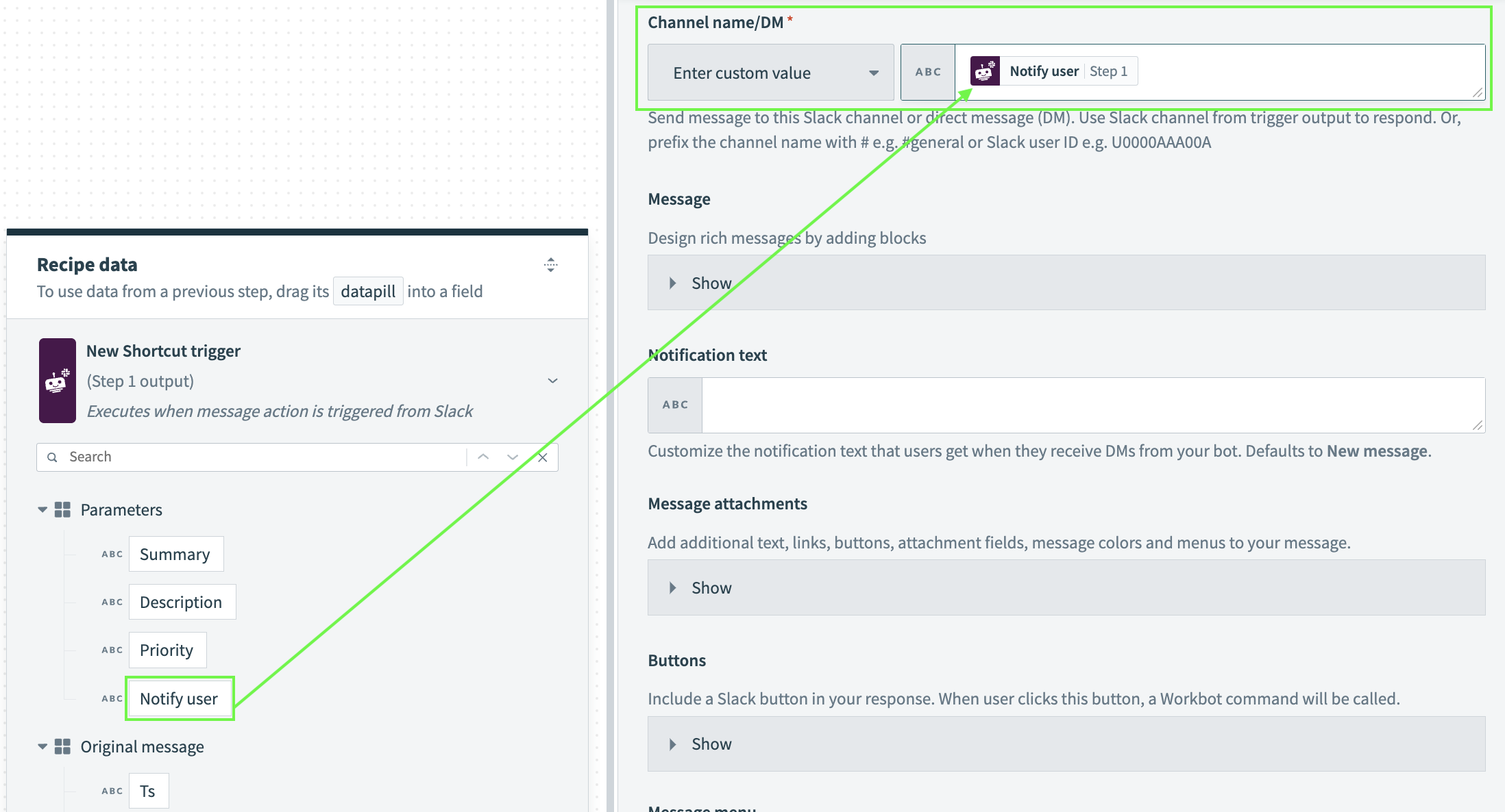

Map the Workbot for Slack Notify userStep 1 datapill to the Channel name/DM field.
Notify userConfigure the Channel name/DM field
Click Add block to message and use the Type drop-down menu to select Section with text.
Add block messageClick the Add block to message button
Map the Zendesk SubjectStep 4 datapill, the Zendesk Ticket IDStep 4 datapill, and the Workbot for Slack User IDStep 1 datapill to the Section text field.
Map section textMap the Section text field

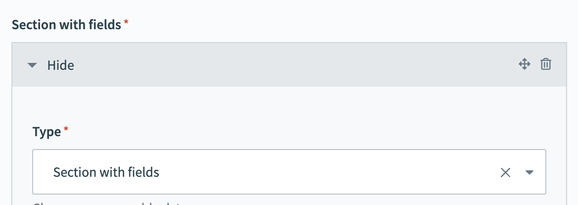

Click Add block to message and use the Type drop-down menu to Section with fields.
Section with fieldsSection with fields

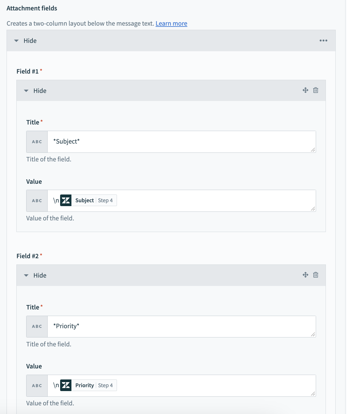

Locate the Attachment fields section and click Add field.
Add fieldClick the Add field button
Enter Subject in the Title field.
Map the Zendesk SubjectStep 4 datapill to the Value field.
Attachment fieldsAdd a Subject field
Click Add field to add a second field.
Enter Priority in the Title field.
12
Map the Zendesk PriorityStep 4 datapill to the Value field.
13
Click Add field to add a third field.
14
Enter Description in the Title field.
15
Switch the Value field to formula mode and copy and paste the following formula:
="\n"+_dp('{"pill_type":"output","provider":"zendesk","line":"create_ticket","path":["description"]}')[0...65]+"..."
Attachment fieldsAdd a Description field
16
Click Add field to add a fourth field.
17
Enter Status in the Title field.
18
Map the Zendesk StatusStep 4 datapill to the Value field.
19

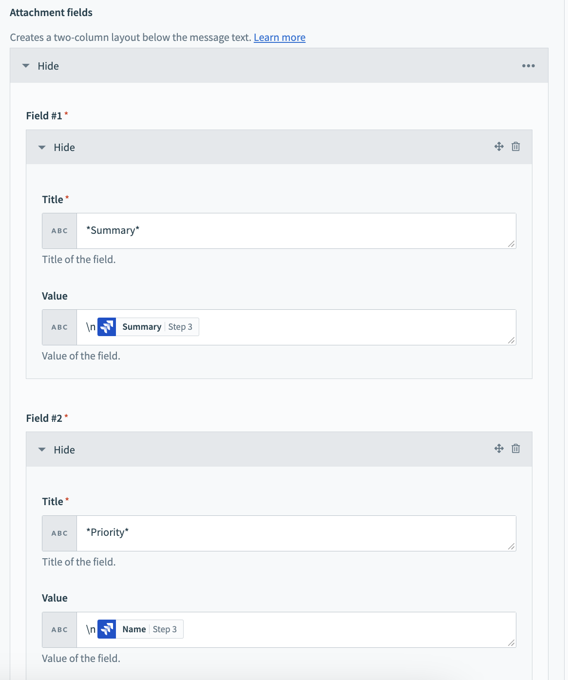

Enter Summary in the Title field.
Map the Jira SummaryStep 3 datapill to the Value field.
Attachment fieldsAdd a Summary field
Enter Priority in the Title field,
Map the Jira NameStep 3 datapill to the Value field.

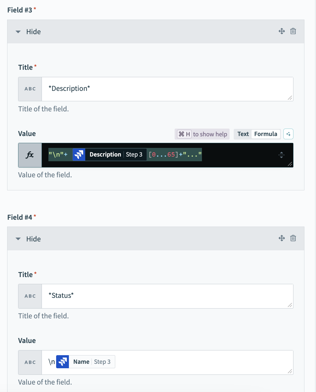

14
="\n"+ _dp('{"pill_type":"output","provider":"jira","line":"9e7af602","path":["fields","description"]}')[0...65]+"..."
Description fieldAdd a Description field
15
16
17
