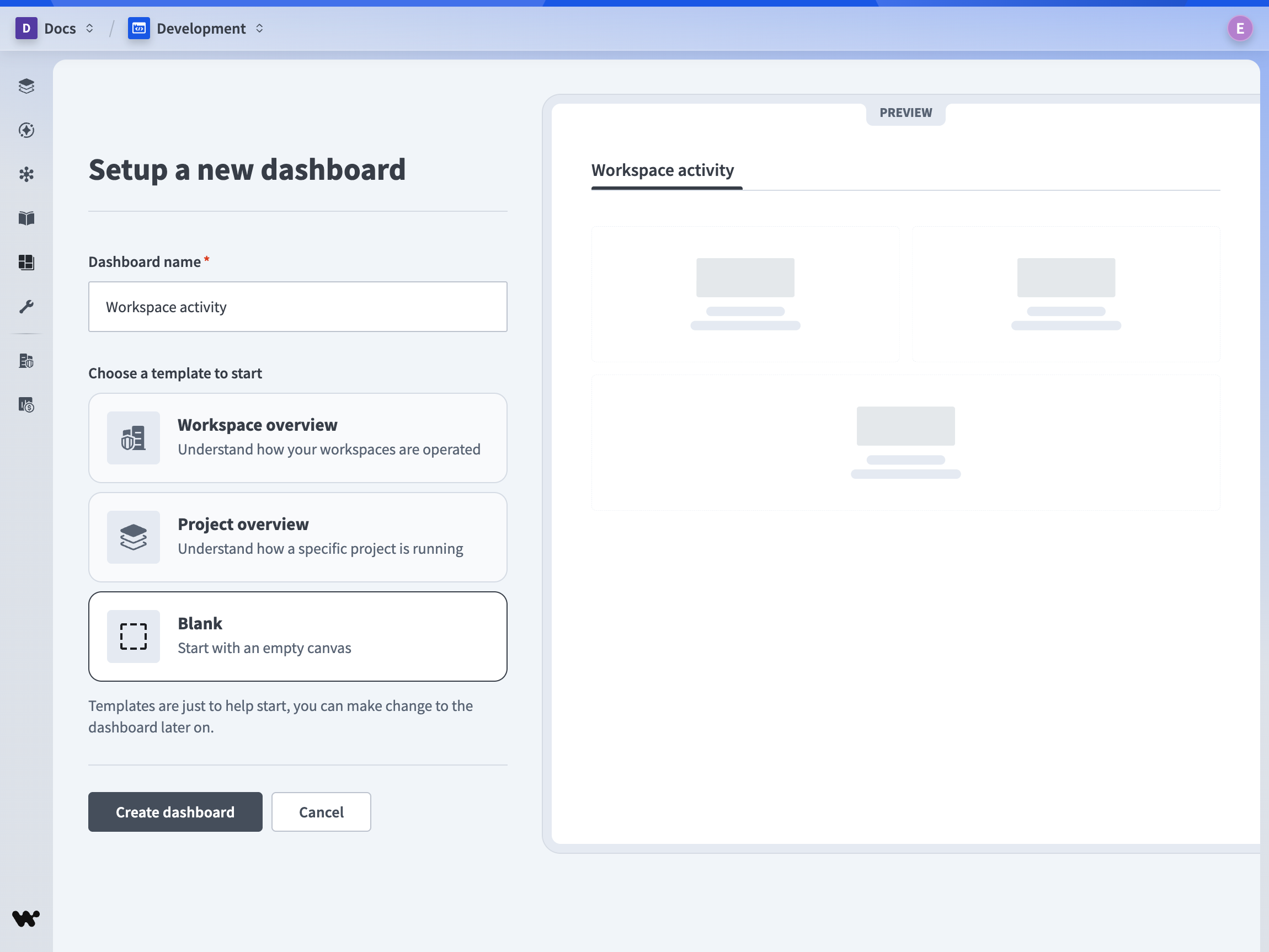

Go to Platform > Insights and select Create dashboard.
Create a new dashboard
Name your dashboard Workspace activity and select the Blank template.
Name your dashboard
DASHBOARD TEMPLATES
The Blank template lets you build a dashboard from scratch. Dashboard templates are also available for common workspace and project views.
Click Create dashboard to open the dashboard editor.

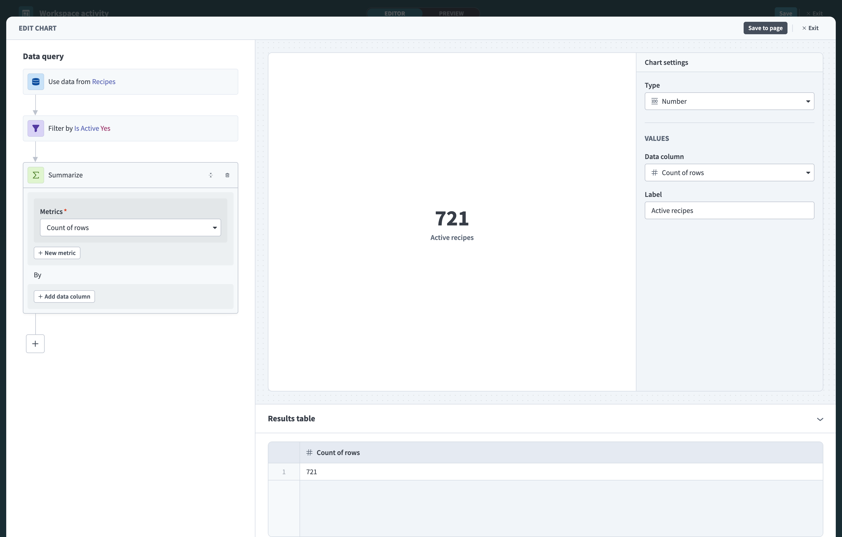

Chart 1: Active recipes
This KPI chart shows how many recipes are currently running in your workspace. Use this to verify that your automations are running as expected.
Active recipes KPI chart

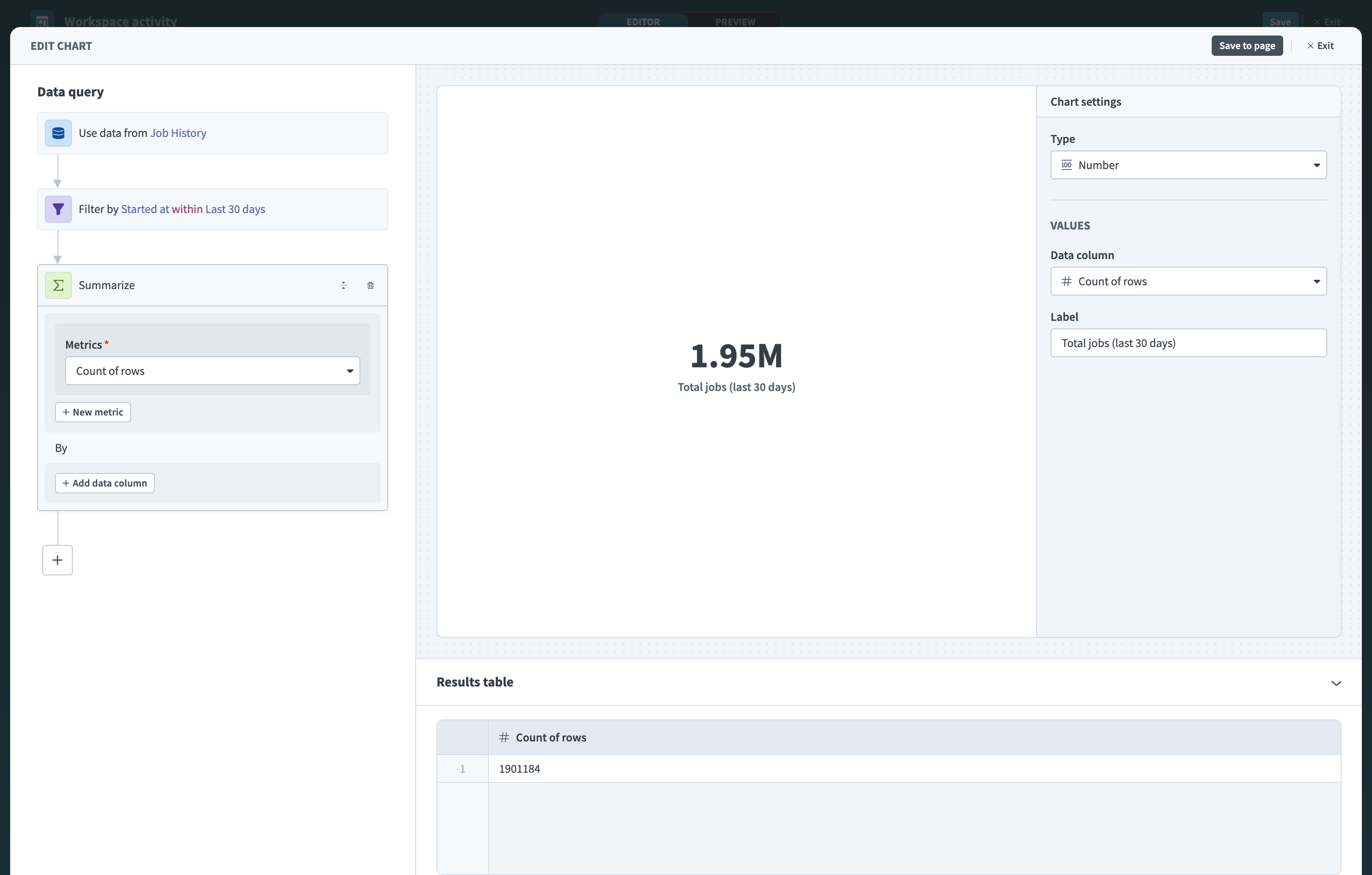

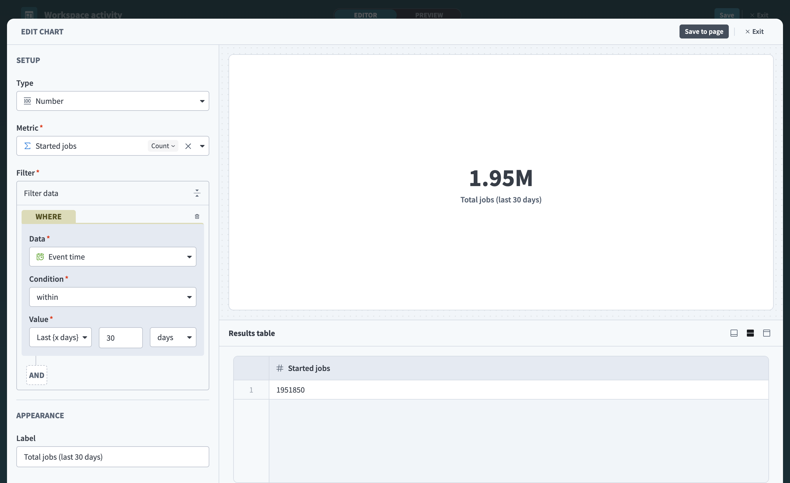

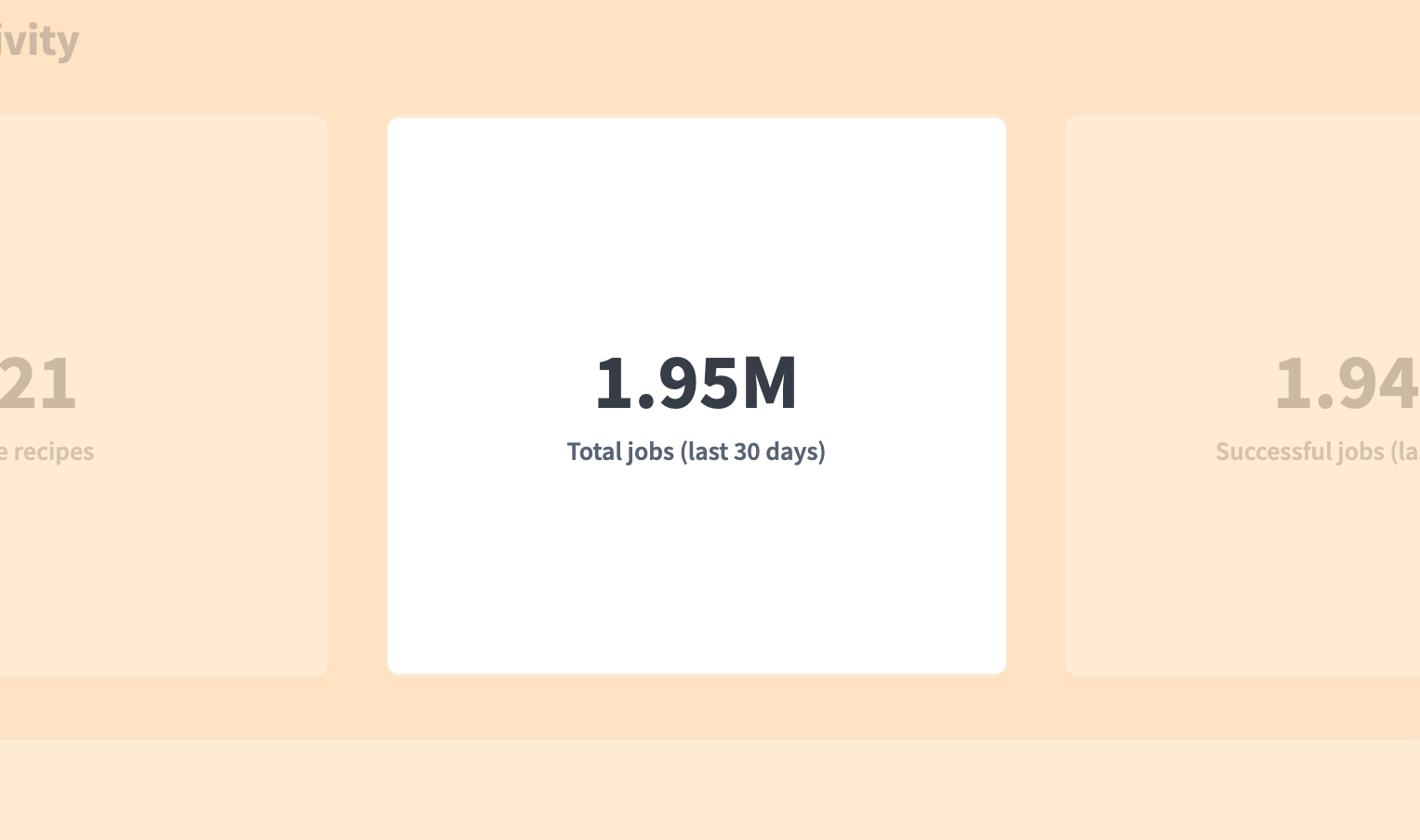

Chart 2: Total jobs (last 30 days)
This KPI chart shows how many jobs ran in your workspace over the past 30 days. Use this to measure how actively your automations are being used.
Total jobs chart

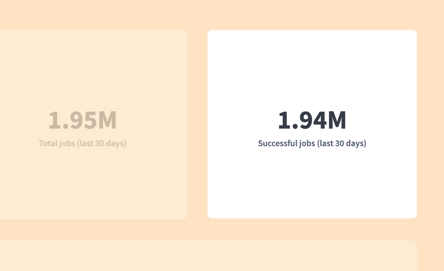

Chart 3: Successful jobs (last 30 days)
This KPI chart shows how many jobs completed without errors in the past 30 days. Use this alongside total jobs to see how reliably your automations are running.
Successful jobs chart

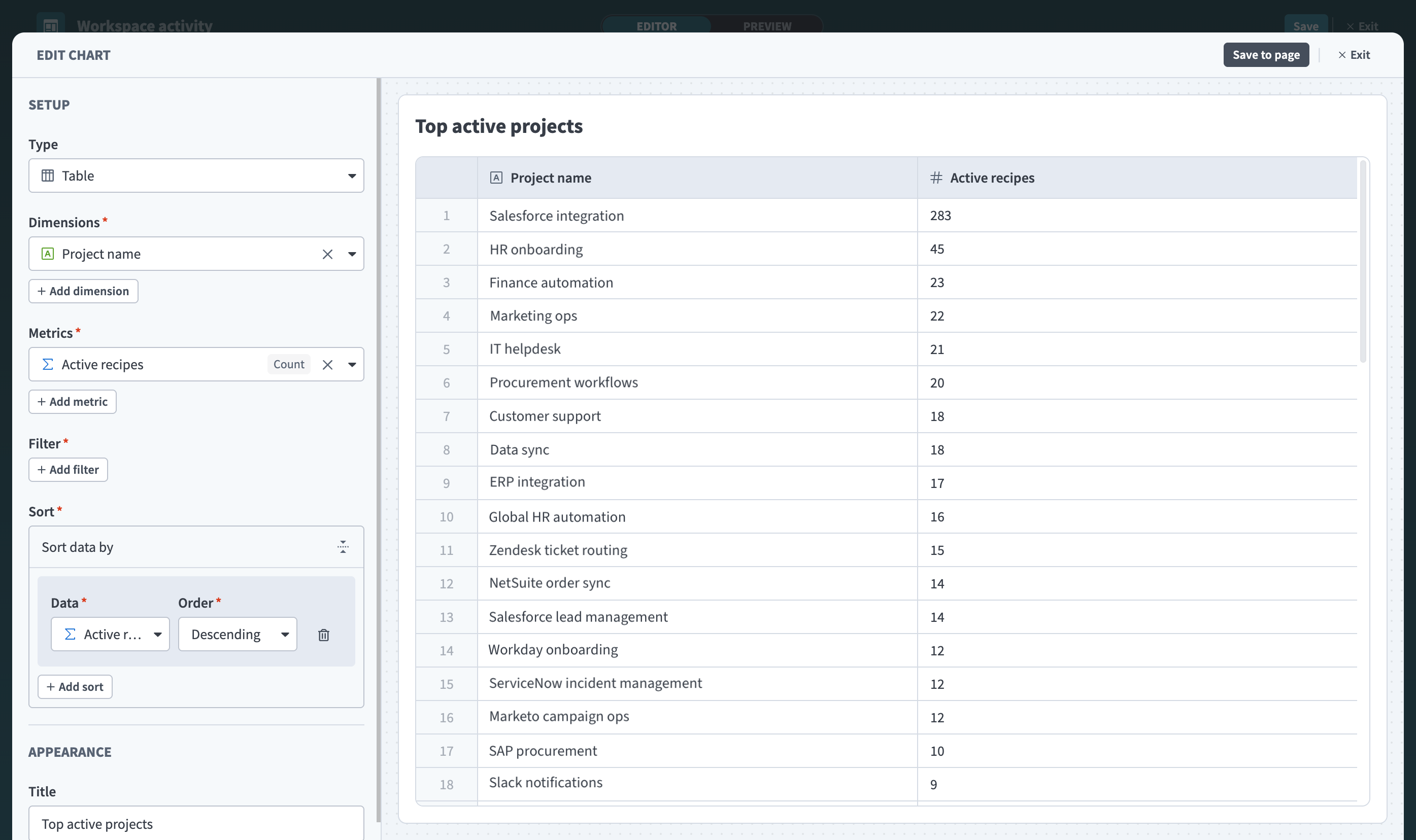

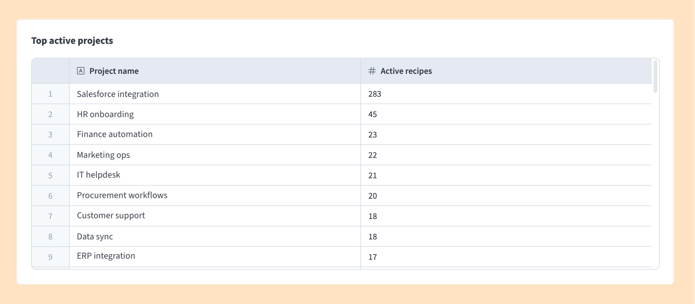

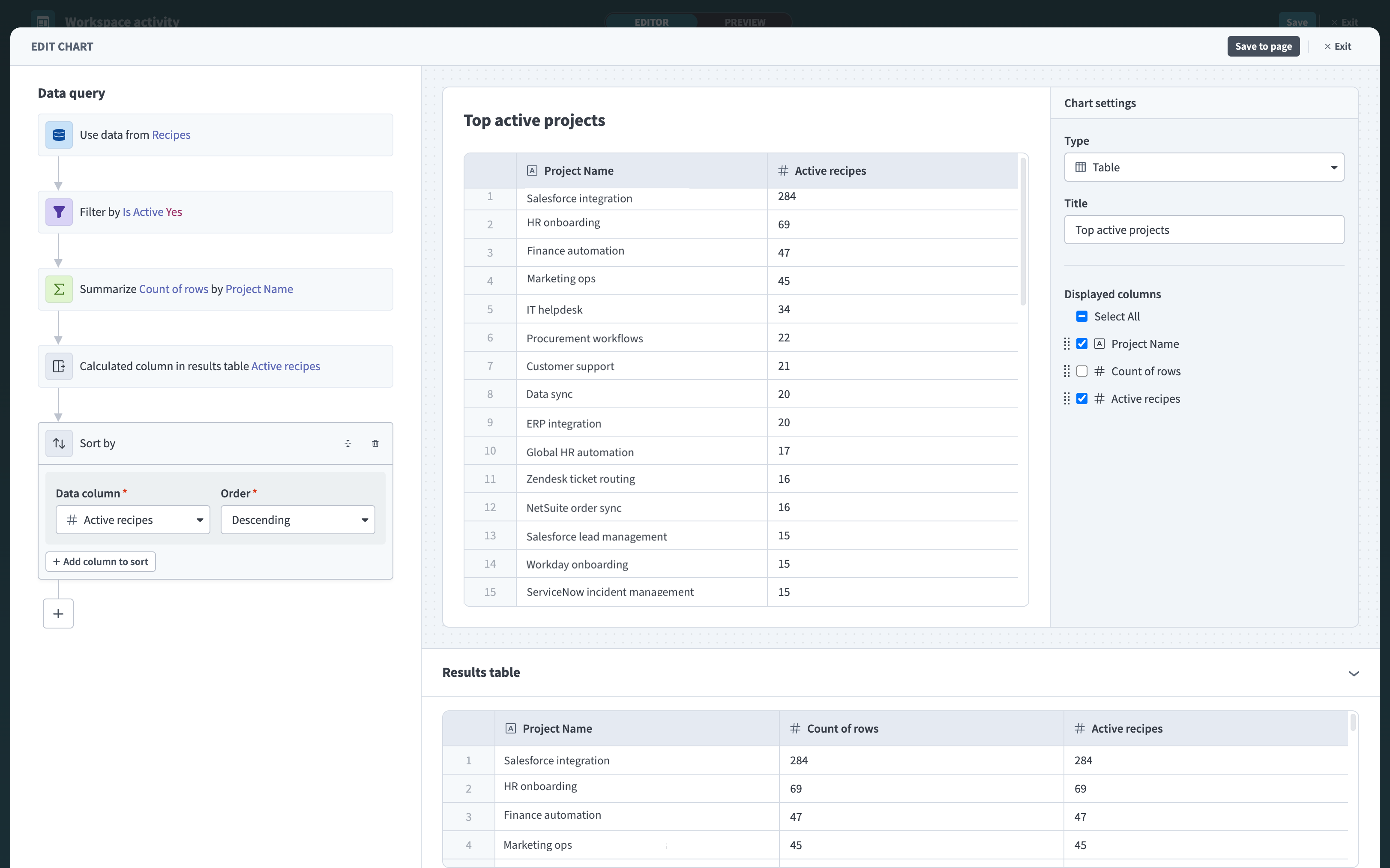

Chart 4: Top active projects
This table ranks your projects by the number of active recipes. Use this to see which projects have the most automations running and understand automation adoption across teams or departments.
Top active projects chart

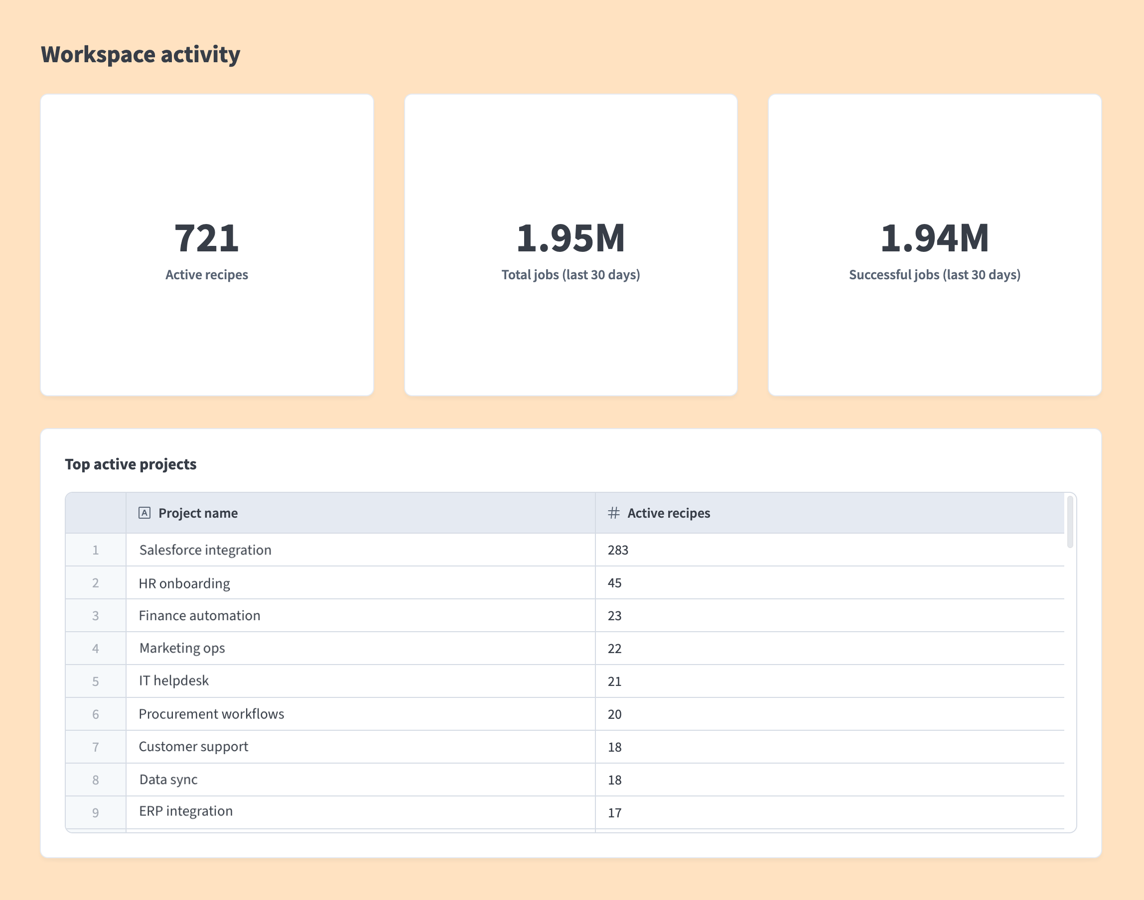

Save your dashboard
Complete the following steps to save and view your dashboard:
Click Save in the dashboard editor.
Click Preview to see how your dashboard looks to viewers.
Example: Active recipes dashboard
Your dashboard shows:
- Three key metrics about workspace activity
- A table of your most active projects
Click Exit to return to the Insights homepage.
Your dashboard updates automatically as new jobs run in your workspace.

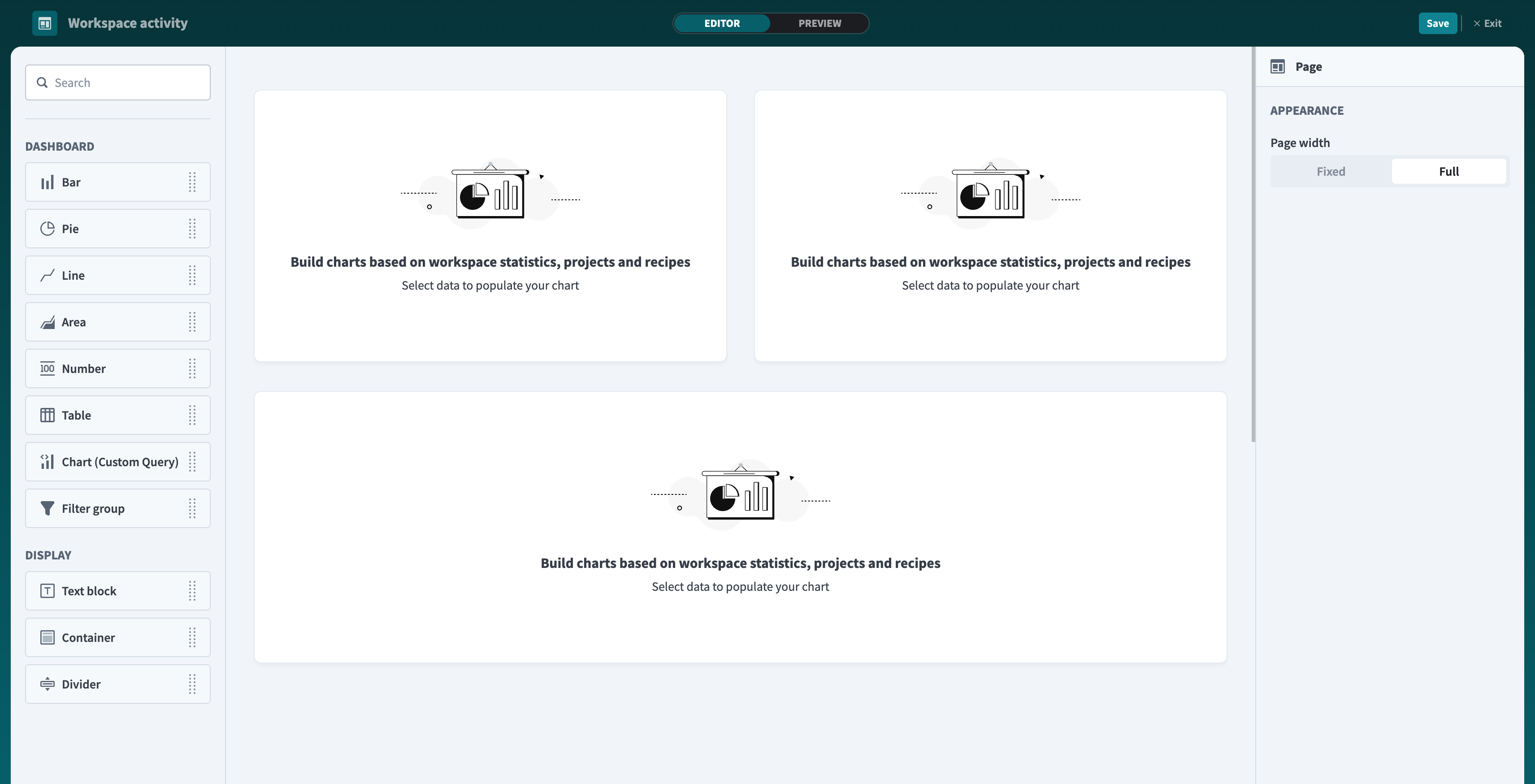

Dashboard editor with Report builder: the components panel shows specific chart types (KPI, Table, Bar, and others) along with a Filter group option
Dashboard editor with Query builder: the components panel shows a generic Chart component and a Filter group option

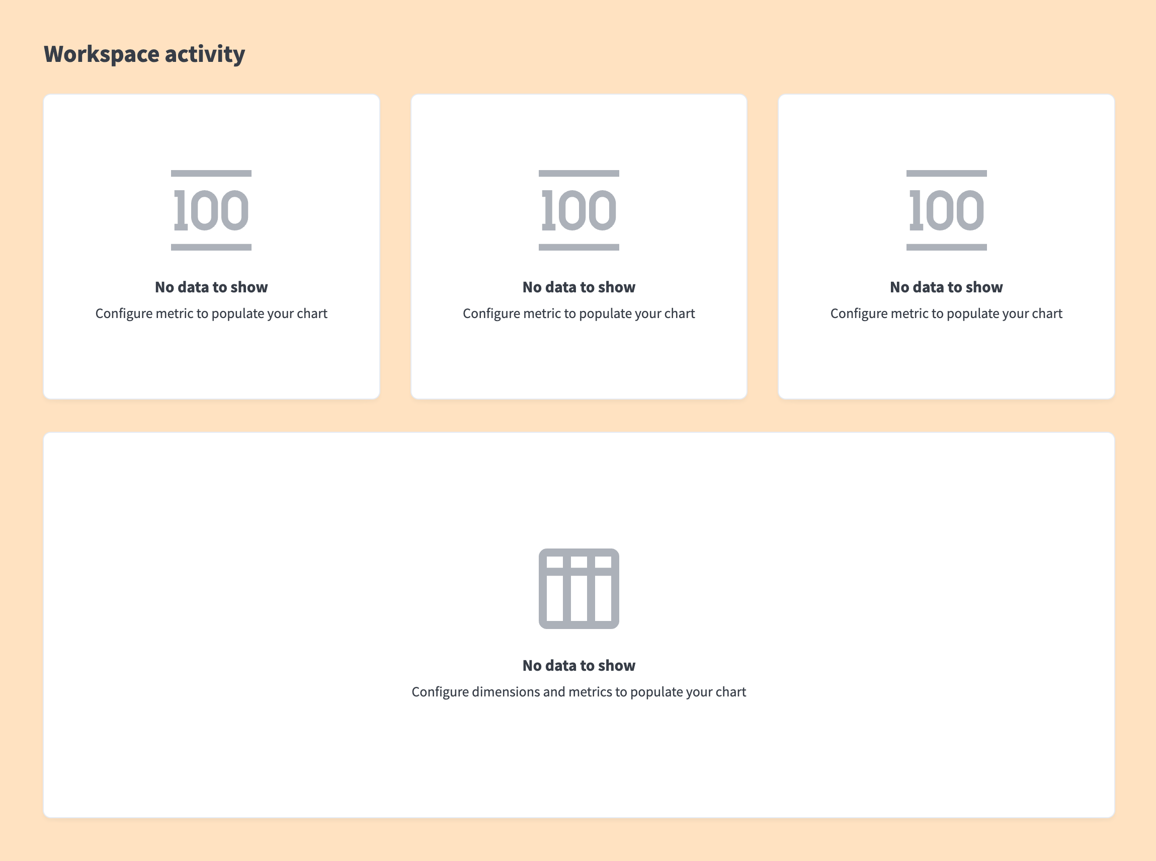

Target layout: three KPI charts on the top row, table spanning full width below
Target layout: three charts on the top row, one chart spanning full width below
Active recipes chart configured in the Report builder
Active recipes chart configured in the query builder
Total jobs chart with date filter and custom label
Successful jobs chart with date filter and custom label
Top active projects table configured with dimensions, metrics, and sort order
