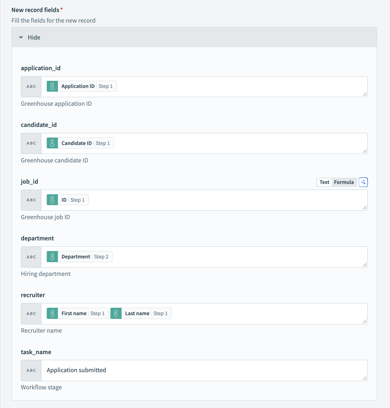

Complete the following actions in the New record fields section:
Map the Application IDStep 1 datapill to the application_id field.
Map the Candidate IDStep 1 datapill to the candidate_id field.
Map the Job IDStep 1 datapill to the job_id field.
Map the DepartmentStep 2 datapill to the department field.
Map the First nameStep 1 and Last nameStep 1 datapills to the recruiter field.
Enter Application submitted in the task_name field.
Your configuration should look as follows:
Map datapillsMap datapills from meaningful business events in other applications to create a record in a data table

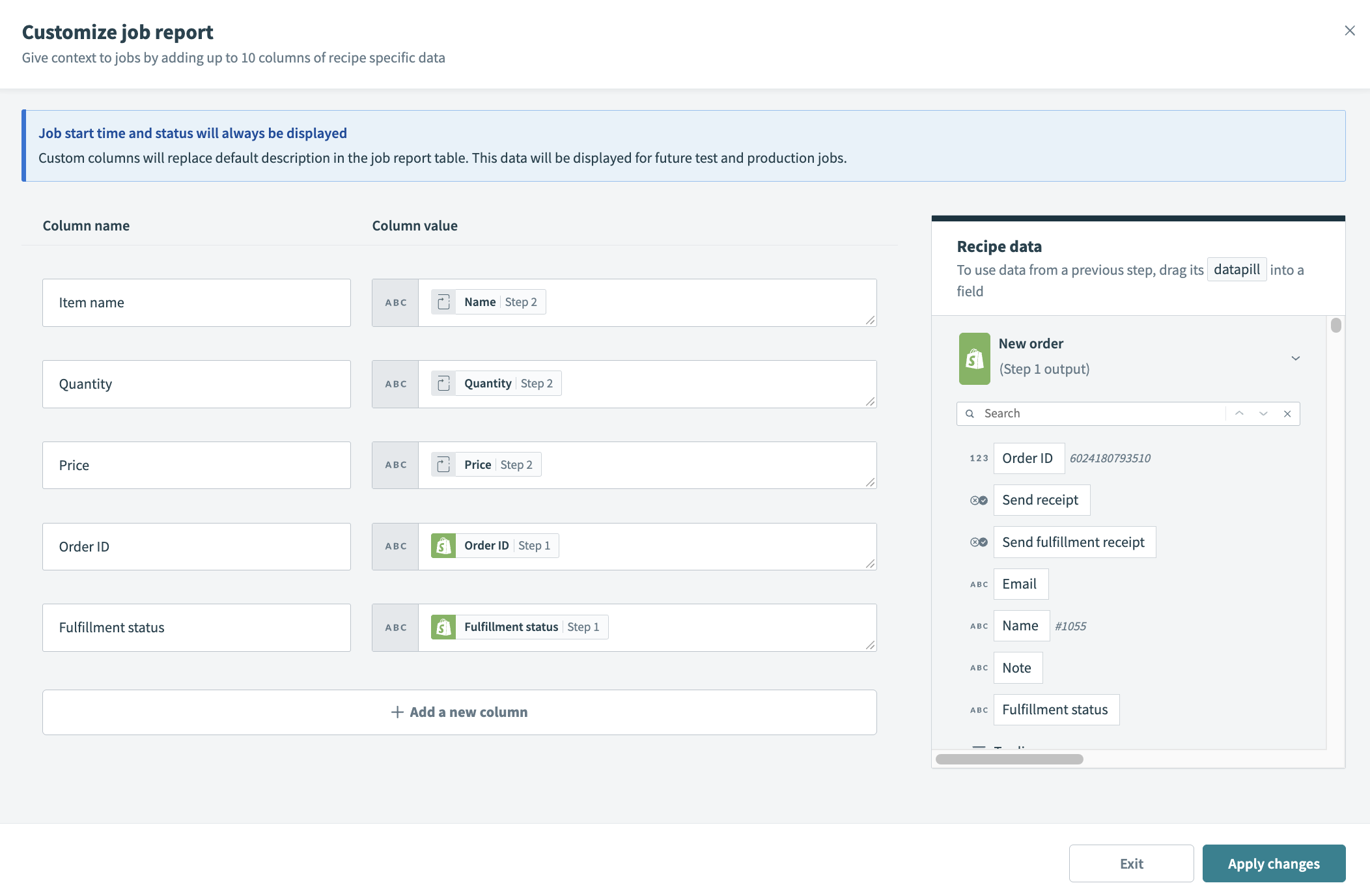

Customize your job reports to surface meaningful information from your recipes. You can add up to 10 additional columns and custom job report columns support datapill input. Job reports are subject to your workspace's data retention policy.
In this example, the Integration Lead is assessing the effectiveness of an automated order processing workflow to evaluate efficiency gains driven by automation. They plan to surface data from the order, such as the order ID, fulfillment status, name, item quantity, and price in their job reports.
Select a recipe job report to customize. Your recipe must be inactive to customize its job report.
Go to the Jobs tab.
Click the ... (ellipsis) and select Customize job report.
Click + Add a new column.
Create the following custom columns:
Go to the Column name field, type Item name, and map the NameStep 2 datapill to the Column value field.
Go to the Column name field, type Quantity, and map the QuantityStep 2 datapill to the Column value field.
Go to the Column name field, type Price, and map the PriceStep 2 datapill to the Column value field.
Go to the Column name field, type Order ID, and map the Order IDStep 1 datapill to the Column value field.
Go to the Column name field, type Fulfillment status, and map the NameStep 1 datapill to the Column value field.
Customize job reportMap datapills to custom columns in your job reports
Click Apply changes.

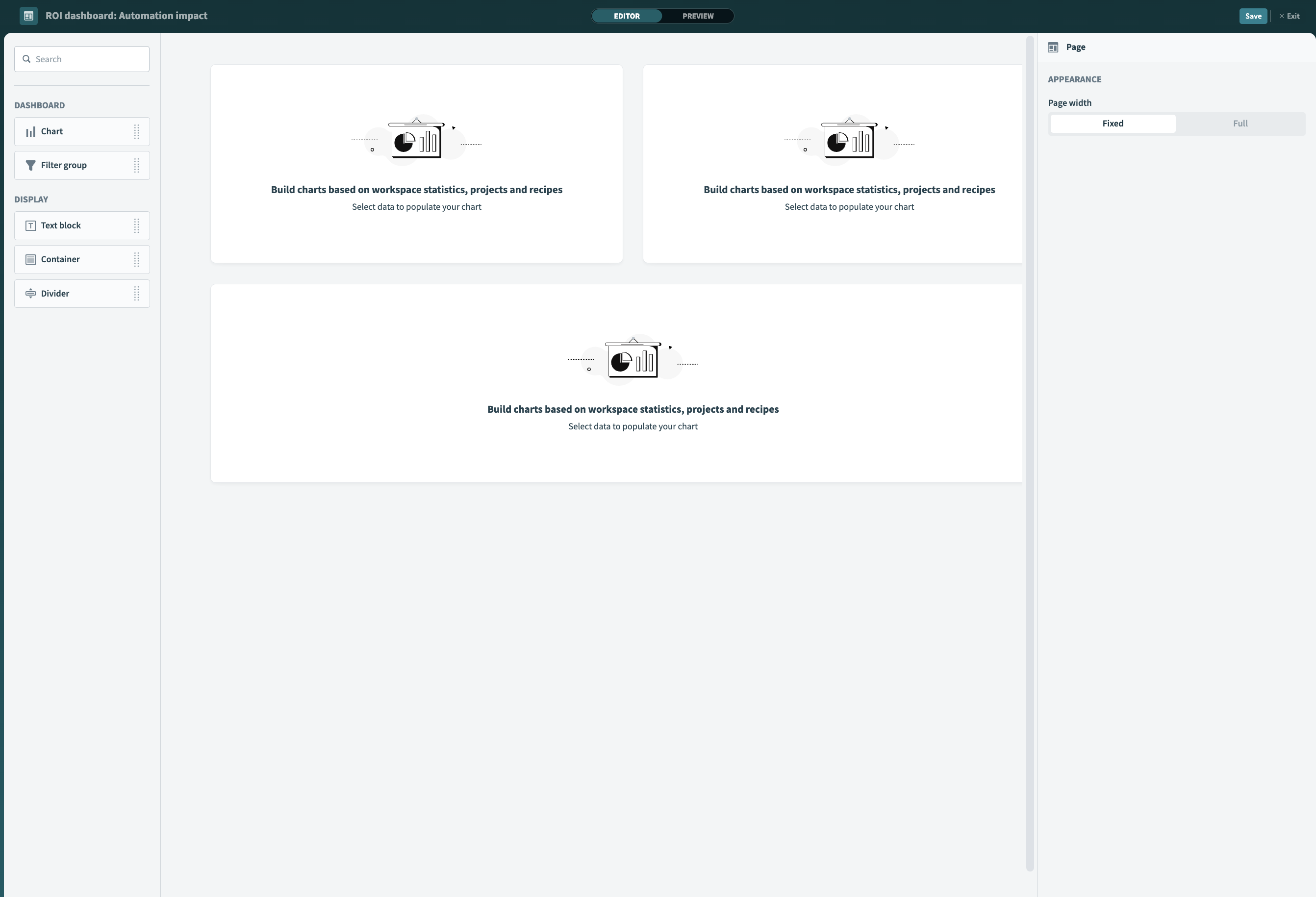

Determine the width of your dashboard. Insights supports Full and Fixed width options.
Determine the widthDetermine the width of your dashboard

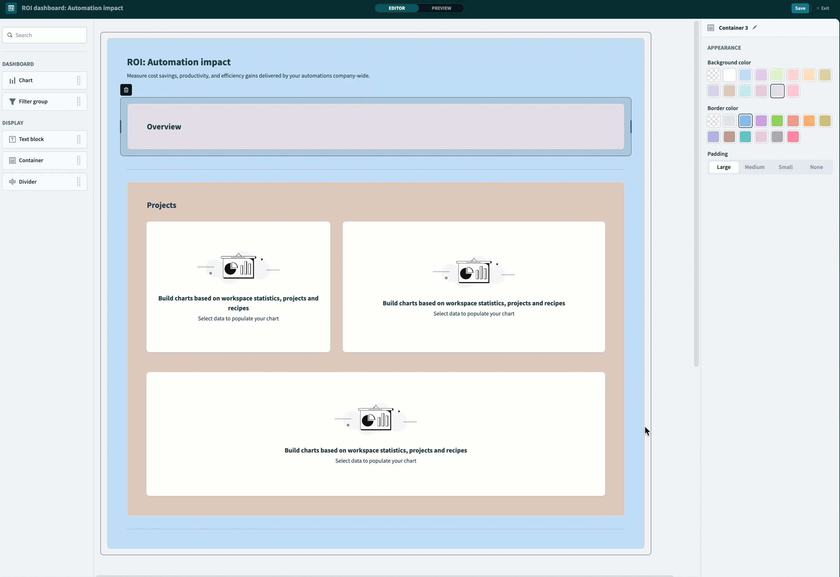

Add containers to define your layout. You can click and drag the edge of the container to resize it.
Customize containersCustomize containers
Add a title and additional text components to your dashboard as necessary. We recommend applying headings to containers in your dashboard to help categorize your visualizations.
Add a text componentAdd and customize text
Customize container colors on your dashboard as necessary. We recommend using color strategically throughout your dashboard to convey meaning. For example, choose white or a neutral color to maximize contrast between the background and your charts. Alternatively, choose a color to sync with your brand.
Customize container colorsCustomize container colors
Add a divider. You can place dividers in between containers to create a visual separation between different groups of charts.
Add a dividerAdd and customize dividers
Add chart components to your dashboard.
Add chartAdd charts to your dashboard

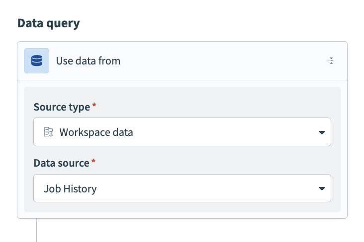

Select a data source
Go to the Use data from field and select Workspace data as the Source type, and Job history as the Data source.
View the results tableSelect a data source

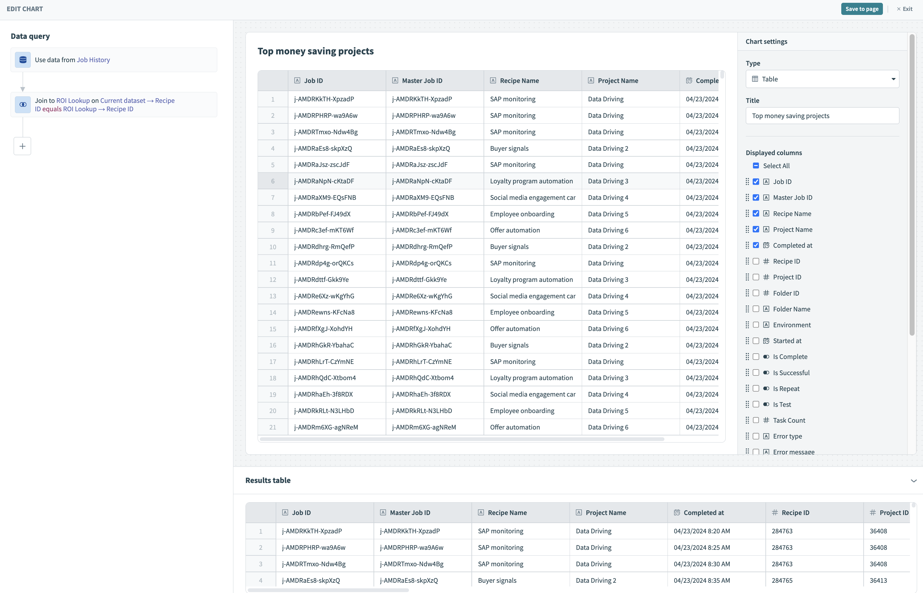

Click + (plus) and select Join from the query builder.
Available queriesSelect Join
Configure the join step
This step joins job history data to data in a lookup table, ROI lookup. The ROI lookup table maps each recipe to its automated use case and associated cost savings.
Use the Join type menu to select Inner join, use the Source type menu to select Data tables, and set the data source to ROI lookup.
Use the Current result drop-down menu to select Recipe ID and use the ROI Lookup drop-down menu to select Recipe ID.
Preview your data in the Results table. This table displays job history data joined to data in ROI lookup.
View the results tablePreview your data in the Results table

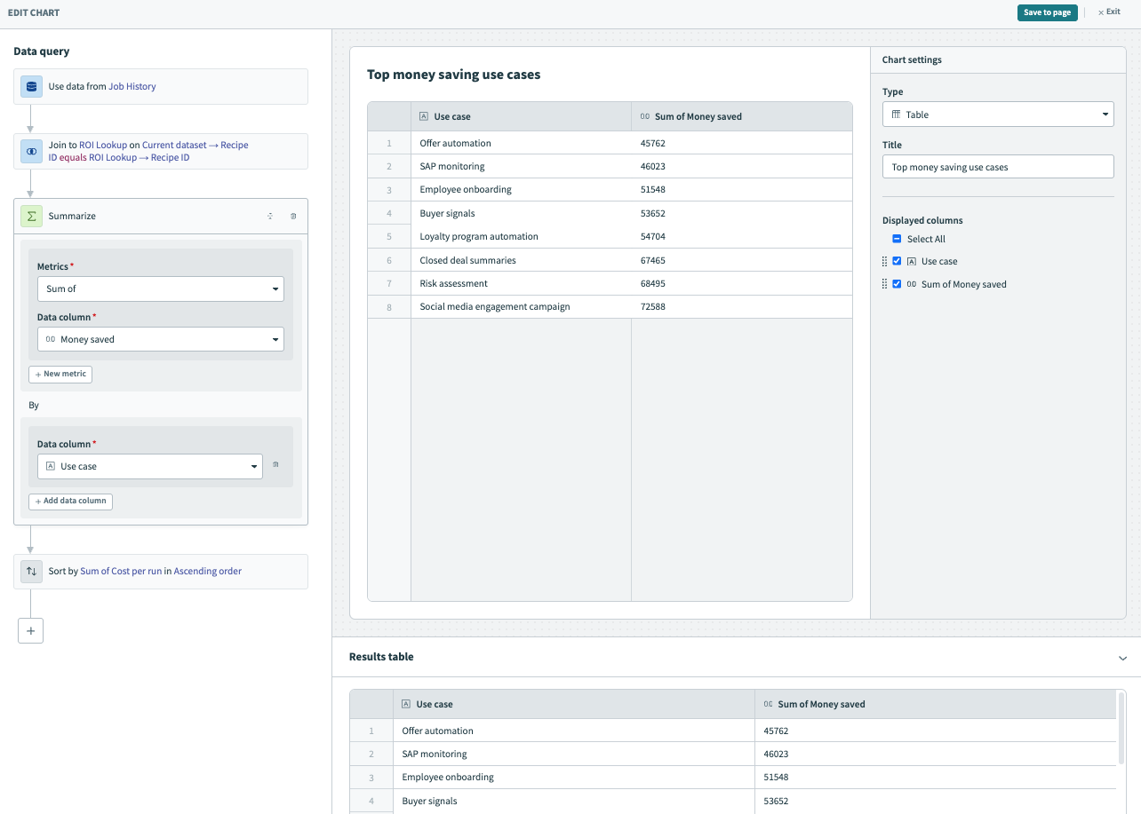

Click + and select Summarize from the query builder.
Available queriesSelect Summarize
Configure the summarize step
Use the Metrics drop-down menu to select Sum of and use the Data column drop-down menu to select Money saved.
Use the Data column drop-down menu to select Use case.
Preview your data in the Results table. This table displays use cases and the amount of money saved by each.

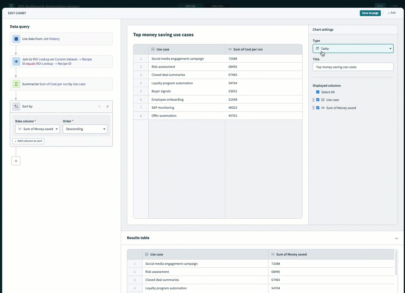

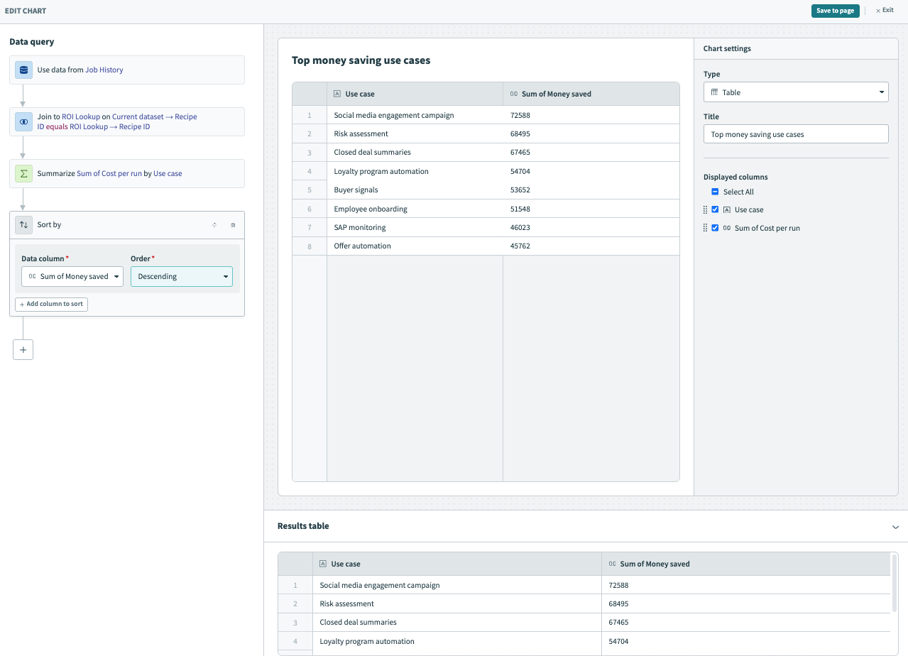

Click + (plus) and select Sort from the query builder.
Available queriesSelect Sort
Configure the sort step
Use the Data column drop-down menu to select Sum of Money saved and the Order drop-down menu to select Descending.
Preview your data in the Results table. This table displays use cases sorted by the amount of money saved.

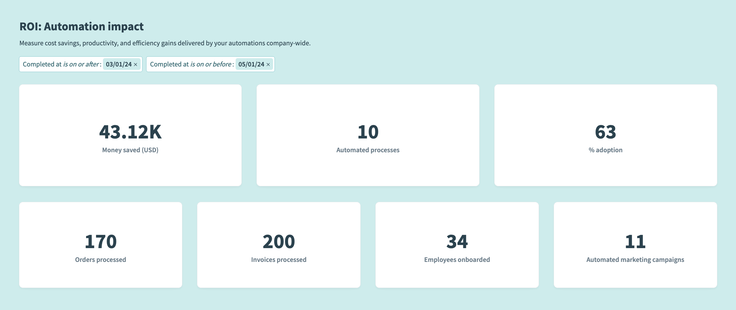

View filter behavior on the Insights homepage. View filter behaviorView filter

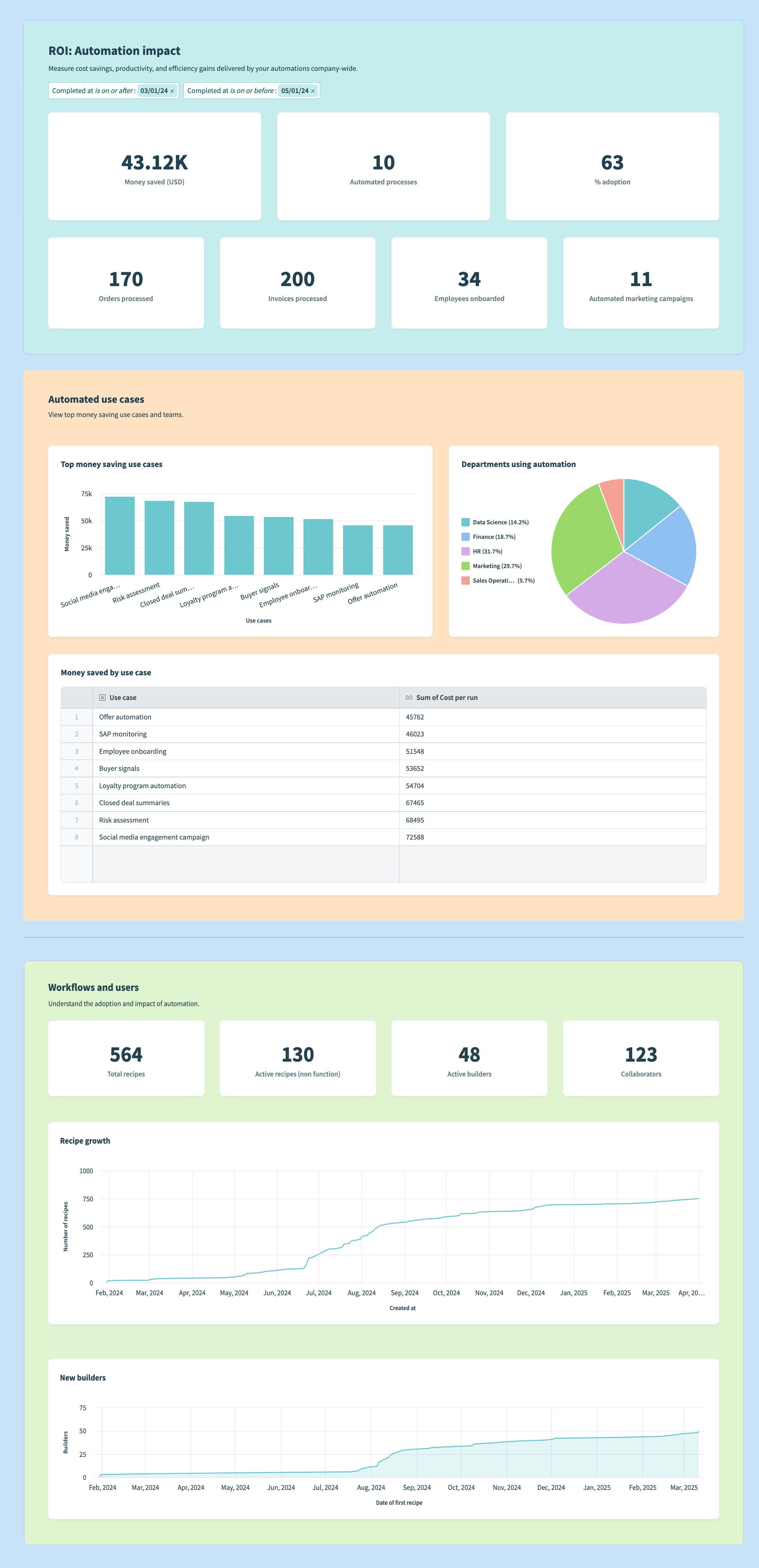

View your completed dashboard
Your dashboard is now complete and can be accessed from the Insights homepage.
Finsihed ROI dashboardCompleted ROI dashboard
