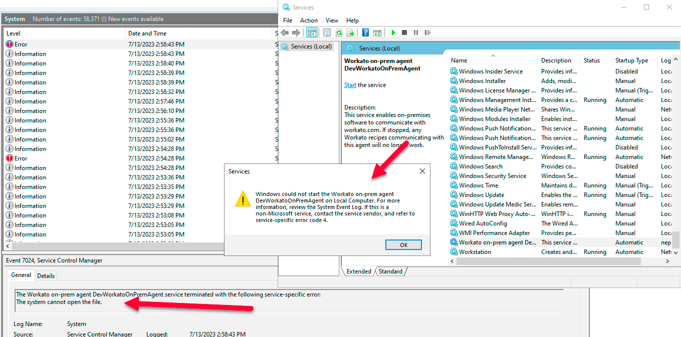

Windows service account permissions
The agent may fail to start if the assigned service account lacks required permissions. Assign a user with higher privileges to resolve the issue. For example, in Windows:
Press Win + R, type services.msc, and press Enter.
Go to the Services window and locate the agent.
Right-click on the agent and select Properties.
Switch to the Log on tab.
Change the account used to run the agent to one with higher privileges.
Change your accountChange your account
Refer to Install an on-prem agent on Windows for more information.

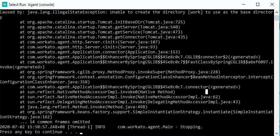

Unable to create directory [work] to use as the base directory error
The agent may fail at startup with an Unable to create directory [work] to use as the base directory error when it lacks permission to create the work directory. This issue often occurs when the agent runs under a limited-privilege account.
Initialization errorInitialization error
Run the agent with an administrator account to avoid this error. If the agent runs as a service, confirm that the assigned service user has full access to the install path.
