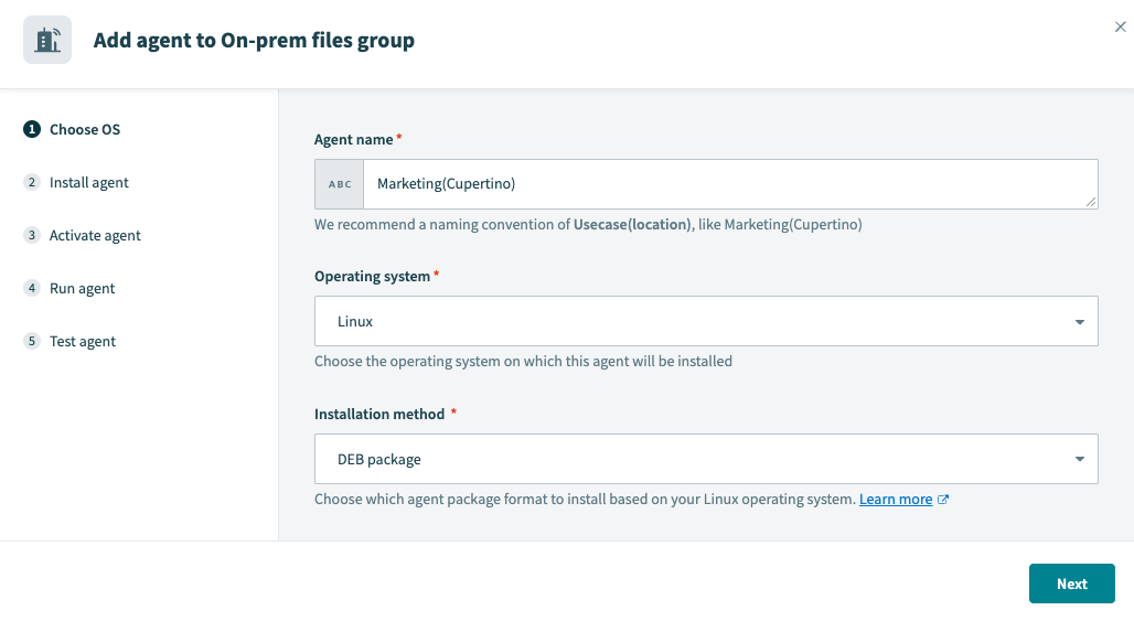

Go to the On-prem groups page and click Add new agent. Provide a meaningful agent name, and select the operating system (OS) for the agent installation.
Choose OS Choose OS
