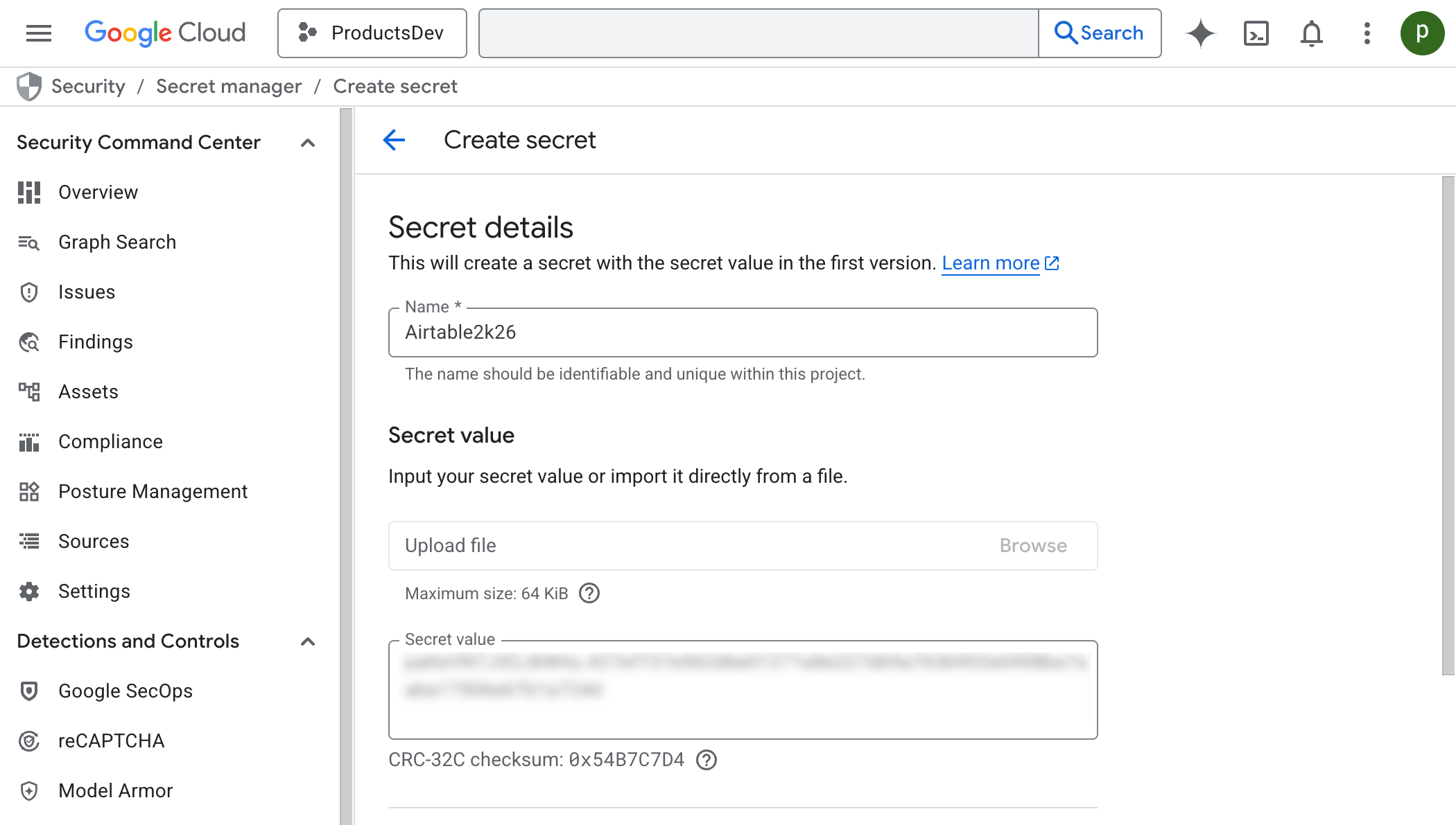

Go to Security > Secret Manager.
Click Create secret.
Enter a unique identifier for your secret in the Name field. For example, salesforce-api-key or workato-db-password.
Enter your secret data in the Secret value field, such as an API key, password, or token. Alternatively, you can click Upload file to provide a text file containing the secret data.
Create secretCreate secret

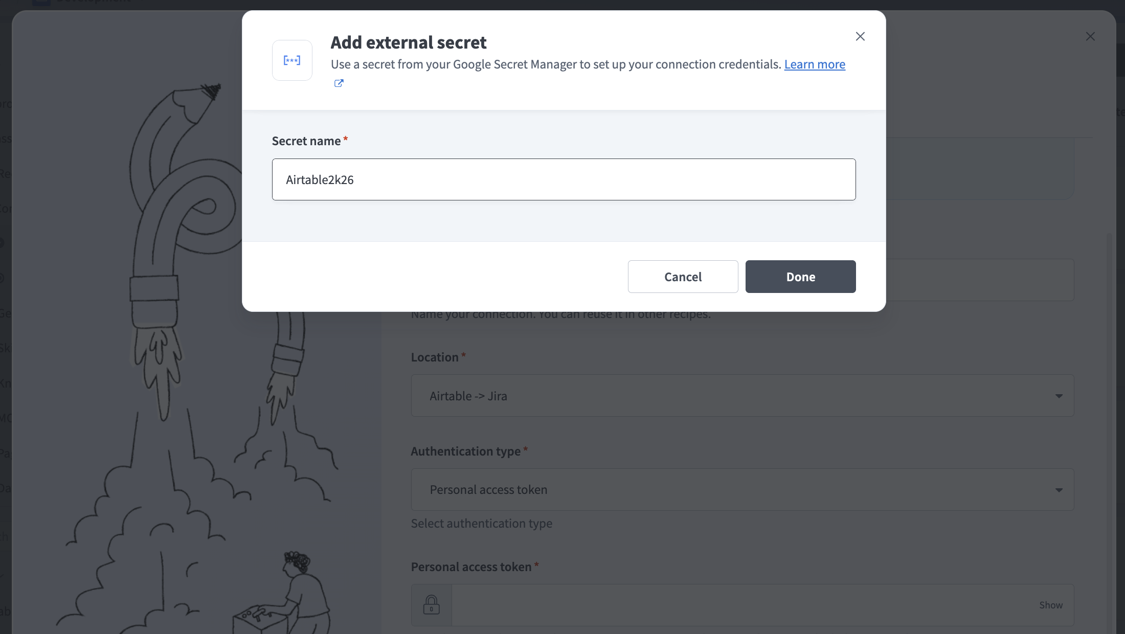

Click Add external secret for any sensitive field (for example, API key, password, or client secret).
Enter the exact name of your secret from Google Secret Manager in the Secret name field and click Done.
Enter the secret name from Google Secret ManagerEnter the secret name from Google Secret Manager

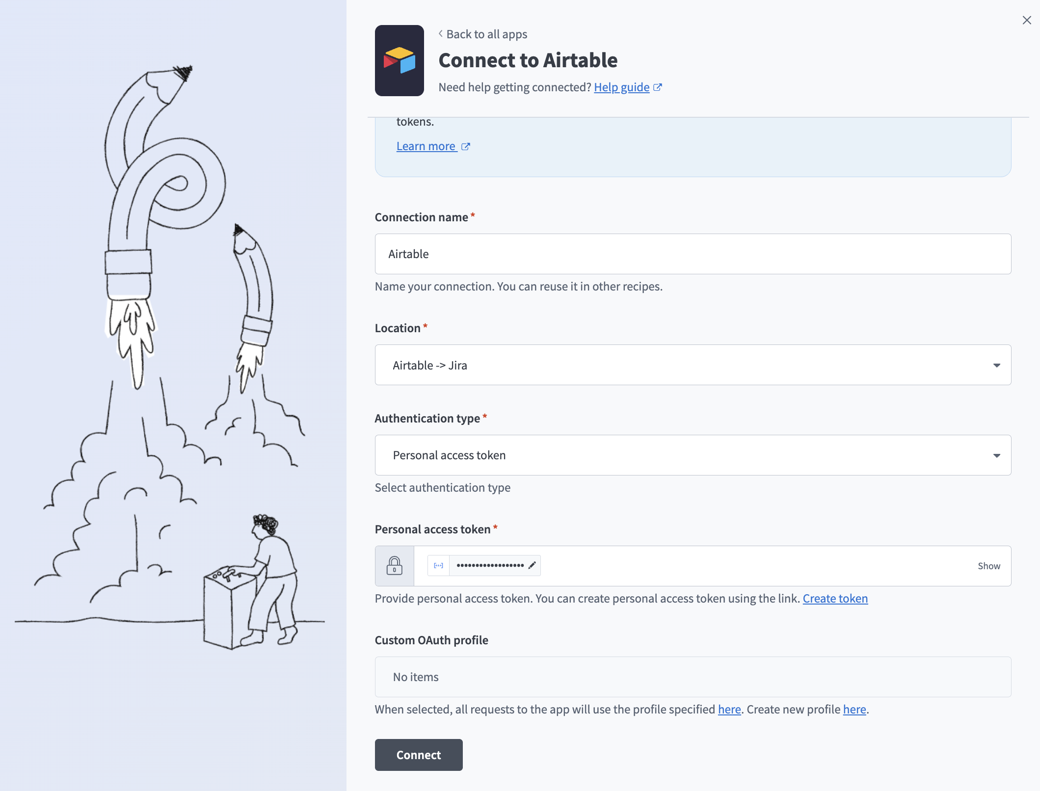

Complete the remaining connection fields.
Connect using a secret from Google Secret ManagerConnect using a secret from Google Secret Manager
