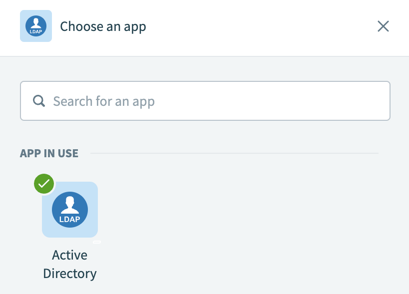

Search for Active Directory and select it as your app.
Choose Active DirectoryChoose Active Directory

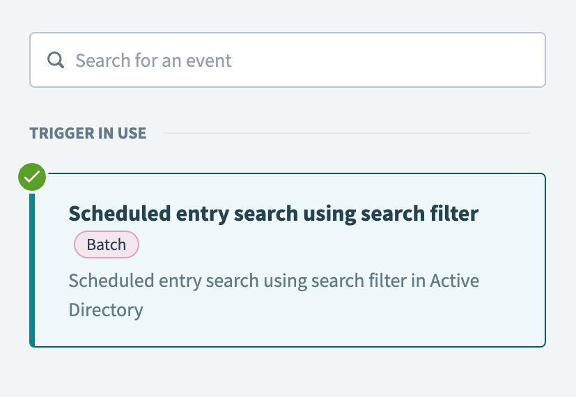

Select the Scheduled entry search using search filter trigger.
Select the Scheduled entry search using search filter triggerSelect the Scheduled entry search using search filter trigger

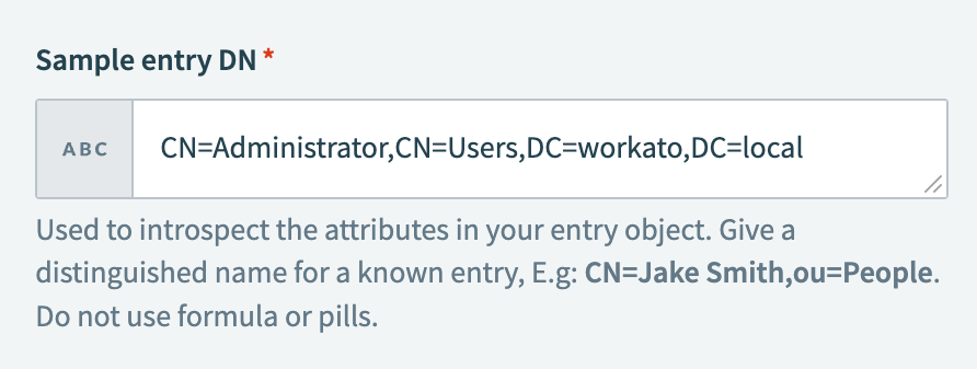

Enter the distinguished name of a known entry in your Active Directory instance in the Sample entry DN field. For example, CN=Jake Smith,OU=People.
Example of Sample entry DN configurationExample of Sample entry DN configuration
Ensure the entry you choose includes all the fields you plan to use as column names in the CSV file. Don't use formulas or datapills in this field.

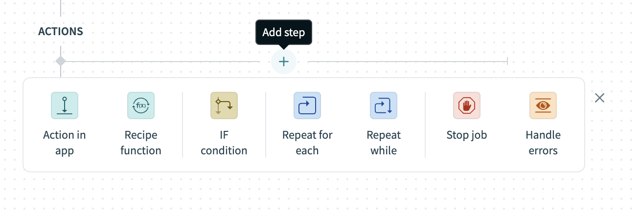

Add actionClick Add step > Add action in app

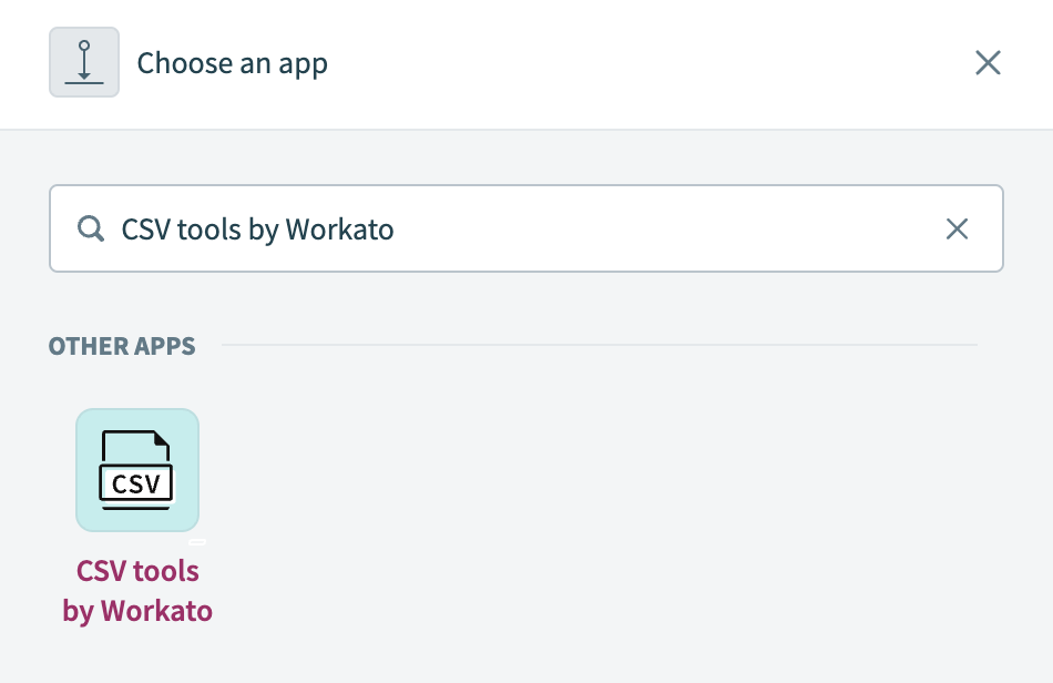

Search for CSV tools by Workato and select it as your app.
Choose CSV tools by WorkatoChoose CSV tools by Workato

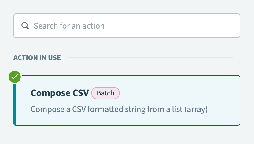

Select the Compose CSV action.
Select the Compose CSV actionSelect the Compose CSV action

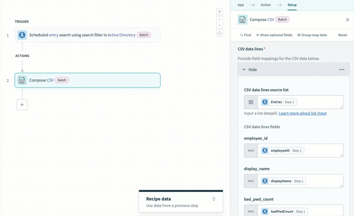

Map the Active Directory EntriesStep 1 list datapill to the CSV data lines source list field.
Map the relevant Active Directory datapills to the fields in the CSV data lines fields section. These fields correspond to the column names you entered in CSV column names and depend on the Sample entry DN value provided in the previous recipe step.
For example, this recipe maps the Active Directory employeeIDStep 1 datapill to employee_id, displayNameStep 1 to display_name, and so on.
Completed configurationCompleted configuration

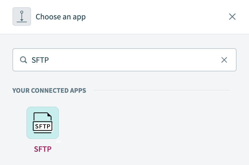

Search for SFTP and select it as your app.
Choose SFTPChoose SFTP

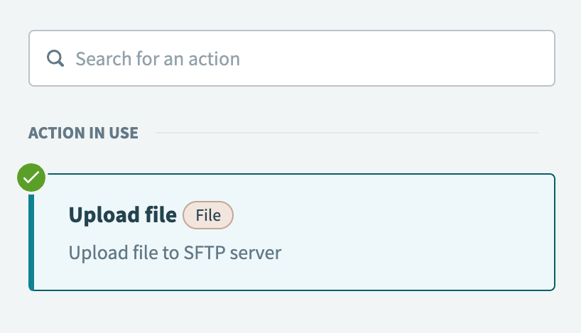

Select the Upload file action.
Select the Upload file actionSelect the Upload file action

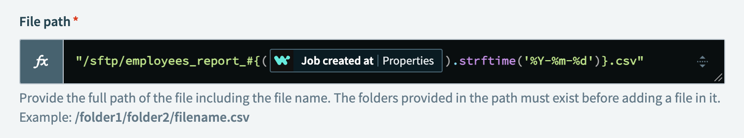

Enter the full path to the file, including its name, in the File path field. Ensure the folders in the specified path exist before attempting to add files.
For example, this recipe switches the File path field to formula mode and uses the following file path:
ruby
"/sftp/employees_report_{JOB_CREATED_AT}.strftime('%Y-%m-%d')}.csv"
In this example, {JOB_CREATED_AT} represents the Job created atProperties datapill. This path configuration ensures that each file is uniquely named based on the job creation date.
Example of File path configurationExample of File path configuration

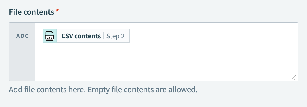

Map the CSV contentsStep 2 datapill to the File contents field.
Configure the File contents fieldConfigure the File contents field

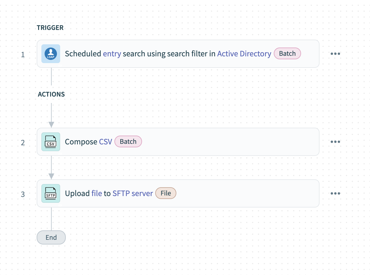

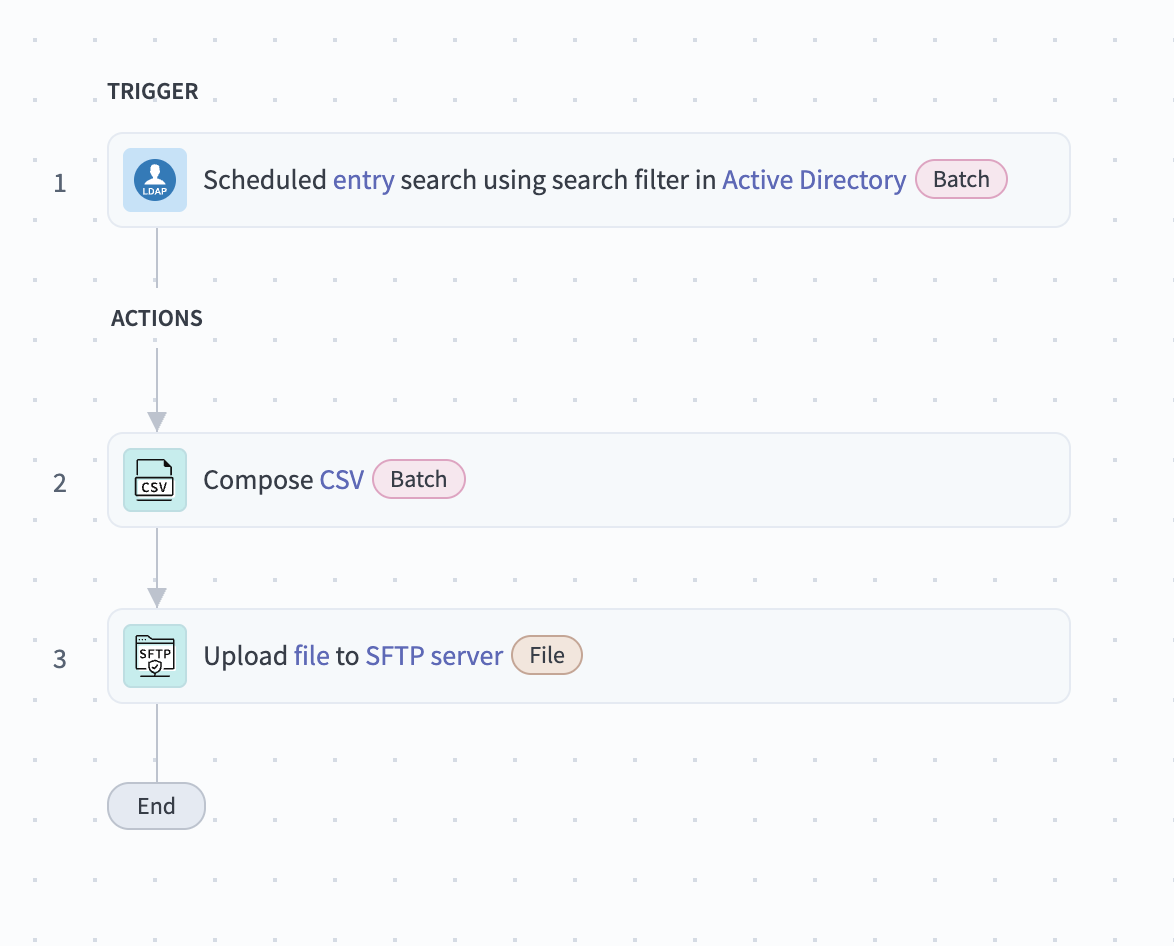

Example recipe configuration.
Active Directory, CSV tools by Workato, and SFTP recipeActive Directory, CSV tools by Workato, and SFTP recipe
