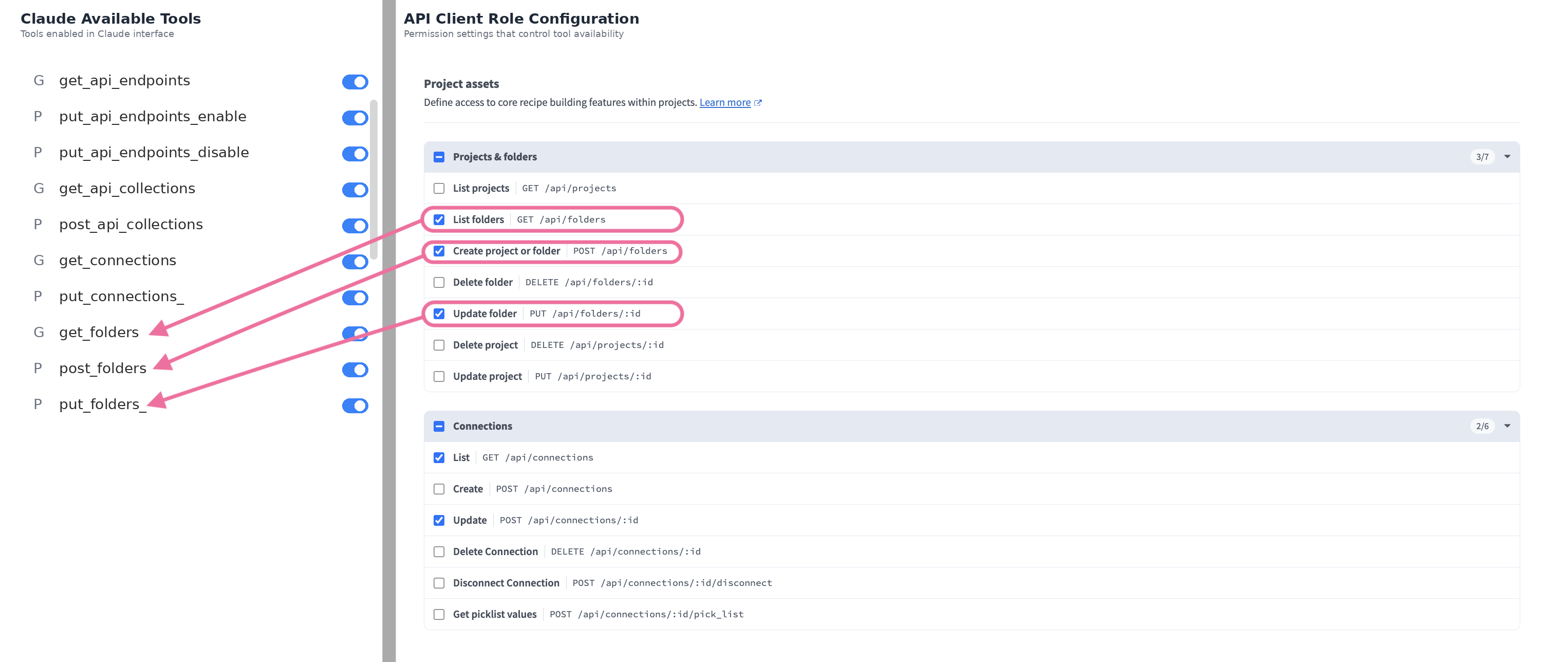

Go to Workspace admin > API clients to view your API client role that defines which tools you have access to or Create a client role with the tools you plan to use. For example, enable List folders, Create project or folder, and Update folder if these are tools you plan to use in your LLM.
EMBEDDED API CLIENT AND TOKEN REQUIREMENT
You must use a token created in an Embedded admin workspace to manage Embedded APIs through the MCP server.
LLM tool availability is defined in the client roleLLM tool availability is defined in the client role
Obtain your API client token or Create an API client and copy and store the generated API token.

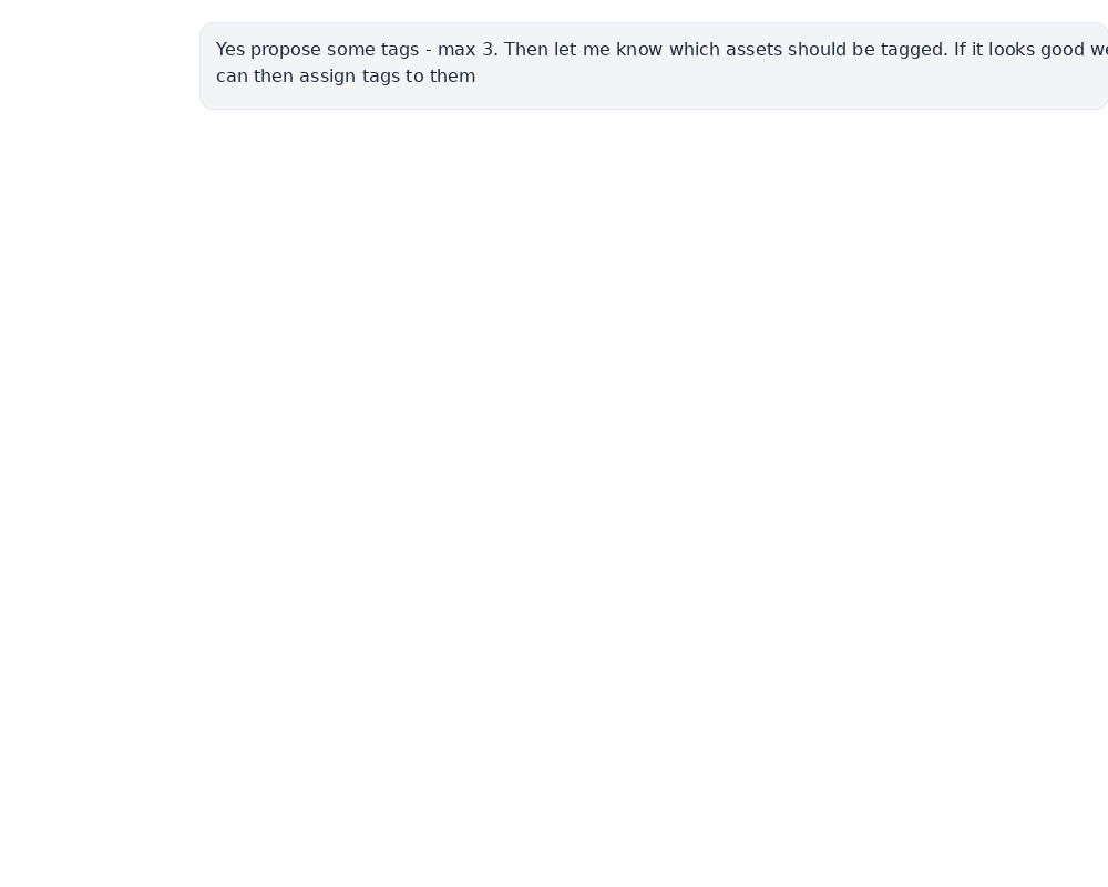

Start a new chat with your LLM and enter a prompt.
Example prompt for project and asset management
Enter the following prompt:
plaintext
Propose a maximum of 3 tags based on my workspace activity.
Create tags from your LLMCreate tags from your LLM
Review the suggestions and ask your LLM to create the proposed tags.

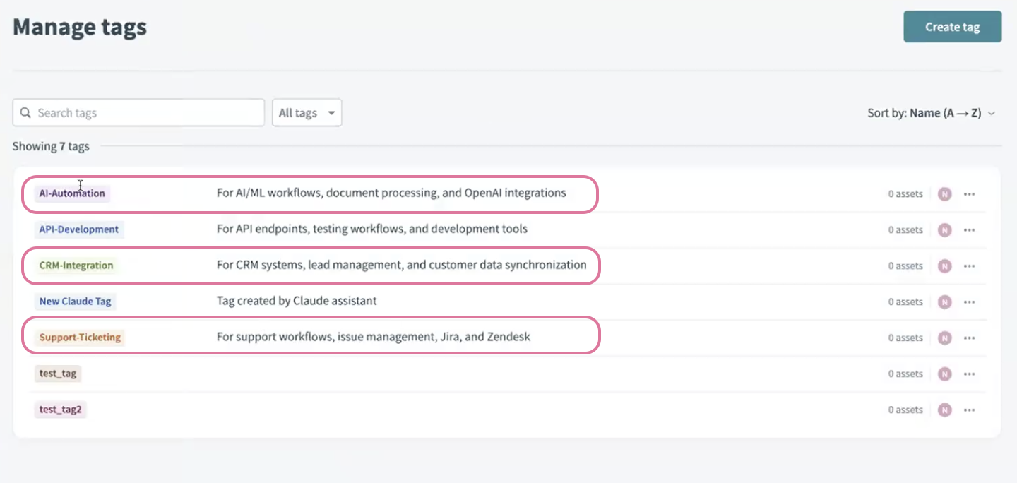

Go to Workspace admin > Settings > Tags and click Manage tags to view the tags created by your LLM.
Tags created by your LLMTags created by your LLM

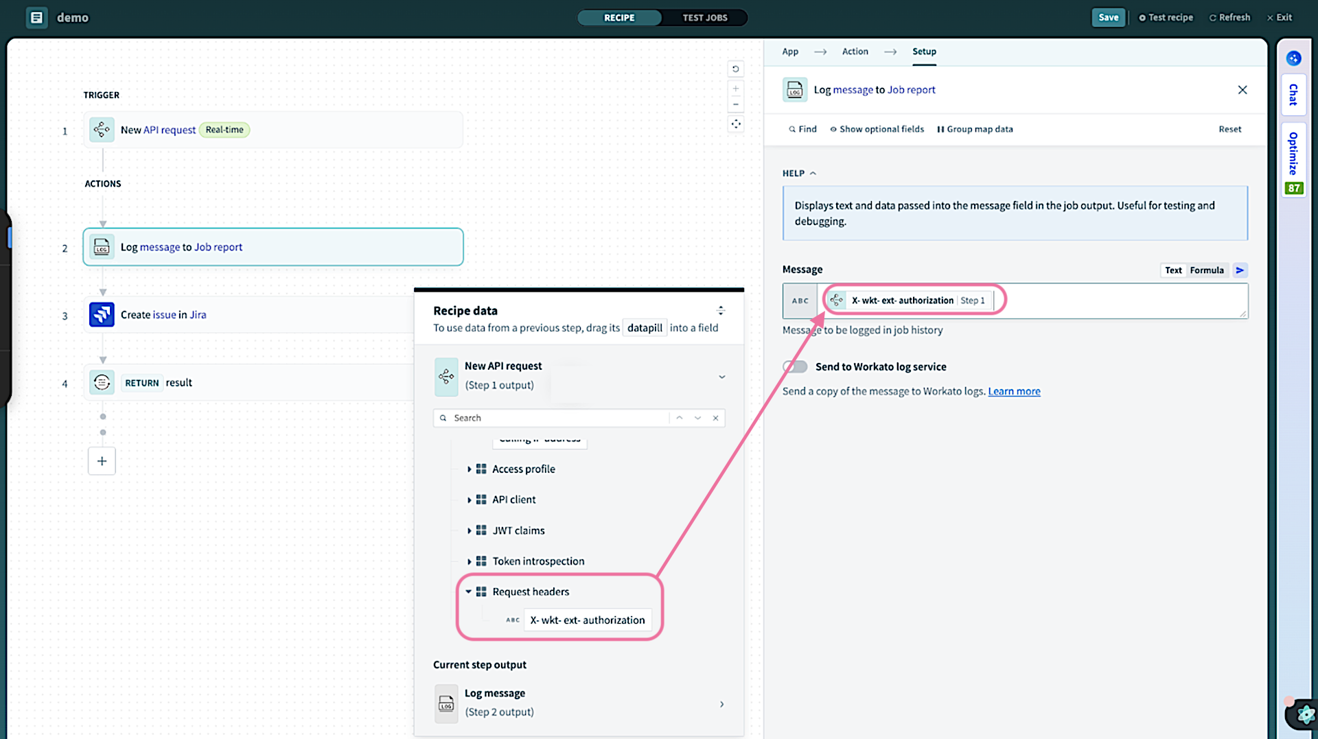

You can call APIs with authorization headers within Workato recipe actions. You must use the header X-Wkt-Ext-Authorization datapill in your Workato recipe for APIM-collection-based MCP servers.
Complete the following steps to pass authorization headers in your API calls:
Go to a project and click Create > Recipe or press C+R.
Use the Location drop-down menu to select the project where you plan to store the recipe.
Click Start building.
Click Pick a starting point and select Trigger from an app.
Search for and select API platform by Workato.
Select the New API request trigger. The New API request trigger in this use case doesn't require you to establish a connection.
New API request triggerNew API request trigger
Complete the following steps to configure your request schema:
Go to the Request headers section and click Add header.
Enter the following name in the Name field:
bash
Optional. Provide a descriptive label for your header in the Label field.
Click Add field. Your header value is now accessible as a datapill under the New API request step output.
Map the X-Wkt-Ext-AuthorizationStep 1 datapill to the field where you plan to pass the header authorization.
Map your header authorization datapillMap the X-Wkt-Ext-AuthorizationStep 1 datapill
Save your changes.
