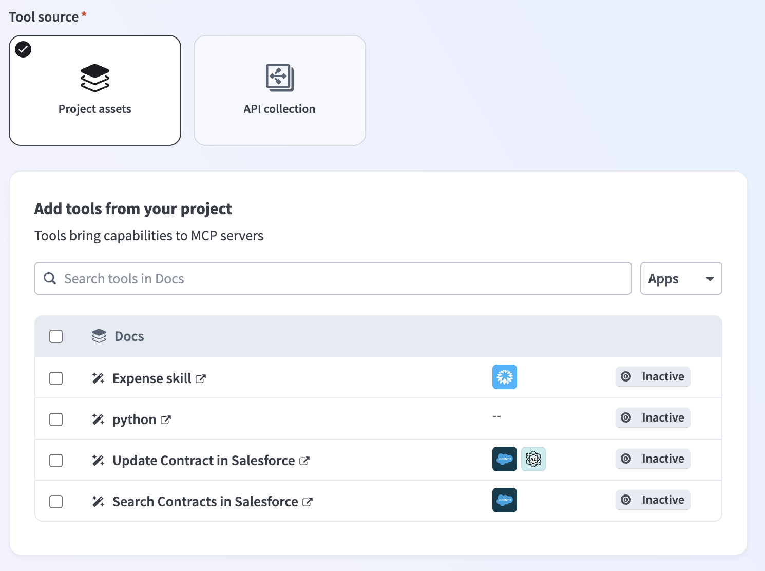

Select either Project assets or API collection as your Tool source.
Select your tool sourceSelect your Tool source
Select the tools you plan to add to your MCP server.

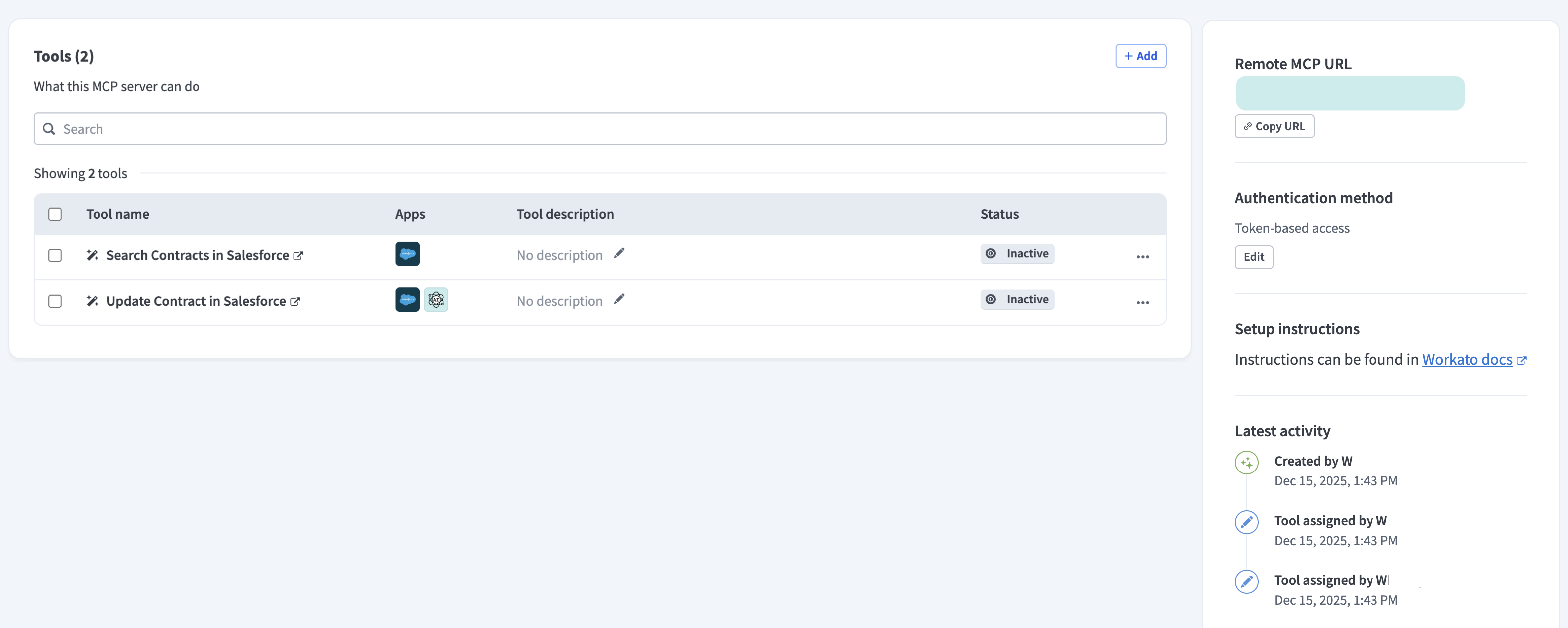

Click Start building. The MCP server tools, description, remote MCP URL, and additional server information displays in the Overview tab.
MCP server Overview tabMCP server Overview tab admin view

Click the MCP server card you plan to view. The MCP server displays the following information:
  • Description
  • Installation link
  • Tools available on the MCP server, such as Tasks Create and CRM Get Company Properties
  • The MCP remote URL
