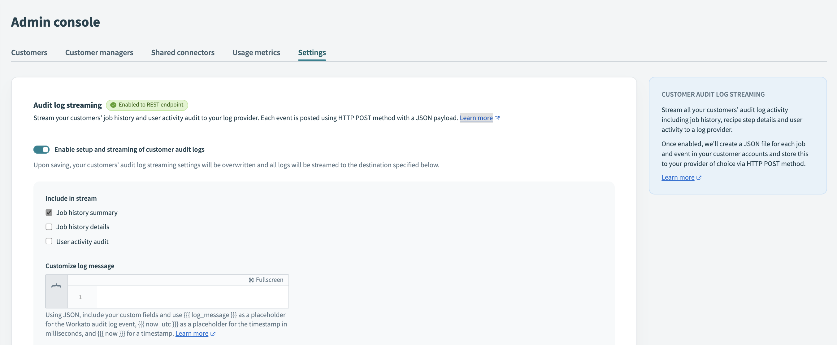

Sign in to Workato with an Embedded partner workspace.
Go to Admin console > Settings > Audit log streaming.
Audit log streaming settings in the Admin console
Use the Enable setup and streaming of customer audit logs toggle to enable audit log streaming.
Select the events to stream:
- Job status only: Logs whether a job succeeded or failed.
- Full job details: Logs job details, including status and data for each line action.
- User activity: Logs all user activity in the workspace.
- API platform logs: Logs all API requests handled by the API platform.
- Workato Log events: Logs all messages sent to the Workato logging service.
Additionally, select the Log types and Log levels to include if you plan to stream events from the Workato logging service.
Optionally, customize the log message format.
Select a Destination type from the picklist and enter any required fields for the selected destination type.
Select Save.

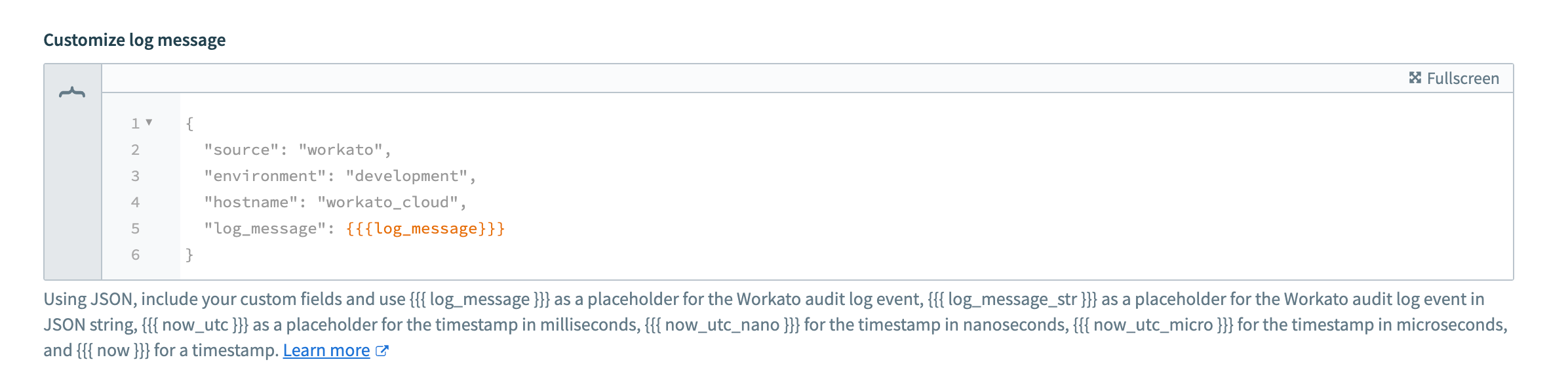

Customize audit log JSON
You can customize the audit log JSON format for your destination application. For example, you can define a source application, such as workato, to process the event logs in the destination application automatically.
Go to Admin console > Settings > Audit log streaming > Customize log message to create a custom log message in JSON format. Define the JSON structure with placeholders for Workato audit log fields and any custom fields. Workato replaces each placeholder with the actual value before it streams the event.
Refer to Supported placeholders for more information.

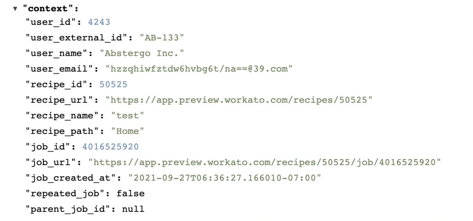

Identifying customers from JSON files
The JSON file includes the user_id and user_external_id parameters in the context block for all log files related to job details. These two IDs refer to the Workato customer ID and the partner-provided external ID for the customer.
Sample JSON from a job event

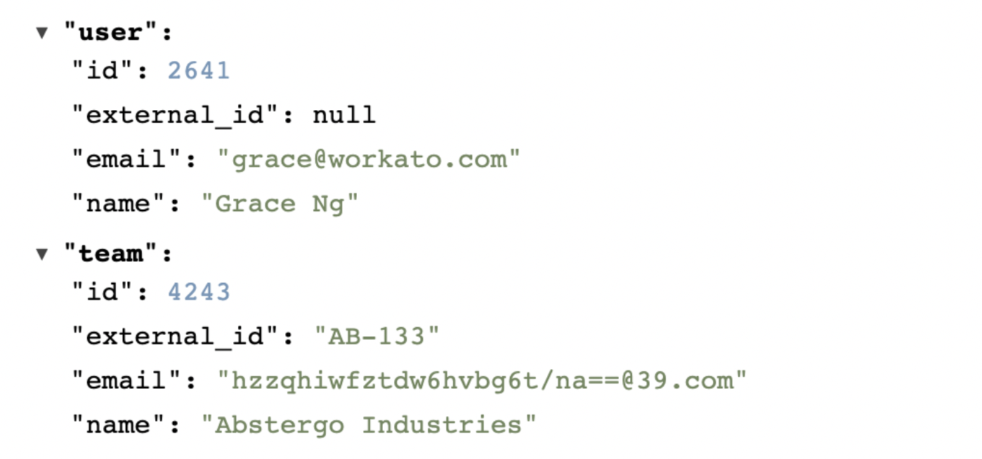

The JSON file includes the id and external_id parameters nested in the user and team for all log files related to user activity. The IDs in the team block refer to the customer, while the IDs in the user block refer to the specific customer team member who performed the action.
Sample JSON from a user activity event
If the partner did not provide any external ID while creating the customer or customer team member, the external_id value is null.
