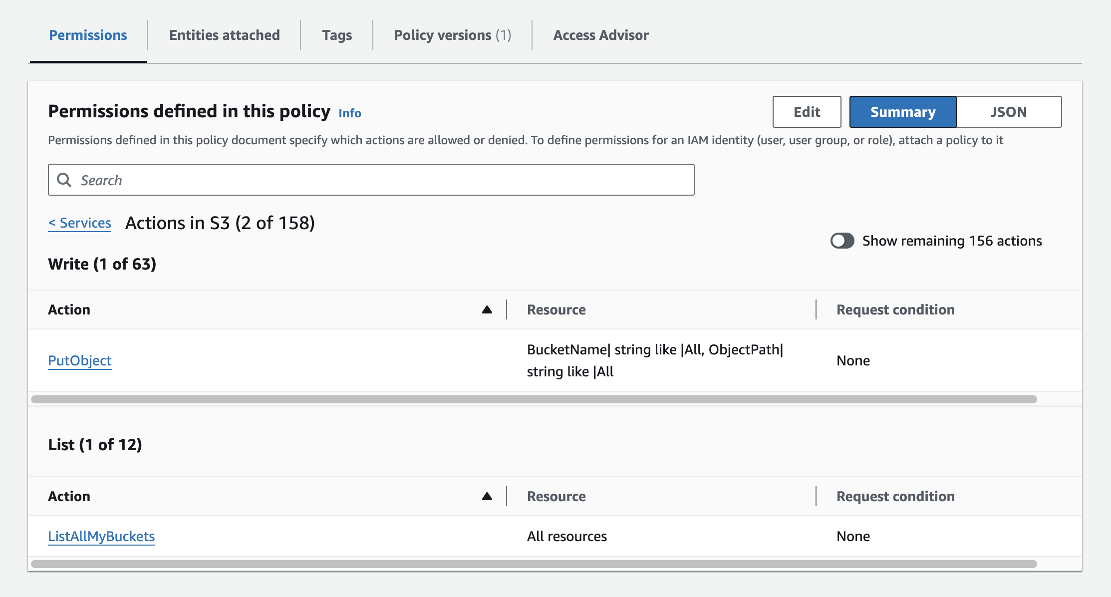

To stream your audit logs to Amazon S3, select an existing Amazon S3 connection or create one that has a region and bucket set up. This connection must be assigned an IAM role with the following policy permissions:
ListAllMyBuckets: This list permission allows Workato to list all buckets belonging to your S3 account. This permission is required even if your connection is restricted to one bucket within S3.PutObject: This write permission allows Workato to stream your activity audit logs to the bucket you specify during setup.
Minimum permissions for audit log streaming to S3
To ensure the audit logs are streamed successfully, confirm that your Amazon S3 connection meets the following requirements:
- The specified S3 bucket must exist.
- The region specified in the S3 connection must match the region of the selected bucket.
- The IAM role ARN (Amazon Resource Name) associated with the S3 connection must be valid.
- The IAM role must have the
ListAllMyBucketsandPutObjectpermissions.
Learn more about setting up an IAM role and permissions policy in our IAM role-based authentication documentation.

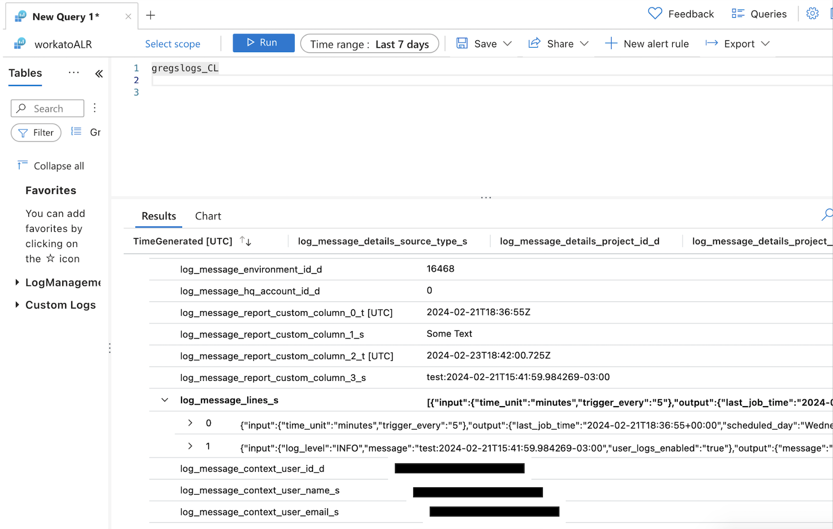

Ensure your Azure Monitor Workspace receives the audit logs by querying the specified log type.
Verify your audit logs

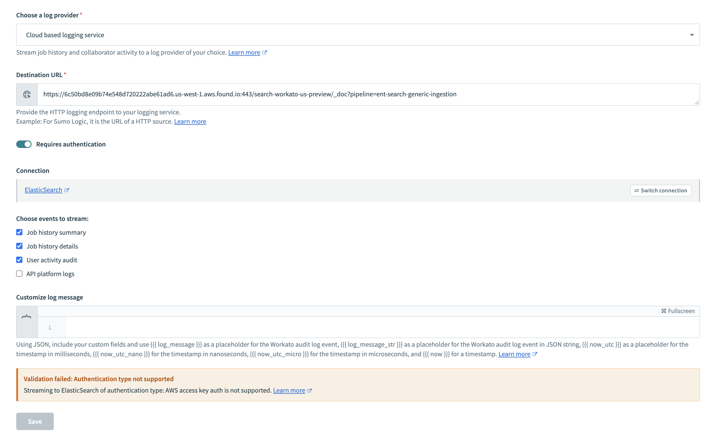

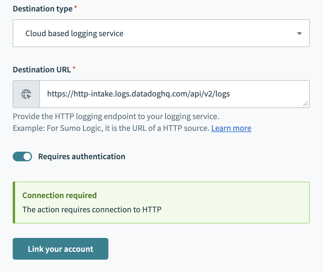

Go to the Destination URL field and enter the HTTP URL from your cloud-based logging service provider. Workato audit log streaming posts the audit log events in real-time to this URL.
If your log service provider requires authentication to send HTTP requests, enable the Requires authentication slider, then select the Link your account button to specify an HTTP connection with your authentication information. You can create a new HTTP connection or link to an existing connection.
Link to an HTTP connection

Note that audit log streaming to REST-based destinations is only compatible with the preceding listed authentication methods. You will not be able to successfully configure streaming if you use another authentication method.
Validation failed

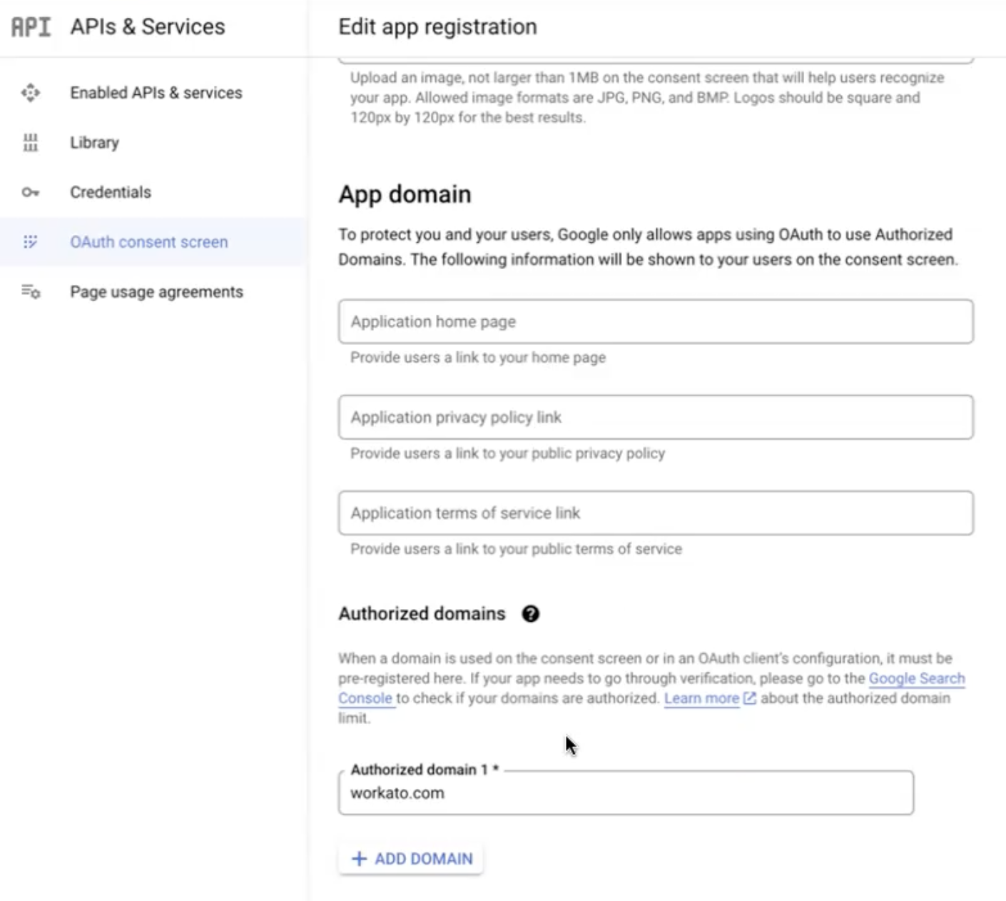

Go to Authorized domains > click Add Domain > and enter workato.com.
Add the Workato domain

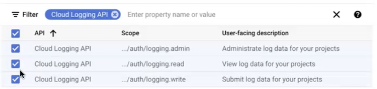

Ensure that you have the following Cloud Logging API scopes:
.../auth/logging.admin.../auth/logging.read.../auth/logging.write
Required API scopes
Click Add > Submit for verification.

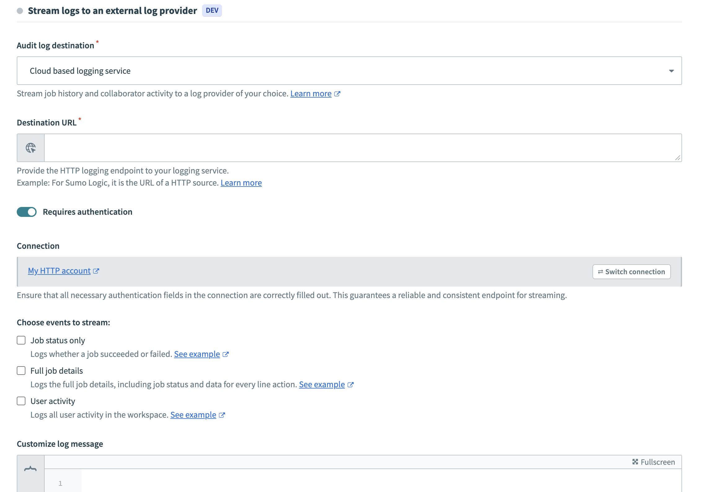

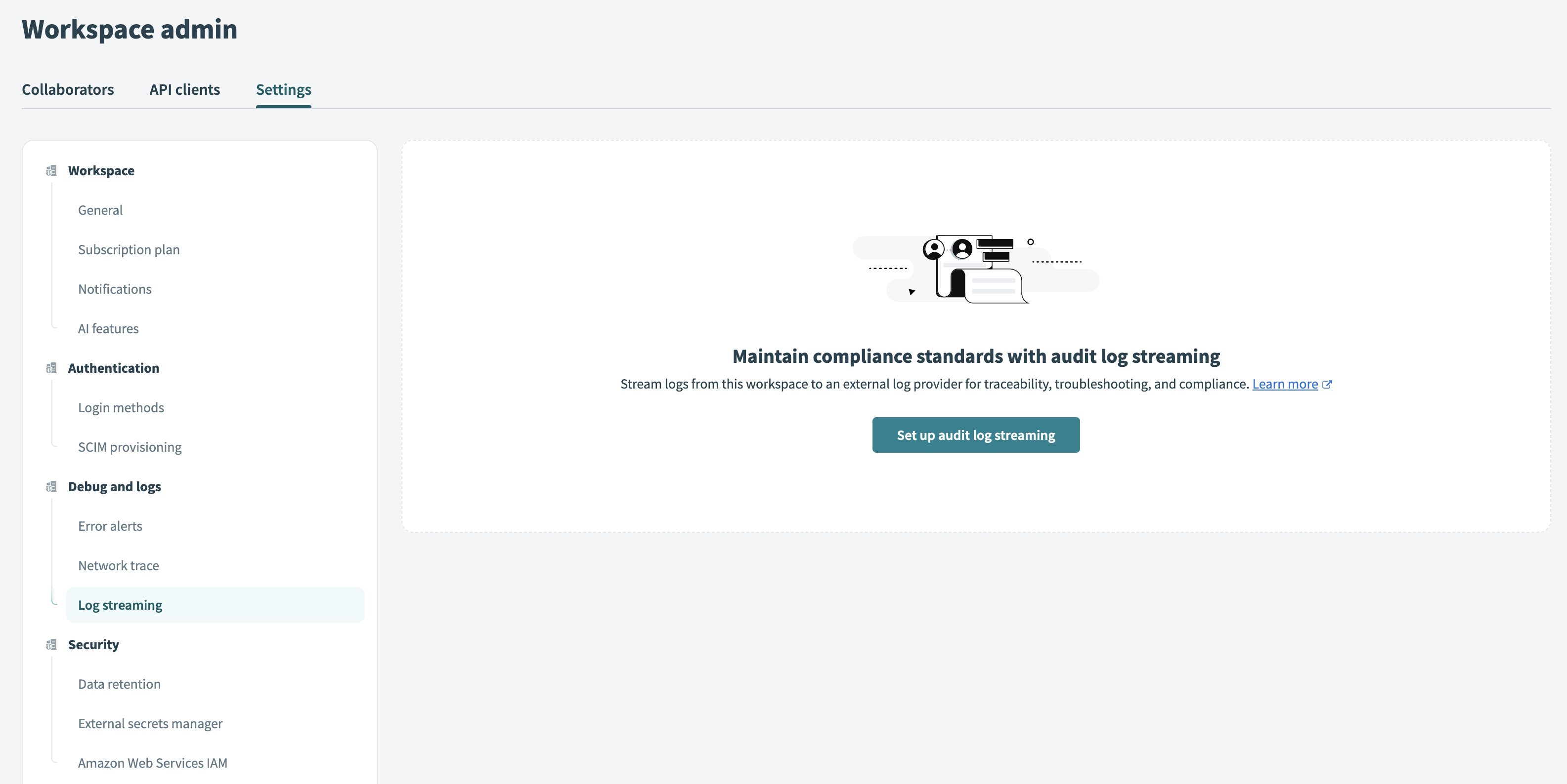

Go to Workspace admin > Settings > Debug and logs > Log streaming.
Go to Log streaming
Click Set up audit log streaming.
Use the Audit log destination drop-down menu to select Cloud based logging service.
Configure your logs to stream to an external log provider
Enter the following URL as your Audit log destination: https://logging.googleapis.com/v2/entries:write.
Select the Requires authentication toggle.
Click Set up connection, then use the Existing connections drop-down menu to select the connection you set up in the preceding section.
Select the connection from Existing connections
Go to the Choose events to stream section and select the checkboxes for the events you plan to stream.
Enter the logging message you plan to use in the Customize log message field.

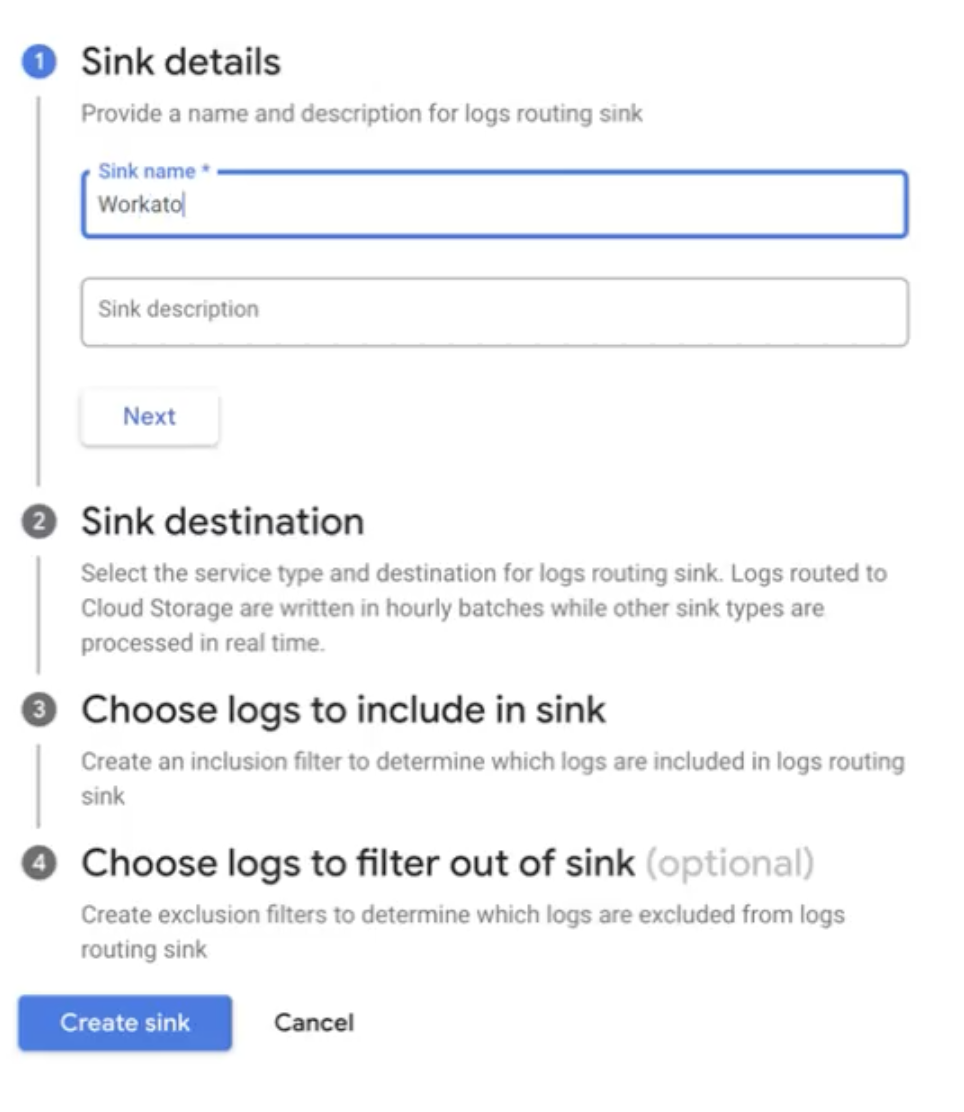

Go to Cloud Logging Explorer > Log Router > Create Sink.
Provide a Sink name, such as Workato to GCP, then click Next.
Create a sink
Use the Select sink service drop-down menu to select Google Cloud Bucket.
Click Browse to locate and select the Google Cloud Bucket you plan to use, then click Next.
Choose the logs you plan to include in the router by entering the log name in the Inclusion filter field and then click Next.
Click Create Sink.

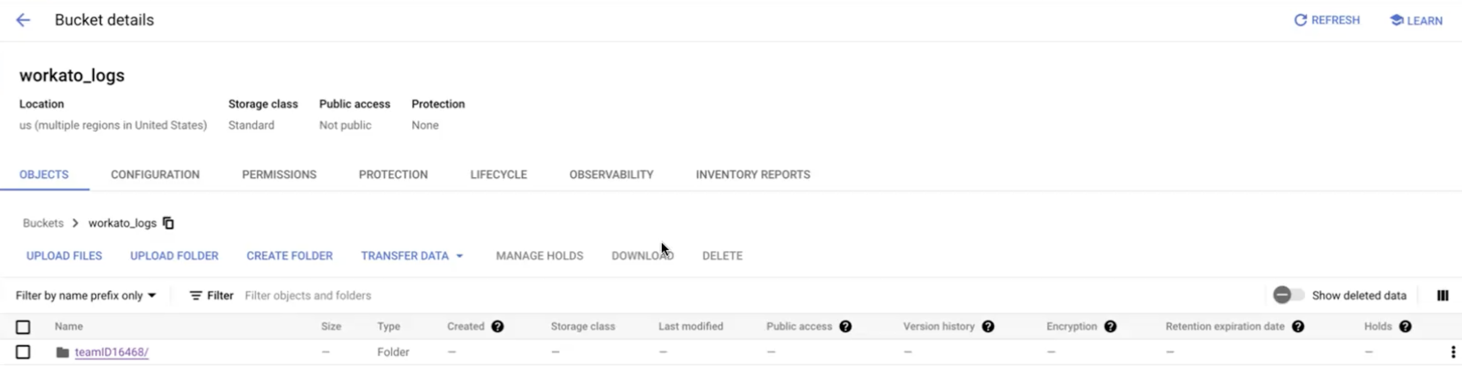

Google Cloud Bucket details
