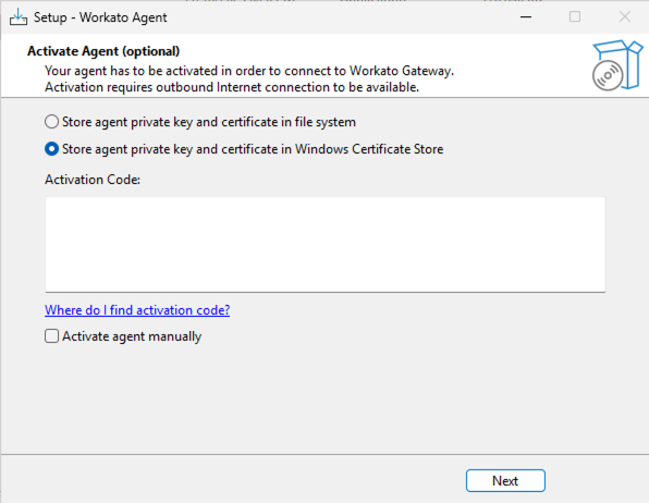

Select where to store the agent private key and certificate:
- Windows Certificate Store: Stores the private key and certificate in the system-managed certificate store. Access requires appropriate Windows permissions on both the certificate store and private key. This is the default option.
- File system: Stores the private key and certificate in the
C:\Program Files\Workato Agent\conffolder. You must protect theconffolder from unauthorized access if you select this option as your storage location. This option is only available in OPA versions 30.0 and later. Refer to the Security section for more information.
CERTIFICATE NOT FOUND
You may encounter a Certificate not found error when activating the agent with Windows Certificate Store selected. This is typically caused by insufficient permissions to access the certificate store on your machine. You can resolve this issue by storing the key and certificate in the file system or updating your Windows account permissions.
Choose where to store OPA key and certificate

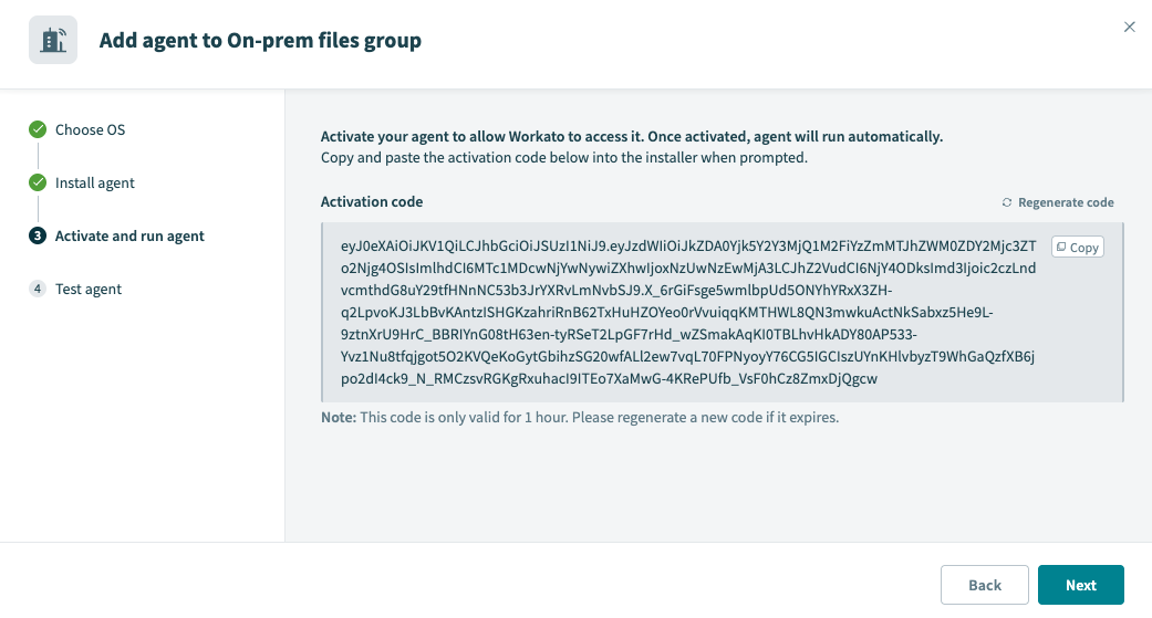

Copy and paste the Activation command from Workato. The code is valid for one hour. Click Regenerate code to generate a new code if it expires.
Alternatively, you can select Activate agent manually and activate the OPA after installation using the activation script.

Provide the Activation command from Workato's OPA setup wizard when prompted. The code is valid for one hour. Click Regenerate code in the setup wizard to generate a new code if it expires.
Copy and paste the Activation code

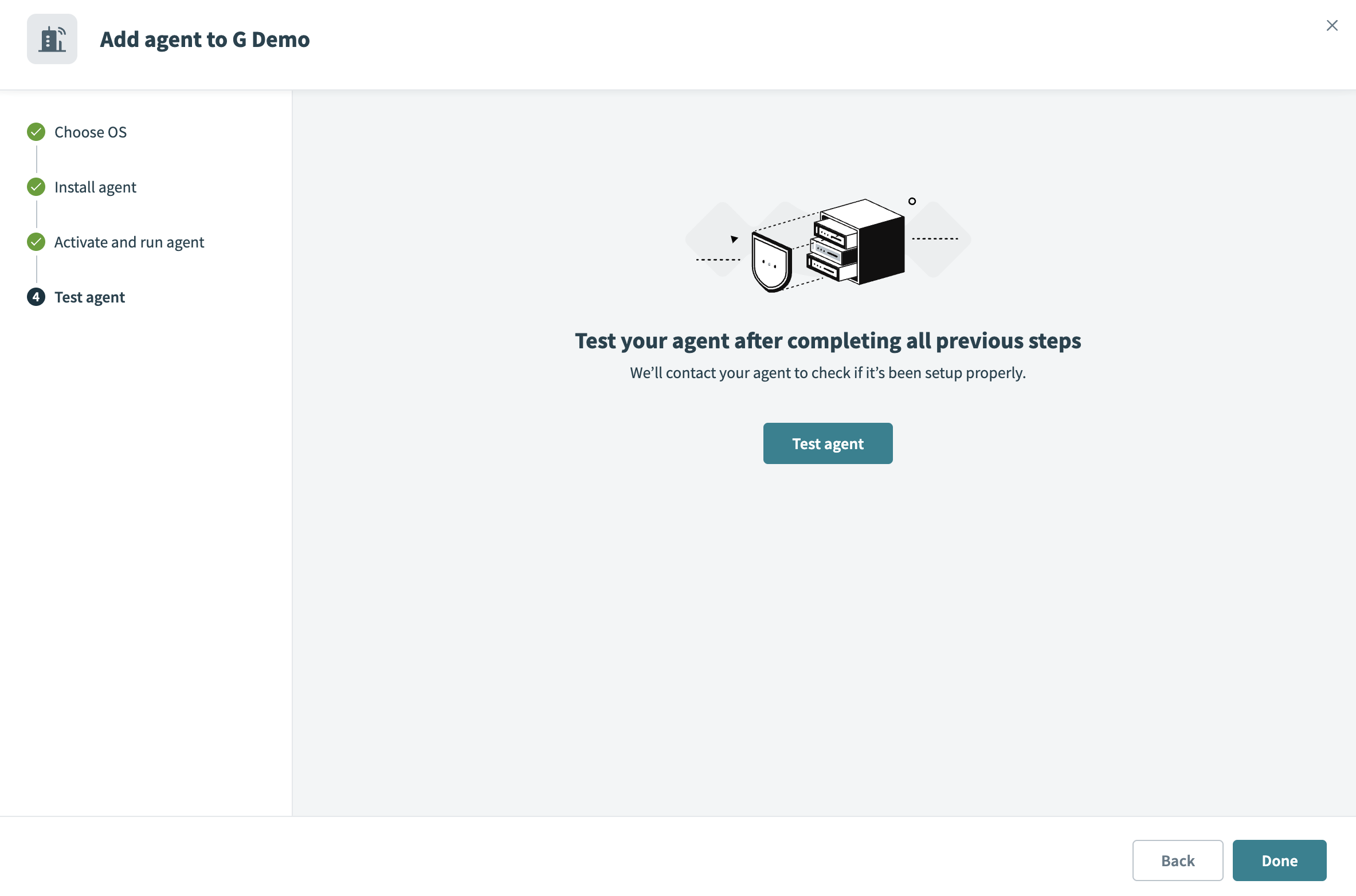

Return to Workato and click Next.
Click Test agent to confirm that your on-prem agent is working as expected.
Test the on-prem agent
Click Done to complete the installation.

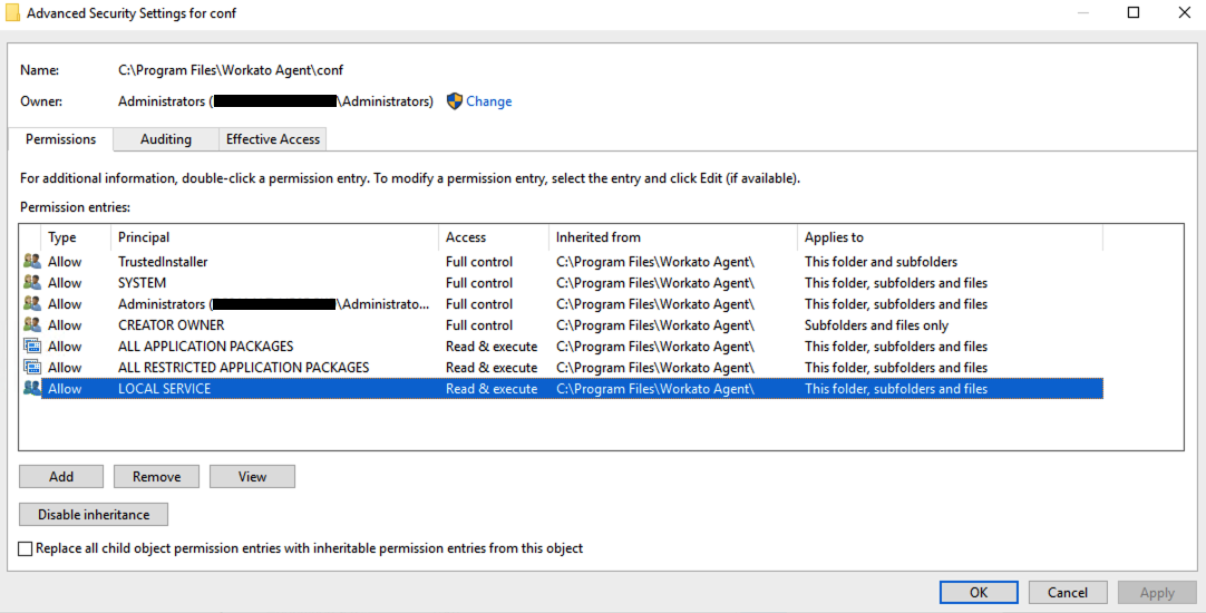

How to set permissions
Complete the following steps to protect the OPA's conf folder:
Right-click the conf folder and select Properties.
Go to the Security tab.
Click Advanced and remove any unnecessary explicit or implicit access to the conf folder.
Explicitly allow Read access to the conf folder for the LOCAL SERVICE system account (or the account assigned to run OPA as a Windows service).
OPA conf directory permissions
Click Apply, then OK.
