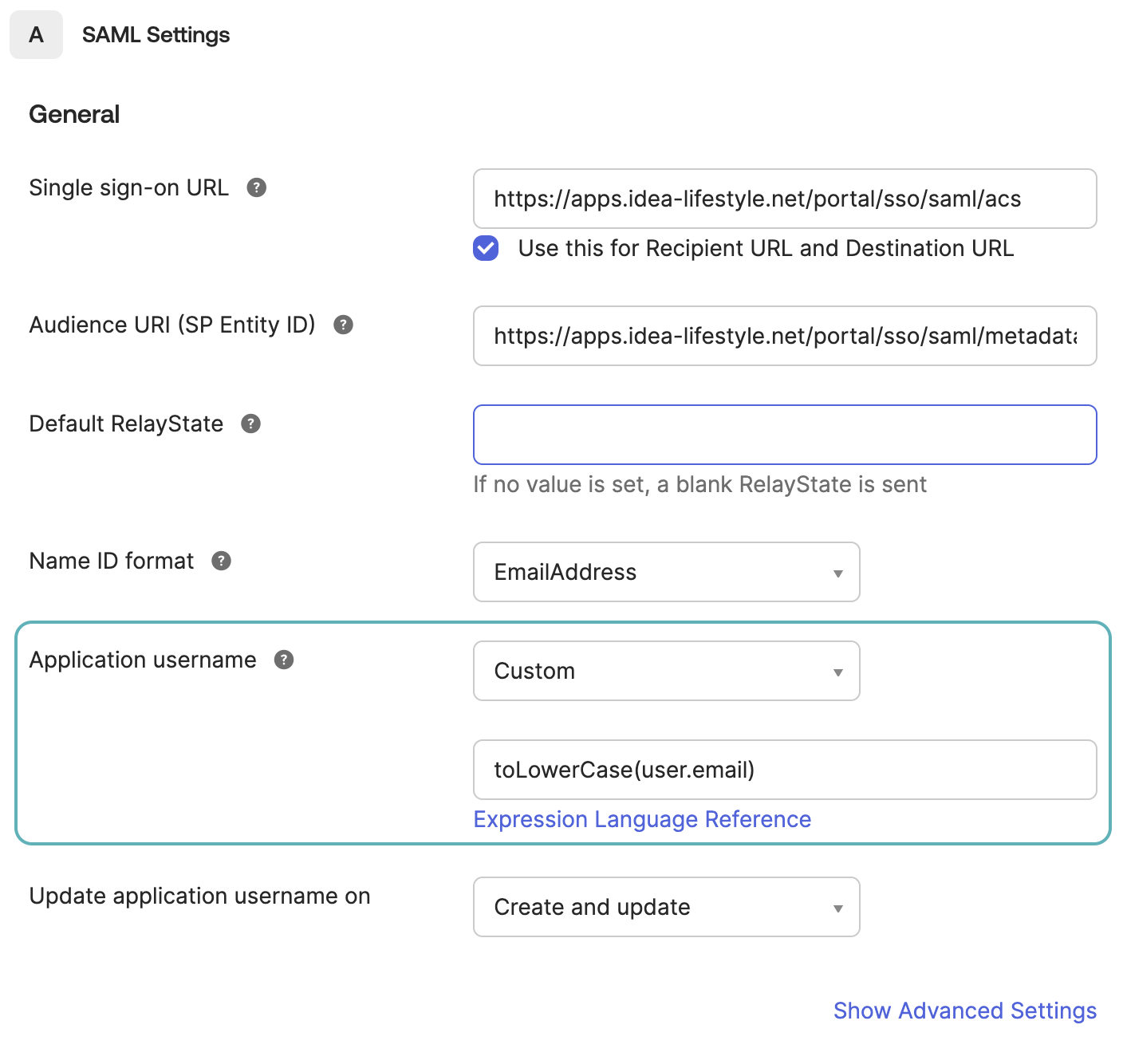

Enter your Single Sign-On URL
In Workato, go to Platform > Workflow apps portal > Settings > Security.
Copy and paste the Single Sign-On URL into its corresponding field in Okta.
SSO URL FORMAT VARIES
The Single Sign-On URL (SSO URL) format varies and is unique to your Workflow apps portal subdomain/domain and the data center in which your account is located.
If you are using the default domain, the Single Sign-On URL follows this format:
https://{subdomain}.workato.app/portal/sso/saml/acsWhere {subdomain} is your portal's subdomain.
If you are using a custom domain, the Single Sign-On URL follows this format:
https://{custom-domain}/portal/sso/saml/acsWhere {custom-domain} is your custom domain name.
Select Use this for Recipient URL and Destination URL.
Enter your Audience URI (SP Entity ID)
Copy the Service provider (SP) entity ID and paste it into the Audience URI (SP Entity ID) field in Okta.
AUDIENCE URI (SP ENTITY ID) FORMAT VARIES
The Audience URI (SP Entity ID) format varies and is unique to your Workflow apps portal subdomain/domain and the data center in which your account is located.
If you are using the default domain, the Audience URI (SP Entity ID) follows this format:
https://{subdomain}.workato.app/portal/sso/saml/metadataWhere {subdomain} is your portal's subdomain.
If you are using a custom domain, the Audience URI (SP Entity ID) follows this format:
https://{custom-domain}/portal/sso/saml/metadataWhere {custom-domain} is your custom domain name.
Select EmailAddress as the Name ID format.
Set the Application username to Custom and enter the following expression. This expression converts the user email to lowercase:
toLowerCase(user.email)

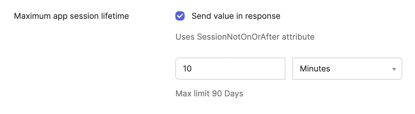

Optionally, you can customize the session duration. By default, the session duration is seven days without group syncing enabled. When group syncing is enabled, the default session timeout is one day.
Customize the session duration
Click Advanced options.
In the Maximum app session lifetime field, select the Send value in response checkbox.
Specify the maximum app session lifetime. For example, enter 10 minutes. This is the new session timeout duration. The maximum limit is 90 days.
Customize session timeout

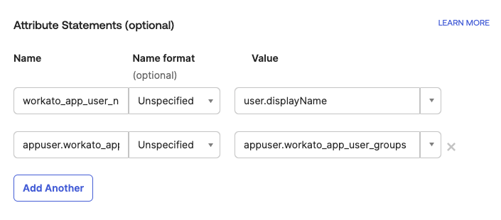

Assign Attribute Statements to your App Integration
In the Attribute Statements section, add the following attribute statements:
| Name | Value | |
| Attribute 1 | workato_app_user_name | user.displayName |
| Attribute 2 | workato_app_user_groups | appuser.workato_app_user_groups |
The resulting attribute statements should look like this:
Add Attribute Statements to your App

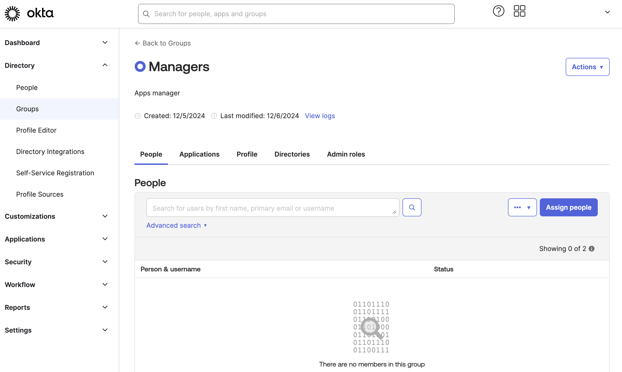

Go to Directory > Groups and click + Add group to add groups to your Okta instance.
Add one or more groups. For example, you might create one group named Managers and another named Members.
Select a group, such as Managers.
Click Assign people and select the users you plan to add to this group.
Assign users to groups

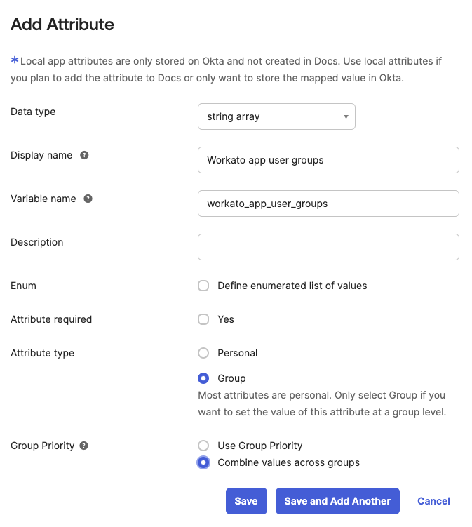

Set up a custom attribute for groups
Okta concatenates multiple values of a string array into a single string of comma-separated values by default. You must have the SAML_SUPPORT_ARRAY_ATTRIBUTES flag enabled in your account to ensure that string array types are returned as multiple values. Contact Okta support to enable the SAML_SUPPORT_ARRAY_ATTRIBUTES flag if it's not already present in your account.
Complete the following steps to set up a custom attribute for groups:
Go to Directory > Profile editor > {App name} User and click + Add Attribute.
Select string array as the Data type.
Add attribute
Enter Workato app user groups as the Display name.
Enter workato_app_user_groups as the Variable name.
Select Group as the Attribute type.
Optionally, set the Group priority to Combine values across groups.
Click Save.

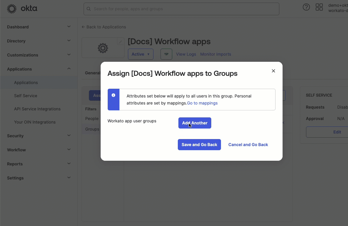

Assign groups to the app
Complete the following steps to assign your Okta groups to your app. This process involves assigning a custom attribute to your groups.

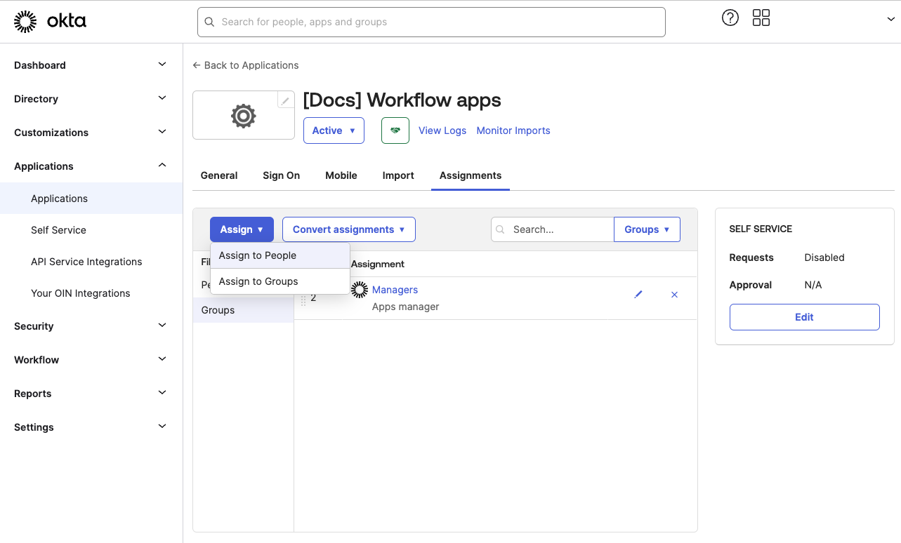

In Okta, go to Applications > Applications and select your app.
Click Assignments > Assign and select Assign to groups.
Click assign to select the groups to assign to this app
Select the group you plan to assign.
Next to the Workflow app user groups, click Add another and enter a group name from your Workflow apps portal. This syncs group assignments between Okta and the Workflow apps portal, ensuring that this Okta group has the app access afforded to the group you specify. In this example, we've assigned Members to the Sales group.
Assign groups
GROUPS MUST EXIST IN WORKFLOW APPS PORTAL
The user group must already exist in Workato to assign it to your Okta groups.
Optionally, click Add another to assign one or more additional groups.
Click Save and go back, and then click Done.

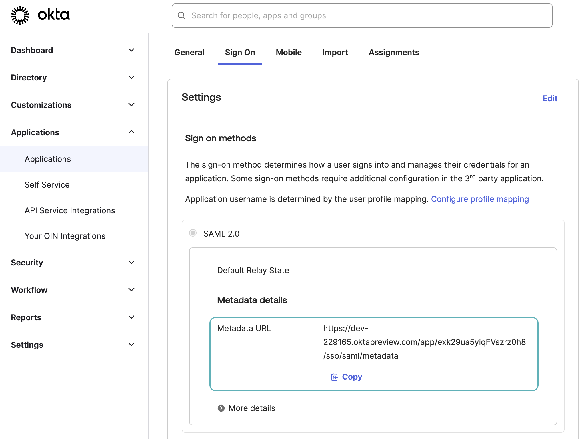

Provide metadata from your IdP. In the Do you have your identity provider metadata URL field, select Yes or No.

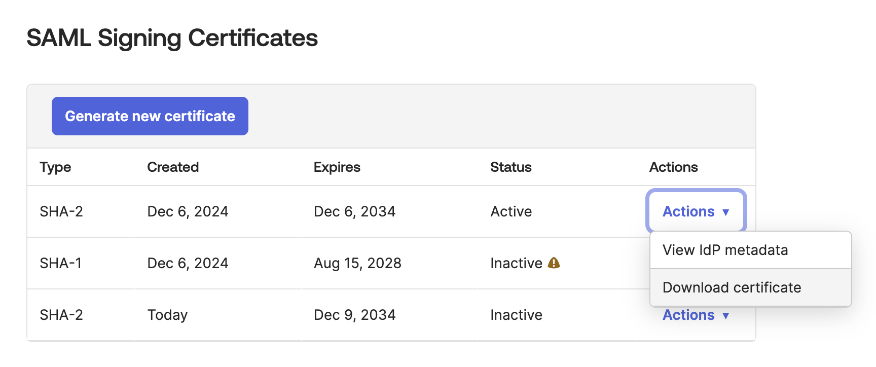

Copy the metadata URL
Download certificate
