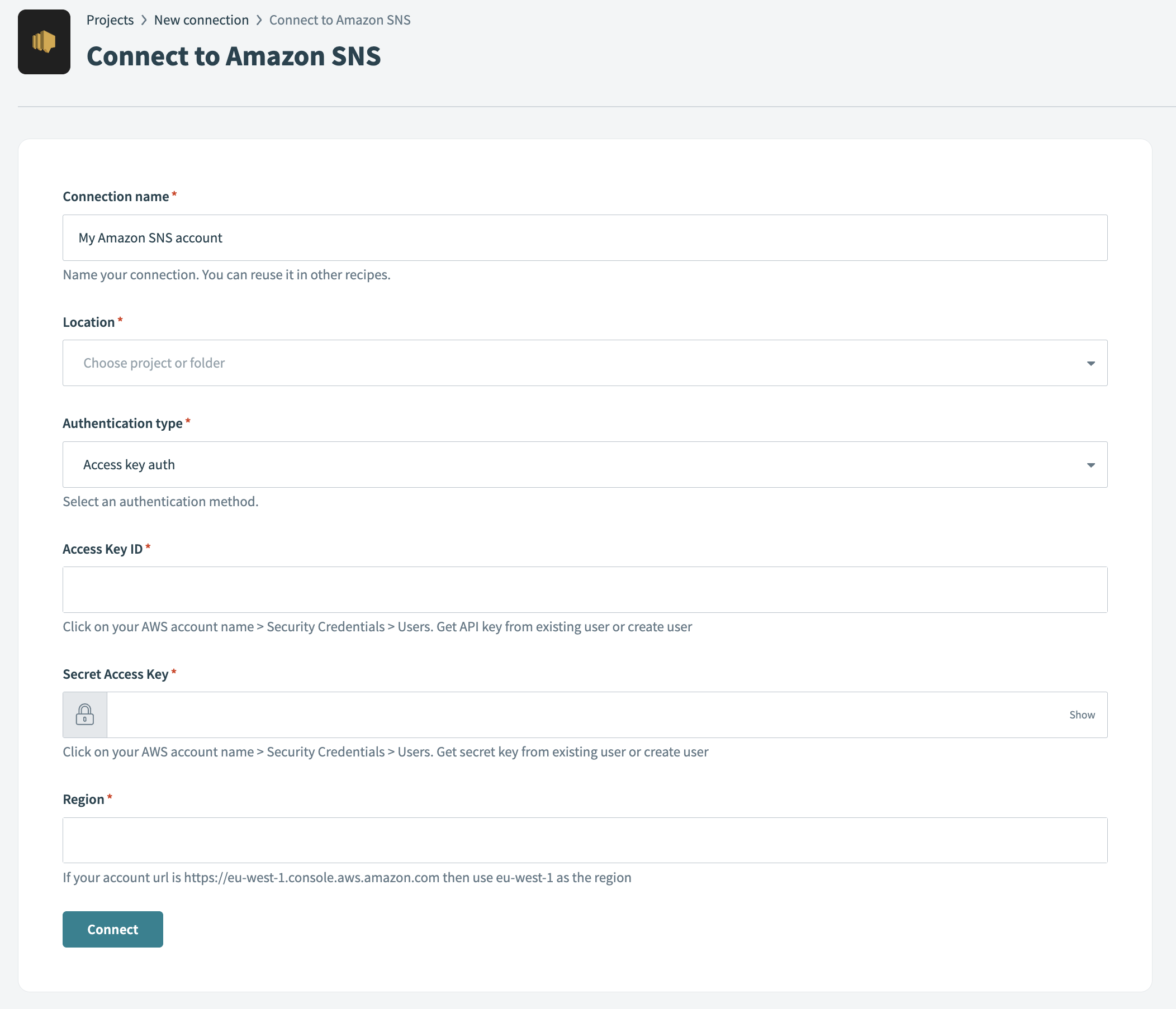

# Connect using an access key authentication
Complete the following steps to create a connection using an IAM user's access key:
Select the project where you plan to store the Amazon SNS connection.
Click Create > Connection.
Search for and select the Amazon SNS connector.
Connection setupAmazon SNS connection setup
Use the Location drop-down menu to select the project or folder where you plan to store the connection.
Use the Authentication type drop-down menu to choose Access key auth.
Enter the Access key ID. Go to AWS account name > Security Credentials > Users to retrieve this value. This is the IAM user's access key ID.
Enter the Secret Access Key from the same page.
Enter the Region of the SNS account. For example, if your SNS URL is https://eu-west-1.console.aws.amazon.com, use us-east-1 as the Region.

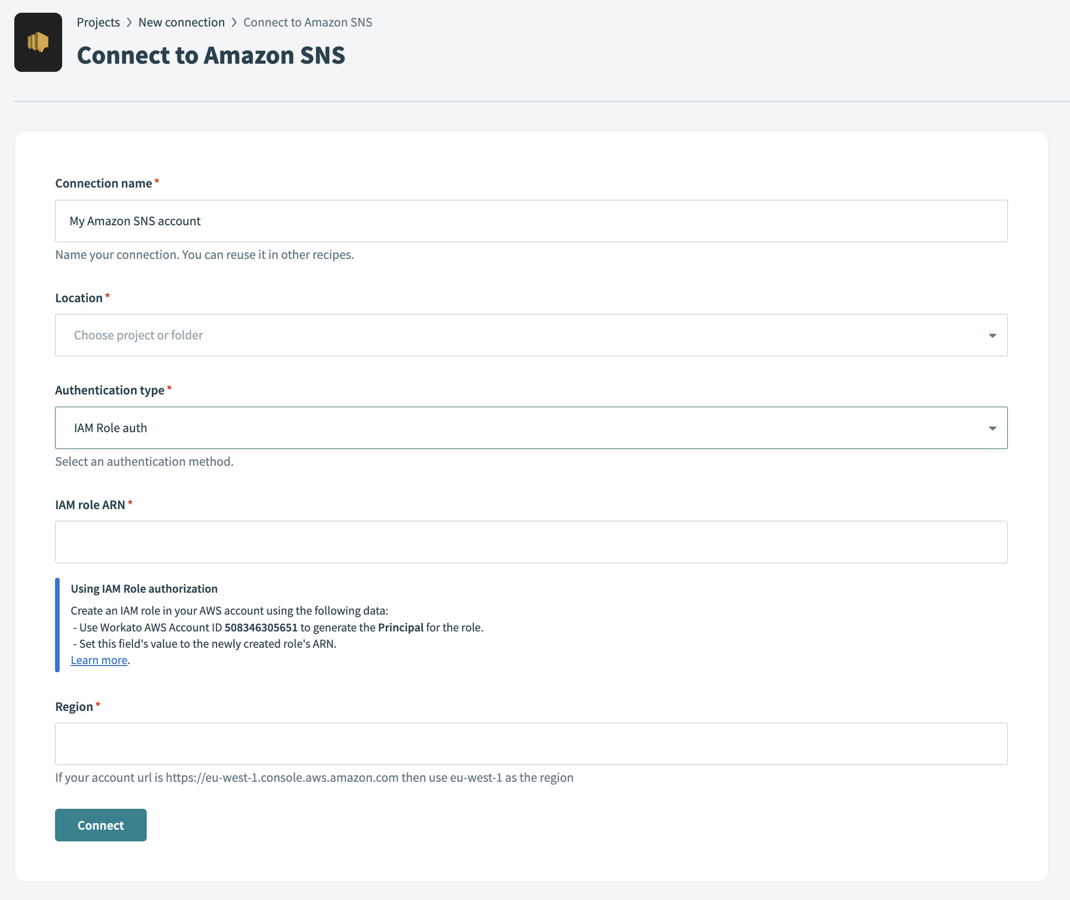

# Connect using IAM role authentication
Complete the following steps to create a connection using an AWS IAM role:
Use the Authentication type drop-down menu to select IAM Role auth.
Enter the IAM role ARN associated with your IAM role. For example, arn:aws:iam::account_id:role/role-name-with-path.
Refer to the IAM Role-based Authentication for AWS Services page for instructions on how to create an IAM role for Workato and retrieve your Amazon resource name (ARN).
Enter the Region associated with your SNS account. For example, if your account URL is https://eu-west-1.console.aws.amazon.com, use us-east-1 as the Region.
