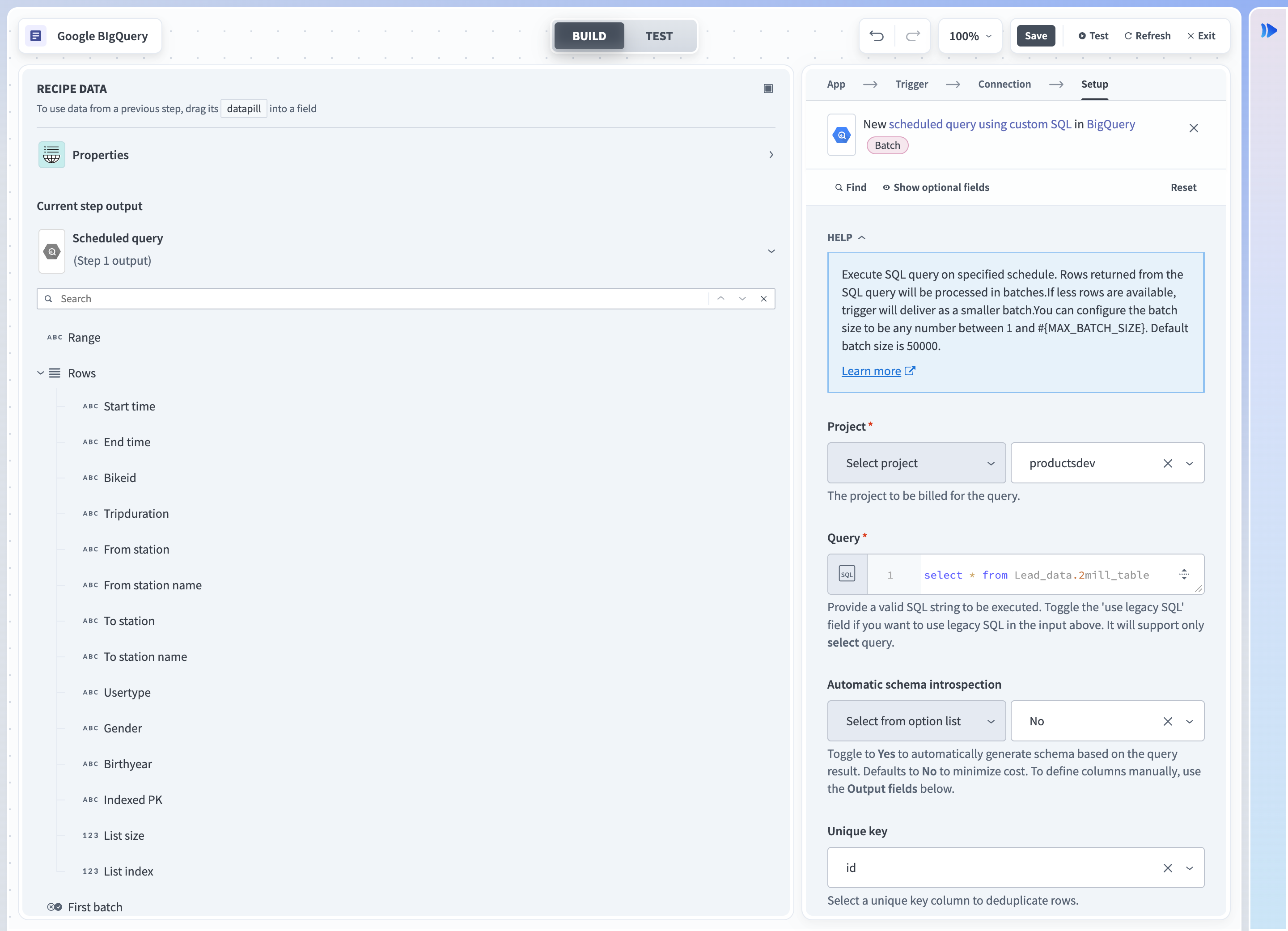

Scheduled query trigger
# Input
Input field | Description |
Project | Select the project to bill for the query. |
Query | Select the query to execute. If a limit clause is used, automatic schema introspection is not allowed. |
Batch size | Select the number of rows in each job. Jobs may be processed faster when batch sizes are smaller. |
Schedule settings | Set how often you want this query to run. The minimum period is 1 hour to give previous triggers sufficient time to batch and complete. |
Automatic schema introspection | Defaults to No . If Yes , Workato automatically tries to introspect the output of your query. In cases where the query takes too long or if datapills are used, toggle this to No and define the output fields of your query manually. |
Output fields | This input field appears when Automatic schema introspection is false . Use this to manually define the output fields of your query. The names given to the output should be identical to the column names expected. Find out how to define your output fields quickly and easily. |
Unique key | Enter a unique key to deduplicate rows with. When we execute the scheduled query, we immediately order by this key. |
Location | Select the geographical location of where the job should run. This field isn't required in most cases. |
Legacy SQL | The default is assumed to be standard SQL. Select true to use legacy SQL instead. |
