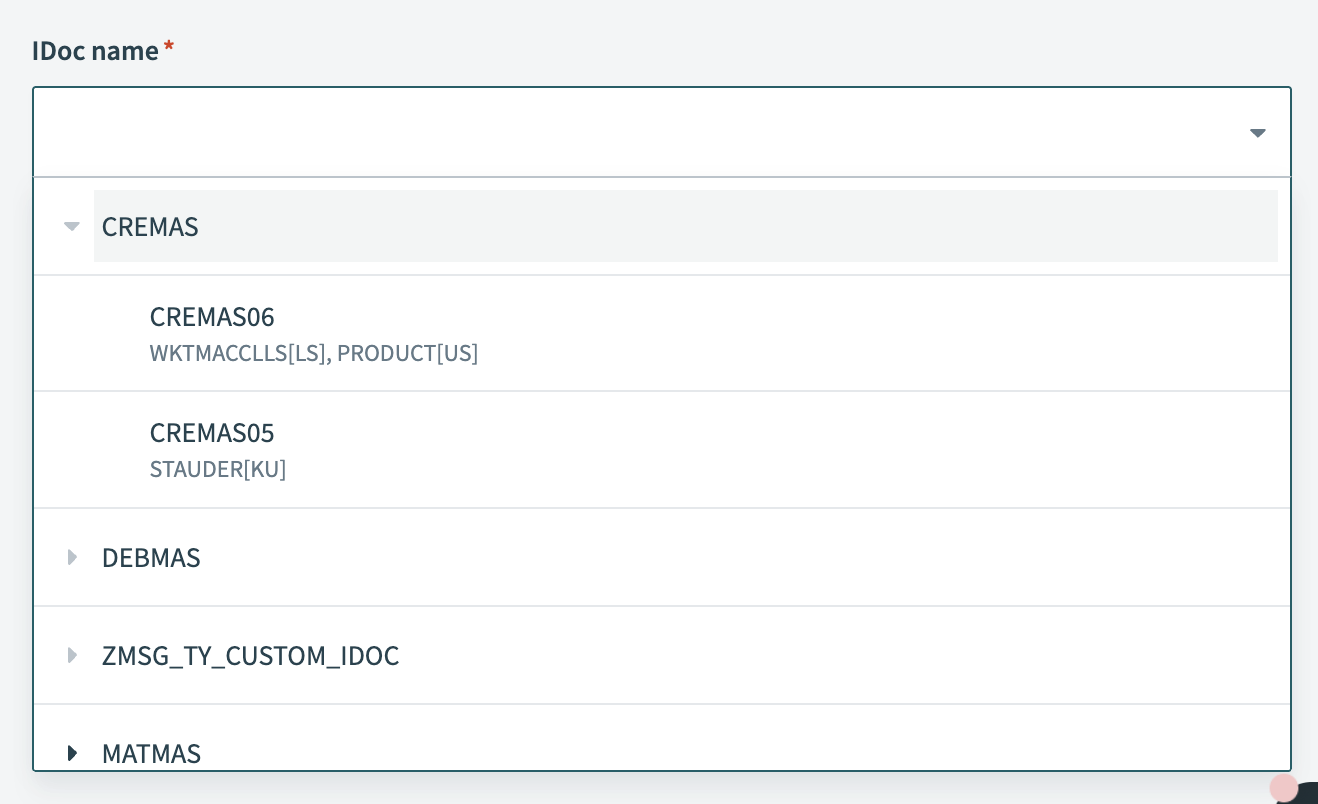

Starting in OPA v27.1, SAP partner details are included automatically in the IDoc description. The description shows the partner number/partner profile and partner type. These values come from the message type, IDoc type, and custom extensions included in the ALE configuration for SAP transaction codes WE20 and BD64.
New IDoc description

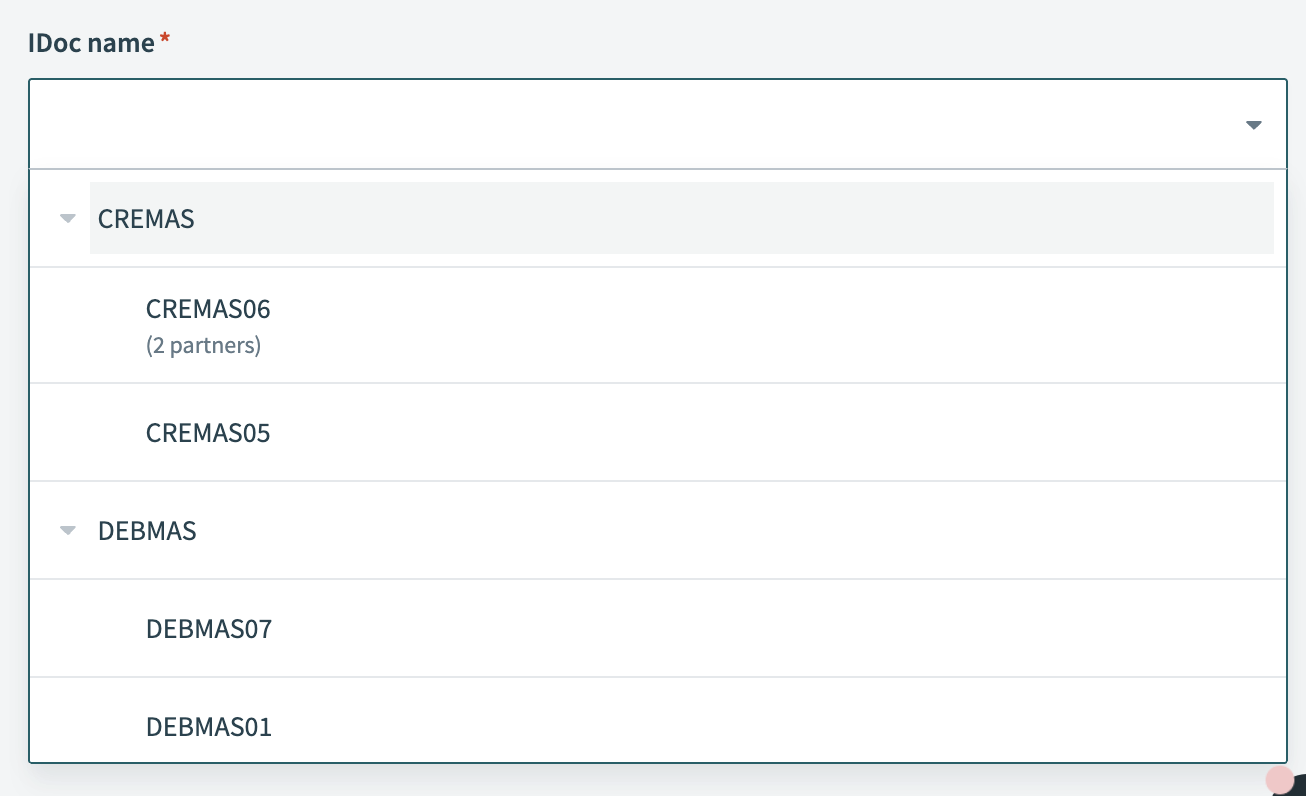

In earlier OPA versions, the description only shows the total number of partners if there is more than one. The description doesn't include partner details.
IDoc description with earlier OPA version
