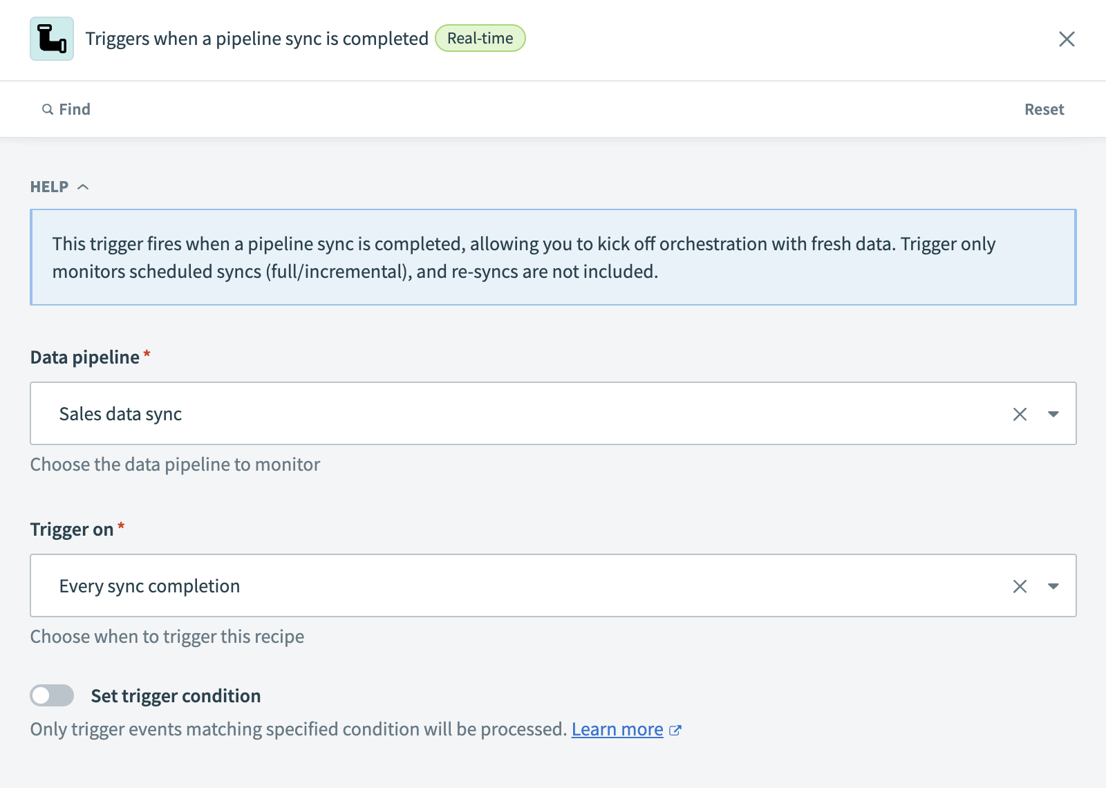

Set up your data pipeline sync trigger
# Set up the data pipeline trigger
This trigger monitors the sync status of a pipeline. It fires every time a sync completes.
Search for PipelineOps by Workato and select it as your app.
Select the Sync completed real-time trigger.
Set up the data pipeline triggerSet up the data pipeline trigger
Choose the Data pipeline you plan to monitor.
Select Every sync completion in the Trigger on field .
Workato recommends selecting Every sync completion instead of Failed syncs. This ensures you capture object-level failures, which may not be tracked under sync-level failures.
Set up your trigger condition
# Set up a trigger condition
You can set a trigger condition directly in the trigger setup.
Enable the Set trigger condition toggle.
Map the Sync state Step 1 datapill to the Trigger data field.
Set up your trigger conditionSet up your trigger condition
Set Condition to contains.
Set Value to ERROR.

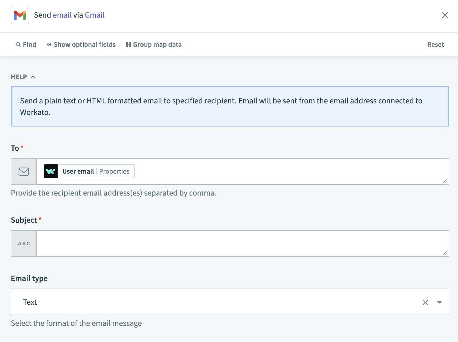

Set up a Gmail alert
# Send an email when a pipeline sync fails
This step sends an email from your connected Gmail account when a pipeline sync fails.
Select the Send email action.
Enter one or more recipients in the To field. Separate multiple email addresses with commas.
Configure your Gmail actionConfigure your Gmail action
Enter a subject in the Subject field, such as Pipeline Sync Failure Alert.
Select Text or HTML in the Email type field.
Enter the message body in the Message field.
