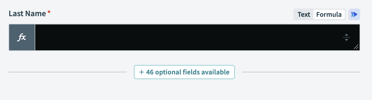

When starting a new or empty formula field, complete the following steps to get direct help from AIRO:
Navigate to any trigger or action step within your recipe that requires data transformation.
Click on the Formula tab in the input field to dynamically set values based on your recipe data.
Navigate to the Formula tab
Select the Ask AIRO to fill field button within the formula box for empty fields to allow AIRO to generate your formula.
Ask AIRO to fill the input field

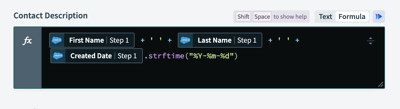

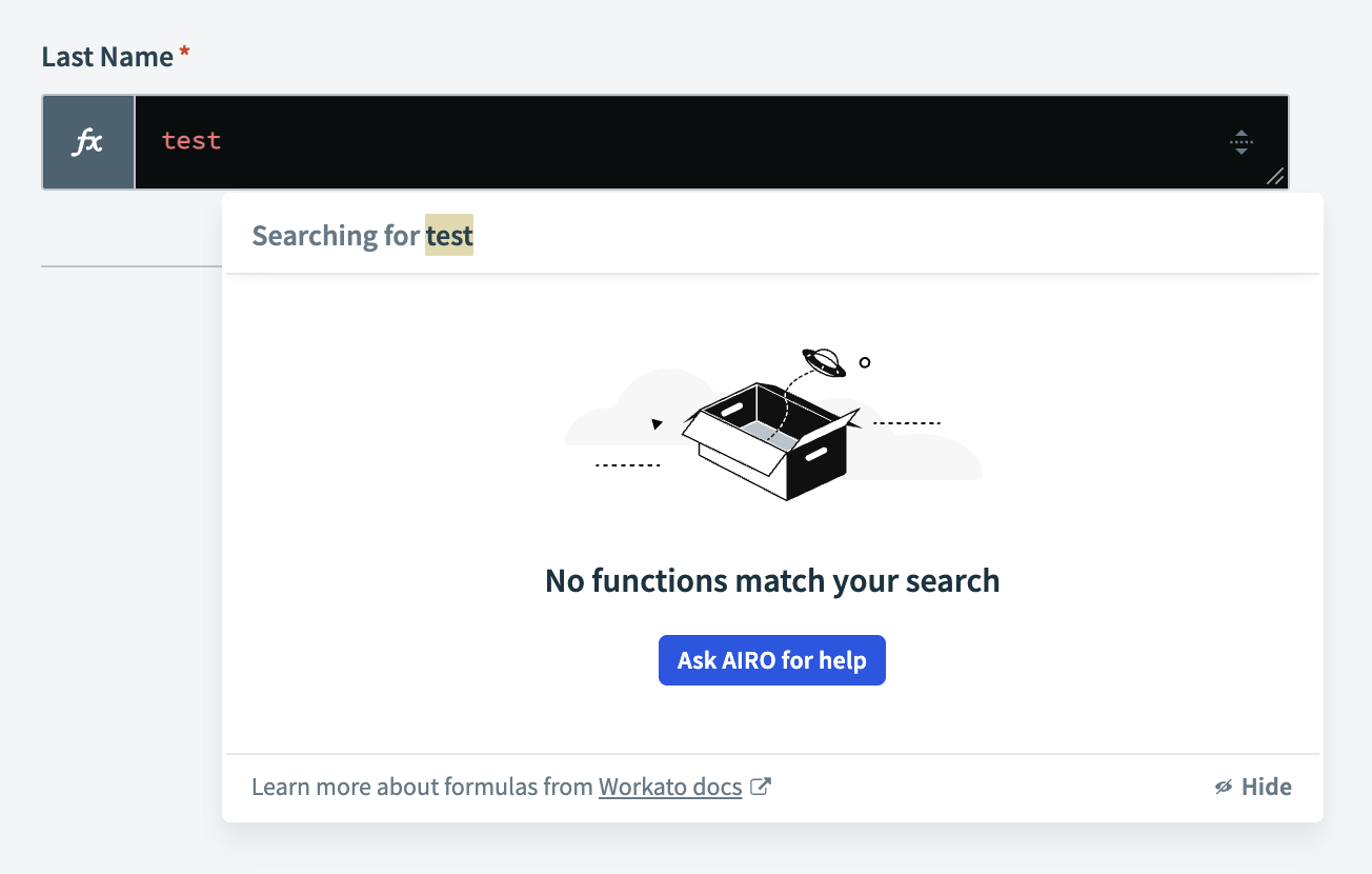

Click on the Formula tab and begin formulating your input.
Click Ask AIRO for help if your input results in no function matches, indicated by No functions match your search.
Ask AIRO for help when no function matches

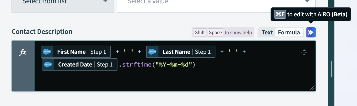

When fine-tuning formulas, you can click the AIRO icon within any formula field to activate AIRO. This feature ensures AIRO is readily accessible to streamline your formula editing process.
Click the white box to activate AIRO for formula assistance

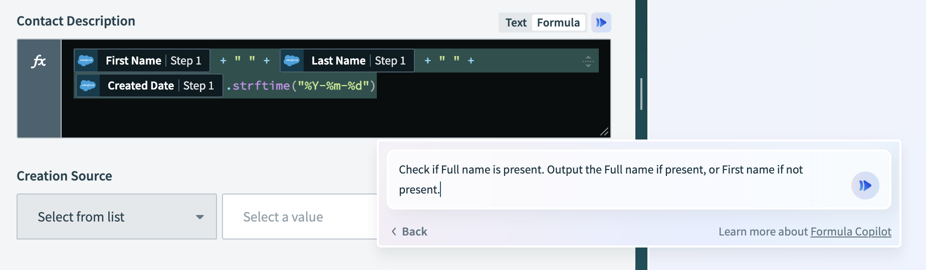

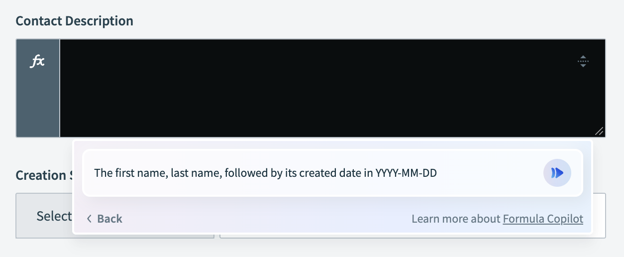

Type your formula requirements or a description of the transformation you require directly into the prompt. Select the Back option if you plan to revise your input or view previous suggestions.
Generate a formula prompt in AIRO

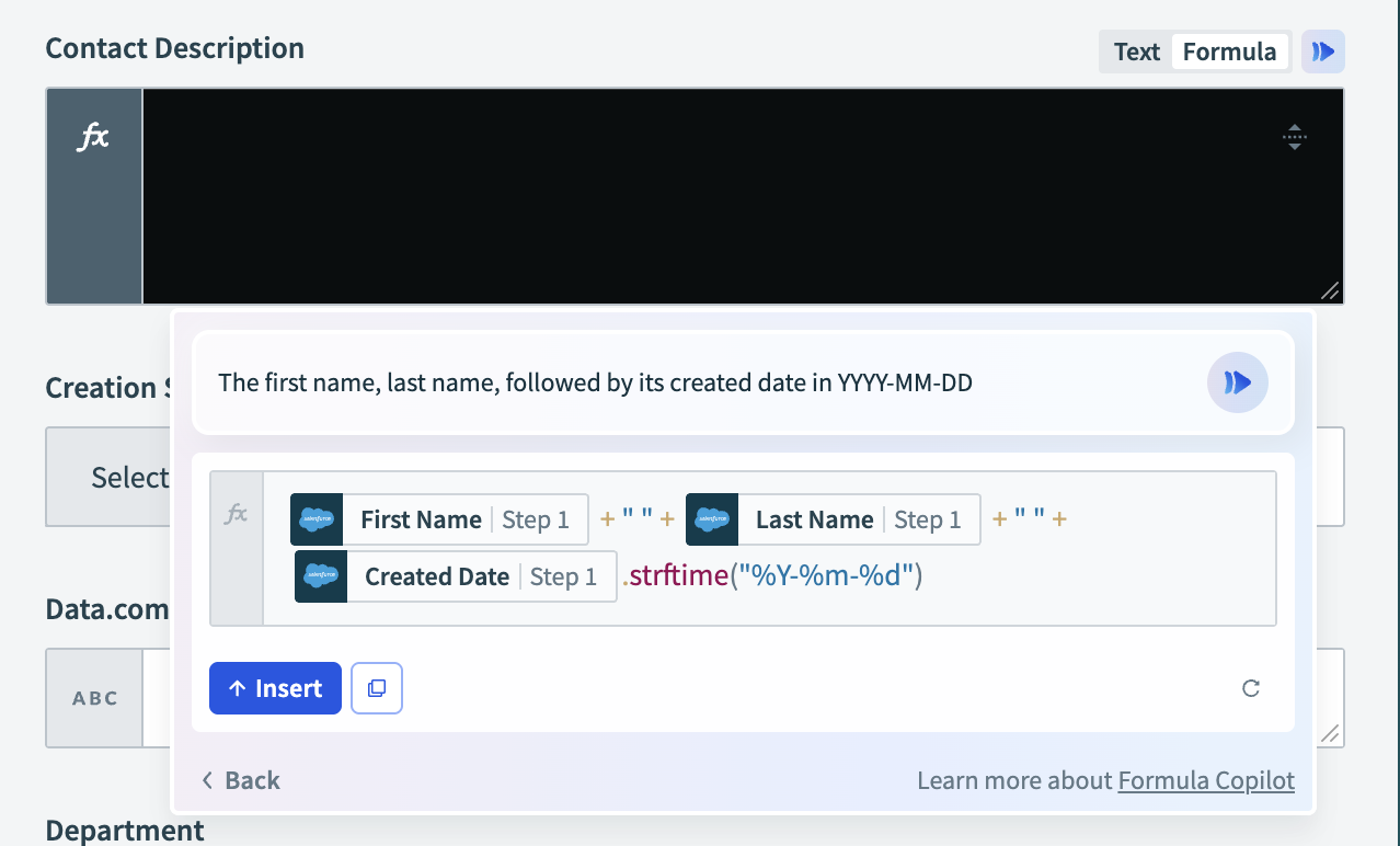

Click the send button to begin the formula generation process. The system displays Generating input…, indicating that it is processing your input for suggestions. You can also select Stop to cancel the process.
Generate the formula in AIRO

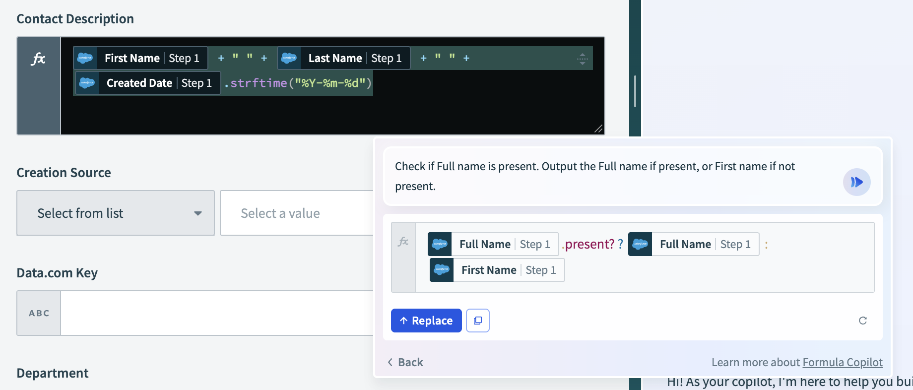

Examine the formula suggestion that AIRO generates to ensure that the formula meets your transformation requirements.

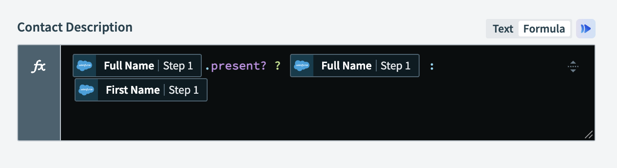

Insert the suggested formula directly into your formula field or click Copy to clipboard to use it in another part of your recipe.
Insert the generated formula into the input field
Use the provided suggestion or refine it to ensure it aligns with your specific data needs and preferred output format.
Refine existing input or AIRO-generated formulas
If you already have input in the formula field or need to refine a formula generated by AIRO, complete the following steps to tailor the suggestions to your requirements:
Activate AIRO by clicking Fill field with AI in the formula box. This step is crucial whether you're starting with a datapill, have existing input, or are refining a formula previously generated by AIRO.

Enter your specific requirements in the prompt to customize the formula suggestion.
Type the new requirements for the formula
Examine the AI-generated formula suggestion to ensure it matches your intended output.
Review the updated formula suggestion
Select Replace to adjust the formula.
Replace the formula

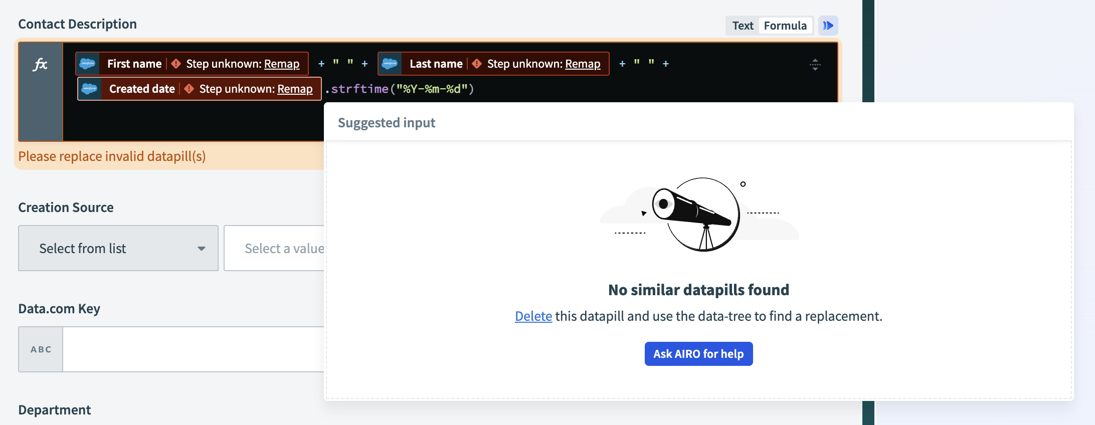

Remap unknown datapills
If AIRO does not find similar datapills for your formula, complete one of the following options:
- Delete the unmatched datapill and manually select a replacement from the data tree.
- Select Ask AIRO for help to get AI-assisted suggestions for remapping the datapills.
Remap unknown datapills in AIRO
Following these steps ensures that your formula accurately references the correct datapills within your recipes.

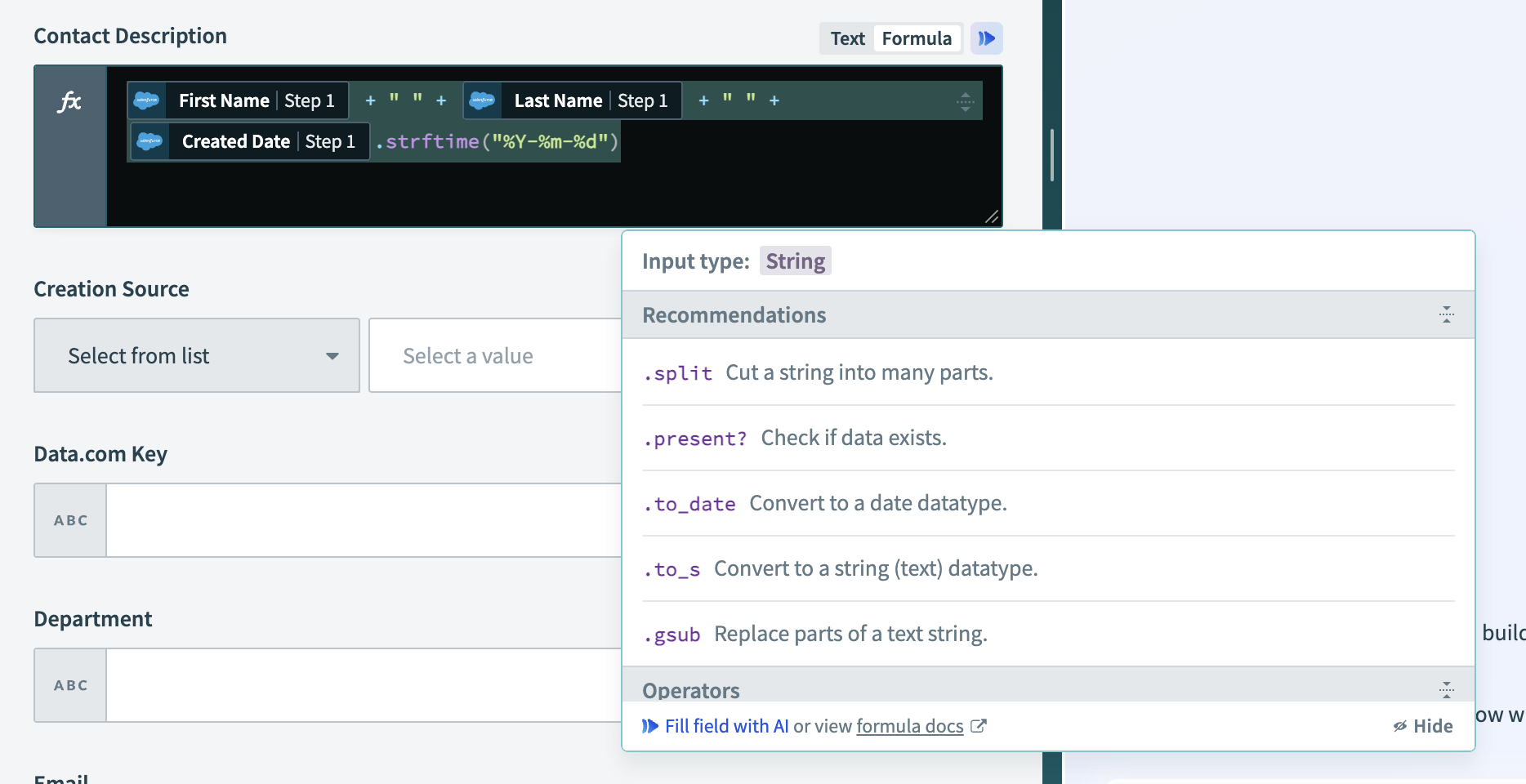

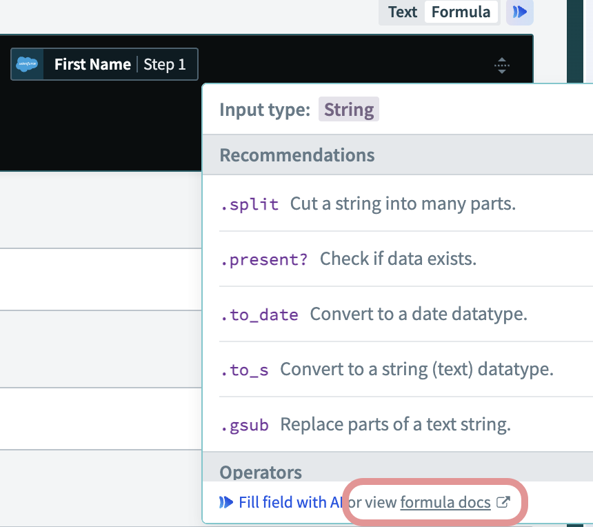

Use formula recommendations
When you insert a datapill in formula mode, AIRO provides recommendations for functions in the input field. If you type a recognized function, such as .where, the footer displays a direct link to that function's detailed explanation in Workato's formula documentation. For additional support, you can click Fill field with AI in the footer to prompt AIRO to generate a relevant formula for your needs.
Link to a function in Workato’s formula documentation
