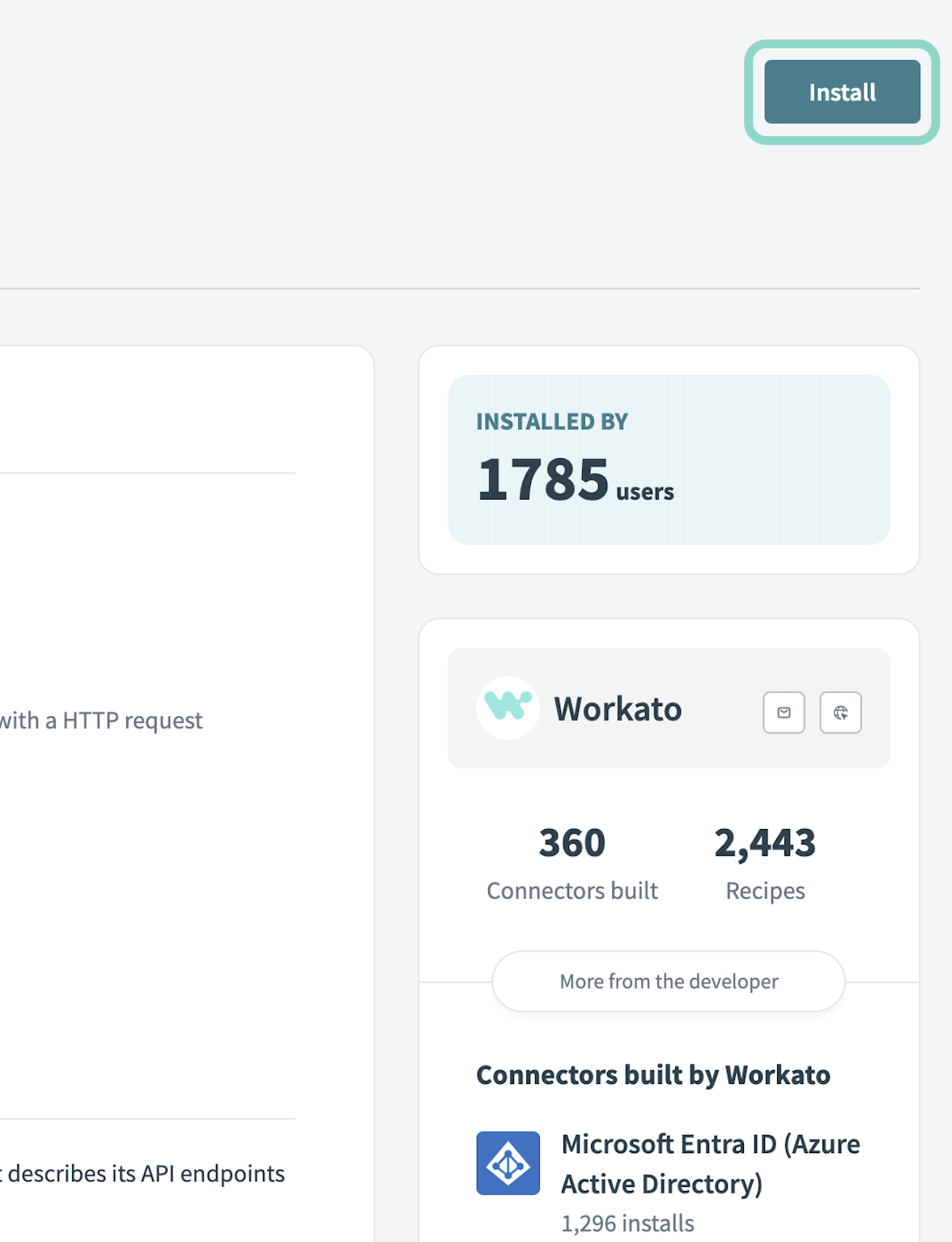

# Download the GraphQL connector from the Community library
Complete the following steps to install the connector from the community library (opens new window):
Open the recipe editor and search for a connector. Alternatively, you can search for a connector in the community library (opens new window).
Search for recipe editor Search for community connectors in the recipe editor
Click installClick Install
