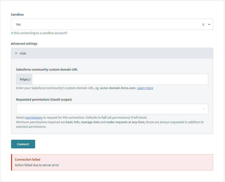

# Salesforce connection failed: Action failed due to server error
The action failed due to server error message displays when you click Connect to establish a Salesforce connection and it fails.
action failed due to server errorSalesforce connection fails with an action failed due to server error message
Complete the following steps to resolve this error and successfully establish a Salesforce connection:
Verify the domain. Use the correct Salesforce domain or custom domain:
  • Set the Sandbox field to Yes if your Salesforce domain ends with .sandbox.my.salesforce.com, or No if it ends with .my.salesforce.com.

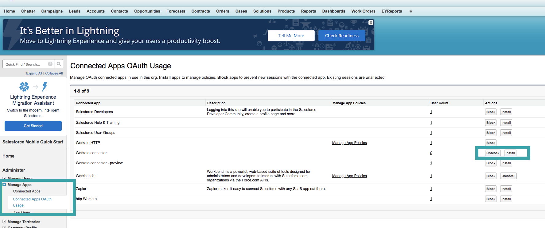

Confirm that Salesforce doesn't block Workato. If the Workato connector is blocked, go to Manage Apps > Connected Apps OAuth Usage, then click Unblock next to the app name.
Unblock Workato in SFDCUnblock Workato in SFDC
