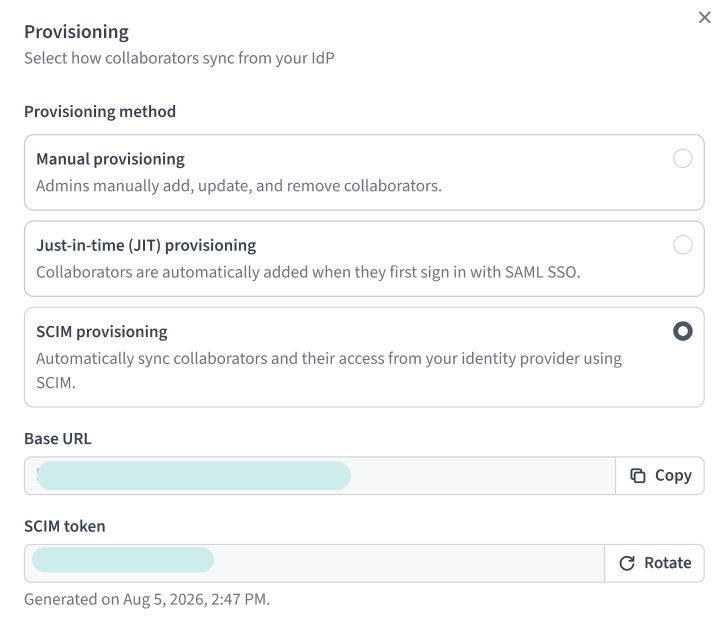

Rotate SCIM token
You can rotate your SCIM token in Control plane.
Complete the following steps to rotate your SCIM token:
Go to Enterprise controls and click Control plane.
Sign in using your Control plane credentials or SSO.
Go to Settings > Authentication.
Go to the Identity provider (IdP) for SAML SSO section and click the ... (ellipsis) option menu of the IdP with SCIM token you plan to rotate.
Click Provisioning to open the Provisioning modal.
Click Rotate.
Click RotateClick Rotate
Click Save changes.
