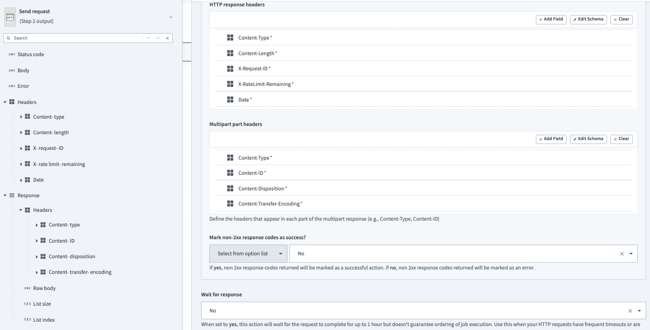

Output ​
Output fieldDescription
Status codeThe status code of the API response.
BodyThe body content of the response.
ErrorAny errors the request encountered.
HeadersContains information about the headers extracted from the response, based on the configuration of the Response section.
ResponseContains information about the response, based on the configuration of the Response section.

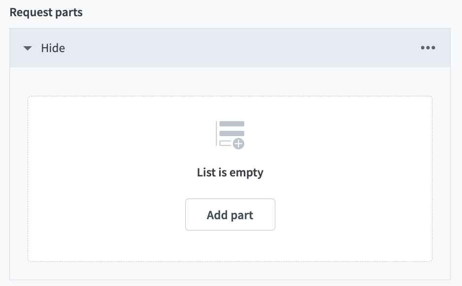

Go to the Request parts section. This section defines multiple parts for the request, where each part has its own headers and body content.
The Request parts sectionThe Request parts section
Click ... (ellipses) to choose between a Fixed list or Dynamic list.
Select Fixed list when you know the total number of parts and their content. Select Dynamic list when the number of parts or their content depend on a list.

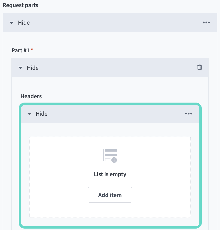

Go to the Headers section. This section defines headers for each request part.
The Headers sectionThe Headers section
Select Fixed list when you know the total number of headers and their content. Select Dynamic list when the number of headers or their content depend on a list.

Complete the following steps to configure the Send request via HTTP action's Response section to receive multipart responses:
Use the Response content type drop-down menu to select Multipart.
Workato automatically detects the boundary from the response's Content-Type header.
For example, Workato extracts ----Boundary123 and uses it to parse the response parts if the API returns the following:
http
Content-Type: multipart/mixed; boundary=----Boundary123
If the boundary is missing, Workato throws an error.
Use the Encoding drop-down menu to select the encoding method.
Complete the following steps in both the HTTP response headers and Multipart part headers sections. The HTTP response headers section defines headers to extract at the response-level, while the Multipart part headers section defines headers to extract from individual parts.
Use the Mark non-2xx response codes as success? drop-down menu to select whether to mark non-2xx responses as successful. Workato's HTTP connector treats non-2xx response codes as errors by default. This causes the job to stop unless there is a Handle errors step.
The output datatree updates with the headers you defined. For example:
The Send request via HTTP output treeThe Send request via HTTP output tree
