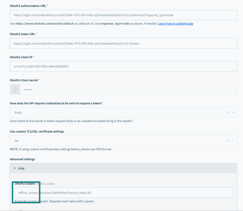

Set the OAuth 2.0 scope field to include offline_access
when configuring the HTTP connection. This allows the connection to receive a refresh token and automatically renew the access token after it expires.
Include
offline_access
scope
Reconnect the HTTP connection after you save the updated configuration.
