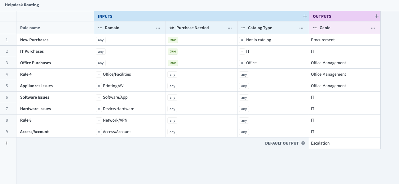

Open the Decision table node and add your routing rules as rows. Rules are evaluated top to bottom: the first matching row determines the output. You can also set a Default output that applies when no rule matches. For example:
Rule nameDomainPurchase neededCatalog typeGenie
New purchasesAnytrueNot in catalogProcurement
IT purchasesAnytrueITIT
Office purchasesAnytrueOfficeOffice Management
Office/Facilities issuesOffice/FacilitiesAnyAnyOffice Management
Printing/AV issuesPrinting/AVAnyAnyOffice Management
Software issuesSoftware/AppAnyAnyIT
Hardware issuesDevice/HardwareAnyAnyIT
Network/VPN issuesNetwork/VPNAnyAnyIT
Access/Account issuesAccess/AccountAnyAnyIT
Default outputEscalation
Configure routing rules in the decision tableAdd routing rules as rows in the decision table

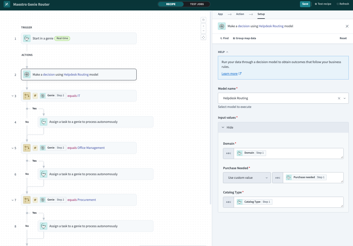

This step calls the routing decision model and retrieves the name of the specialist genie to assign the request to.
Click + Add step in the recipe editor.
Search for and select Decision Models by Workato.
Select the Make a decision action.
Use the Model name drop-down to select your Request routing model.
Map the input datapills to the model's input fields:
  • domainDomainStep 1 from the skill trigger
  • purchase_neededPurchase neededStep 1 from the skill trigger
  • catalog_typeCatalog typeStep 1 from the skill trigger
Map datapills to routing decision model inputsMap skill trigger datapills to the routing model's input fields
Click Save.

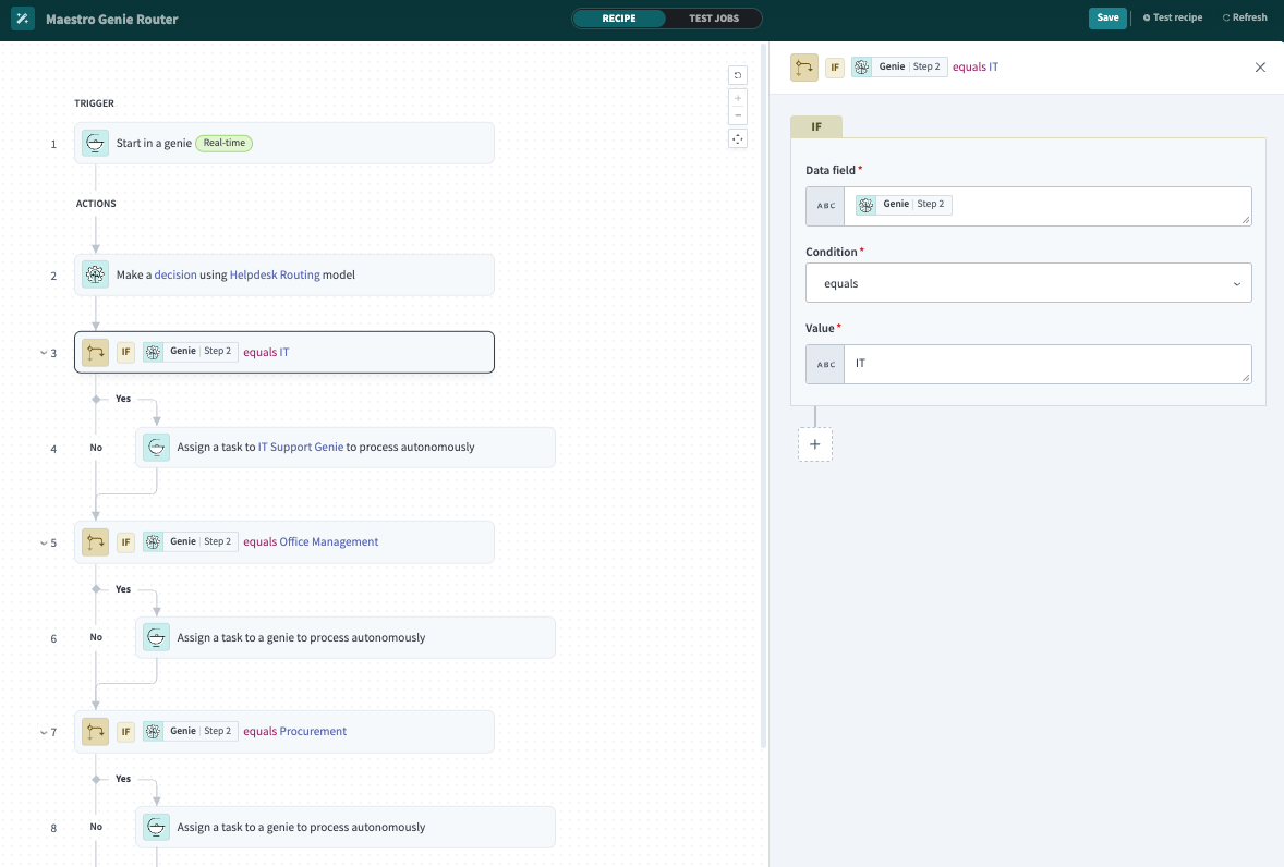

This step uses IF conditions to branch on the decision model's Genie output and assign the task to the correct specialist genie using agent orchestration.
Select IF condition.
Set the Data field to the Genie output datapill from the Make a decision step, set Condition to equals, and enter the name of the first specialist genie as the Value, for example, IT.
Go to the Yes branch, click + Add step, search for and select Workato Genie, and select the Assign a task to genie action.
Configure the action to assign the request to the matching specialist genie.
Repeat steps 1–3 for each routing value from the decision model, for example, Office Management and Procurement. Each branch can assign the task to a specialist genie or trigger a different action. For example, an Escalation branch could update a Jira issue and assign it to an on-call team instead of routing to a genie.
Configure agent orchestration IF conditionsAdd an IF condition and action step for each routing value
Click Save.
