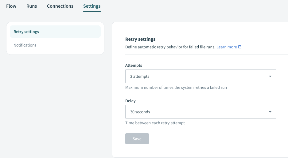

Retry settingsRetry settings
Complete the following steps to configure automatic retry settings:
Select the File transfer asset that you plan to configure.
Go to Settings > Retry settings.
Enter the maximum number of retries in the Attempts field. The maximum value is 10, and the default is 3.
Use the Delay drop-down menu to select the time to wait between attempts. The default delay is 5 seconds.
Click Save.

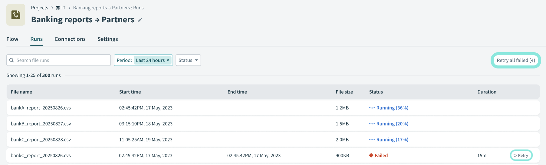

# Manual retry
Complete the following steps to manually retry transfers that have reached the automatic retry limit:
Select the File transfer asset that you plan to retry.
Go to the Runs tab.
Click Retry on a failed row to retry a single transfer, or click Retry all failed to retry all failed transfers.
