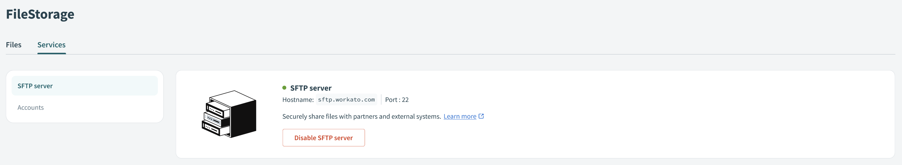

Enter a unique workspace identifier in the Set up identifier dialog. This identifier is permanent and must be unique within your Workato workspace.
Set up identifierSet up workspace identifier
The preview shows the final identifier format.
Click Set up to confirm and save your identifier.
Enabled SFTP serverEnabled SFTP server
The server is enabled immediately, and the connection details, including hostname and port, display on the page.

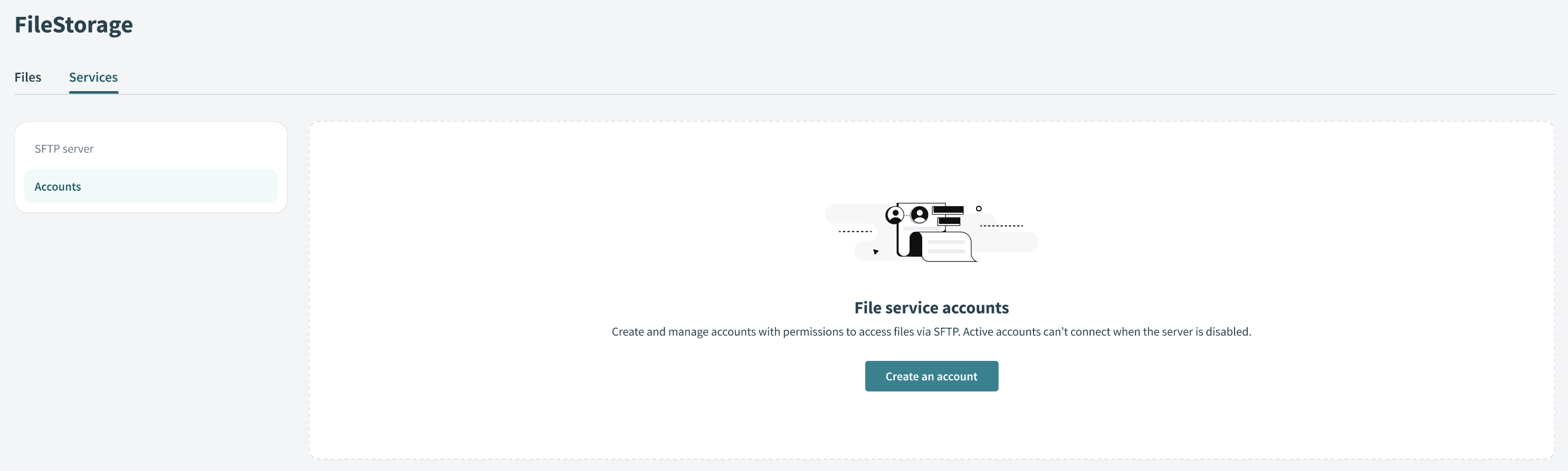

# Create an SFTP account
You can create user accounts to grant external entities access to the SFTP server after the workspace identifier is configured. Each account has isolated access to the folders you specify.
Complete the following steps to create an SFTP account:
Go to Platform > Managed File Transfer > File Services > Accounts.
The Accounts pageThe Accounts page
Click Create account. The Create an account modal opens.
Enter a Username for the SFTP account. The username must be between 3 and 32 characters and only use alphanumeric characters. Workato automatically appends your workspace identifier to create the full username. For example: name@workspace-identifier.

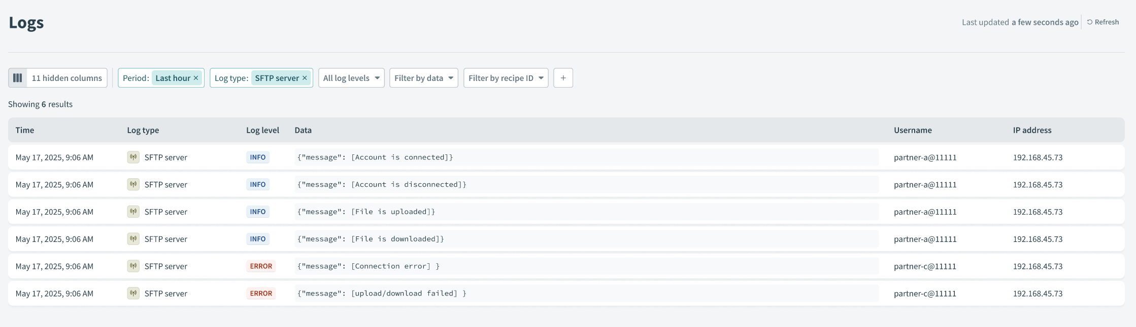

# Server logs
Workato's logging service captures detailed information for every server activity in Tools > Logs. Use these logs to view successful and failed connections, track file uploads and downloads, and troubleshoot errors across file transfers.
Server logsServer logs
Workato logs the following event types:
  • Authentication events: Displays whether authentication succeeded or failed, the username, IP address, and reason of failure (if applicable).
  • File operations: Record upload, download, and delete activity, including the username, file path, size, IP address, and failure reason (if applicable).
Use the following filters to locate specific logs:
  • Period: Select a preset such as Last 30 days or define a custom date range.
  • Log type: Select File Servers to view logs related to MFT file server activity.
  • Log level: Select INFO to view successful events or ERROR to investigate failures.
